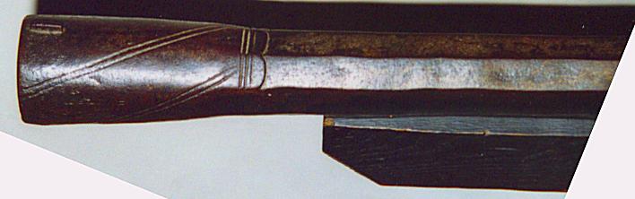

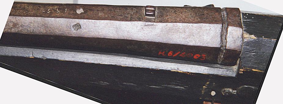

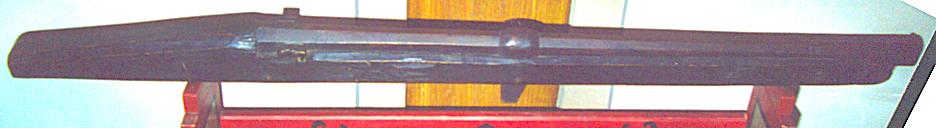

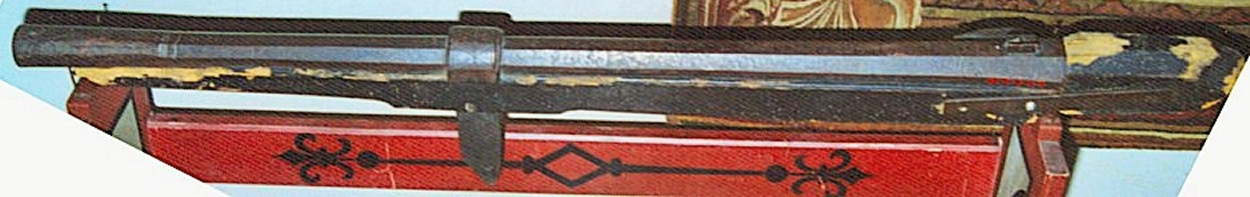

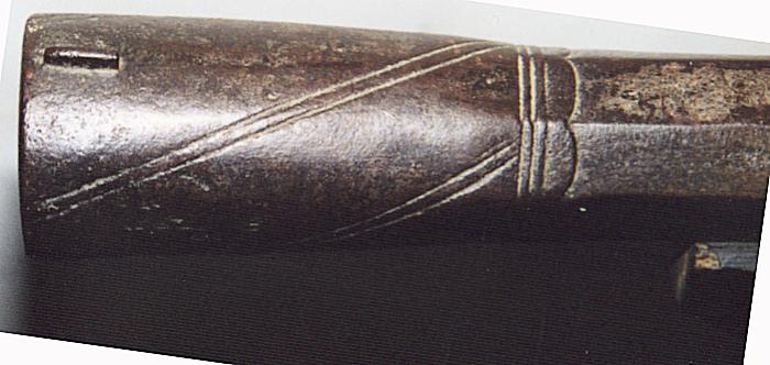

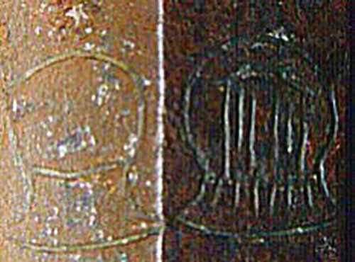

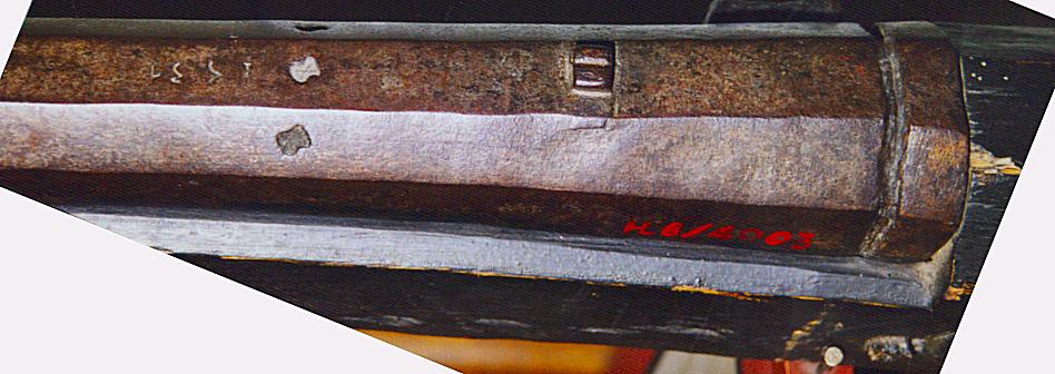

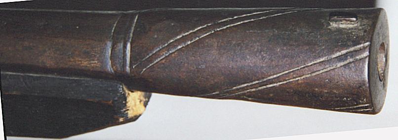

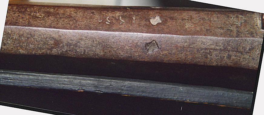

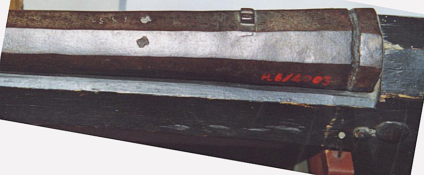

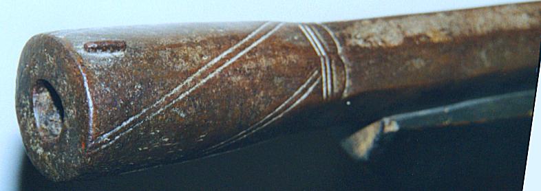

Attached here is another detail of the muzzle section of the gun discussed in the previous post.
A matchlock barrel in the Landeszeughaus Graz, inv.no. RG 2 in Robert Brooker's Eine Radschloss-Sammlung - A Wheellock Collection, 2007, mounted on a later stock, and together with a ca. 1535-40 wheellock mechanism, is struck with that mark and the date 1537 (definitely misread as 1527 in Brooker) - see author's photos from 2005 attached.
Two important matchlock arquebuses, the barrels struck twice wit that crossed arrows mark and the date 1539, are in the Germanisches Nationalmuseum Nürnberg, inv.no. W 494, and in the author's collection respectively - see:
post #66 in this thread,
and
http://www.vikingsword.com/vb/showth...harquebus+1539
For cranequins with that mark dated 1532, 1540 and 1545 respectively, see:
http://www.vikingsword.com/vb/showth...cranequin+1532
and attachment to post #70 in this thread.

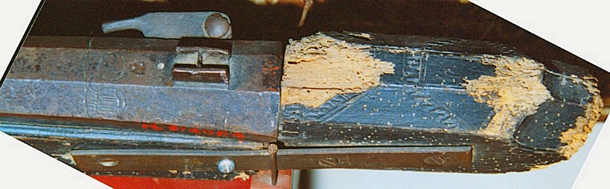

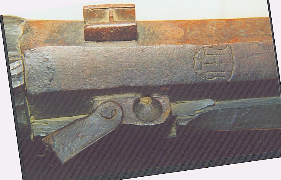

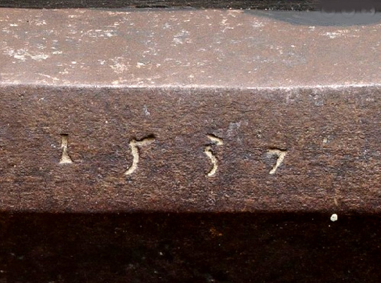

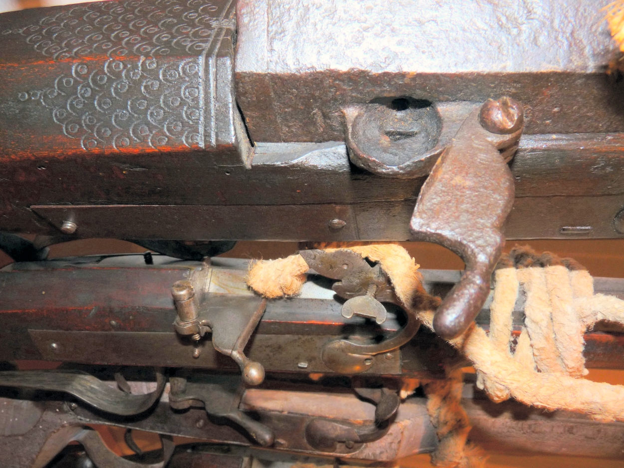

Attached are photos of another, almost identical wall gun still preserved in the Hohenlohe-Langenburg collection, the barrel struck with the same mark and the identical date 1537; most probably, the stock is the original although figured slightly diferent from that of the first piece.
Author's photos.

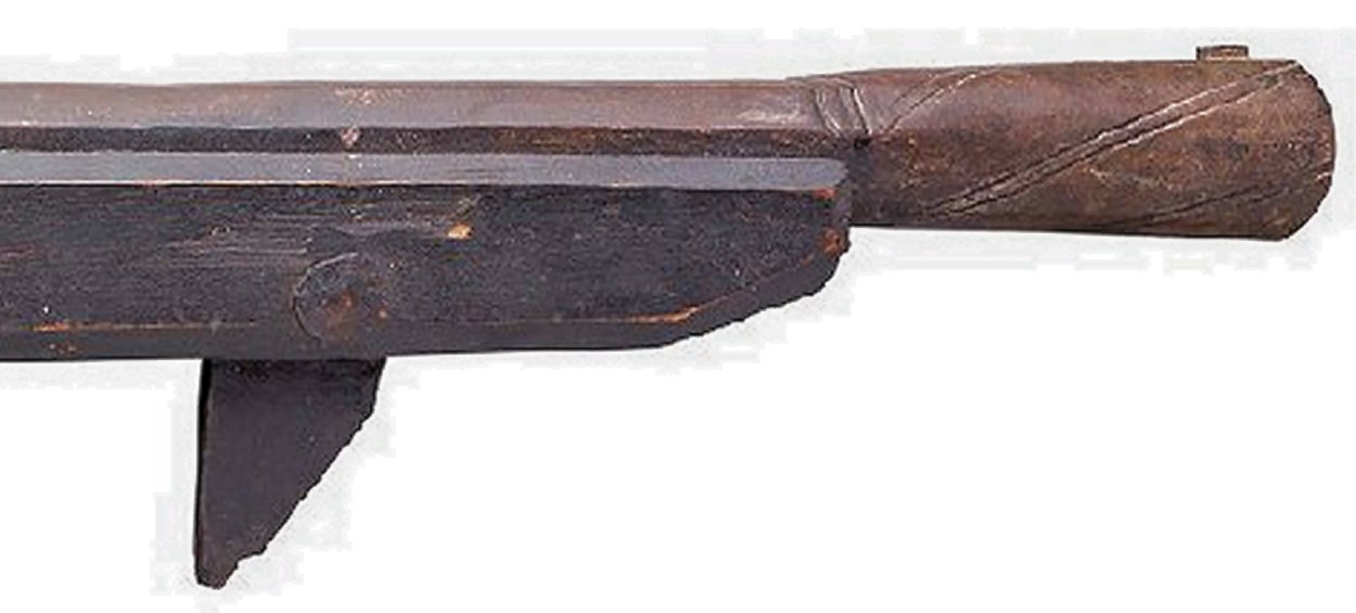

Old 9th December 2014, 11:25 PM   #92
Matchlock
Matchlock's Avatar
Join Date: Sep 2008
Posts: 4,310

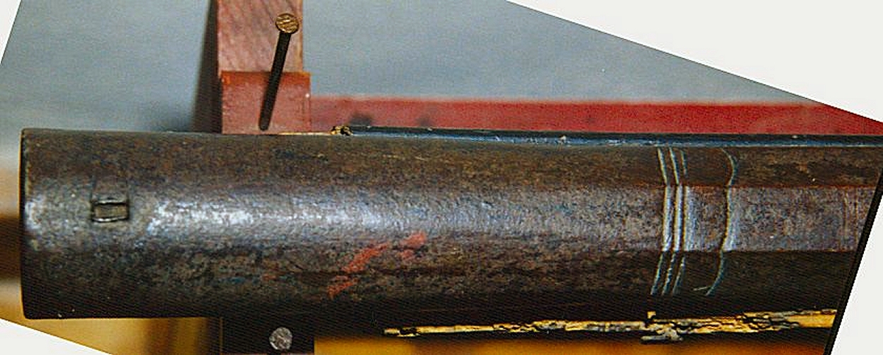

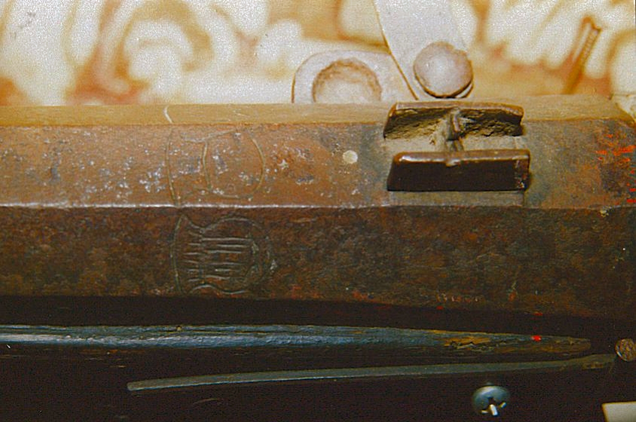

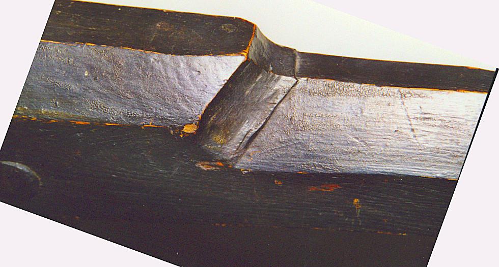

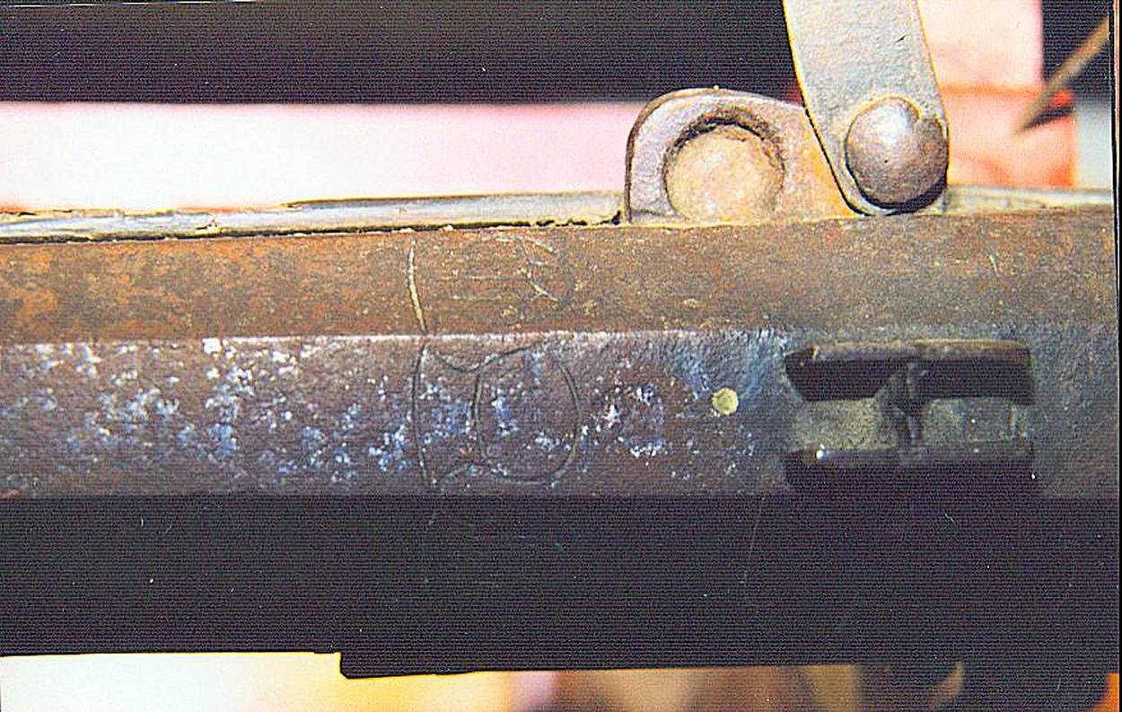

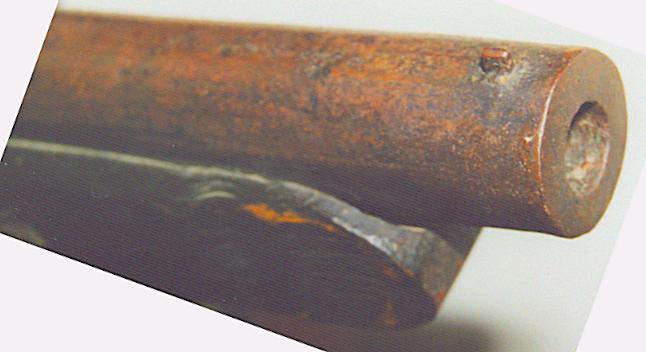

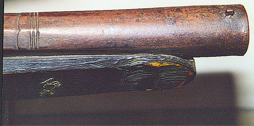

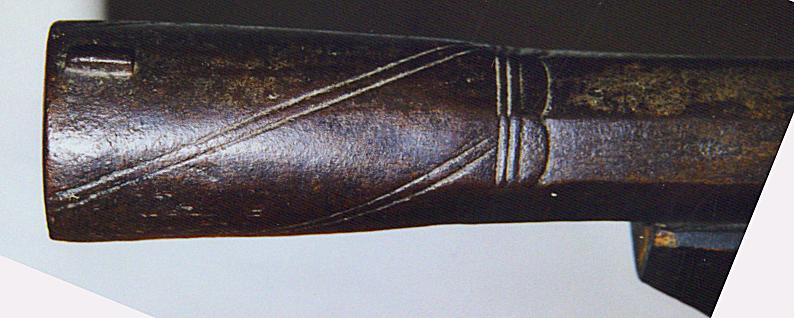

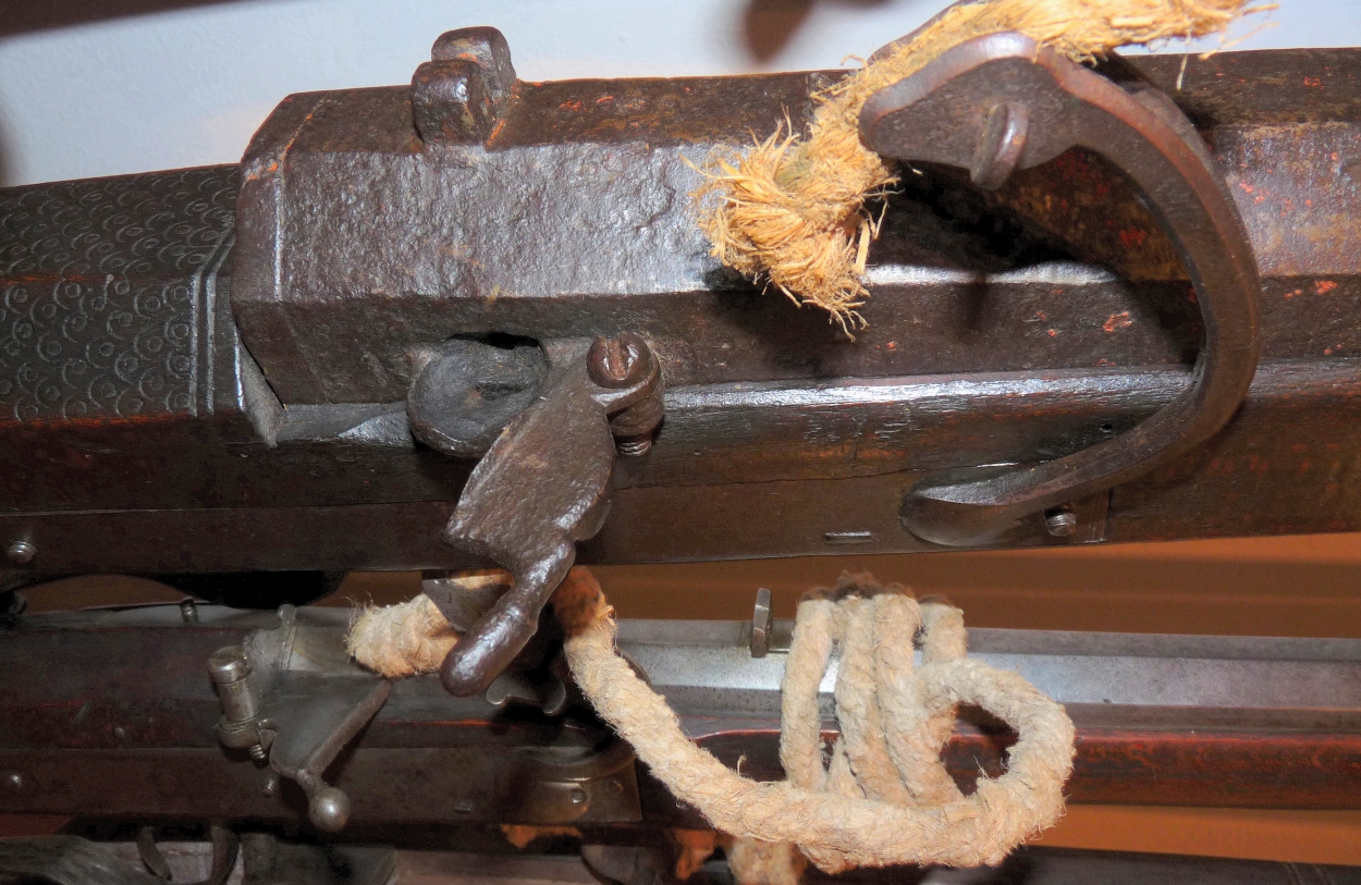

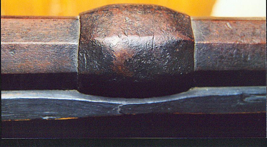

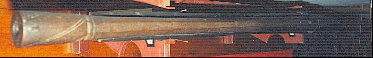

Three more close-ups of the muzzle section.
Author's photos.

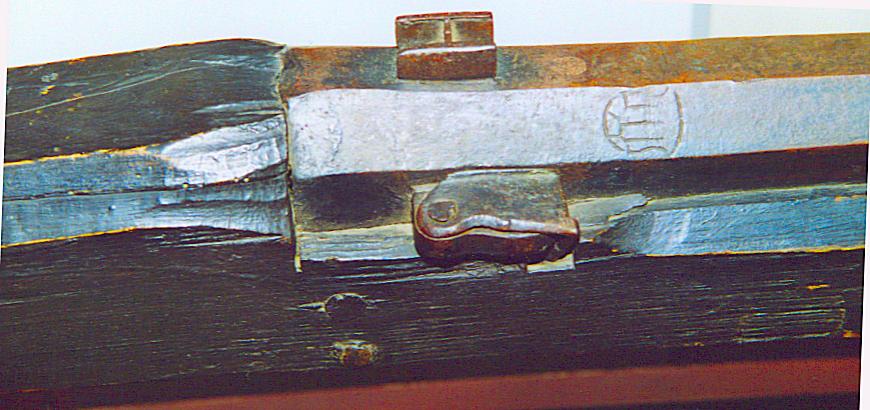

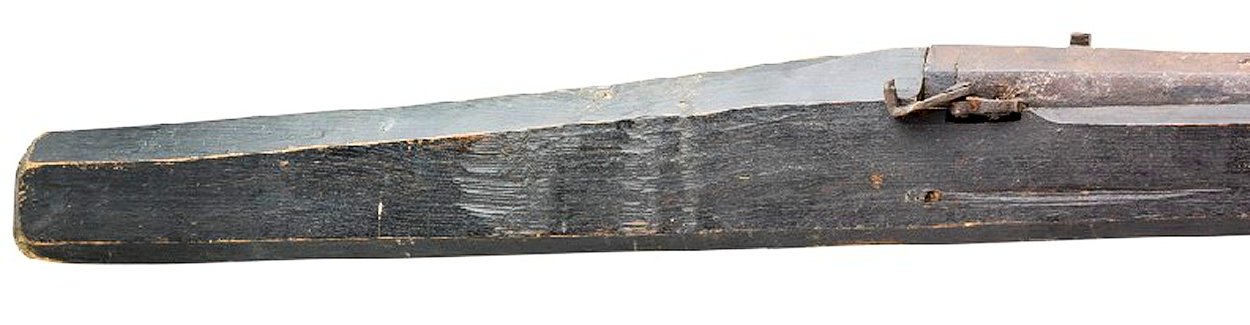

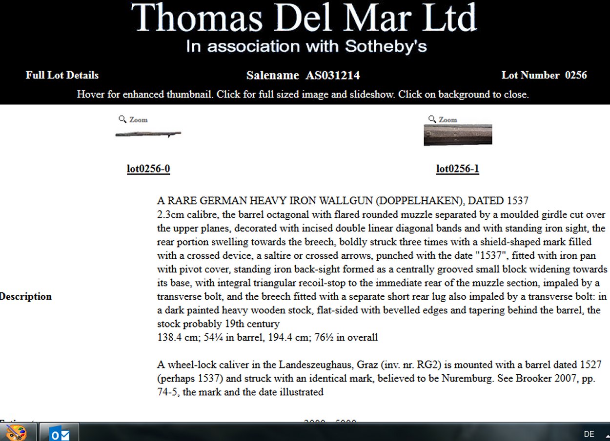

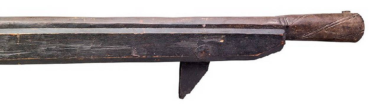

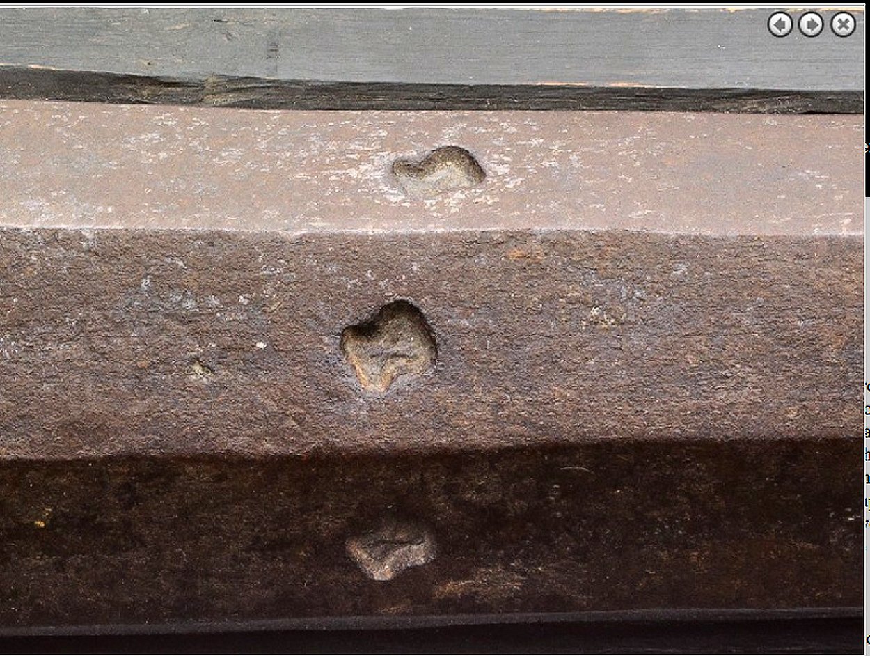

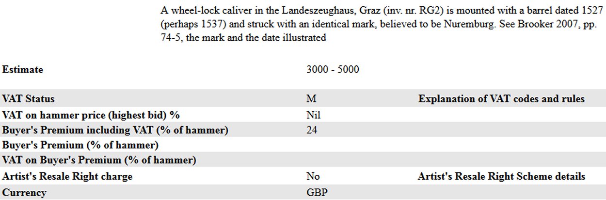

The description and images from Tom Del Mar's catalog.
Old 9th December 2014, 11:37 PM   #94
Matchlock
Matchlock's Avatar
Join Date: Sep 2008
Posts: 4,310

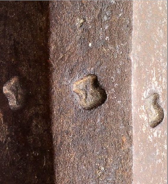

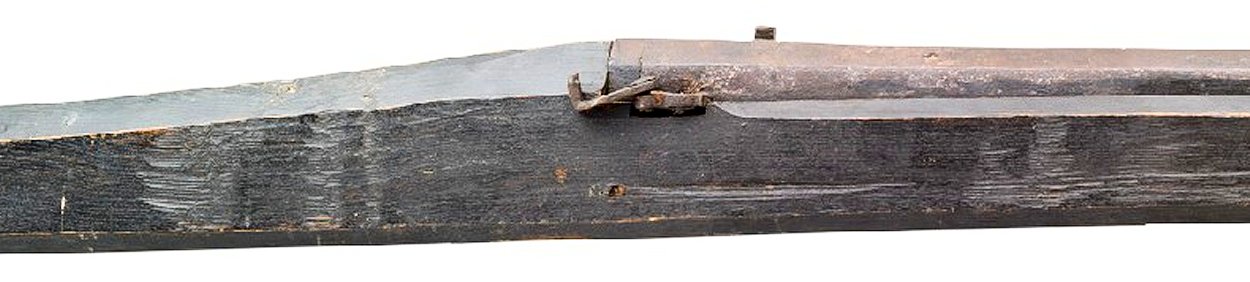

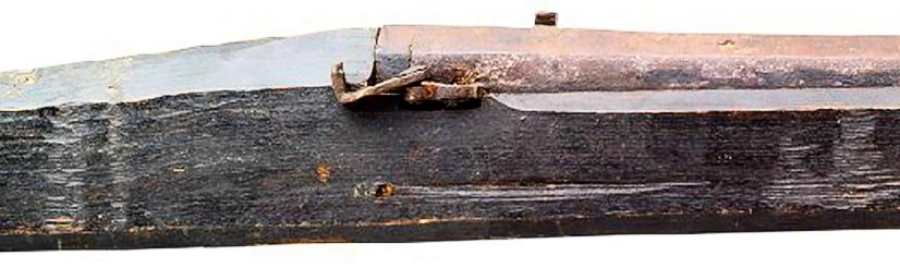

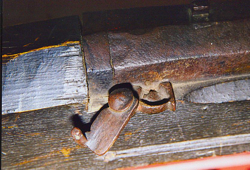

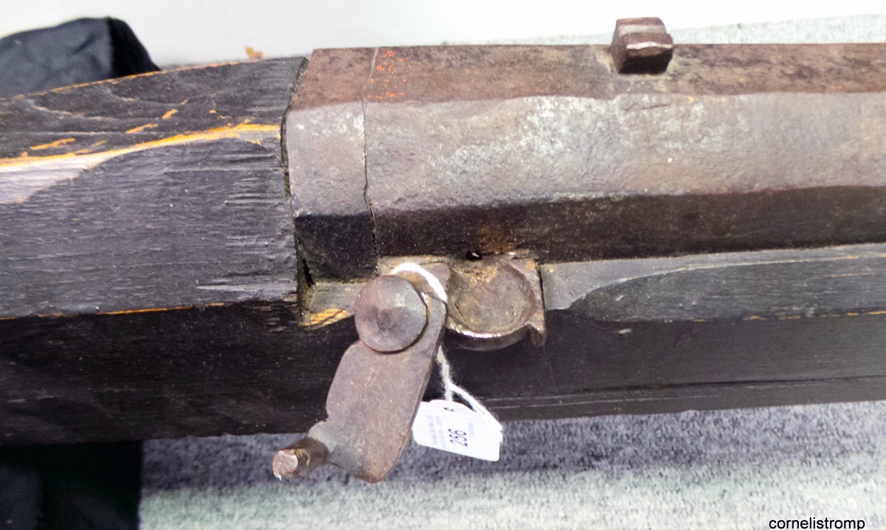

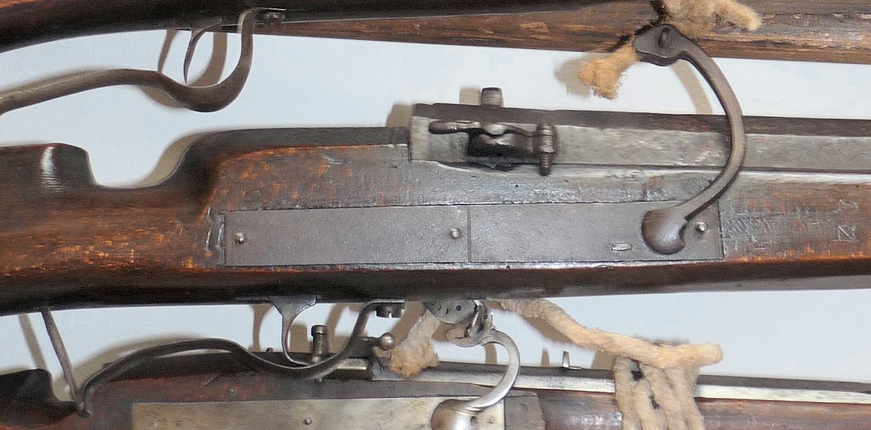

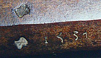

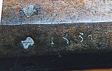

A close comparison of the pan and cover of the Doppelhaken dated 1537 sold at Tom del Mar shows that when the author photographed it, the cover was not yet bent - the way it was by the time of the sale.
First two photos attached copyrighted by the author, the others copyrighted by Thomas Del Mar Ltd.

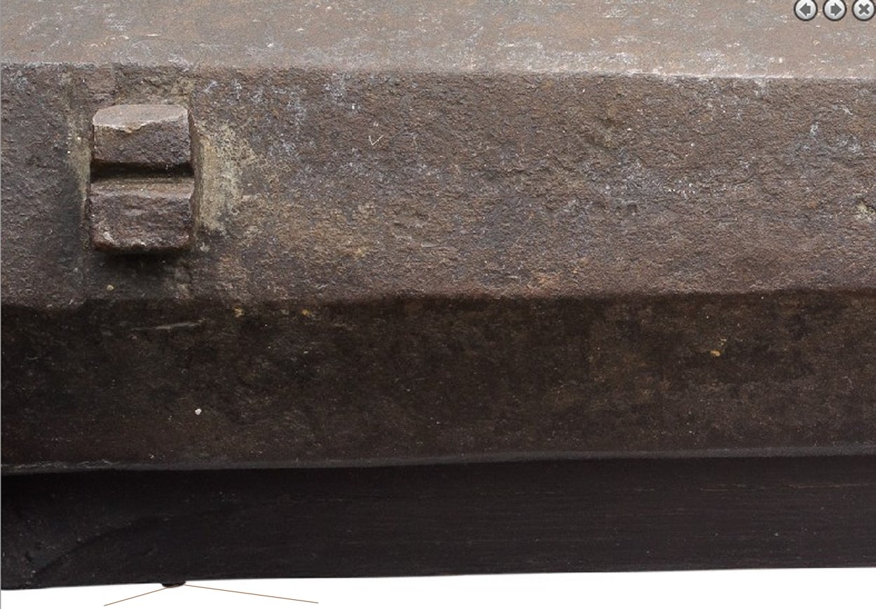

Old 10th December 2014, 07:19 AM   #95
cornelistromp
cornelistromp's Avatar
Join Date: Mar 2009
Posts: 1,071

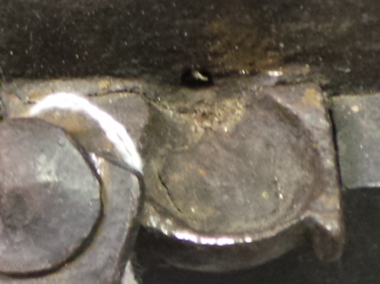

Hi Jasper,
Thanks for posting these!
I will have more on them soon.

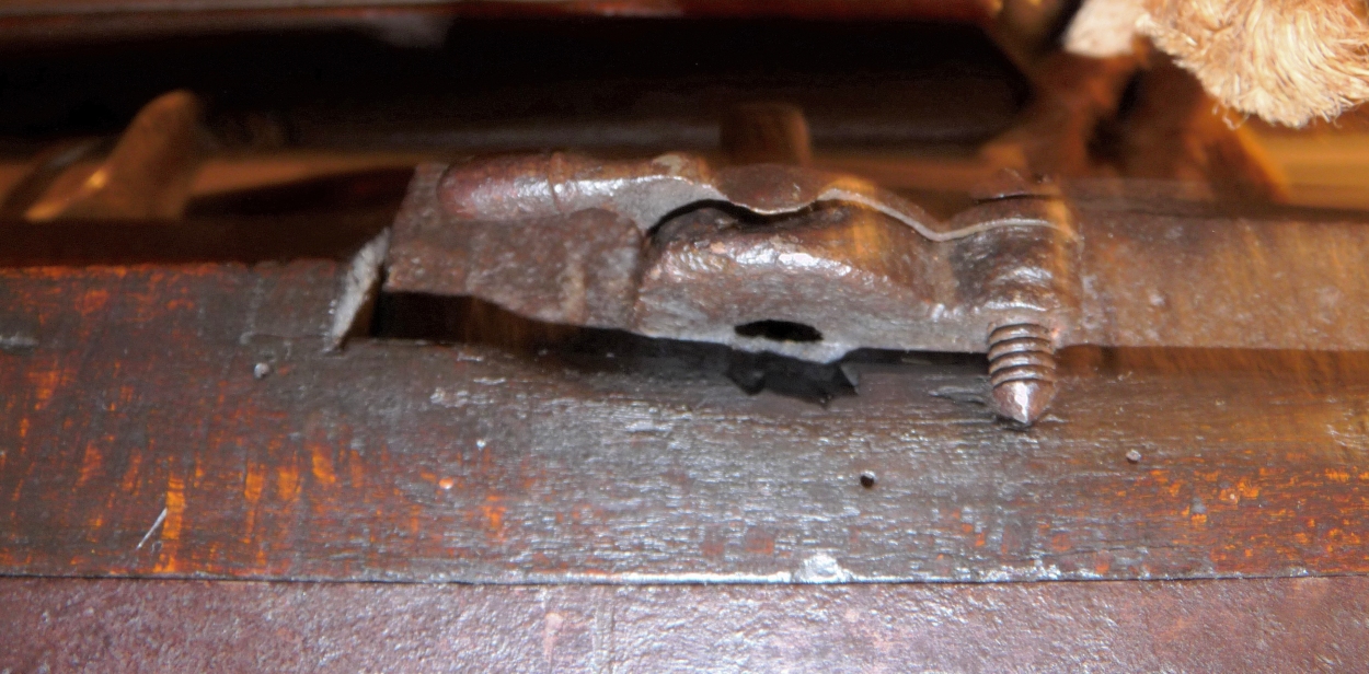

The nail to the rear end of the pan on the wall gun dated 1537 you are refrerring to actually is the head of a rivet, the pivot for the swiveling pan cover.
Hi Michael,
thanks for your explanations and clarifications regarding this very interesting weapons
re: Nail in pan
I did not mean the pivot nail, There is also a similar nail hammered inside the pan you can see it on the picture. Do you maybe know its function?
VBW,
jasper
Old 10th December 2014, 07:41 AM   #96
Marcus den toom
Marcus den toom's Avatar
Location: Netherlands
Posts: 543
I would say this is a working life repair of the igniting pan
After so many shots, the corrosive blackpoder charge would have eaten right trough the quit thinly made pan... and no good can come from a pan with a hole in it.

Thomas del mar 3/12 lot 257, Iron doppelhaken, dated second half of the 16th century.
however due to its simple barrel shape and hook construction is probably earlier. around 1500?
best,
Jasper

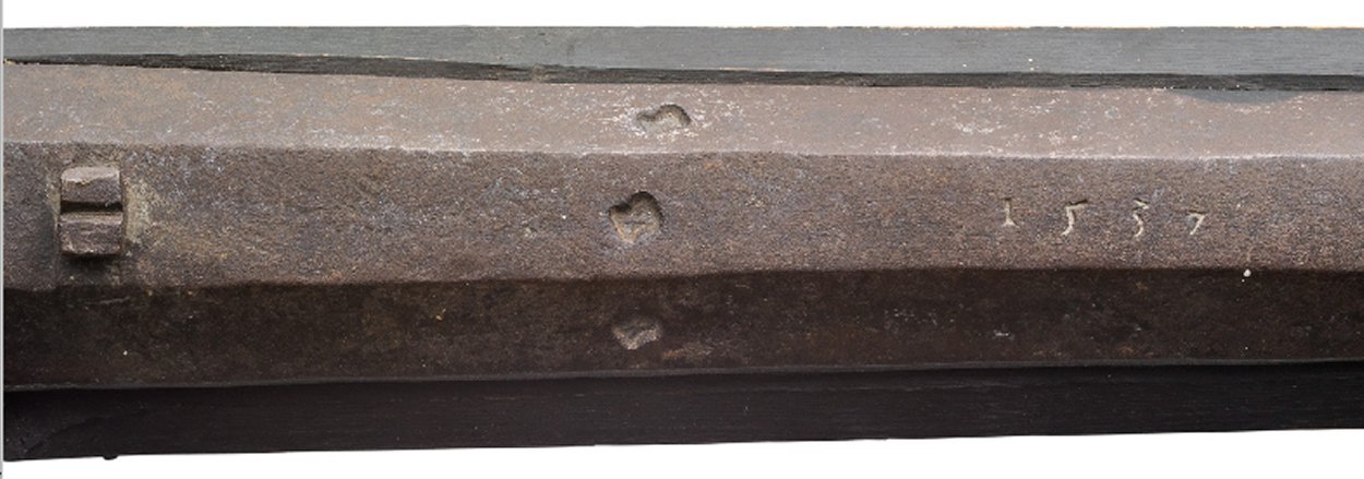

Hi Jasper,
You are absolutely right, that barrel definitely was earlier than the catalog description reads, "second half 16th century".
Sadly, the experts did not note the obvious close relationship between this barrel to the the one dated 1537 - although the two of them lay side by side; still, the former got misdated.
Although not dated, and bearing a different mark, that barrrel shows exactly the same triple sectioning as the one dated, octagonal/round/round, with the very same dimensions, and is equipped with the same kind of pan. Also, the location of the rear sight, though shaped diffrently from that on the 1537 barrel, doubtlessly assigns the piece to the 1530's.
See two last attachments to post #70 and all atts. to post #71 in this thread for a contemporary barrel with the same type of square rear sight.
The only notable formal difference between this and the dated barrel being that the hook of the former is attached by a sturdy iron sleeve. Although this can normally only be observed as a later working time addition to early 15th c. barrels that originally did not have a hook, it was most probably characteristic to the (unidentified) workshop. Another, almost identical piece that still is in the Schloss is wrought exactly the same way, and it doubtlessly retains its original stock, so these hooks cannot be explained by some later working life alteration.
See atts. to follower post.
Due to the formal stylistic criteria set up by the author to enable a closer dating of barrels, this item, too, must have been wrought within a narrow span of time, which isca. 1530-40, and logically it should be correctly identified and dated "Nuremberg, late 1530's", because in 1539, the first Nuremberg barrels were sectioned only twice, with the separating girdle forward of the breech having disappeared:
cf. the barrels of two Nuremberg made Landsknecht's matchlock arquebuses, both struck with the "Crossed Arrows" mark and the date 1539.

In all probability, a small series of those barrels at the Hohenlohe-Langenburg armory were bought from the City of Nuremberg, to which all local workshops had to deliver by contract a certain quantity of their products. The Nuremberg city archive records still hold all the details.

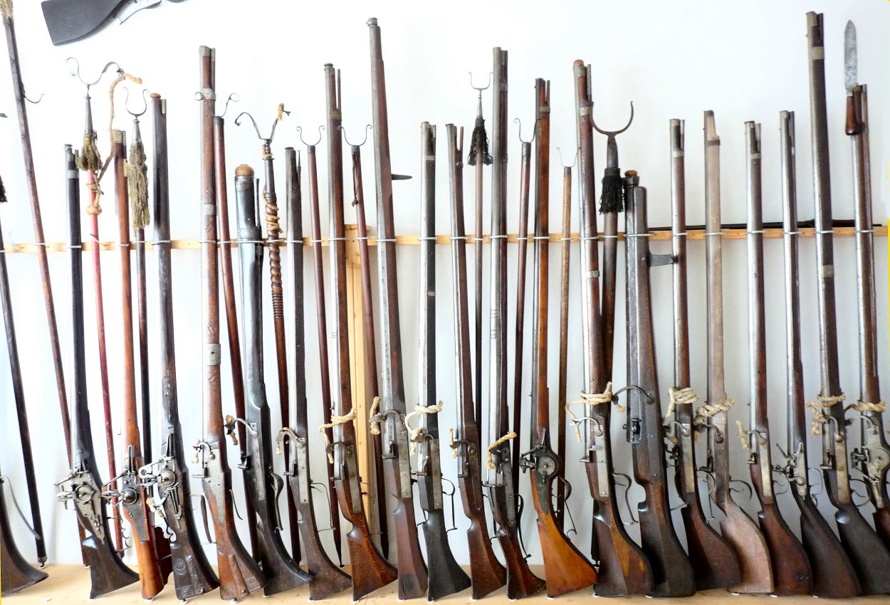

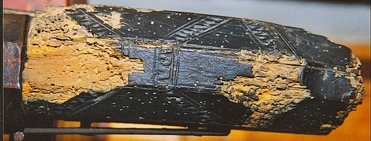

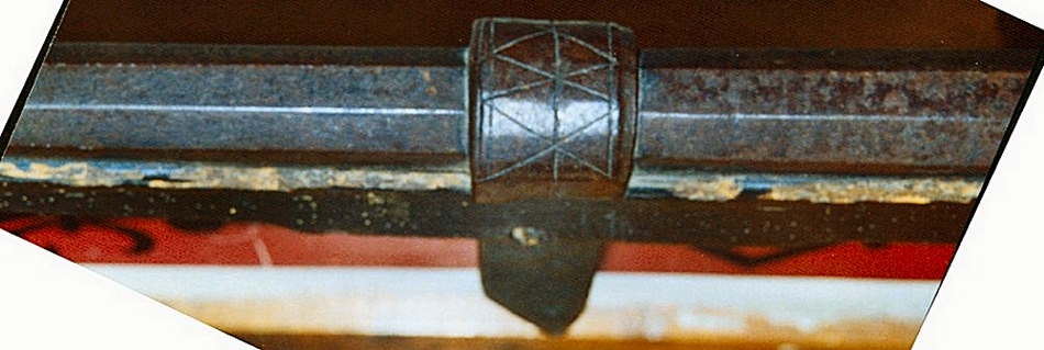

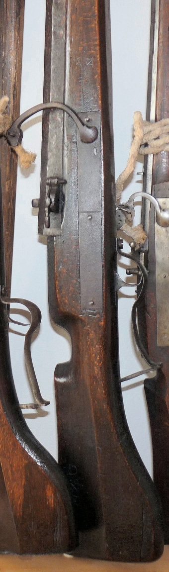

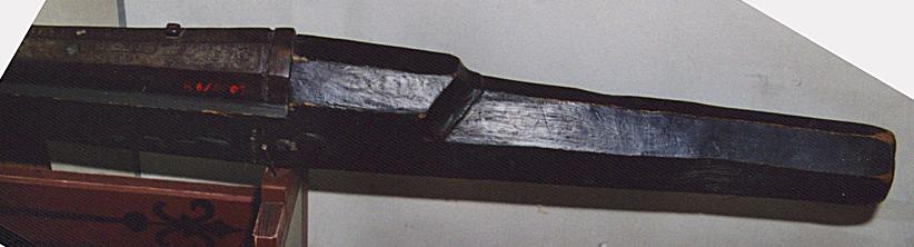

In the exhibition hall, the author photographed three more similar wall pieces, all of them doubtlessly Nuremberg made; they still are in Schloss Hohenlohe-Langenburg:
- one with a cast brass barrel very similar to the sample dated 1525, and contemporary:
see atts. to post #90;
- and two more with wrought iron barrels:
the first almost identical to the one just sold (cf. posts 83f. and 93f.), the wrought iron barrrel also dated 1537 and bearing the same "Crossed Arrows" mark struck three times
and another, the barrel not dated and almost the pair to lot #257 at Thomas Del Mar (cf. posts #84 and 99)
, retaining its original slightly carved stock but in worse condition, the butt stock heavily wormed, damaged and incomplete:
see atts. to this post.

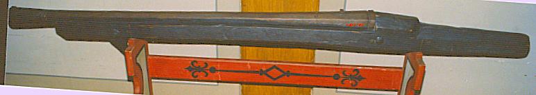

There also remains a breech loading falconet (German: Bockbüchse) mounted on a two-wheel carriage;
please see my thread:
http://www.vikingsword.com/vb/showth...=breechloading

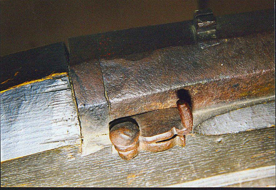

Originally Posted by cornelistromp
Hi Michael,
re: Nail in pan
VBW,
jasper
Hi Jasper,
I'm sorry for not getting the point,
and thanks for pointing me at a small detail I would otherwise have overlooked.
Marcus is absolutely right:
the pan was rusted through, and nailing was the easiest way to fill that hole, just like spiking a burnt-out touch hole.
Rust holes in pans can sometimes be oberserved on 500 year-old haquebut barrels which saw hard service for most of their long working life, especially during the Thirty Years War.
The reason being that those large wall guns were always kept right there in the same place - loaded and primed, and ready to be fired any moment. Thus the bottom of their pans kept rusting heavily from the priming powder they always held, and after centuries, they sometimes failed to hold it any more.

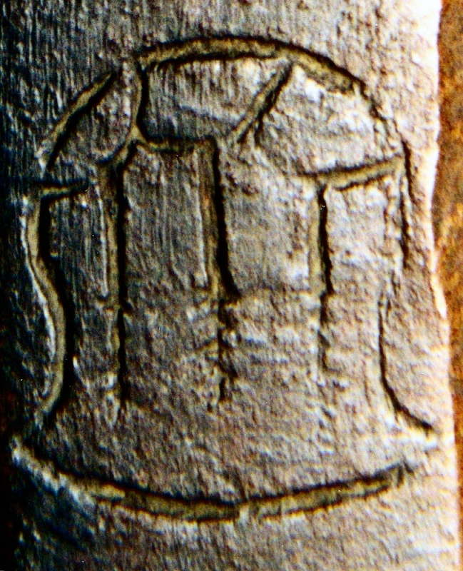

E.g., in the author's collection there is a heavy Late Gothic haquebut barrel that was wrought in ca. 1490 -1500, and restocked with a matchlock at the Regensburg City Arsenal during the 1640's, the most roaring latter years of the Thirty Years War; its pan, too, is rusted through - from holding the priming powder most if the time, and with no oiling done for centuries.
Its beechwood butt stock is branded with the Regensburg City arms, two crossed keys, and the letters ZG for Zeughaus (arsenal).
Photos of that 16 kg monster attached - Marcus, you doubtlessly remember handling it!

Old 3rd January 2015, 01:30 PM   #104
Matchlock
Matchlock's Avatar
Join Date: Sep 2008
Posts: 4,310
For a detailed discussion of that 16 kilogram monster of a matchlock wall gun/haquebut from the former Regensburg City Arsenal, now in The Michael Trömner Collection, please see author's thread:
http://www.vikingsword.com/vb/showthread.php?t=10481
Unfortunately, none of all those photos depicts the rust hole in the priming pan; I will get one, though - I promise!
Finally, here are the images of the pan perforated by rust, due to holding the priming powder for hundreds of years.

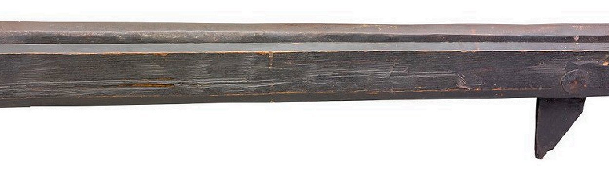

Default Revicing this great thread

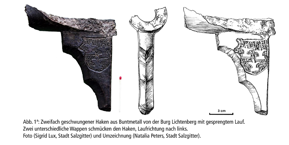

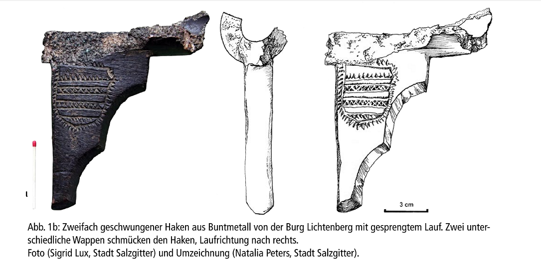

Three pictures, two of a fragmented wall piece, brass from Lichtenberg.
