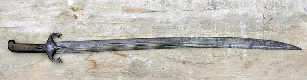

Default Shamshir for comment

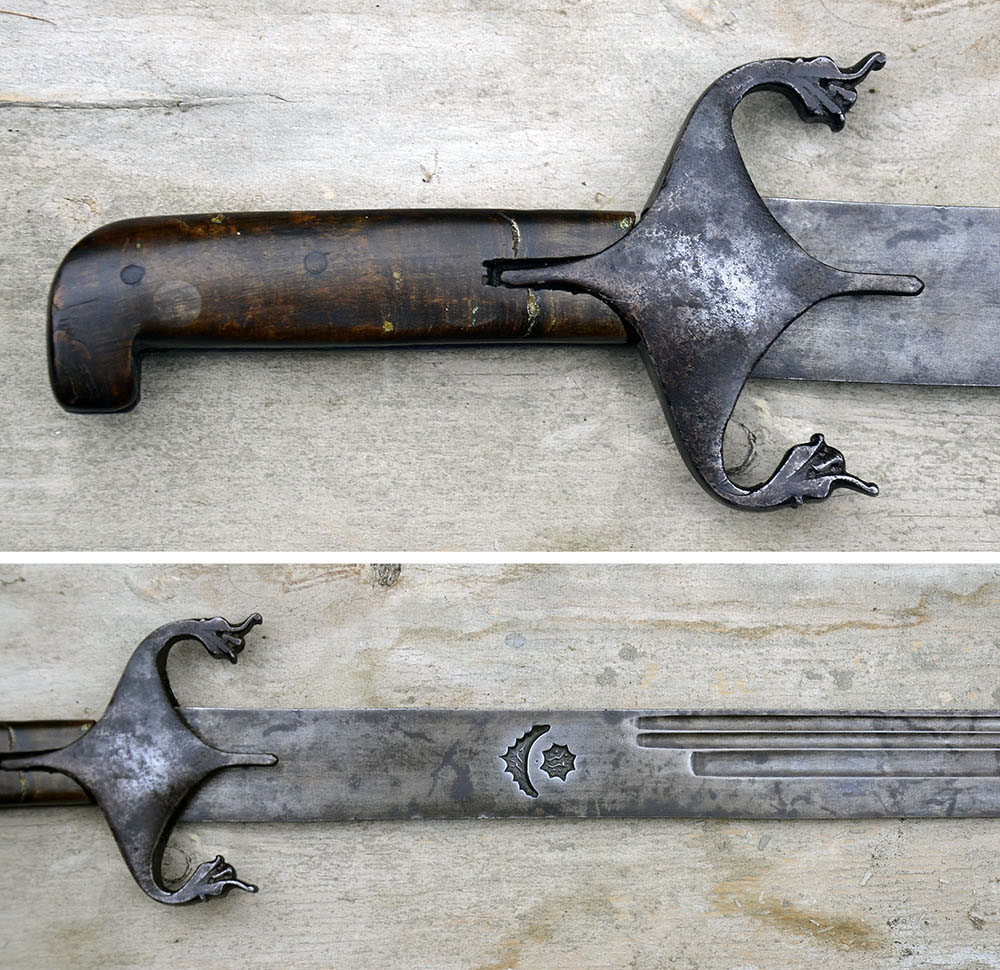

After a google search I presume it is a shamshir and turkish
The cross-guard is different than most I see on the web.
96 cm long.
I would appreciate your comments about the origin and age.
The cross-guard is loose, is there a way to fix it?

Oliver Pinchot
Join Date: Sep 2012
Posts: 468
It's hard to say where this sword is actually from because it's a combination of parts. The blade is good Caucasian work, probably made in Tbilisi c. 1850. The guard is Persian, and considerably earlier; this type with recurved quillons is rare. The grips are more or less recent. It was probably assembled for use in the early 20th century.

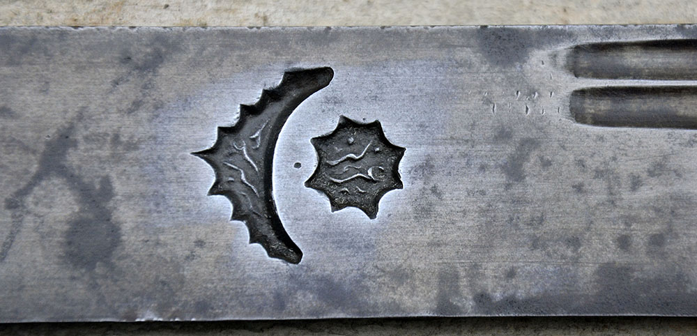

Dear Oliver,
Are you sure that the blade is Caucasian?
I have a Persian Qadara with the same stamps...
The blade looks Persian for me.

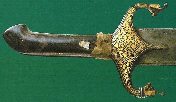

Found this picture on the net, similar guard.
shamshir-nader-shah-afsharid-dr-khorasani

might be due to shrinkage of the wood grip scales. you could try soaking the hilt in linseed oil to swell it a bit, as long as the scales are not also attached with an oil soluble glue; that might however let you disassemble the hilt easier & tighten it back on cleaning and re-assembling it. injecting a modern filler like epoxy steel into the gap is likely to be frowned on & reduce it's value. a big blob of goop like the last photo would also not be a good idea. some middle eastern swords have that area wound with wire, which might be something to try first. it at least will not be a permanent repair that might lessen the item's value.
adding a pin thru the guard like that thru gold koftgari is also not a good career move. i do note in my photo above there was some sort of glue, possibly cutler's cement under the wire which came thru a bit. might even be silver solder. not my weapon.
this one shows the outline of the guard grip languet under the wire a bit better.
i recall someone posted instructions on reconstructing a turkish hilt here somewhere that might help.

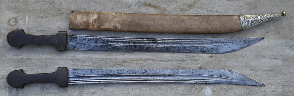

Voila
Very similar...

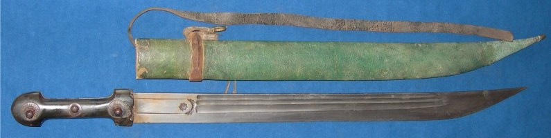

Congoblades
Congoblades's Avatar
Location: Belgium
Posts: 171

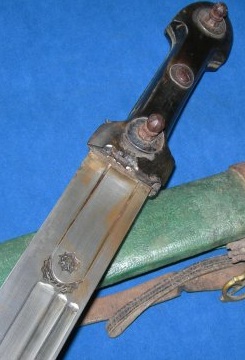

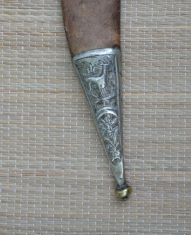

Have also this one, similar fullers as the sword. Will probably be of the same region. The decoration on the tip of the sheath is a bit strange. Looks more like german or austrian??
Congoblades is offline   Reply With Quote

The lion with the sword or the gazelle on your scabbard are pure Persian motives.
For me, your sword is Persian from A to Z.
