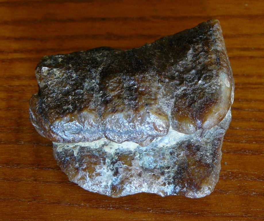

This subject was raised in another thread and I got some interesting information from my Javanese friend from Yogyakarta who trades this materials and I would like to share it with you in order to stimulate the discussion:
According to him, there are 2 types of fossil elephant/mamoouth molar, namely the hard one and the soft one, and only the soft type can be used for making kris hilts or warangkas. One possible interpretation (uncontrolled opinion only) could be that the hard fossil type is older than the soft one due to mineralization?
Also according to him the materials comes from Sumatra (from fossil or more recently dead elephants?) and since recently also from Russia (Siberia) where a lot of frozen mamooths can be found (not fossil ones since they were perfectly preserved under the ice or frozen ground). The Russian molar materials is worked in Bali especially.

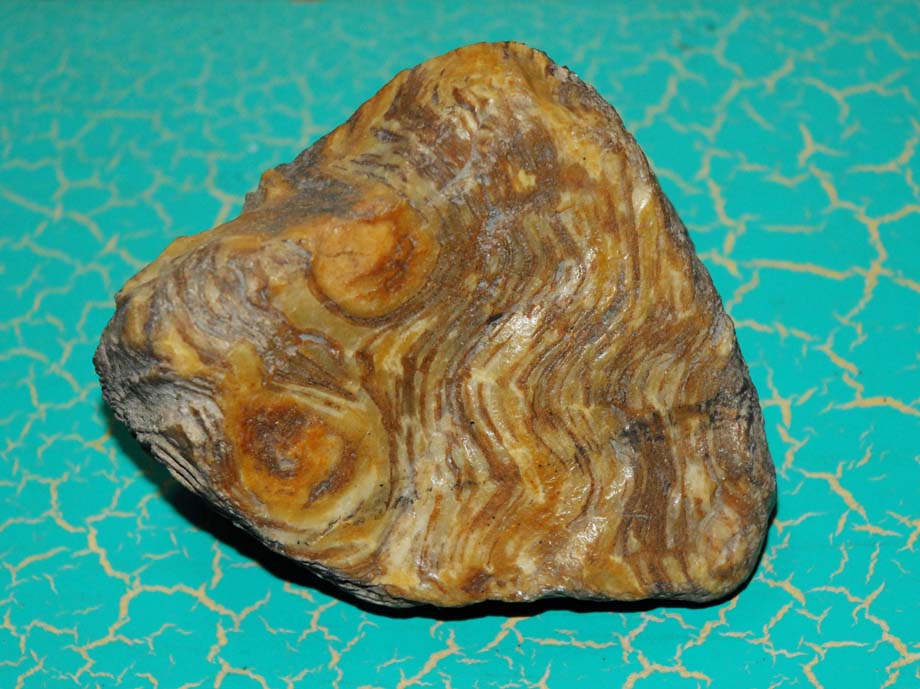

I attach a picture of the raw material, which has a yellowish colour with white and darker stripes, and a sample of a finished Javanese hilt & warangka. In order to enhance the colour contrast, some traders dye the pieces by dipping it into a potassium permanganate solution which has a purple colour. Upon contact with air, the unstable permanganate compound is chemically reduced to manganese oxide which has a brown colour and is stable. I attach a picture of such a dyed piece, so the difference in colour between some pieces would not be due to their age as I wrongly said earlier but to a dying treatment.
I personally wonder whether these pieces are actually fossil ones or not, or may be both?

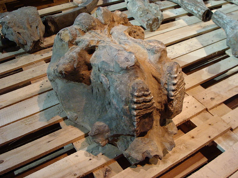

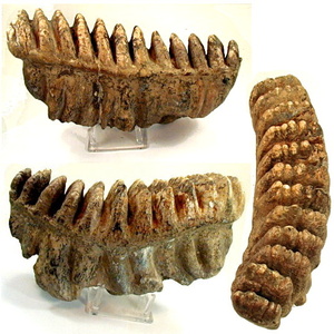

THE FOSSIL TEETH I SAW BEING USED IN BALI AND ELSEWHERE WERE SAID TO HAVE COME FROM JAVA. IT WAS MORE STABLE THAN TEETH I HAVE SEEN COMMING FROM MANY OTHER LOCATIONS. THE ONE FROM JAVA WAS THE TOOTH OF A STEGODON A TYPE OF MASTODON. MAMMOTH, MASTODON AND EXTINCT ELEPHANT FOSSILS ARE WIDESPREAD I EVEN FIND THEM HERE WHERE I LIVE. THE TUSKS AND TEETH HERE ARE BRITTLE AND NOT SUITABLE FOR MUCH. THE ENAMEL ON THE TEETH COULD BE USED FOR TAILSMAN OR JEWLRY BUT NOT FOR A KERIS HANDLE.
PICTURE OF PARTIAL SKULL OF STEGODON TRIGONOCEPHALUS
AND 3 PICTURES OF A SINGLE STEGODON TOOTH FROM JAVA MEASURES 10.5 X 5.5 X 3 INCHES. ITS THE KIND I SAW BEING CARVED IN BALI.

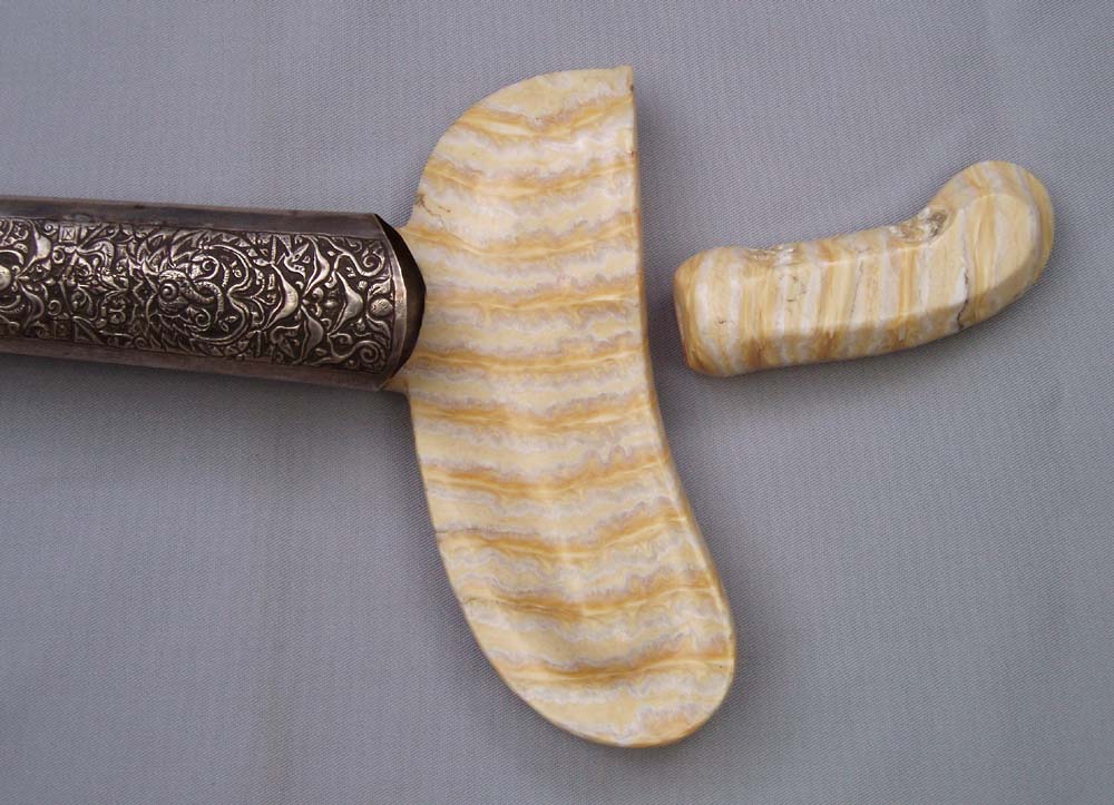

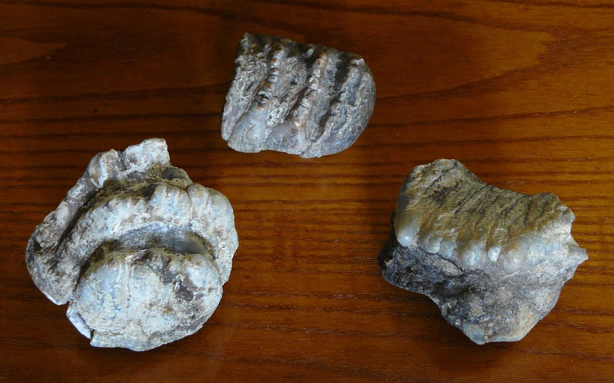

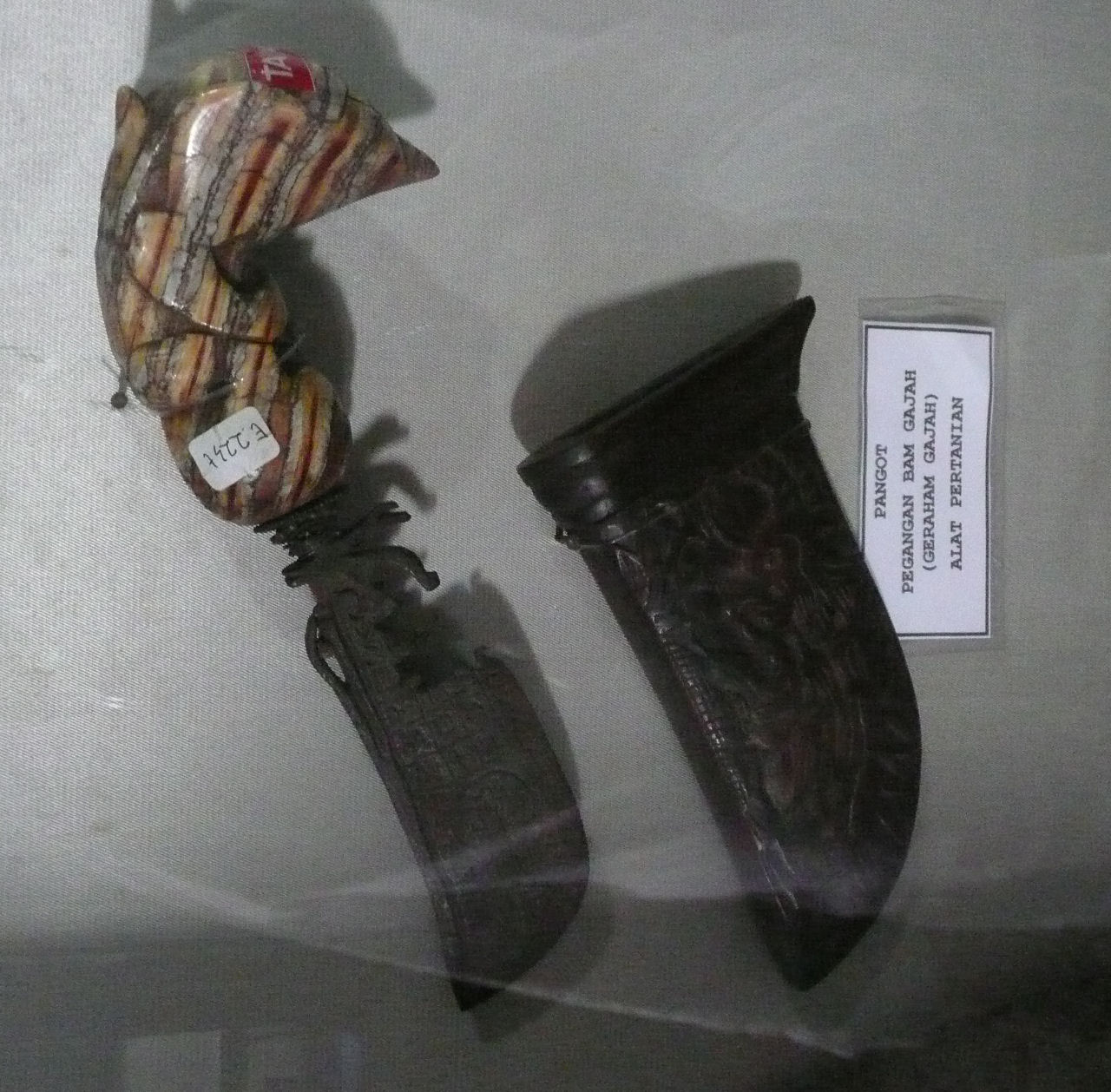

I attach pictures of fossil teeth which I got in Sangiran (near Solo) some 15 years ago, they are too small for making a hilt and may not come from a mammoth at all. I think that this site was extensively excavated and is highly controlled so I doubt that fossil teeth are still available from this location and used for making artefacts, but it was probably the case in the past.

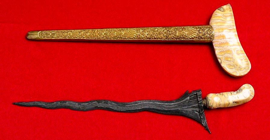

I attach a picture of a Jogja kris in my collection with the hilt & waranga made from elephant molar (from Sumatra?), I bought it 5 years ago and the materials is still strong, as I said I think that it may not be that old so the organic binder in the tooth is still present and avoids it to be too brittle.

There is still a lot of material coming out of Sangiran, Jean. Possibly not from the regulated areas, but every time there is heavy rain fossils are uncovered, and when the creeks and rivers running through the area rise, they uncover fossils in the creek banks, which the local people harvest as soon as the water level drops. Its all highly illegal of course, but like most things illegal, its only illegal if you get caught.You've only got to walk around the local markets to see evidence of what is found.

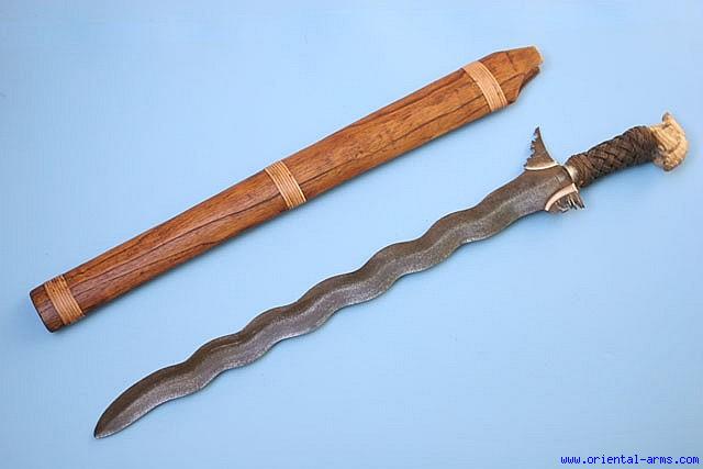

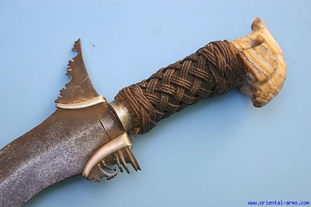

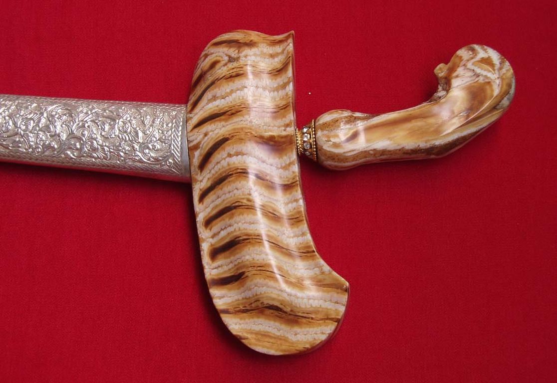

THE 3 KERIS PICTURED ARE RECENT BUT I HAVE SEEN A FEW EXAMPLES IN OLD POSTS ON THE FORUM THAT SEEMED TO HAVE MORE AGE. I HAVE SEEN IT USED ON SOME PHILIPPINE WEAPONS AS WELL BUT IT IS MORE RARE. SO I WOULDN'T JUMP TO THE CONCLUSION THAT ALL ARE RECENTLY MADE.
THESE STEGODON FOSSILS WOULD BE AT LEAST 11 THOUSAND YEARS OLD AND MOST LIKELY OLDER AS THE MAMOTH AND MASTADON BECAME EXTINT AROUND THEN.
I CAN'T IDENTIFY THE MATERIAL IN THE FIRST PICTURE BUT THE MATERIAL USED ON THE KERIS AND THE 3 FRAGMENTS APPEAR TO BE FROM THE SPECIES OF STEGODON FOUND IN JAVA. THERE HAS BEEN INTREST IN FOSSIL TEETH SINCE ANCIENT TIMES SO IT IS VERY LIKELY TO HAVE BEEN USED. SUCH TEETH HAVE BEEN REFERRED TO AS DRAGONS TEETH AND MAGICAL POWERS ATTRIBUTED TO THEM AND HAVE BEEN USED IN MEDICINE AND AS TAILSMAN FOR A VERY LONG TIME.
SO USE ON ANCIENT WEAPONS IS A POSSIBILITY WHERE STABLE MATERIAL COULD BE FOUND. I COULD ONLY FIND ONE PICTURE OF A MORO SWORD USING IT AS A POMMEL.
THE PATTERN IN THE STONE IS DETERMINED BY THE DIRECTION IT IS CUT IN. I HAVE A SQUARE BLOCK OF JAVA STEGODON AND THE PATTERN IS DIFFERENT ON ALL 6 SIDES, SO THERE CAN BE QUITE A LOT OF VARIATION EVEN IN ONE TOOTH. THERE ARE MANY OTHER KINDS OF FOSSIL ELEPHANT TEETH AS WELL AS TITANOTHERE AND OTHERS SO THERE ARE A LOT OF VARIATIONS POSSIBLE. BUT FINDING GOOD STABLE MATERIAL IS A PROBLEM. MOST OF THE FOSSIL IVORY CARVED IN BALI INTO PENDANTS ECT. ARE FROM SIBERIA OR ALASKA MOSTLY MAMMOTH TUSK IS USED.

Hi! everyone
the mollar handle from the Radya Pustaka Museum in Solo, Jawa, Alan was talking about.
