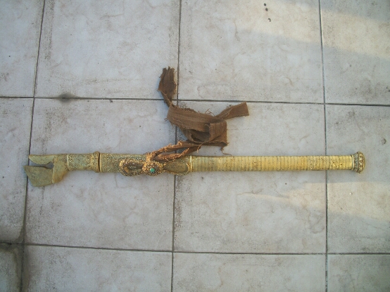

i presenting the pic of an old bugis alameng
in gold ,diamonds and emerald
a very rare blade and very good condition of scabard and hilt
any comments are welcom
Cheers ,
ganja iras

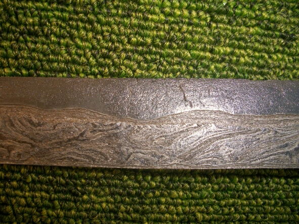

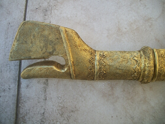

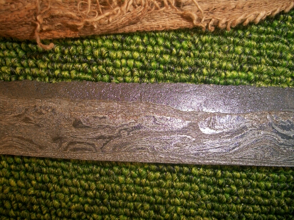

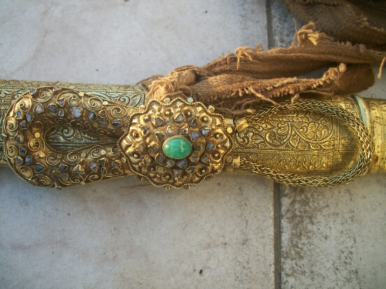

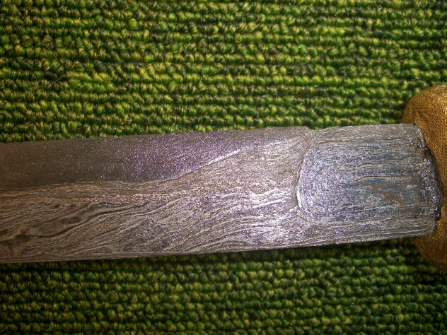

dear folks ,
here some more pic's of the Alameng and that the best i can do...sorry..
kind regards ,
ganja iras
Ganja Iras is offline   Reply With Quote
Old 25th August 2014, 09:07 PM   #9
Posts: 5,854
It has a rather rough look for goldsmiths work? Have you tested the metal with the correct acids?

Thanks for the close ups.
It's interesting that it has several quite unique features compared to those found in old pictures and collections.
Does your friend know anything more about it?
Does it have any provenance?
