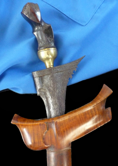

Default Palembang Pendokok
Close ups of the Palembang pendokoks, as requested by Detlef...

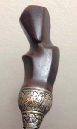

Default Palembang Hilt and Sheath....
Dear Klungkung,
Just to remind again, that we had a long discussion about Palembang keris in this warung in the past. Just to complete the discussion of the topics raised by our pal, Klungkung ....
Ganjawulung

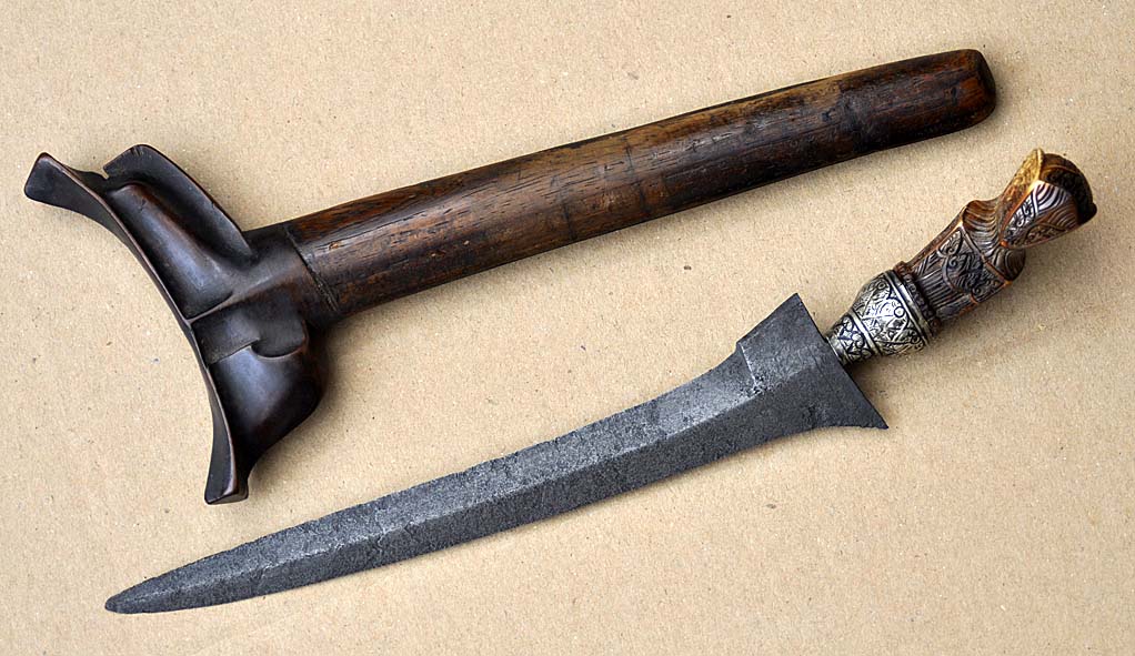

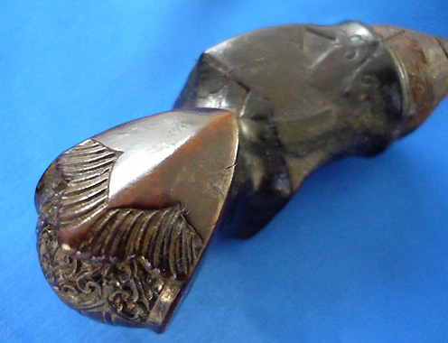

Dear all,
Shocking pics about a damaged DURGA handle (never saw a similar with carvings, only the 'bare' ones !) after I tried to free it from the peksi with the heating method but I new I could not avoid it as the handle already had a severe lengthwise crack. After it got off I saw it was once repaired already with glue and 1 single nail!
I restored it the best I could with wood putty. The blade shipped to Java for cleaning as it has promising pamor.

Default Lampung hilt....
Gosh,
Rarely seen Lampung keris handle has carved like that, Klungkung. Really have not seen before, a "putri malu" hilt (according to local people) such as this. Nice. Unfortunately, it cracked and broke down. But the fact that the damage can be repaired carefully, in order to recover such as never broke.
I happen to also have, Lampung carved keris handles. Even more fully carved, and the material is made of old ivory. It's just about the size of a patrem....

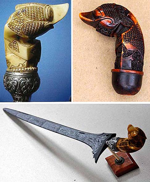

Default Putri Malu
Dear Jean and Sajen,
Yes, I also happened to ask this at friends in a facebook group, Sumatra group on keris and tosan aji. Friends of Palembang and Lampung, both confirmed this kind of hilt as "putri malu". And I happened to know any better, a native who is preparing a book on Lampung keris. He also confirmed this name of hilt as "putri malu"...
This specimen below, is according to him Lahat style of "putri malu". More "twisted" and has a specific form of "triangular" face. That's Lahat to him. (He was born in Lampung, and still finishing his book on Lampung Keris. Hopefully in the near future....)

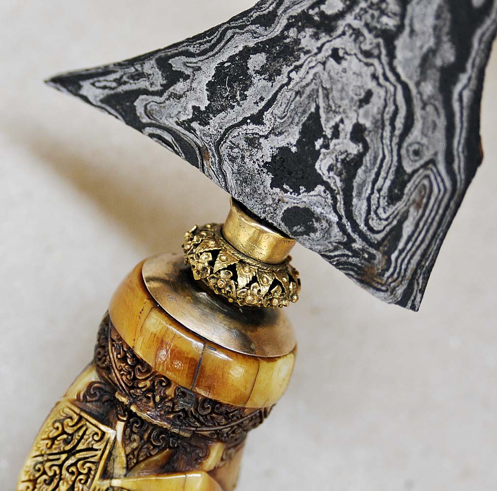

Default Palembang Patrem
Dear Gustav and Jean,
Thank you Gustav, to remind my old post. At that time I was still searching for the name of that "Batman-like" hilt. Lately I just know, that people in Southern Sumatra used to call it "Putri Malu" (Shy Princess).
Jean, as in-reposting by Gustav, such that the appearance of my Palembang patrem (my Lampung friend even said it as "lampung patrem"), measuring only 20 cm.
Ganjawulung

Pak Ganja and Gustav,
Thanks for the clearer pic. The blade is very rustic (no pamor, simple shape, ganja iras) as compared to the typical blades from the area. Also the sampir has a different and less elegant shape than the Palembang ones ("rudder" and notch at the back especially).
To my knowledge the standard krisses from Lampung are quite similar to the Palembang ones except the hilt, so are these features specific to one area in Lampung or these krisses made for specific persons? I have another kris patrem (blade 22 cm long) from South Sumatra with a putri malu hilt also but the blade is rather in bahari style.
Best regards

Default Hulu "luday"...
Dear Jean, Gustav, Sajen and Loedjoe,
One more example of a Lampung keris hilt, they commonly refer to as "hulu luday" (luday hilt). Not only on the keris hilt alone, there are ornaments of "luday" or a kind of snake - which, according to Lampung traditional belief - just living only in the deep river bottom. But also be decorated in traditional houses of Lampung poles. It is small serpent, but according to the myth, can turn into a big snake. Some call it, "luday" is the origin of symbolization "local naga" of Sumatra.
Magical creatures "luday" also exist in Palembang keris hilts. At first glance a bird-like figure. But actually it is snake figure. May be differed from the description of the creature's eyes.
Ganjawulung

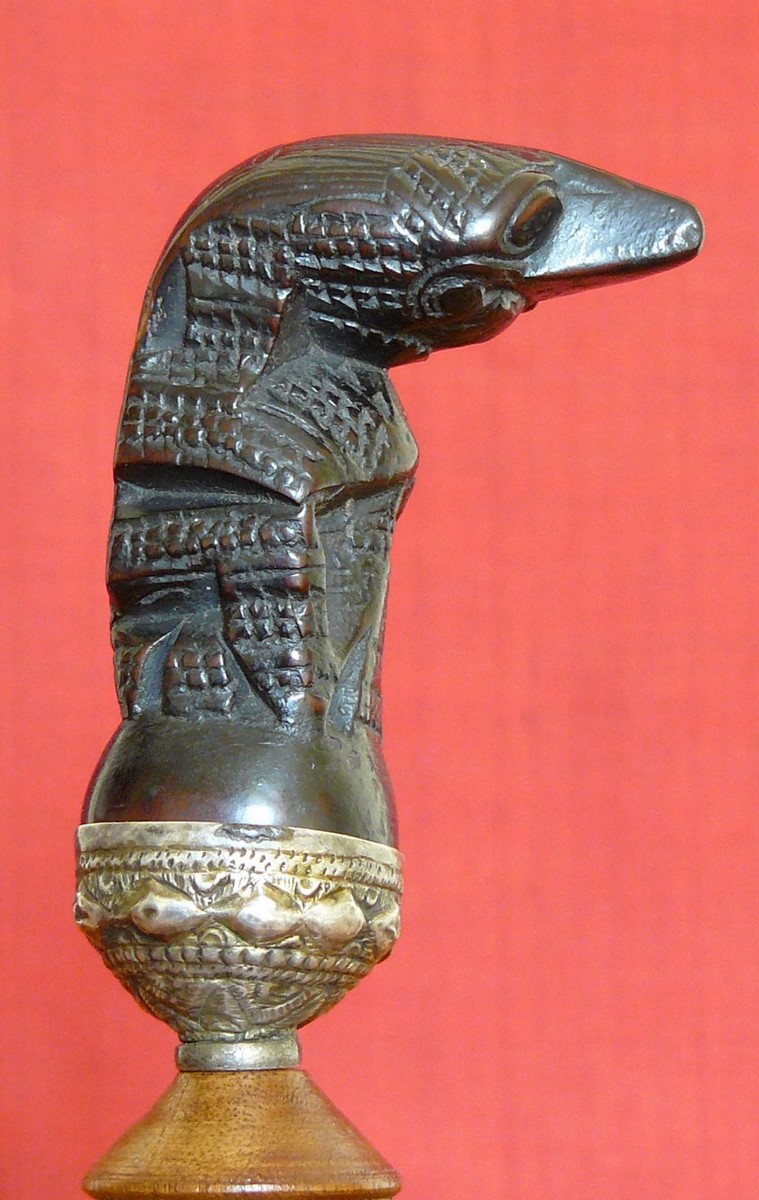

Thank you, Jean, for the correction. You are correct, that the "wearing crested" hilt is called "hulu burung", a Palembang hilt. Not "hulu luday" from Lampung or serpent hilt. The non-crested hilt, it is called " hulu luday". I've asked my Palembang friend, and he said the Palembang one is simply called "hulu burung". While it is true that "hulu luday" is Lampung hilt.
The difference that can be observed from the second hilt, in addition to the crested, also in his eyes. That "hulu luday" is more like a serpent's eyes, rather than a bird's eye ....
Once again, thank you for the correction. Hopefully Shahrial Alamshah will add more information on this Palembang and Lampung hilts...
