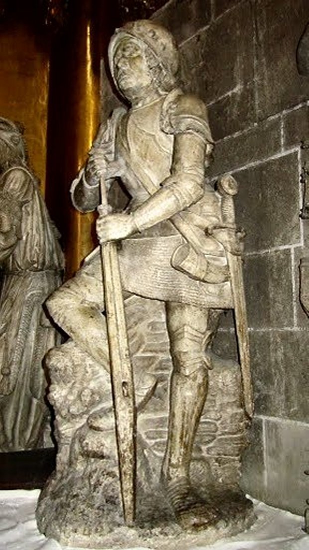

On an internet site for private photo sharing, I found the attached images of a stone sculpture representing an arquebusier with his arquebus and octagonally shaped powder horn, dated early 16th century and labeled to be part of a cathedral in Chartreuse, France.
The web, however, does not identify such a city, just a French mountain range of that name.
