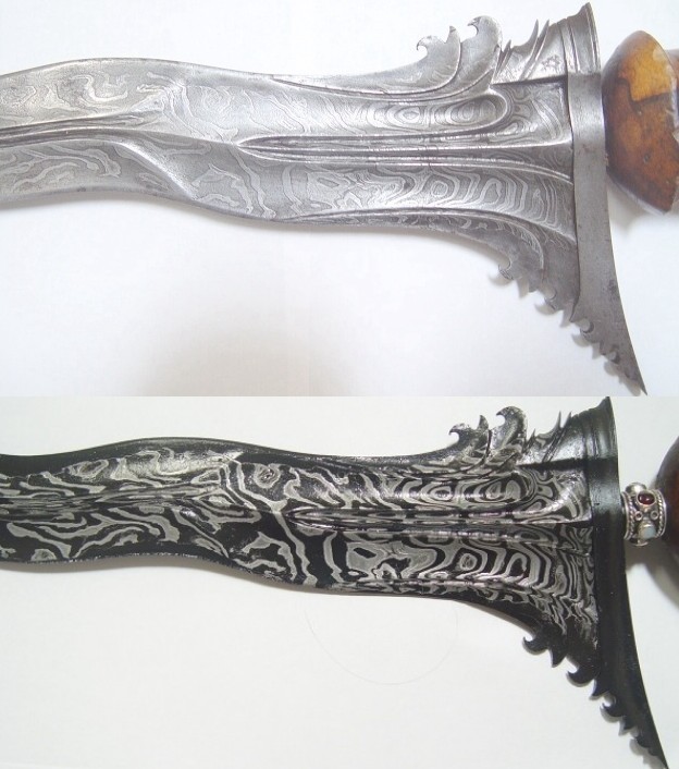

I have noticed also that modern keris are silver in colour first and then dyed black to bring up the pamor whilst old keris used a dark Iron which contrasted with the pamor. The thing is that if you sharpen a dyed keris the dye will rub off revealing the silver metal underneath and you will need to dye it again. As far as I know old keris had black Iron so even if you sharpen it the keris will still be black at the edge because it was the Iron it was made from which was black not a coating of black dye. I have to say I don’t like these modern dyed blades.

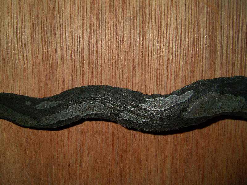

Below is an example of the results of a few hundred years of washing ; the parallel lines running down the blade are strands of the base iron .

Why is the Iron black?? if you look at a modern keris like the one I seen on this forum (bellow) it is silver as we would expect since it is steel but my old keris is black like the one in your photo but it is not dye, the Iron is black

In modern times which keris workers are able to produce a keris using meteorite Iron? I know it is difficult so most keris workers dont have this skill but which ones have.
Pusaka is offline   Reply With Quote
Old 14th November 2005, 10:19 PM   #23
Kiai Carita
Posts: 91
Pusaka, up till WWII people still sold meteorite in the markets of the cities. All keris craftsmen would be able to make keris using meteorite. Making a keris is difficult and even in the modern times most of the technical, material, aspects of keris making are the same as the way the ancient Mpu used to work, the difference being mosty in the spiritual work. I suggest go to Aeng Tong Tong and you will be able to see a village full of keris makers.
Mans, who posts on this forum regularly goes there and knows many of these craftsmen. Some consistently produce good work and do not cut corners and live straight lives and although they are not recognized as Mpu they argueably could be called Mpu just for their service of keeping quality keris making skills alive. The Solo art academy also has people who have interest in making keris. The problem is making keris is a long process and the market is small. You can buy a regular quality old keris for less than the price of a new well made one. Alot of people prefer the old because they think the old has more 'spiritual' powers.
Traditionally you if you go to an Mpu and ask for a keris to be made for you would be asked many things to determine what shape and pamor pattern would be beneficial for you, and when the making should proceed and end, and so on. You could collect meteorite from e-bay and forge it and hammer it clean of impurities...according to Harsrinuksmo's Ensiklopedi Keris, you need between 300-400 grammes of this stuff to make a keris. Then you choose what iron (around 12 - 18 kg depending on the shape of the blade, wavy or straight) and the steel for the centre and sharp edge (around 600 grammes).
As long as you chose a pamor pattern that is categorized as pamor mlumah (lying on it's back) then the difficulties are not that high. If you want a fancy pamor miring (lying on it's side) then it is much more difficult to execute using hammer welding.
By the way, I notice you are cut-and-pasting posts and photos from members of this forum and using the images and member's words in discussion on the martialartsplanet silat forum withough mentioning the source. Is it OK to do this? I am sure there are many keris enthusiasts through silat there that would benefit from joining this knowledgable forum.
Warm salaams to all,
KC

Maybe all keris craftsmen can use meteor material to make keris if they know how to use meteor material.
The truth is that during the last 50 years at least only one keris maker known to use meteor material:- Empu Djeno Harumbrojo.
One other keris maker in Solo make two keris with using pamor material from meteor but that Solo keris maker do not prepare the meteor to be able to use. Somebody not from Indonesia prepare the meteor and give to the Solo keris maker to use for pamor material.
Meteor can be weld if wrap in iron and then weld and wash, but technology with technique that use in Jawa can not make pure meteor pamor material. To make pure pamor material the difficulties very high if the technology to use is the traditional technology of Jawa.

Empu Djeno Harumbrojo is the only person left in Indonesia who can make a meteorite keris ? Im sure that cant be correct, can it??
Old 15th November 2005, 12:05 AM   #28
marto suwignyo
Join Date: Jan 2005
Posts: 52
Visit Yogya, Solo, Madura and Jawa Timur and try to find somebody else who already use meteor.
Somebody who give gaurantee that he can make keris with meteor material.
