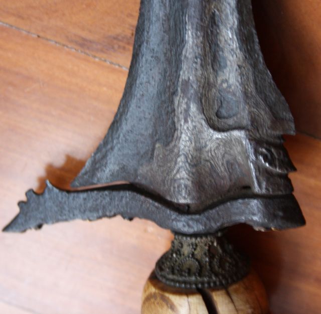

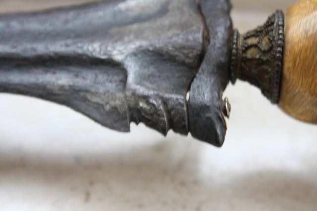

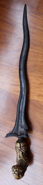

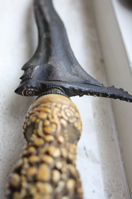

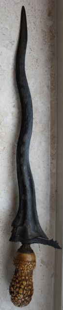

Recently I was able to add this keris to my small collection.
I hope to learn more about it.
I was thinking the form might be megantoro but I was reading this earlier discussion about this form and therefore I am now in doubt.
http://www.vikingsword.com/vb/showth...ight=megantoro
The gonjo does not have the typical curve at the end (excuse me but I do not know the correct name for that) which would be typical for the gonjo wilut I think?
The handle is Madura but I think the blade might be east Java?
Hope to hear your opinions and learn.
Many thanks in advance, Erik

Hello Erik,
This old blade has 5 waves so IMO the dapur is not Megantara nor any of the established dapur types in Central Java.

Hello Erik,
I have no clear idea but my personal guess would rather be an old javanese village or trade blade but other opinions are welcome

a) is there an specific/established dapur for this kerisform (and if so what is it)?
b) has the end curve of the ganja wilut broken of or would this be part of the dapur?
b) an estimation of tangguh
Best regards, Erik

Posts: 7,255
a) --- There is no comparable dhapur in the Surakarta Pakem, but that does not mean that this was not a legitimate dhapur at the time it was made and in the place where it was made
b) --- This keris is very badly eroded, we can only guess at what might have been there before time stole it. I don't like guessing all that much.
c) --- I cannot classify this keris from photos. It has elements that suggest East Jawa, but "East Jawa" is not a recognised tangguh. Erik, something that has been forgotten about tangguh is this:- it arose to fulfill a societal need and it was originally intended to apply only to very high quality keris in very good condition:- keris of investment quality. For a long time now that has not been the case, everybody wants to slap a tangguh on every keris they see. I do not agree with this approach and prefer not to get involved with it.
