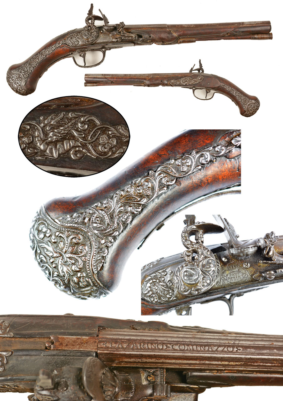

Salaams all ~ Lazarino Kominazzo was a great 17thC. master gun maker... see http://transantique.com/articles/view/id/365/ for a short rendition by Catoire de Bionkur ..
All quite puzzling since they both appear to be the same person and when you realize that between 1600 and 1635 it was quite common for signatures to be forged. In fact the master gun making house of Cominazzo hardly did any complete weapons but focused on gun barrels thus it is hardly surprising that in putting together a weapon from bought in Cominazzo parts that the signature was copied...
Ibrahiim al Balooshi.

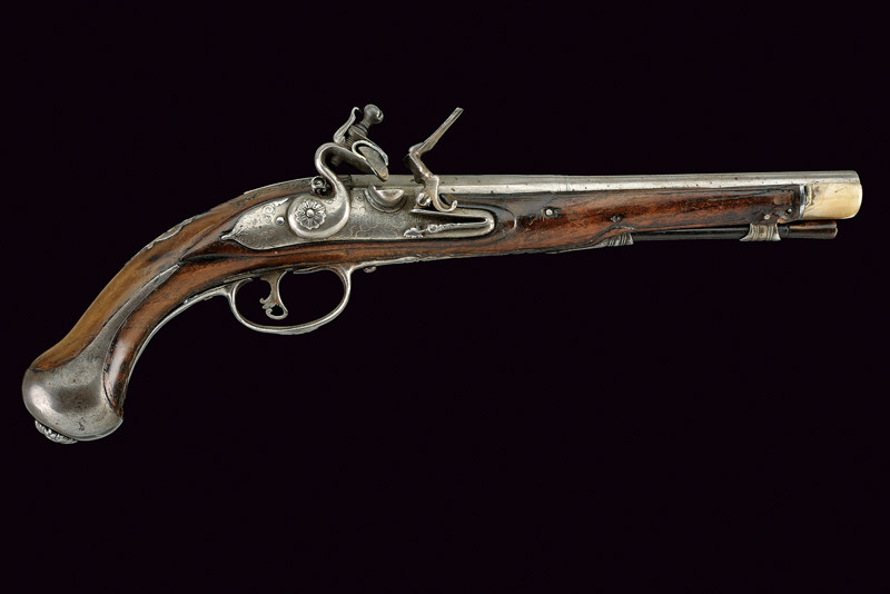

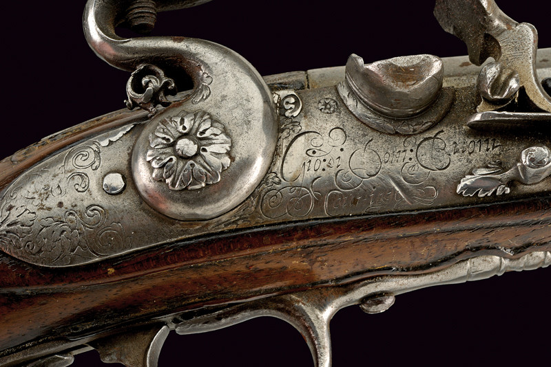

I think no one disputes it's not a masterpiece :-) Anyhow, the brass furniture is quite interesting. I read somewhere (don't remember where exactly) that the Roman lock was widely used in central Italy during the 18th century although the quality of the works was quite rough. I think it fits very well to this piece.

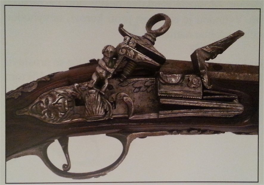

I found a similar pistol at Christie's (sale 6345, lot 99).
Matus
Matus is offline   Reply With Quote

Of course, just wanted to mention that the quality of the key (lock) does not correspond to the works of Cominazzo ....
Affectionately. Fernando K

The first one in giving fame to the family was Angelo Lazarino, who was signing himself “Lazari Cominaz“ whom was active between the last years of the 16th. century and the first decades of the 1600's. His son Lazaro, who signed himself “Lazarino Cominazo“, but also “Lazaro Lazarino Cominazo”, is the author of the barrels of the beautiful couple of pistols here uploaded. Up to 1700 the Cominazzo built almost exclusively barrels, renowned in the whole world for their resistance. Still the couple of 'terzette' here uploaded, considering its top quality and of the lack of other signatures, makes us think that the work of Lazaro Lazarino should not have been circumscribed to the wonderful barrels alone. The common identification of their products was “Canes Lazzarine” (Lazarine barrels), after the ancestor’s the name.
Some members of the family moved elsewhere and the last ones were still working, although without most of the ancient fame and ability, at the end of the 1800's. The fame of the "lazzarine" barrels was such, especially abroad, that they were counterfeited by smiths from all parts of Europe and marked with inscriptions very close to the original, sometimes absolutely equal. Considering all counterfeits and the several signatures of the components of the family, is not always easy to distinguish the authentic barrels. Still those considered authentic are the ones with a fileted top or those with more elements. Another characteristic that makes us incline to the authenticity is the presence, at the beginning and in the end the signature, of a kind of three lobed asterisk.

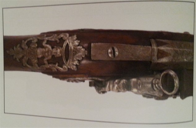

All, if you have access to Art, Arms and Armour '79, page 340, you will see Marchesan (central Italy) romanlocks and pistols not unlike the subject pistol. May not be much help, but it is the place I looked first when I saw the subject pistol lock.
Miqueleter is offline   Reply With Quote

@Miqueleter - could you please post a scan/photo of that page?

Matus, here you go. Not a very good scan. but it will have to do.

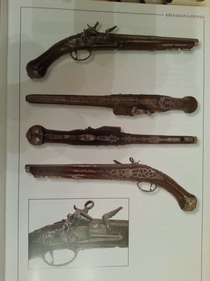

And here is the promised scan/photo from the Czech book "Sbirka pistoli a revolveru" (Collection of pistols and revolvers).
The author dates it to the end of 17th century, Central Italy. Total length is 37 cm.

I recently found this Lazarino Cominazzo flintlock pistol.
The wood under the barrel is in bad shape, but overall it's a decent 17th century example I think.
"Pietro Paolo Pantigir" was probably the name of the owner.
