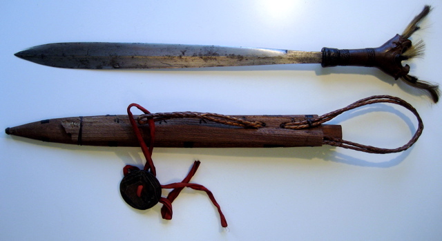

It was great to meet so many of you in Baltimore this Saturday.
Some of you asked for handouts, which I never made, but here is a short summary of the "non-mandau-blades" I talked about:
Banjarmasin/Negara (Malay): keris, jumbia, sadup (the straight dagger), Banjar parang, candong, beladah belabang ("ex-parang nabur") and pedang jenawi besar (the large straight sword").
Some of the characteristic features: gold, diamonds, dragon's blood (red), floral motifs and rosettes, bird hilts, djadwal ("magic squares"), exoticism and show off.
Outside Banjarmasin (Ngaju Dayak): duhung (spear dagger), ilum (= sadup), dua matu bayu (double edged sword), parang negara (flat "mandau" with floral motifs).
NW Borneo (Land Dayak, Malay, Melanau): latok/buko, latok sadap, pandat, pedang/senankas.
NW Borneo (Iban): parang nabur ("the real one"), langgai tinggang, jimpul, tilan kemarau, duku/pedang.
NW Borneo (Dusun): gayang (flat blade), duku/pedang ("piso podang").
NW Borneo (Murut): parapat ("ex-pakayun"), gayang.
NW Borneo (Brunei Malay & Kadayan): klewang ("ex-sangkit"), pedang/senankas, pedang, keris, kris.
And then the mandau also shows up here and there, too.
as I am ngaju.. I only know.. duhung/dohong, ambang, pisau lantik/ parang bungkul, ladok, keris, mandau..
sadop/sadup is not ngaju but it belongs to Dayak Paser...
I never heard dua matu bayu.. its definitely not ngaju language..
do you have any literature of picture about this "dua matu bayu"?

Originally Posted by Cakszz
(snip)... I never heard dua matu bayu.. its definitely not ngaju language..
Sorry I first saw your post now.
As I explained on the seminar dua mata bayu is not from any dayak language but is Indonesian. It roughly means two eyed wind, i.e. a sword that can cut from both sides (being double edged).
PS Gavin, I think all of the mentioned blades can be found if you do a search on this forum. My presentation was VERY heavy in size with all the pictures...
