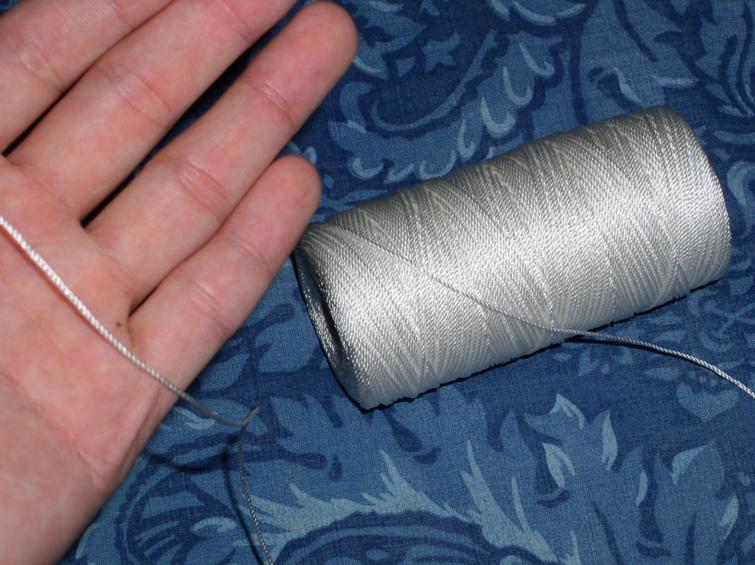

Use thick nylon thread. Nylon thread repels moisture, unlike cotton cloth or thread, which actually absorbs moisture. And we all know what moisture does to kerises...

Nylon does not compress.
It even more dangerous to use nylon than to use cloth.
My recommendation was for wool. That is wool as produced by sheep.

Yes, the thick nylon thread I was referring to is not the clear angling sort. It is made up of many smaller strands twisted together to get a thicker thread. It can be compressed.
I guess the point is that regardless of material used to wrap the peksi, the wrapping must provide some tolerance -- i.e. a snug fit, but the hilt can be twisted without too much effort.
Picture of the thick nylon thread I was referring to.
