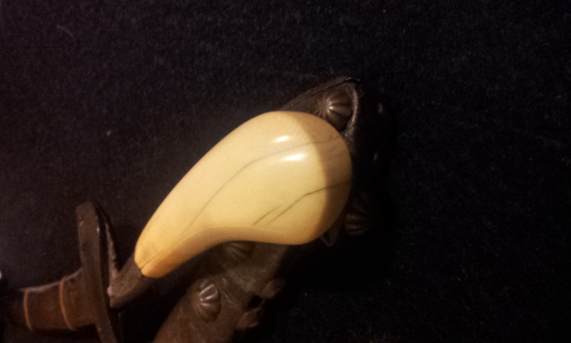

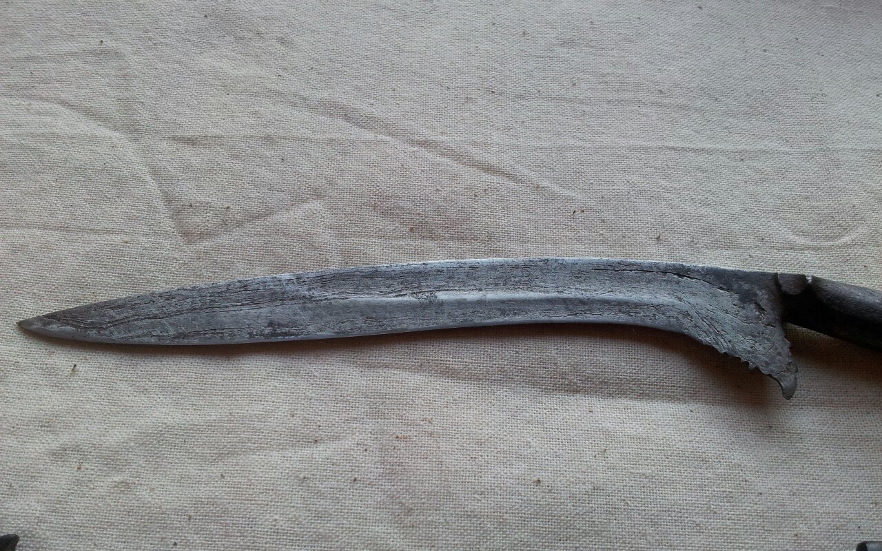

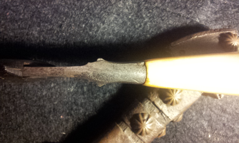

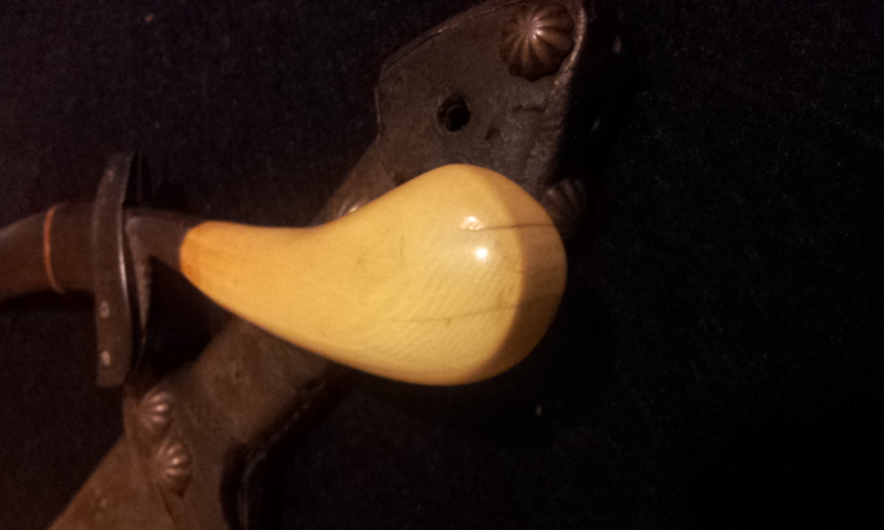

Hello Russel,

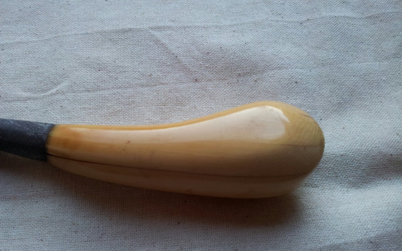

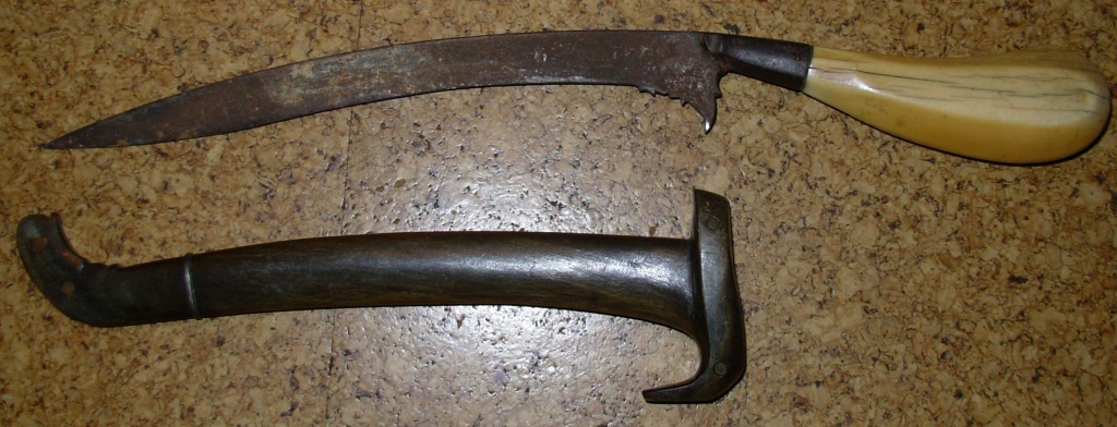

Congrats, looks like a neat, small example!

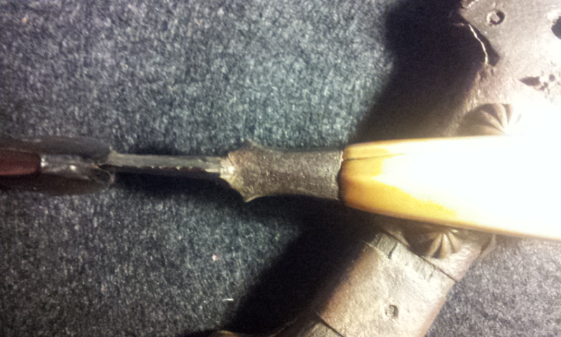

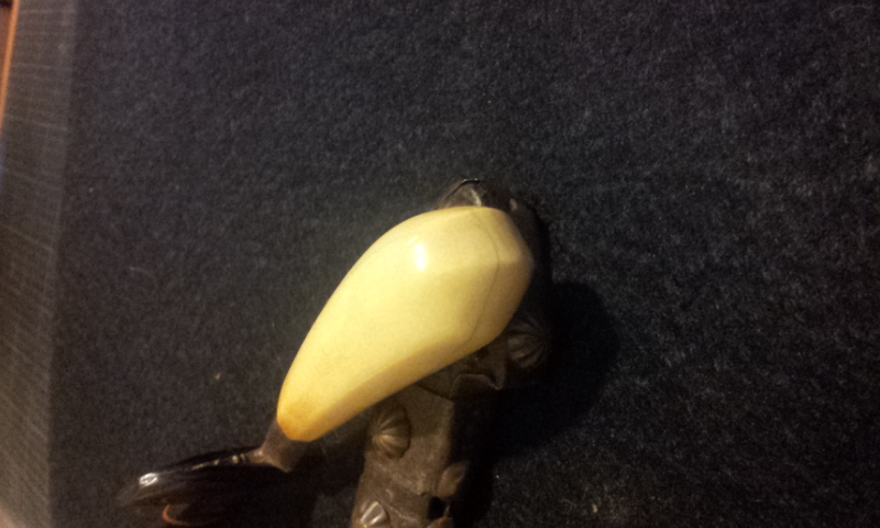

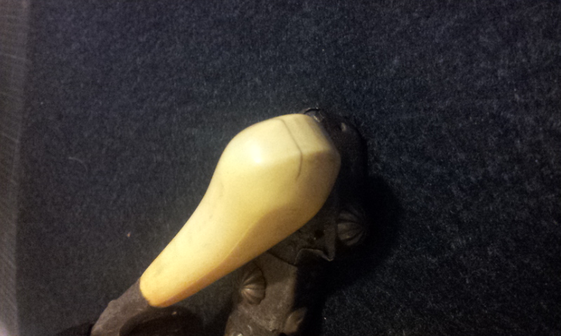

The scabbard is a later, non-traditional replacement. The rencong looks genuine and antique: blade looks Gayo to me; the hilt is a bit odd (not sure wether it got shortened/modified to repair a damage). Could you post close-ups of the tip of the pommel as well as upper and lower views of the bolster/base of grip area, please?

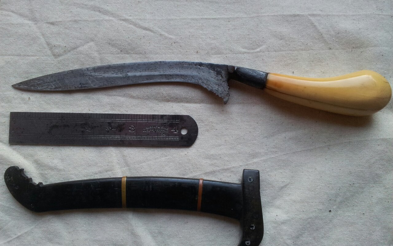

Hello Russel,
very nice piece. Love the nice patinated ivory hilt. I think the scabbard is a later replacement. Can you please post dimensions?
Old 15th April 2013, 09:53 PM   #4
Hello Detlef,
It's a small one - check the inch ruler on the first pic.

Thanks for the comments guys.
I had always suspected that the scabbard was a later addition. Yes it is small: 8 3/4 inches overall, blade a fraction over 5 inches.
Here are additional images as requested.

I too think it would be considered as being gayo.

Hello Russel,
I think your hilt is from elephant ivory.
Old 17th April 2013, 07:26 PM   #11
Originally Posted by kai
...... the hilt is a bit odd (not sure wether it got shortened/modified to repair a damage). Could you post close-ups of the tip of the pommel as well as upper and lower views of the bolster/base of grip area, please?
Hello Kai,
when I look to the other pictures Russel have posted and the rentjong from Chregu in the link Maurice have posted it seems to my eyes that both hilts are very similar, what you think?

The original area is Gayo or Gajo, like notes above. The scabbard looks modern to me.
Still nice piece.

Hello Detlef,
Yup, elephant ivory (Schreger lines).
Yes, they are really close - they are apparently a simplified variant of hulu puntung/gerepung hilt (without the usual kink/bend and no added carvings to the pommel end). I agree that both ivory hilts appear to be genuine antique examples (the fit between the bolster and the base of the hilt seems better in Chregu's piece).
I asked for the additional pics since one has to be very cautious with Sumatran pieces these days: quite a few antique blades get pimped up with new ivory fittings.
Old 18th April 2013, 12:07 AM   #15
Thanks, Russel!

Old 24th April 2013, 07:13 AM   #19
Sorry, glossed over your request, Willem!
I am still in the process of identifying/verifying indicators of origin and/or style/age/etc. for rencong; in many cases it's only a guestimate...
This blade looks Gayo to me because of its stout proportions; Albert puts it like this in his book: "Blades from Gayo have a somewhat less elegant line. They are a little straighter and more pointed." (AvZ, 2001)
Also Gayo rencong seem to utilize ivory more often than in Aceh; in Aceh horn hilts seem to be favored except for rare akar bahar pieces and some ivory hulu puntung with detailed carving.

Hello Kai,
So it is a combination of blade and hilt on which you base the Gayo origin.
Imho most Gayo pieces we know are not only of stout proportions, but also of stout dimensions. this pieces is under 10 inches (ca.25 cms) overall length. Very small for a rencong even atjeh rencong.
Willem

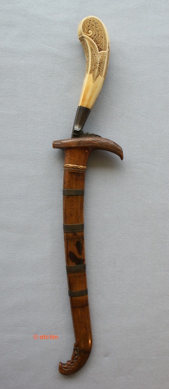

Originally Posted by Jonno
Ivory was rearly used in Atjeh, you see them only in a few kind of weapons, like the Siwaïh, 2 kinds of rentjongs / rencongs and the sikin peuangan.
John,

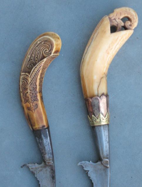

ivory rentjong in Atjeh, are these the 2 variations you mean
Old 26th April 2013, 07:32 AM   #24

Originally Posted by asomotif
John,
What a beauties Willem!
My feeling is that both are Atjeh types.
Have you checked Fisher?
Maurice
Maurice
Hello Maurice,
I did not check Fisher yet, but Imho these are both Atjeh.
But as John mentions specifically 2 type of rencong with ivory hilts, I just wanted to check if this is what he means.
Willem

Jonno
Jonno's Avatar
Join Date: Jul 2009
Posts: 51
Hi Willem,
Yes, this kind.
There are a few more variations.
Btw, nice pieces.
