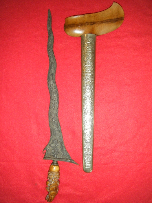

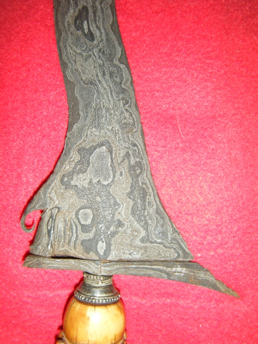

This "bringback" soldier keris, brouht to Netherlands by KNIL soldier begin '50. which i bought last week , is imo ans east Java keris (Balambangan). I have to wait for some better weather to bring the pamor out.
simatua is offline   Reply With Quote
Old 23rd February 2013, 06:52 PM   #6
Posts: 7,255
Yes, Madura soldier keris, and a 100% typical Madura blade:-
steeply inwards sloping gandhik, whispy kembang kacang remnant, gonjo lacks substance over the blumbangan, the distance from the final luk to the point is inclined to be longish.
This is definitely not able to be classified as Blambangan. Sorry.

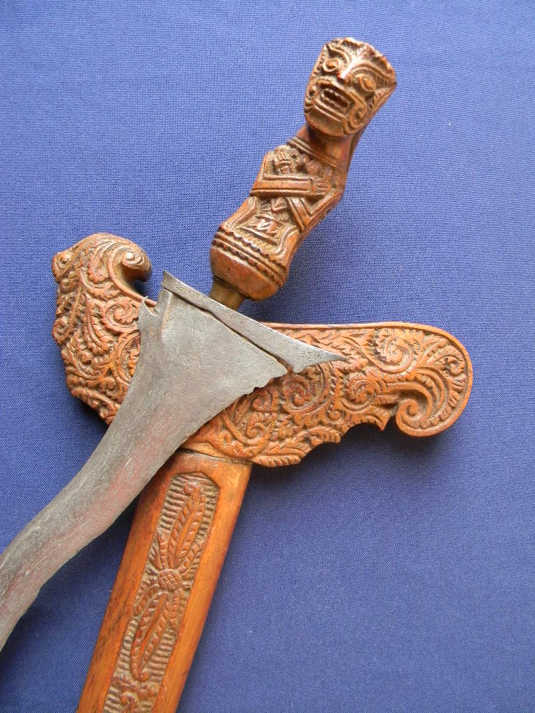

Default 3 luk lara sidua with raksasa hilt
Thanks for the feedback mr. Maisey. dont feel sorry to correct me ( i am here to learn) I did see the Maduran charasteristics, but i went on the wrong foot looking at the ukiran; the raksasa whith the crossed arms for his chest. I thought this is not very common in Madura.
What about this 3 luk keris, wilah ca 34 cm. ( without peksi). also ukiran raksasa, i have to mention, that the ukiran exsist of 2 parts, maybe not to see at the pictures . that te lowest part of the ukiran is a loose "ring".
longhaired at the backside; a little restauration at the head.
I bought it as it is. (mendak etc) the wilah lara sidua luk 3 ( according to Tammens) fits perfect. pamor beras wutah / bendo segodo

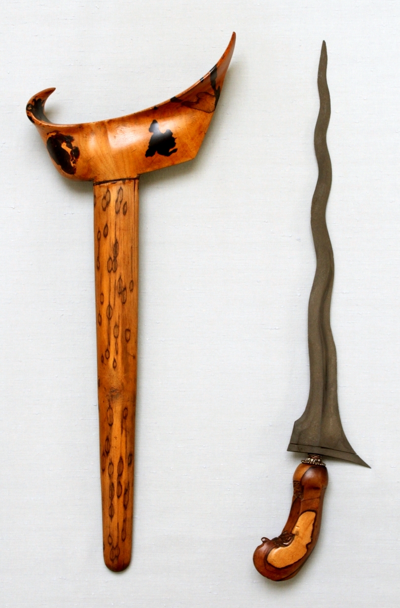

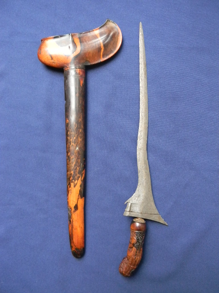

Pictures only, please feel free to comment and forget about the 2 Madurese ivory hilts which are not original.

I want to show also some examples of maybe East Javanese keris but like already said it is sometimes very difficult to differ between Madura and East Java, so I am not sure.
Example 1
Old 24th February 2013, 12:47 PM   #10
Example 2
Old 24th February 2013, 12:52 PM   #11
Example 3
Jean, I really love the blade pictured on the 2nd photo. Simple elegance at its best! Thanks for sharing!

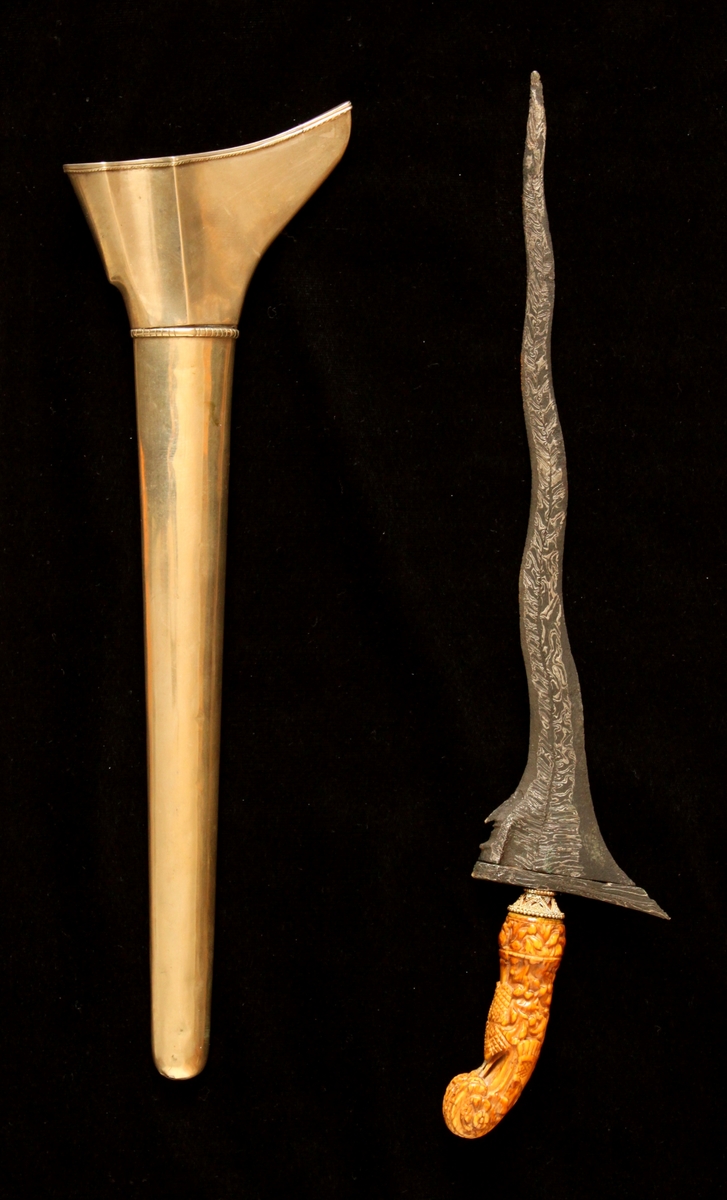

Hello Yuuzan,
The ladrang sheaths from Yogya are called branggah, I attach a typical example. They are finer and more elegant than those from East Java.
I have tried to show representative specimens of the 3 main types of East Java sheaths (gayaman, ladrang, and sandang walikat).
Hello Yuuzan,
Thanks. The darker line along the blade is not a defect but a slight discoloration which appeared after the warangan treatment (pamor kelengan).

Originally Posted by yuuzan
And what about ladrang forms. I don't have any Jogya ladrang myself so I still find it difficult to identify these. Are the ladrang forms in the photos above in Jogya style? Do they also appear less elegant in comparison to those of Jogya?
Jeans second and my third examples are ladrang sheaths typical for East Java but for Madura as well. The style is very similar to the Jogya branggah sheaths like Jean has shown.

Post 8.
pic #1
Stylistically majapahit---long slow luk, boto adeg, thus classifiable as East Jawa, wrongko east Jawa.
#2
Madura is fond of capu kagok as is Solo. This keris doesn't look Solo to me, I think maybe coastal East Jawa, wr. Madura.
#3
mamas SW , complex pamor in light blade, probably Jatim/ Maduro
Post 9

Hello Yuuzan,
Alan has given very interesting opinions about the posted krisses and it shows how difficult it is to properly identify a kris from continental East Java.
By the way when he refers to Jatim it means Jawa Timur or East Java and he rightly compares the ladrang sheaths from East Java to the (thick) kagog capu style from Solo, see attached picture.

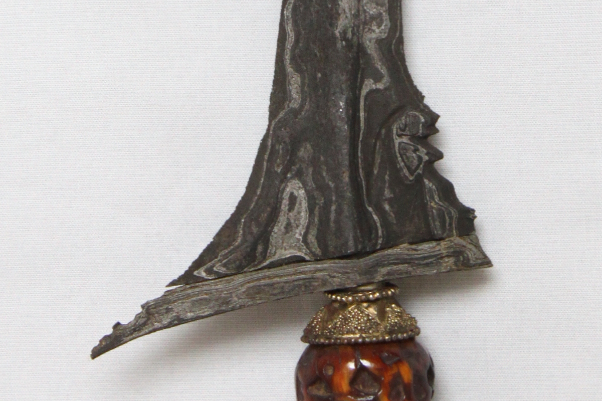

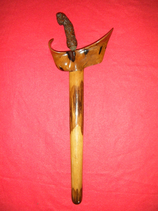

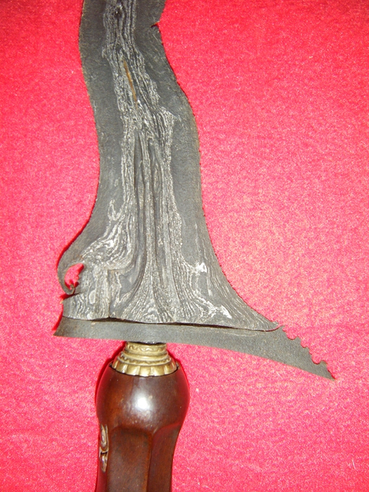

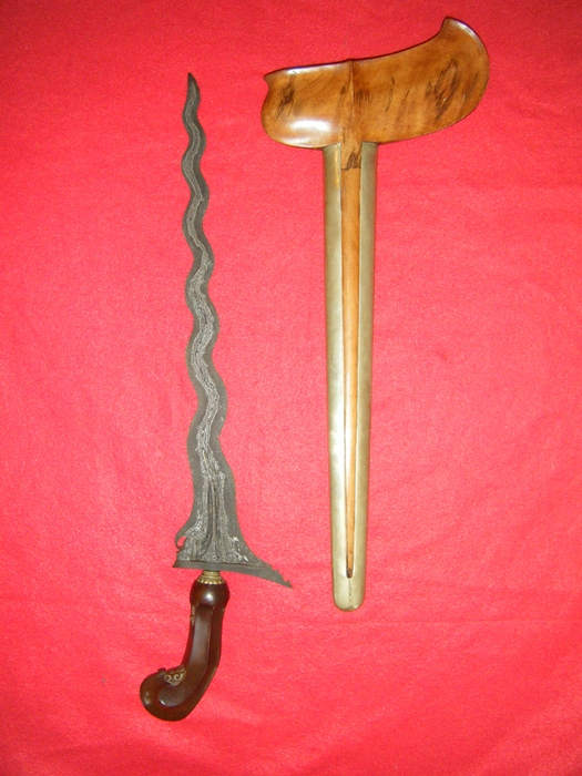

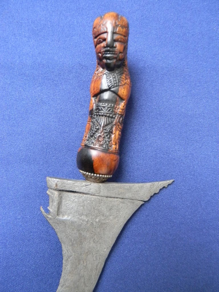

keris #1. post 8.
I believe close examination would show this blade to be a robahan, that is, a blade that has been altered.
The carving at the gandhik is not something that I recognise as an old motif, it looks crisp, and I feel that microscopic examination might show a patch welded into this part of the blade. This patch might have been made from the original gonjo, as the present gonjo looks as if it might be a replacement.
Stylistically this blade looks Majapahit, but it is most definitely not Majapahit. The material looks a bit like Gresik, if it is Gresik it will have a slightly greasy feel to the pamor material, if its not Gresik then I cannot classify and substantiate as it does not appear to fit a major strand, and it has probably been altered anyway. My gut feeling is something done for the trade and originating around Surabaya.
The overall look of the wrongko , with all that nicely patterned wood, is what I think of as East Jawa, but the "S" shaped line that runs down the front of the gambar is a line that I have seen identified with Banyumas by people who know a lot more than I do, however, most Banyumas wrongkos that I've actually handled have been fitted with pendok. This is where we get into difficulties, and the reason is this:-
in a karaton setting the forms are fairly strictly structured and identified for use by whom and when, but when we move away from a karaton into a small town, or a village, that structure disappears and we have a situation where the form of the wrongko is limited by the skill of the carver and by the desires of the customer. Thus, when we try to classify these wrongko forms and styles that lack the guiding hand of tradition and authority, we are in a situation where we do not have guidelines that permit supportable identification of point of geographic origin.
Collectors like to, maybe need to, classify, but when we cannot support a classification what is the point?
We can certainly classify broadly:- Jawa, Bali, Bugis. But when we look at 50 wrongkos by 50 different pairs of hands in 50 different locations, how can we possibly classify? Under these conditions maybe the best we can do is what I did yesterday:- form a quick first impression.
Or, we could go the way that I've seen a lot of people go in Solo:- for a blade --- "outside Jawa", for dress--- "outside Surakarta, not Jogja"; what is left unsaid is "well, its not of any importance anyway, because its not from anywhere that counts, so who cares?"
The Javanese attitude to keris is just a wee bit different to the attitude of collectors outside Jawa who give equal importance to every keris, no matter what it is, or where its from.
Anyway, coming back to post 8 keris #1.
From what I can see, the blade has been played with and made more attractive; the blade and the wrongko are unlikely to be an original mating; my feeling is that I'm looking at a dealer's montage , but one put together with a great deal of care and expertise, possibly the wrongko was obtained first, then a suitable blade was found, the blade "improvement" was done, the gonjo was made so that it exceeded the size of the wrongko hole, which was probably small to begin with. I doubt that this was done recently. I think that this sort of alteration probably stopped in the 1960's early 1970's. I only ever knew one man who could do this sort of thing well, and he died years ago, probably well into his 80's --- he always reckoned he was the same age as myself, but the fact of the matter is that he didn't know when he was born. He lived in Jogja.
So, an old alteration, bit of a mixture, but the blade is stylistically Majapahit, and the impression of the wrongko, principally because of the very attractive wood, is East Jawa. A collector's keris rather than a keris that we can positively link to a specific local geographic area. I'd be happy with a classification of simply "Jawa" for this keris, because I cannot really substantiate anything more detailed, but again, my first impression is East Jawa.
See how confusing this game can get?
I'll look slow and careful at another keris when I have another hour to spare.

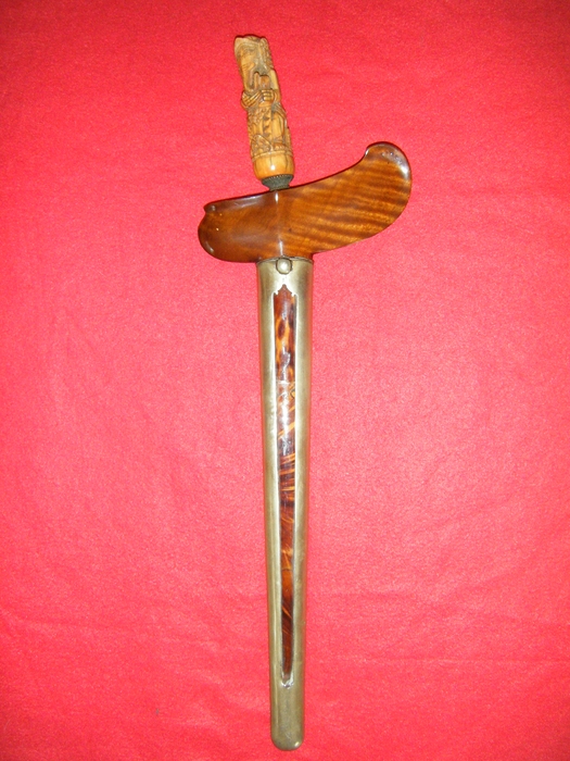

Regarding Wrongko of post 8 #1, I have a feeling, also Gambar and Gandar perhaps don't really match together. The joint between them looks stiff to me, due to difference in size (at the joint line ) and color (dark Wrongko-light Gandar at the joint) and perhaps the position of the joint line itself (a little bit kaku).
For me as an absolute "bloke" difficult to say, if it's due to my limited personal taste, used in wrong place, or due of a possible "peripheral", less careful taste of the Mranggi. Yet I suppose, a person, who originally choses such beautiful piece of wood for Gambar would more carefully chose the matching Gandar.
Old 26th February 2013, 12:55 AM   #28
Posts: 7,255
Yes Gustav, you're right, in the photo they do appear to be strangers to one another, but I did not want to comment on this because I could not Photoshop the image to try to help me see the details that are less than clear:- this appearance of uneven mating could be due to dark wood at the edges of the foot of the atasan.

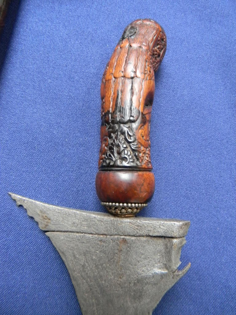

Attached are the detailed pictures of the blade shown in post 8#1.
My visual observations are as follows:
. The blade was in rust-free but unstained condition when I received it. After warangan treatment in Solo, the ganja colour appears clearer than the blade itself but it does not seem to be a recent replacement (greneng worn-out) and it fits quite well with the blade.
. The figure carved on the gandik (putut?) does not seem to have been welded as the pamor lines show a good continuity but it could have been carved-out from a larger blade.
. The atasan matches perfectly with the gandar but the slot has been reduced in sized with some putty so the blade and sheath were not originally matching.
Your further observations or questions will be welcome.
