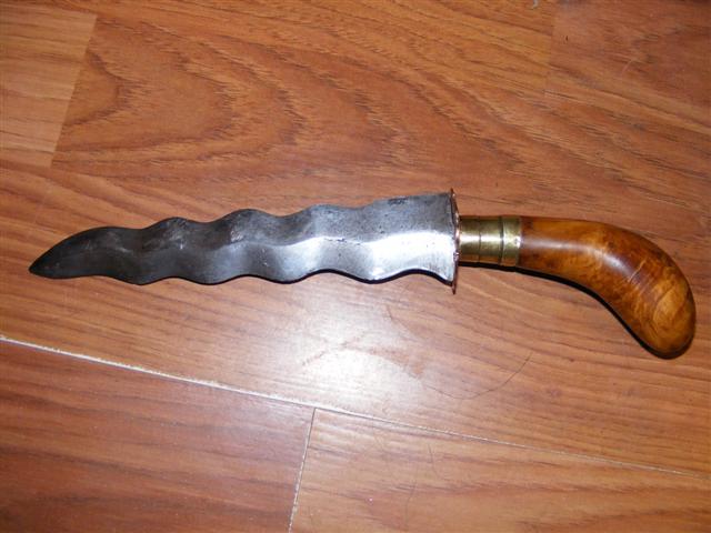

Well, here is the gunong. I still have to finish the scabbard and will post pictures when it is done. Sorry about the poor picture quality but seeing as we had 8 inches of snow today and the wind is still blowing I had to take the photo inside.
Robert

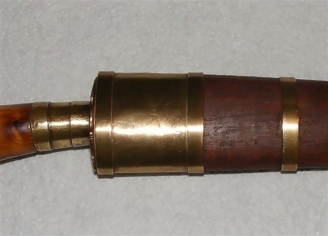

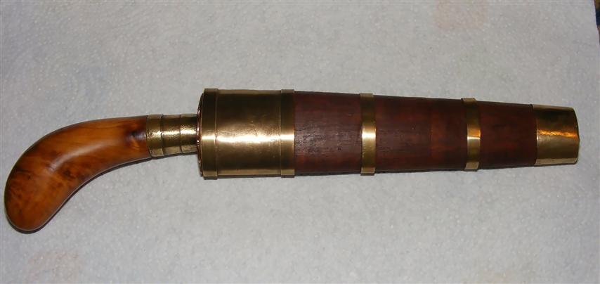

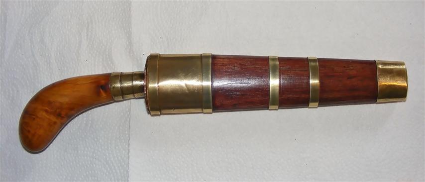

Hello Everyone, I've been meaning to up-date this thread for awhile and never seemed to remember to get around to it. Here are a couple of photos of the gunong after doing a little work to the scabbard. These were taken before I oil finished the wood and aged the brass bits. I will have to take a couple more photos of it to post in the next day or so as I never got around to doing it after I was finished with this piece. I hope that you approve of my efforts at restoring this and trying to give it back some of the dignity it had lost over years of neglect by its previous owners.
Robert
Old 11th June 2014, 05:00 PM   #45
Just stunning what you have done with this little gunong. Have you worked the brass bands for the scabbard byself?
Old 11th June 2014, 05:57 PM   #46
Robert
Robert's Avatar
Location: Centerville, Kansas
Posts: 2,196
Hello Detlef, Thank you very much for your complements on the progress on this piece. All of the bands for the restoration of this I hand made except the for the piece on the very end which was original to the scabbard. The banding at the throat of the scabbard I made to match the ferrule on the hilt of the gunong itself. I had at first made it plain (like the lowest band) but it just did not look correct (or for that matter very pleasing to the eye) so I added the extra bands to the top and bottom to help dress it up a bit and give it a more completed look. I will post photos of the completed piece as soon as I can find the time and the weather decides to cooperate enough for me to be able to take them out doors in decent light. Again, thank you for your kind words.
Robert

Thank you Jose. I tried to use the same material that might have been available at the time this piece was first made by using brass salvaged from a couple of old beat up shell casings I had laying around for just such an occasion as this. I left most of the scratches and dings in to help the new pieces better match the one original piece that was still remaining, unfortunately they do not photograph well. Again, thank you for your opinion on the progress made to the point at which these photos were taken.
Robert

Well, I finally got around to taking a photo of the finished gunong. In the last photo you can see ghost impressions of where the missing original bands had been so I have placed the new bands as close to where the originals were as possible. As it does not seem that it will ever stop raining I had to take this photo inside.
Robert
