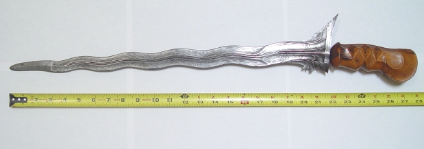

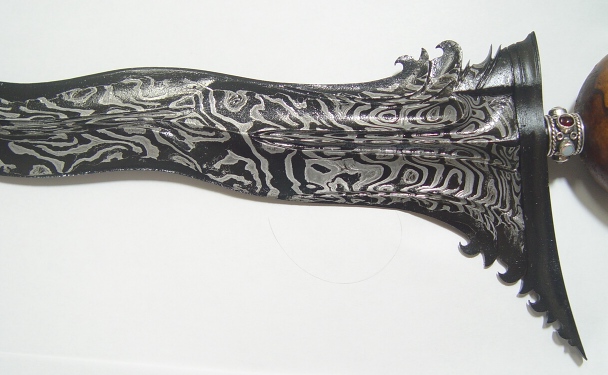

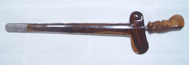

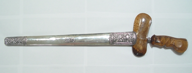

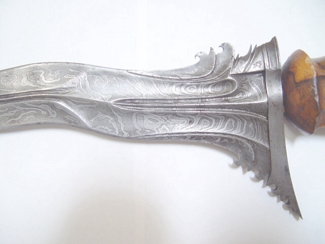

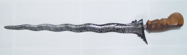

Some members saw this keris when I picked up in Timonium earlier this year. I thought that you (and others) might like to see it after it's round trip to Bali.
The first two pictures are as I picked it up while the others are after it's return to me.

Ah Mickey, that truly is awesome! Nice staining and a good job on the sheath. What's up with that second set of sogokan. I've never seen that before. A very nice and unusual keris.
BTW, how long was the turn-around time on the work?

This keris deserves a place in the books! The ricikans are most unusual, especially the 2 'depressions' surrounding the sogokan.

I totally agree with you Kai Wee. The ricikan seen quite unique here. Not only the impressions around the more common sogokan, but the way the sogokan seem to start up again further up the blade. This appears to be a very special keris.

Just to share, the older Balinese pieces which have not been re-etched has a lower contrast, and a more 'steely' looking white portions, probably due to polishing or perhaps just because they are older and have lost a bit of the sharpness in contrast. Sometimes, the 'black' looks almost bluish in these older pieces. The recently washed pieces I've seen have this 'matt white and jet black' look. Not sure if the method is more Javanese than Balinese?
Old 11th September 2005, 06:38 AM   #11
Posts: 7,418
Bluerf is right. I have noticed that on my Balinese keris. It is older and the nickel is silvery while the rest is a darker bluish-grey color.

I have a dozen or so Balinese kerises. All of them except for the one shown in this thread were patinated in Bali while I was present on the island. The oldest of these (I make this assumption because the pamor is adeg which is laid out in luks and the piece has been washed and polished so many times that the luks themselves are practically nonexistent) shows the dark gray base that Battara mentions in his post. Others have colors that range from dark black through the almost gun blue finish that BluErf mentions. In fact some of them range from black, dark blue, brown and up to and including a golden color in the base material of the same piece. (That is the material other than the nickel bearing material.)
I cannot say that the patinating of this blade was done in Bali. I can only say what I requested that the individual to whom I sent the blade was to do with it. I do know that he passed the blade down to Bali in order to have the scabbard made and he even had a different grip and mendak made and installed before he sent the ensemble back to me.
Due to these variations in the final colors of Balinese kerises that I know of as facts, I am extremely reluctant to get into a contest regarding the judging of the proper color for the patination of a Balinese keris.
