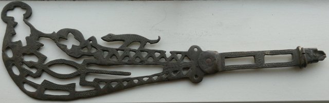

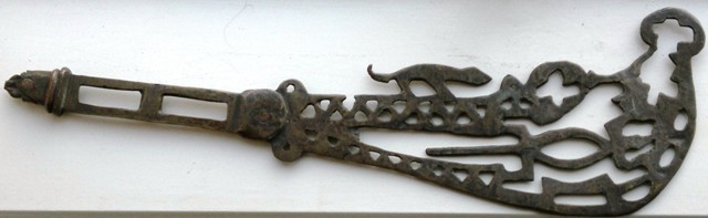

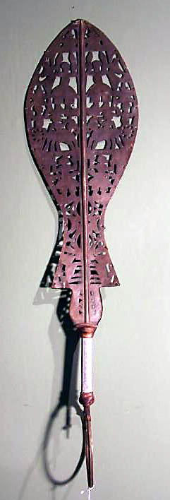

Hello all,

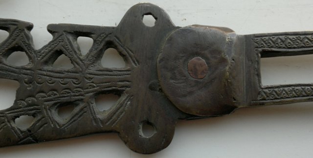

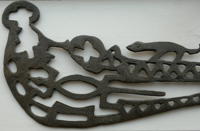

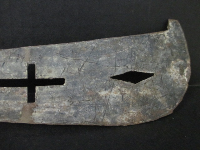

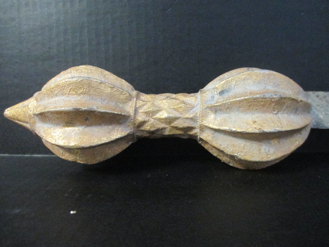

We thought we'd share a few pictures of what we believe to be a Ashanti ceremonial sword. Spring, in his book African arms and armour, has something similar on page 58, he describes the weapon as a 'afenatene'. Our example appears to have had something snapped off, perhaps a hilt of some form or maybe it was originally joined to one of these triple bladed swords. The carving is very interesting, especially the lizard. The patina suggests some age. Interestingly, the handle section pivots. Thanks in advance.

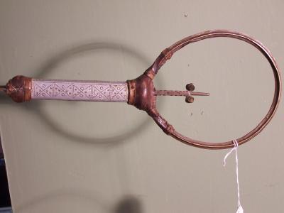

IT LOOKS LIKE AN ASHANTE BLADE THESE ARE FOR CEREMONIAL OCCASIONS AND HAVE PEIERCED DESIGNS IN THE BLADES AND WOOD HANDLES COVERED IN GOLD LEAF. THEY HAVE SMALL GOLD FETISHES ATTACHED AT IMPORTANT OCASIONS AS WELL. THE ONES I HAVE HANDLED DID NOT HAVE AN EDGE PERHAPS THE EARLIER ONES DID BUT I HAVE NOT SEEN A SHARP ONE. THE BLADE YOU HAVE HAS SEVERAL ODD PROPERTIES IT LOOKS CAST RATHER THAN FORGED AND THEN CUT OUT AND THE MOVING PART IS ODD AS WELL. A VERY INTERESTING ITEM. HERE ARE A FEW PICTURES. ONE PICTURE IS OF THE KING AND YOU CAN SEE THE GOLD COVERED HANDLES OF MANY STATE SWORDS.
TWO OTHER INTERESTING THINGS IS THAT THE GHANA STATE JEWLS WERE STOLEN IN OCT. 2012.
LOOK UP THE KOMFO ANOKYE SWORD. IT IS IN A SHRINE AND THE LEGEND IS, AS LONG AS IT STAYS THERE THE ASHANTE KINGOMDOM SHALL ENDURE.

Thanks for the replies chaps.
The komfo anokye sword search proved very interesting and provides a lot of info on Ashanti history. Unfortunately we can offer little on the piece other than its dimensions which are as follows
Overall length: 52.5cm
Width at widest : 17cm
It does appear to have been cast and has never been sharpened. The pivot has only a very limited degree of movement and its purpose is obscure.
We seldom see Ashanti items and it was a lucky day for us to find this one. We added one of our victorian scrapbook cards of a mid 1800's interpretation of an Ashante warrior, he's romantic and kind of fun!

I agree this is likely Ashanti, but a precise classification would be extremely difficult with the complexity of variations of these arms, their purposes, and the heirachies of these forest kingdoms included in the confederation of Ashanti rule.
It seems that cutlass type weapons, along with the razor type weapons Colin has noted of Dahomey, were well established throughout these states and kingdoms. Christopher Spring has done a brilliant job of describing many of these and relies heavily on the outstanding article by Palau Marti, "Sabres decores du Dahomey" ('Objets et Mondes', VII:4, 1967).
I am inclined to think of this openwork cutlass as more likely to be the afena of Ashanti use rather than the afenatene, though the illustration of one of these with multiple openwork blades is clearly similar in the theme of the blade of the afenatene .It is tempting however, with the curious riveted swivel device, to think this perhaps might be for multiple blades to open wider to be stood vertically as in the illustration of the afenatene.
The broader neck seems though to be to support the dual spheres of the afena, clearly missing on this example. As Barry has noted, part of the significant theme of these swords was carried on the sheaths with devices of varying forms (abosodee) which might replicate many items telling of key events symbolically. Allegorical themes are important in these cultures in carrying forth thier history and traditions, which is exactly what the images and figures in these openwork blades are for.
While these are unsharpened and uniquely decorated swords used in symbolic gesture as regalia, they are based on various cutlass type swords often with the large rounded swirl blades which did find use in degree otherwise.

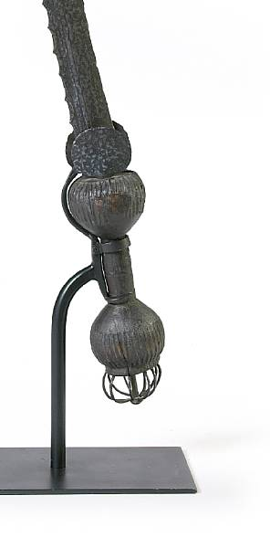

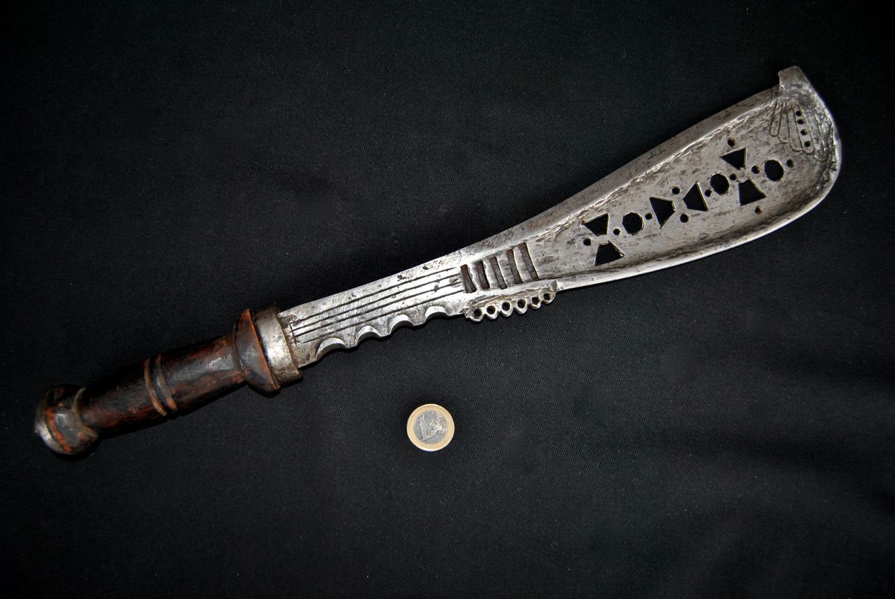

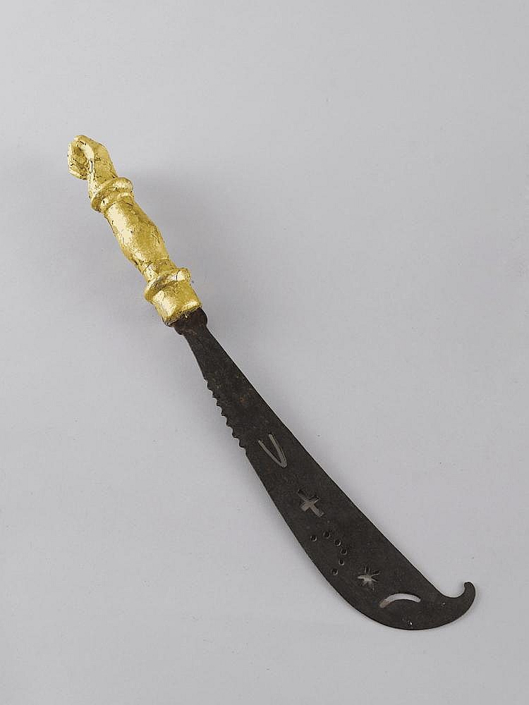

I HAVE SEEN PICTURES OF SWORDS WITH TWO BLADES AS WELL AS AT LEAST ONE WITH 3 BLADES THAT WAS FREE STANDING. UNFORTUNATELY I HAVE NO PICTURES PROBABLY THE SELLER OR AUCTION BLOCKED PICTURES OR PERHAPS THEY WERE IN BOOKS.

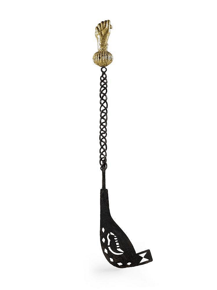

HERE ARE TWO PICTURES OF A YORUBA CEREMONIAL SWORD FOR COMPARASON AND ANOTHER SWORD THAT MAY OR MAY NOT BE ASANTE BUT IS A BIT DIFFERENT THAN THOSE USED AT CEREMONIES INVOLVING THE KING. PERHAPS SOMEONE MORE FAMILIAR WITH THIS SORT OF SWORD CAN ADD SOME MORE INFORMATION ON THESE INTERESTING AND IMPORTANT ITEMS.

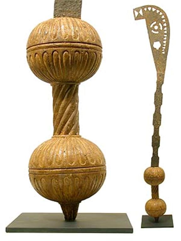

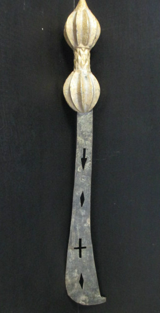

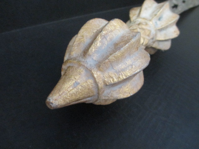

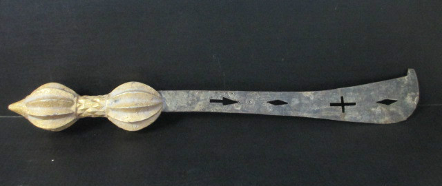

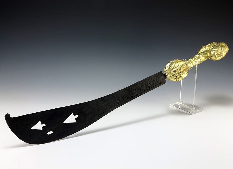

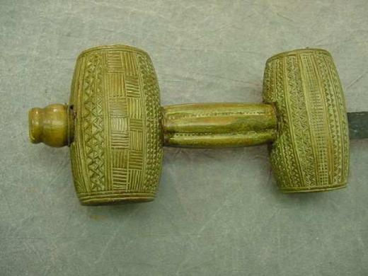

One of the most important symbolic objects of the Akan (Asante, Fante, Baule,etc.) peoples are the ceremonial swords called "Afena". Some (Numbers 1-3), with white and offerings on them are called an "Okomfo Afena" and were used by shrine priests. They originated as practical weapons, then took on various ideological and ritual roles. Dull blades, sometimes with openwork, show they were not intended to be functional weapons. They usually have a curved iron blade and an ornate hilt shaped like a dumbell, which is sometimes covered with gold leaf.. The specific functions and forms of swords vary from state to state. In general, swords are (or were) used for swearing oaths, as symbols of rank and safe passage, and for display.
---Dan Mato, Professor Emeritus of Art History, The University of Calgary
I CAME ACROSS THIS INFORMATION A SEARCH OF THE NET WILL YEILD MORE INF.

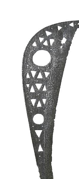

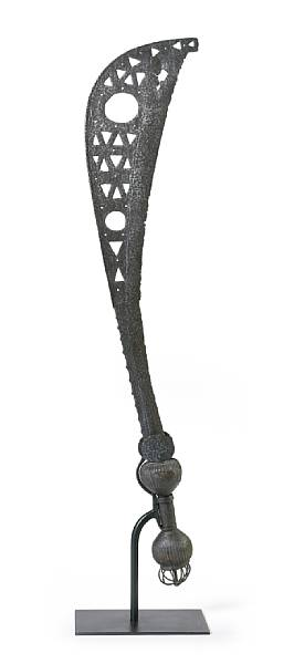

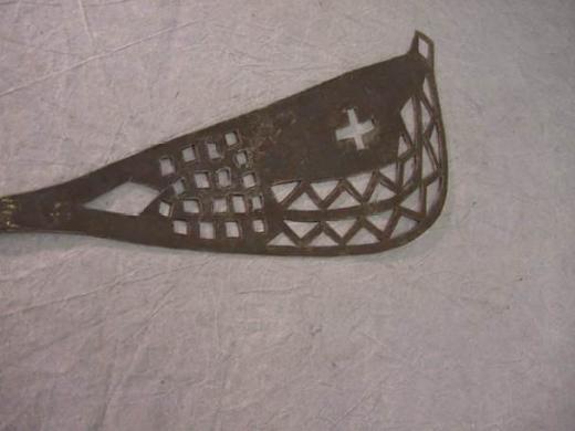

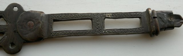

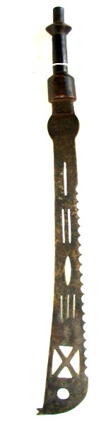

TWO MORE EXAMPLES, THE FIRST PICTURE LOOKS MORE LIKE AN ASANTE SWORD I AM NOT SURE OF THE OTHER ONE.

This one was sold recently via ebay.
