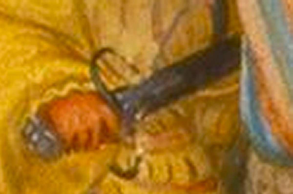

Close-ups from a painting by Lucas Cranach the Younger, dated 1584, in the Germanisches Nationalmuseum Nuremberg.
The arms and armor are of course depicted in the old traditional style of the 1540's.

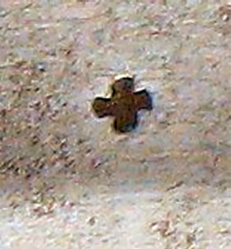

As in several other instances of contemporary illustrative sources of period artwork, the artist even considered depicting the characteristic cross and orb mark - plus, near the tip, a typical wavy, serpent-like ornament - on the blade of the saber!!!
Please note that the hilts of both arms are blackened!
Author's photos, 1995.

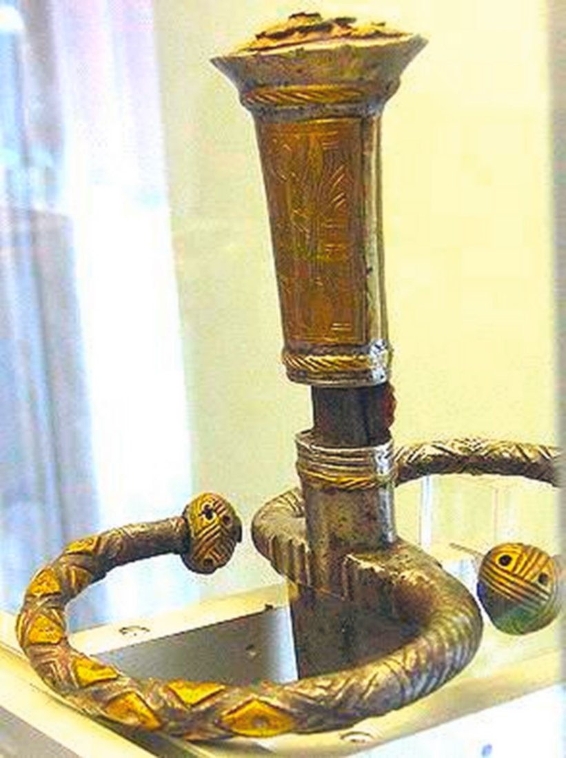

A Katzbalger of characteristic type, the forte of the blade fullered, the bone nodus of the hilt damaged; early 16th c.
Germanisches Nationalmuseum Nurembeg.

Michael,
Di you maybe know which saints are engraved on the brass grip plate?
best,

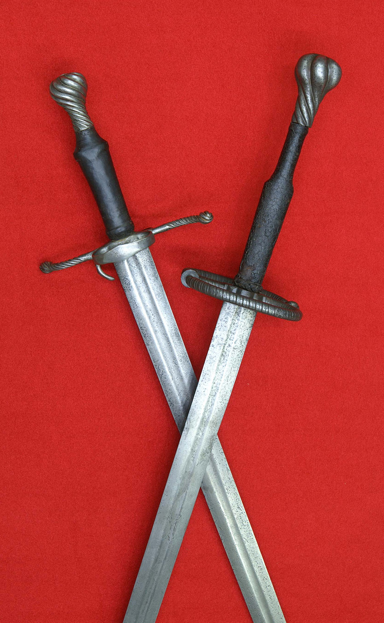

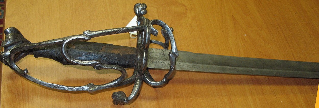

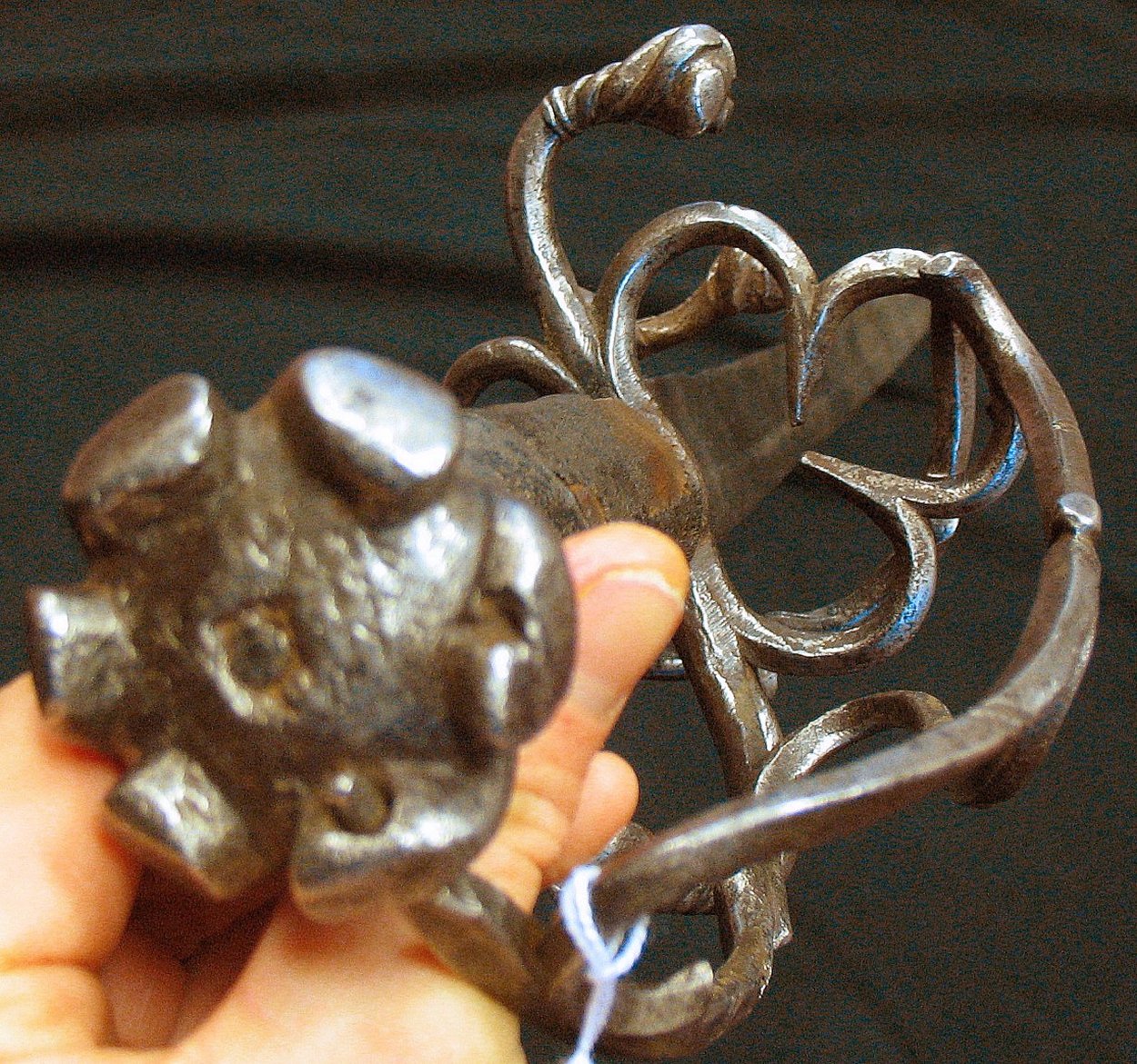

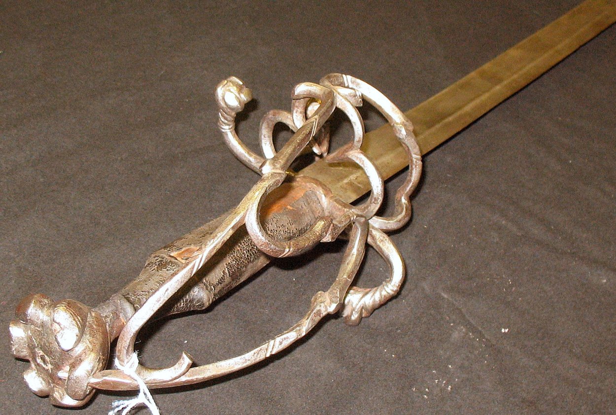

Sword from my collection.
Foxbat is offline   Reply With Quote
Old 5th November 2012, 06:43 PM   #371
Welcome to our forum, Foxbat
What a wonderful start; this is a stupendous sword
Can we see more pictures of it ?
Could you tell us something about it ?

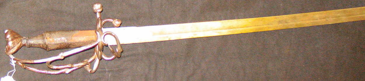

Old 5th November 2012, 07:43 PM   #372
Foxbat
Foxbat's Avatar
Join Date: Oct 2012
Posts: 69

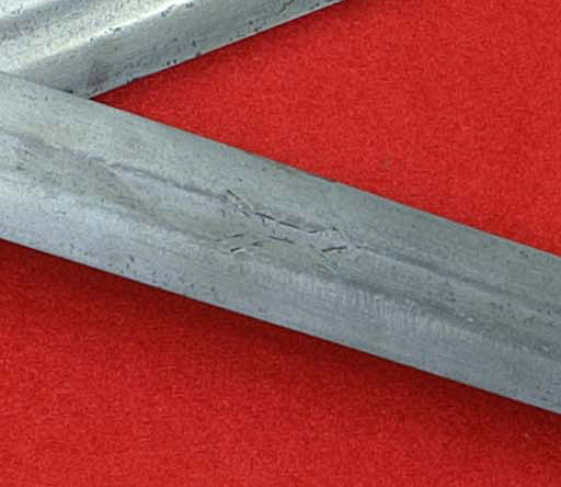

Thank you! Can't really tell much about it besides the fact that it has 36" blade with wolf mark on it, with wonderful balance. The only other picture of it is here, shown with its sister sword.
Old 6th November 2012, 10:28 AM   #373
cornelistromp
cornelistromp's Avatar
Join Date: Mar 2009
Posts: 1,071

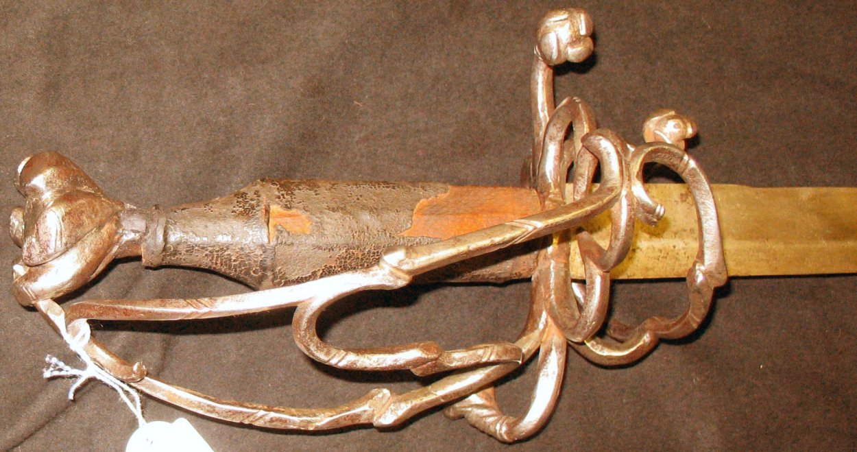

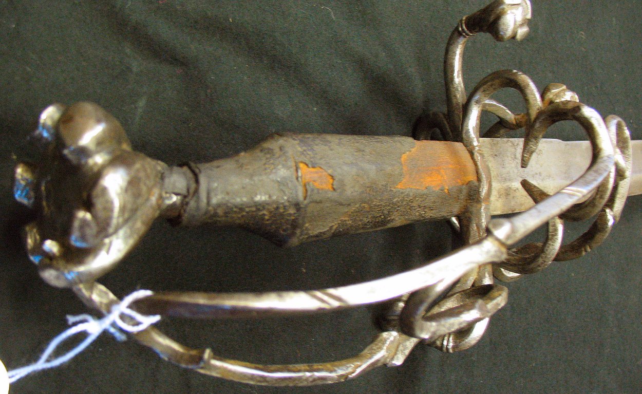

Hi,
re: the guard
circular tracks (due to mechanical rotation?) can be seen on the flat side of the guard finals.
Can you please post a picture where you can see how these finals are attached to the guard?
Do you maybe have a provenance of this sword, collection, dealer or auctionhouse?
best,
Old 6th November 2012, 10:32 AM   #374
Magnificent. Is the 'sister' also from your collection ?
Old 6th November 2012, 10:46 AM   #375
Oh Jasper, i didn't know that you were posting before me.
I see what you mean; a sharp eye from an experienced collector !
Let us hear from Foxbat.
Old 6th November 2012, 12:58 PM   #376
Foxbat
Foxbat's Avatar
Join Date: Oct 2012
Posts: 69
As far as I can tell the finials and the bars are one piece, together with the block.
The circular grooves could have been made by the tool used to turn the hot iron bar in the process of making, to create the screw-effect on the guard branches.

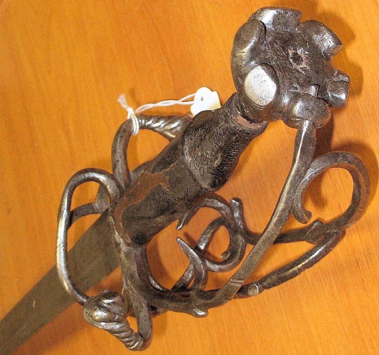

I apologize if I kick someone against the sore leg, my personal opinion in all frankness.
some style attributes, especially on the guard and ricasso block, combined with the extreme rarity of this type make me suspect that this is probably a later reproduction.(20thst or 19th century)
Only two authentic swords of this type are known to me;
- one in the Berliner Zeughaus, published by G. Hitl, p.58 waffensammlung Nr.334 and Mueller/koelling/Platow, Europaische Hieb und Stich Waffen p.189 Nr. 96.
- Another one sold by Hermann Historica 19 mai 2001 lot 64
best,
Old 7th November 2012, 02:28 PM   #380
Foxbat
Foxbat's Avatar
Join Date: Oct 2012
Posts: 69
No apology is needed, we are all entitled to our opinions. In addition things like auction records are not 100% reliable, as some of us have discovered. Having this sword in my hands, I rule out 19th or 20th century replica idea. Could it possibly be a very early, perhaps even a period, composite? Yes. My level of expertise does not go that far.
Old 7th November 2012, 08:58 PM   #381
cornelistromp
Join Date: Mar 2009
Posts: 1,071
I do not expect it to be a composite from the 16th century. I can say with reasonable certainty that the guard is much later.
it may be of course the case that original parts are used, for example, the blade and/or the grip.
However, the patina, colour and pitting of the blade are almost identical to the other sword, this is highly unusual, Do they come from the same source?
It is difficult to give some kind of (final) opinion merely based on the posted pictures, if you have the opportunity and want to have more certainty, I would advice to submit it to a specialist of the well known auction houses;
Thomas del mar, Bonhams or Hermann Historica. A first impression they can give on the basis of photographs.
best,

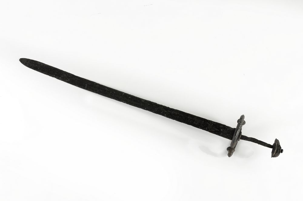

Two soil finds from the Netherlands, the katzbalger is 87cm and the sword is 94cm allover.

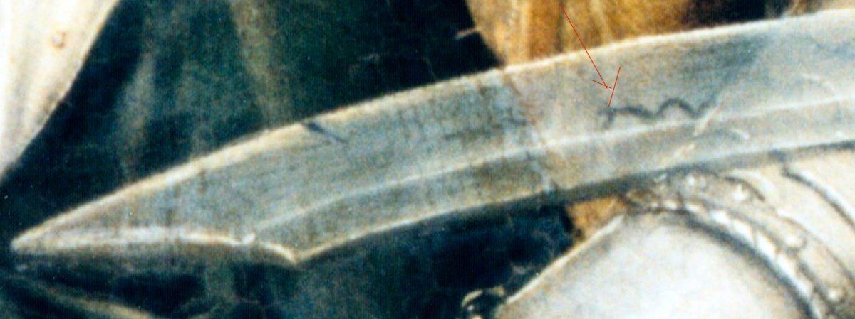

Default A Highly Unusual High-Gothic Seitenwehr (Side Guard), Bavaria, ca. 1425
From a fine and important early painting by the Master of the Worcester Carrying of the Cross, active in Bavaria, where I live, ca. 1425.

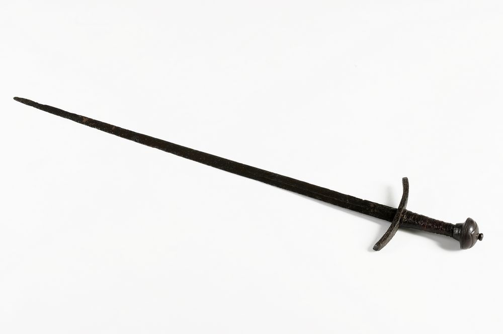

Old 8th January 2014, 10:59 AM   #385
Matchlock
Matchlock's Avatar
Join Date: Sep 2008
Posts: 4,310

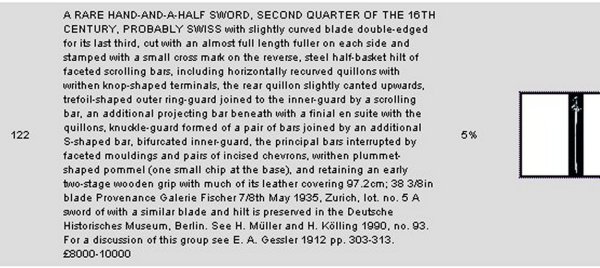

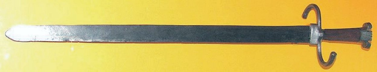

A fine and rare Swiss hand-and-a-half sword with single-edged blade (double-edged for its last third, Schnepf), ca. 1530.
Sold at auction: Tom del Mar, 10 December 2008, lot 122.
Enjoy!

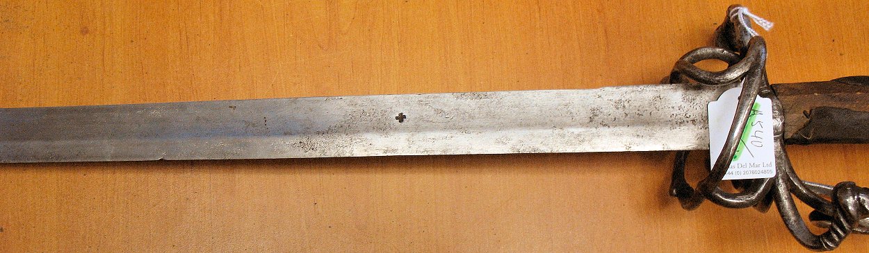

Old 8th January 2014, 10:50 PM   #387
Matchlock
Matchlock's Avatar
Join Date: Sep 2008
Posts: 4,310

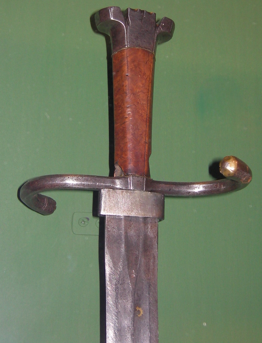

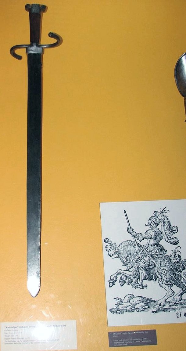

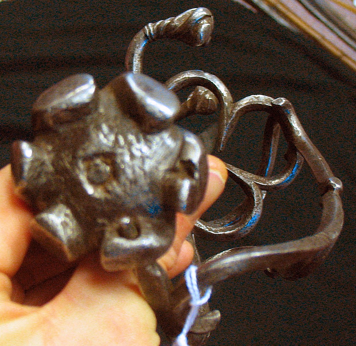

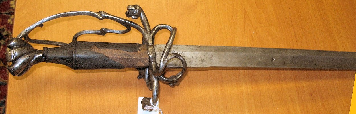

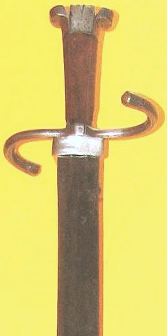

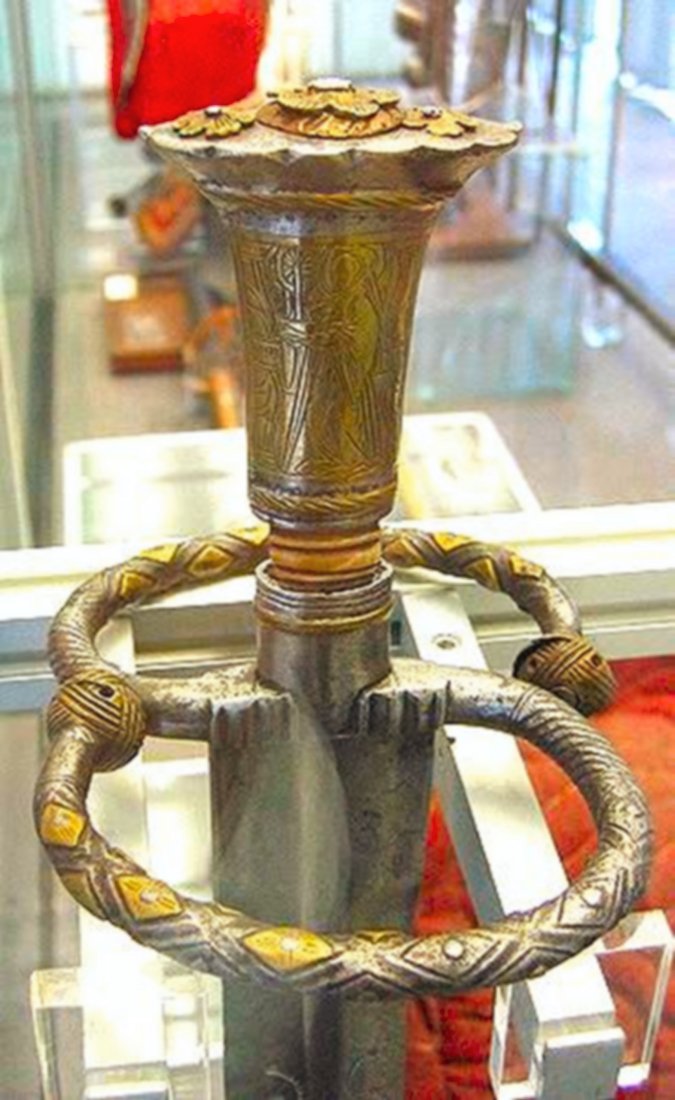

A late Katzbalger, ca. 1540, with recurved but open 'pretzel' quillons and a flat pommel; at the Higgins Armory Museum, Worcester, Massachusetts.
m
Old 9th January 2014, 08:02 AM   #388
cornelistromp
Join Date: Mar 2009
Posts: 1,071

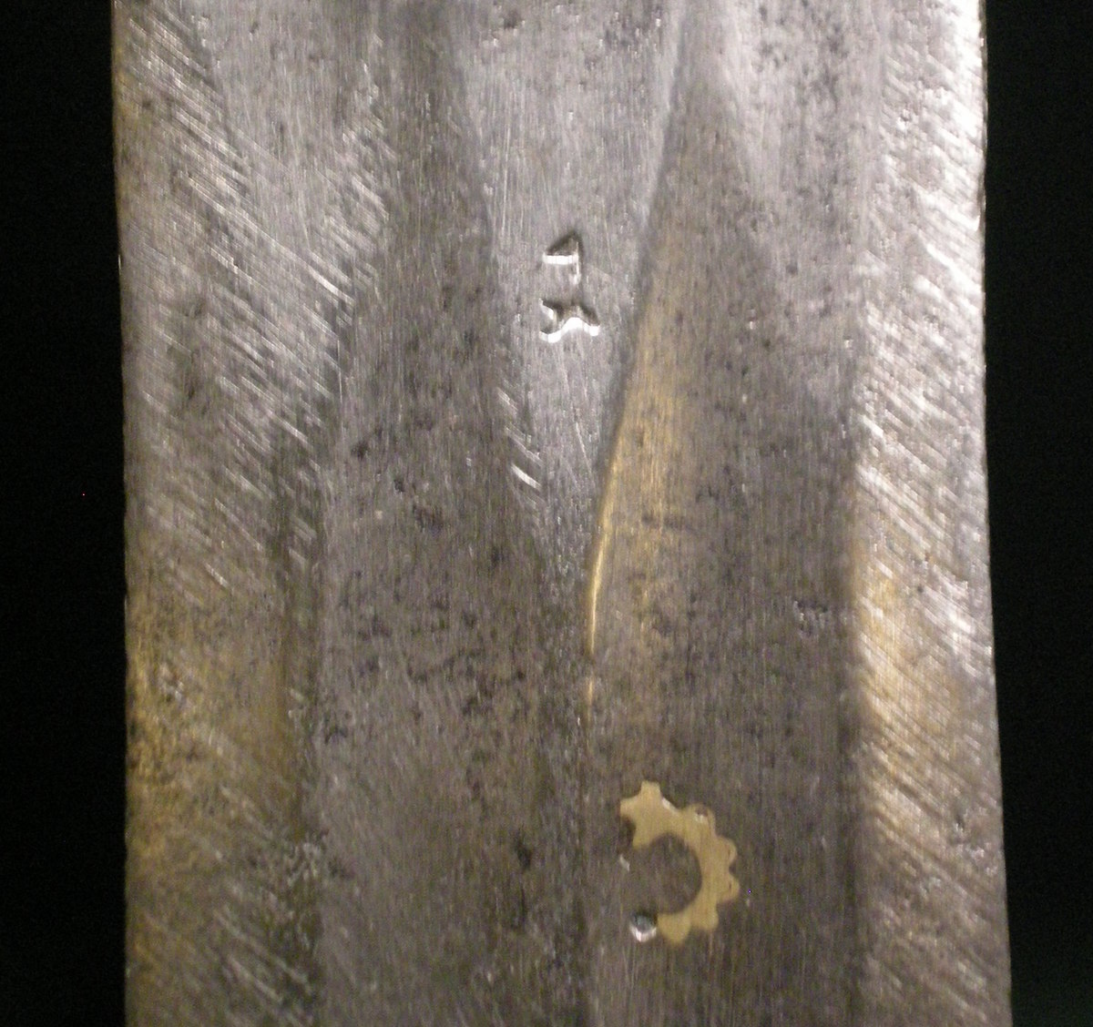

some better pics.
authenticity? don't know, I will check their HAM files for the provenance.
good: is shape of guard, bras finals "riveted" to guard, copper alloy washers used in grip, blade outline.
bad(unusual): is shape of fullers, non-gothic 4 mark, condition of leather grip, shape of pommel.
very bad is that somebody cleaned the blade with heavy sandpaper.
1540 is a bit too late this type came around 1500, this type occurs frequently in the work of Albrecht Duerer.
best,
Old 9th January 2014, 08:50 PM   #389
Matchlock
Matchlock's Avatar
Join Date: Sep 2008
Posts: 4,310
Thanks a lot, Jasper,
Do you have a close-up of that cypher 4 you mentioned?
m
Old 10th January 2014, 07:10 AM   #390
cornelistromp
Join Date: Mar 2009
Posts: 1,071
m
Michael, look at the first picture!
more open the guard, the earlier the Katzbalger!
late 15th century, even with a straight guard into the middle of the 16th century with a completely closed guard.
best,
jasper
