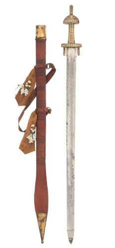

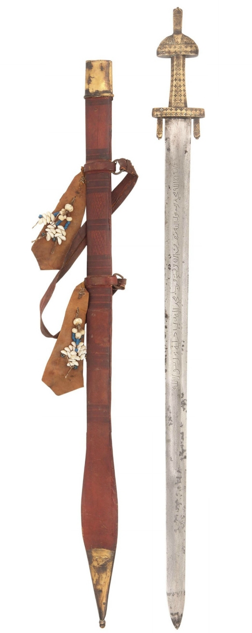

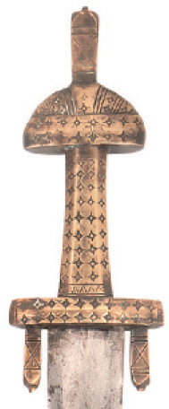

This finished recently at Christies, fetching an enormous sum well above the estimate.
It is a very unusual sword with odd finials on the pommel and guard, which if removed, would resemble very closely a viking style hilt.
Description from Christies as follows:
A LONG SWORD IN THE NAME OF MUHAMMAD AL-MAHDI
SUDAN, 19TH CENTURY
With straight blade inscribed in loose naskh script with the Profession of Faith and the name of the Sudanese leader Muhammad al-Mahdi (La Illah allah Muhammad Rasul All Nasr min allah wa Fath Qarib Muhammad al-Mahdi Khalifa Rasul Allah "There is no god but Allah, Muhammad is his Prophet, help from Allah and present Victory"), one side engraved with a lion within a roundel and pseudo-calligraphic medallions, the hilt with an engraved lattice of quatrefoils, the leather sheath with cowry tassels
43¾in. (111cm.) long
I am having trouble extracting a large image from the Christie's website, but here's the link.
http://www.christies.com/lotfinder/a...f-80e8fe6fde47
It is completely unlike the kaskara of the region and not particularly resembling anything else I can think off. There is perhaps a slight resemblance to the hilt in this thread: http://www.vikingsword.com/vb/showthread.php?t=12979

This is a very lovely piece. Imho, it could be similar to Rsword's type but with abit of added creativity? :-) it belonged to the same person so it seems.

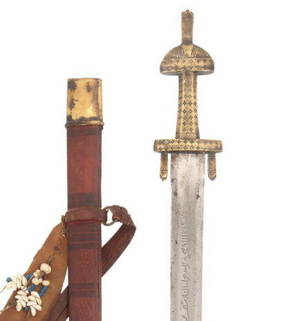

This is the highest res image I can upload directly.
Very interesting sword. The blade seems to have dimensions and shape typical of the kaskara trade blades, but of course the inscription is very interesting. The highly decorated and oddly styled hilt is extremely unusual to say the least. I'm having a little difficulty fitting the inscription and the rich hilt together since richly decorated swords are not a general feature of that era as far as I'm aware - but pretty much anything is possible if it was a gift.
Shame we cannot see the other side. I asked Christies for more pictures, but they never came - maybe they knew I did not have 15,000 GBP to spend
Hi Lofty,
Could well be another piece out of the Ali Dinar group. It could be something collected earlier than that as well (Dinar died in 1916).
My first thoughts when I saw it were the odd brass hilt kaskara like this one: http://www.vikingsword.com/vb/showthread.php?t=14711 Which seem to be presentation pieces.
However this item seems to have a very good blade and the brass looks better aged...
It is a bit odd to me the auction had no provenance attached, yet it reached such a price.
The oddest feature to me seems to be the spikes coming off the guard - has anyone seen anything similar?
EDIT: Thanks Chris for the higher resolution image! Very helpful. I had also requested more images from Christies but never received any. I particularly wanted to see the lion mark.

Am I the only person who suspects a modern repro viking sword hilt, with the odd spikes added to make the piece look a little more genuine and "africanized"?

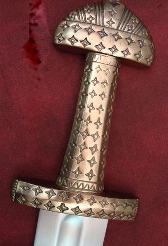

My first thought was that it appears to be built from a sword like this one.
(There are some swords like this made in India that are much cheaper than the Del Tin one above.)
A very good point.

Ouch! This does not look good....

That certainly looks like the Del Tin hilt dressed up with a few little extra knobs. The decorative motif is identicle.

I would say this is a composite sword. The scabbard has thin rings which indicates it was made post 1950 or so. The older scabbards had wide flattened rings. Looks like someone copied a Viking hilt and added some extra tidbits .

Wow - a good example of why its worth keeping tabs on all the modern sword catalogues!
I suppose this is at least a new variant on kaskara blades in medieval hilts

Thanks guys for all the comments and detective work. Certainly looks like Timo is spot on with the Del Tin hilt.
This is one of the reasons I wanted to post this here - something just felt off about it. I always get nervous when a one of a kind sword shows up that's supposedly genuine in a culture that stuck to a particular pattern pretty rigidly. I'd actually done a little photoshoped image without the knobs on this hilt to illustrate just how close, well now it appears identical, this was to a viking hilt. Obviously no need to post that now.
I guess this just goes to show the interest generated by thinking something is rare and unusual leads to some cloudy judgement and someone spending a lot of money for nothing - I am quite curious now where this ended up. The sad thing out of all this I think is that because Christie's sold it, it will probably knock around in the collecting world for quite a while longer as a genuine article.

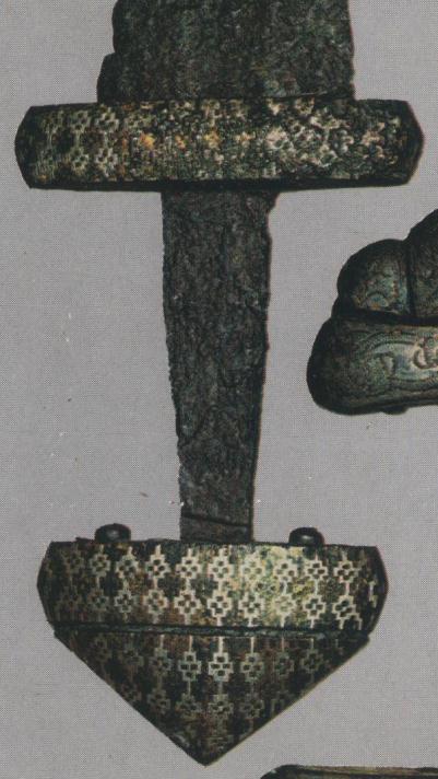

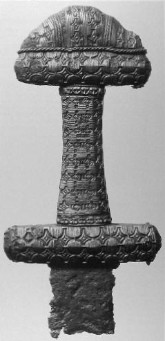

I think that the inspiration for the Del Tin is the sword shown on pages 44=45 of Ian Peirce, "Swords of the Viking Age", Boydell Press 2002. The sword is C1572, Nationalmuseet, Copenhagen. The hilt is bronze or brass over iron. There are some other metal hilted (i.e., with metal grip as will as metal pommel and guard) Viking swords known, often with silver or gold. This particular sword is nice for reproduction since brass is actually authentic (or close) rather than a substitute for gold.
The blade doesn't look like the Del Tin. But it does like like it might come from a modern repro. In particular, the blade past the fuller is diamond-section - I don't recall seeing this geometry on any authentic kaskara or kaskara0like sword. But it is very common on modern repros, since it's what you get when you start with a diamond section blade and cut a fuller into it. Usually, this makes a bad blade, since this means that the blade becomes thicker just where you want it to become thinner.
There are clones of the Del Tin, so if somebody doesn't want to invest Del Tin level money in a gamble like this, there might be alternatives. If it's a non-Del Tin, then the blade might be original to the hilt. On the side-by-side photos above, the edge of the Del Tin looks more rounded than the "antique".
I have a brass hilt a little like this. Undecorated sides - the pattern is only on the front and back, and the pommel is flatter front-to-back, included over the top, rather than rounded. Unfullered blade. But this one was at the cheap-and-nasty end of the scale, and there are probably others intermediate between this and the Del Tin. (This, or at least the blade, was intended as a pell sword, with the hilt perhaps to be recycled.)

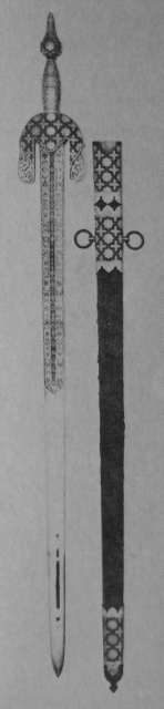

Flipping through an old sale catalogue, I found this - described as "a fine Spanish exhibition sword, in the style of the 15th century". Perhaps the inspiration for the hilt appendages....??
