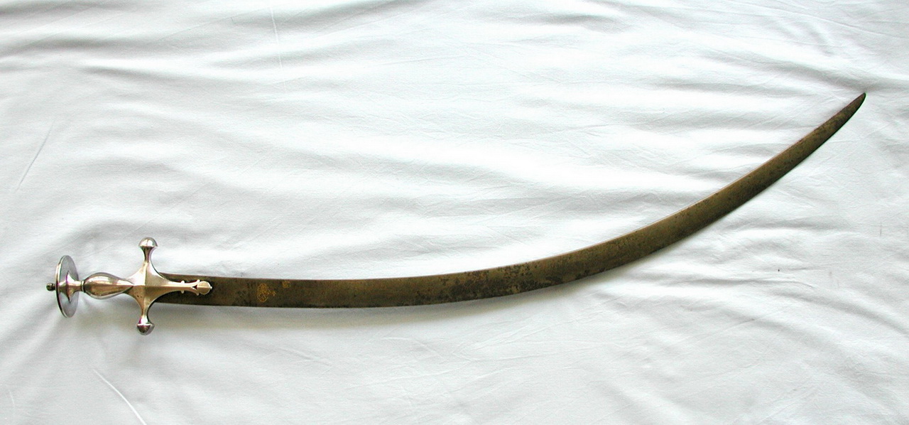

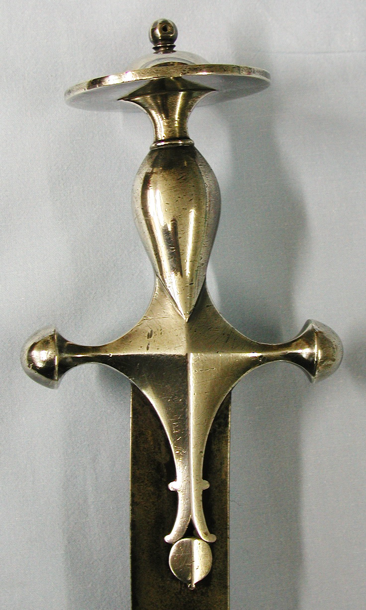

Here is one.
Jens

All right, to stick to the rules I also have to show the whole sword, here it is.

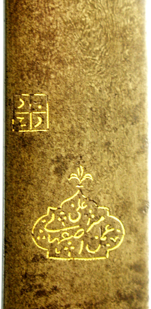

I dont want to deviate too much from the present discussion, but is this langet not an extremely different form compared to most other Indo-Persian tulwar hilts? It seems to me that entirely silvered Mughal hilts are quite rare compared to the usual koftgari patterns.
Have the cartouche and buduh been translated Jens?
Aside from the obvious attractiveness of this tulwar and its silvered hilt, there are other notable features which might reveal more on where other silver hilts might be known.
Erich asks a quite valid question, are there any hallmarks ?
With the popularity of silver hilts in the west in the late 18th century, perhaps the style influenced the princely states in India. In many other colonial settings, silver mounted hilts often had hallmarks in accord with western systems.

Eric, no there are no hallmarks, and I have, as far as I remember, nit seen hallmarks on Indian made silver hilts.
Jim, I have been told that the inscription says 'made by Mirza Ali'.
Silver Mughal hilts are not seen often, and you are right the end of the langet is most unusual - it is the only one I have ever seen.

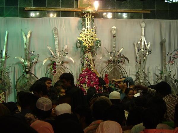

The langet reminds me of the Shiite Alams carried during the Moharram processions in India. Have attached a picture of some alams from Hyderabad in the Deccan. But again, these flags/symbols (alams) were and are still used all over the subcontinent.
Excellent comparison Nidhi! and the Sh'ia influences in Mughal courts would seem likely to produce this subtly appointed silvered tulwar, but still wondering what symbolism may be represented in the balanced orb.

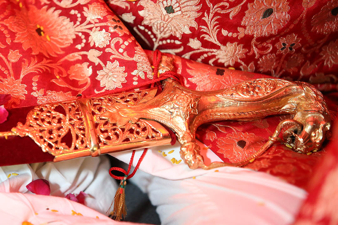

The first is on a shamshere blade, and the hilt is carved out of solid silver. It ends with a lion's head with the tail of a cobra in its mouth. It has recently been gilded in the traditional 'mullamma' process in Benaras. I unfortunately don't have an image of the blade with me presently.

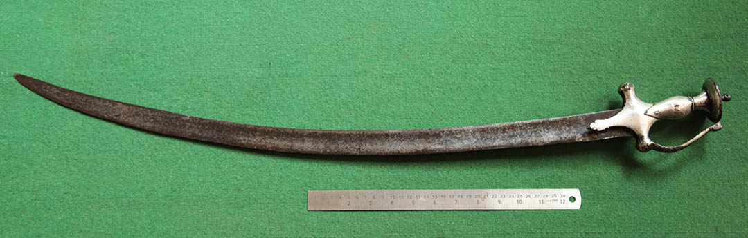

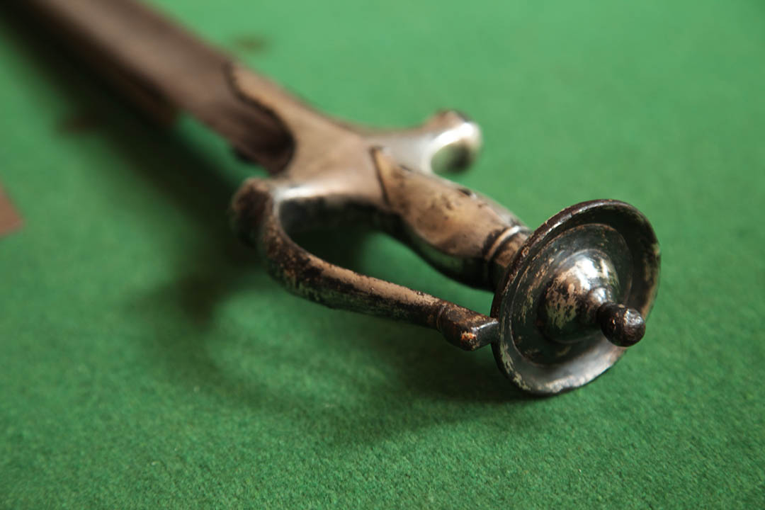

The second is a tulwar and seems to have a thick plating of silver on the iron hilt.
Thanks and best wishes,
