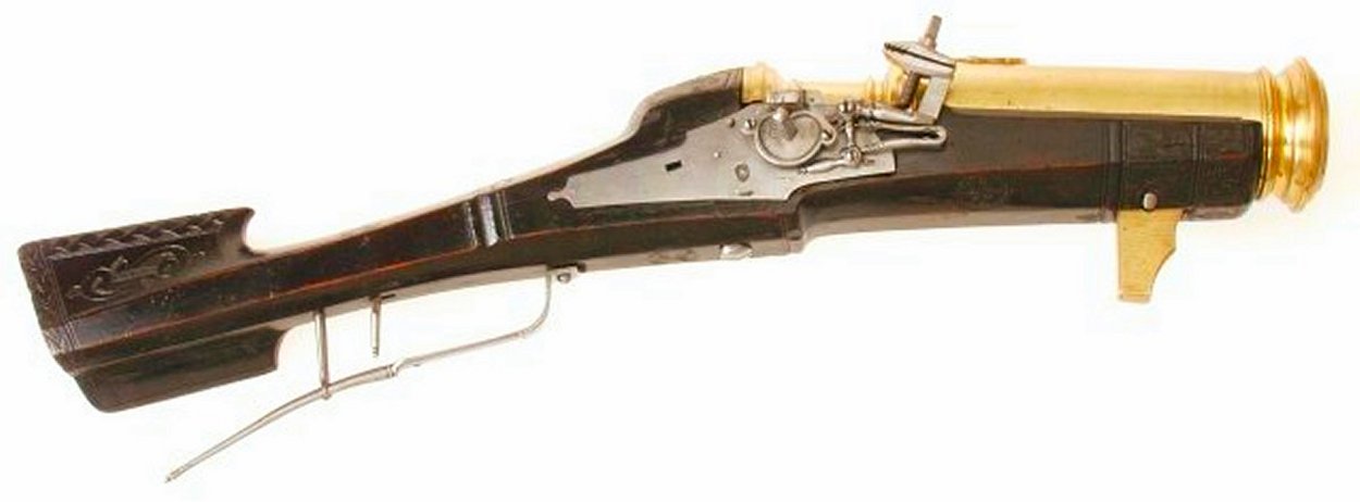

Two more instances in the Bayerisches Armeemuseum Ingolstadt, both equiped with wheellock mechanisms:
- the first Nuremberg, ca. 1590, retaining its safety-catch
- the other Nuremberg, ca. 1600, part of the inside mechanism missing
- a similar sample equiped with a wheellock mechanism and left-hand side safety-catch, Nurembeg, ca. 1610, sold Christie's, Oct 25, 2001
- and the only known illustrative source of period artwork, ca. 1600, showing the way a wheellock hand mortar was rested upright on top of the shoulder when firing.

Two very rare wheellock hand mortar pistols, ca. 1600, almost forming a pair; and a common wheellock mortar;
all Nuremberg, ca. 1590; in Skokloster Castle, Sweden.
A military pistol, ca. 1620, in the museum of Mühlhausen, Alsace.
And a fine Nuremberg wheellock mortar, ca. 1590, the trigger guard with hinged fold-out finger grip; in the Wallace Collection, London.
m

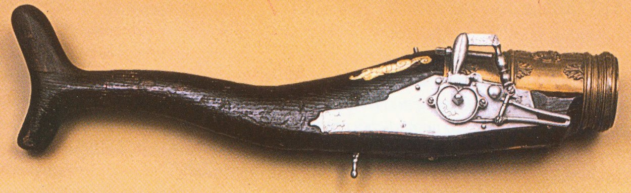

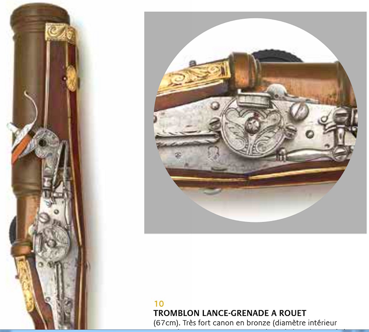

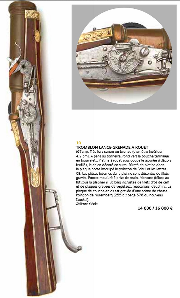

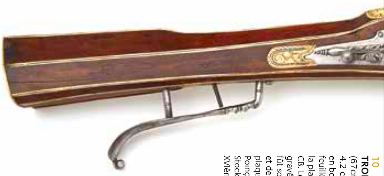

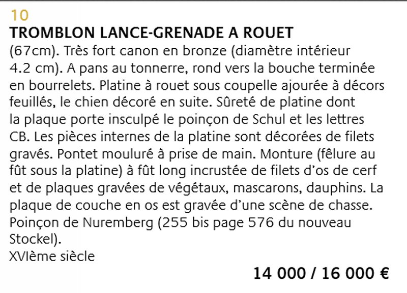

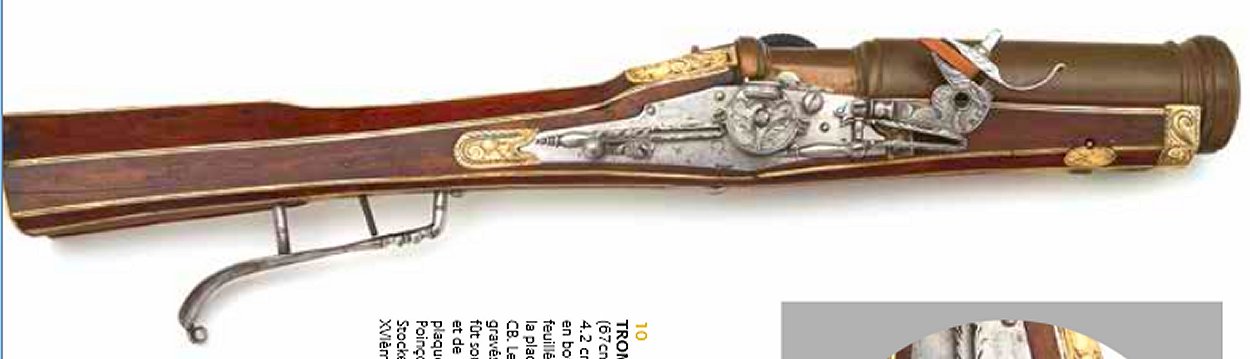

Default A Fine Nuremberg Hand Mortar at Cazo Auction House, Paris
The auction took place on Dec 1, 2013 but there are no results as yet.
Sorry for the quality of the images but their online catalog is in pdf only.

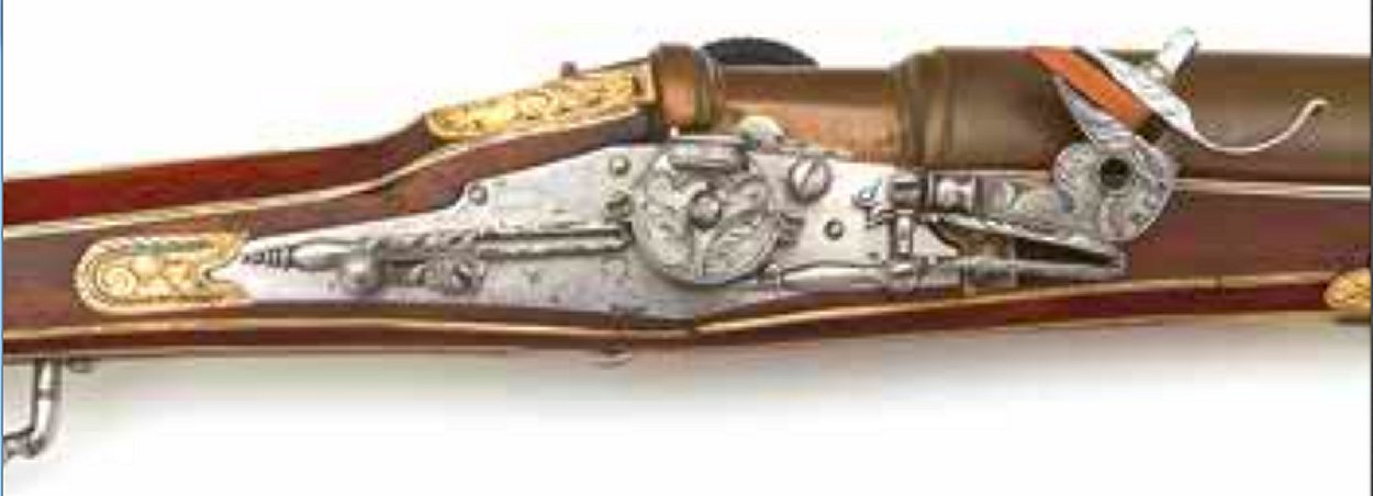

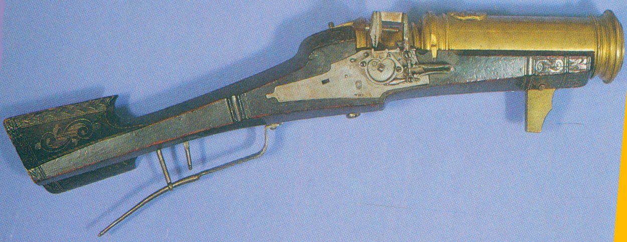

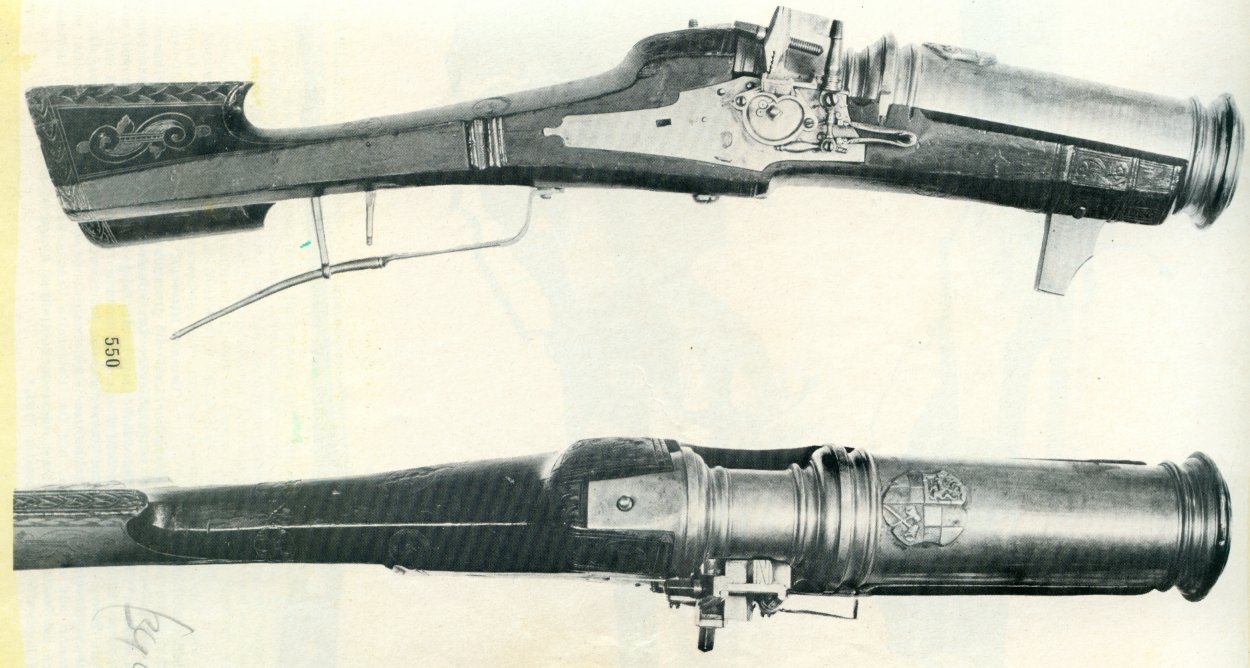

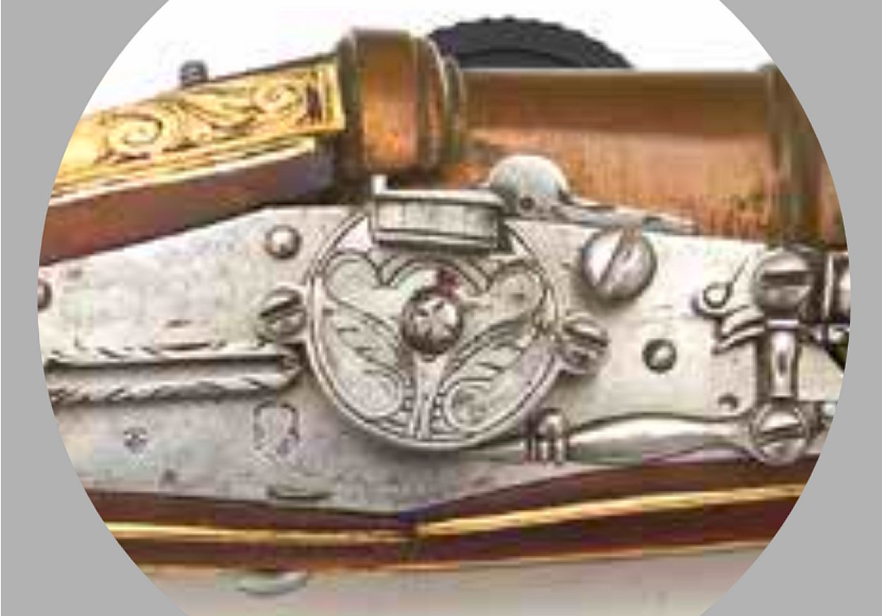

Now here is the story of provenance to a fine wheellock hand-mortar I introduced in post #3, its copper-alloy barrel cast in high relief with the city arms of Schwabach in Franconia/Bavaria, the blackened beechwood full stock carved in the characteristic manner of Suhl/Thuringia, ca. 1600-10, that is now preserved in the Bavarian Army Museum (BAM) Ingolstadt, just 30 km from where I live. A small part of the internal action is missing from the lock plate.
It remained unsold (!) at Sotheby's, London sale of Nov. 17, 1981, lot 52. Later it sold at Christie's, London, on July 10, 1985, at 9,000 euro, and it was resold at Hermann Historica, Munich, on April 26, 1986, lot 550, at more than 21,000 euro (all prices in today's money).

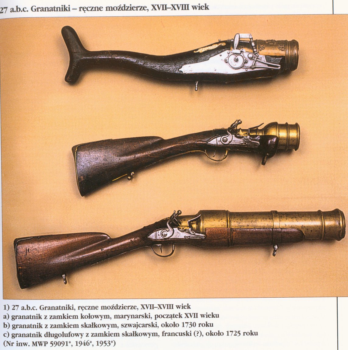

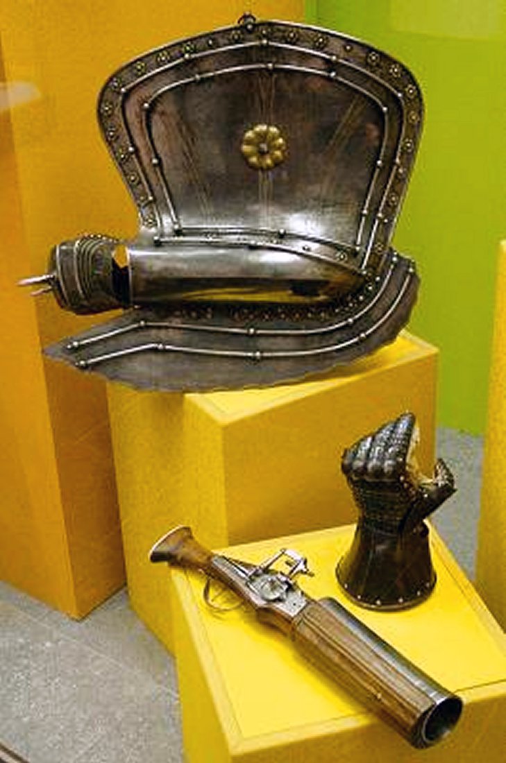

A wheellock grenade or fireworks launcher of ca. 1600, and two flintlock mortars, ca. 1740-50; all in the Muzeum Wojska Polskiego, Warsaw, Poland.

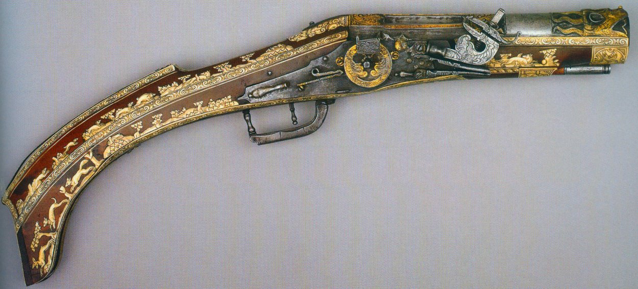

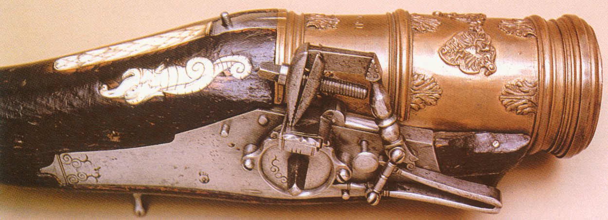

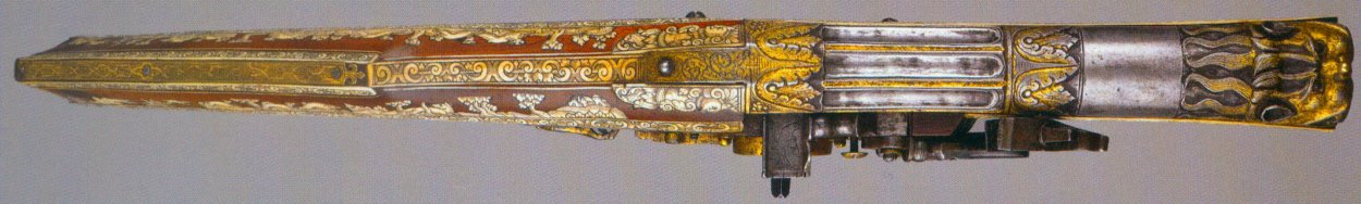

Better images of that fine Nuremberg mortar in the Wallace Colln. from post #4.
The description correctly points out the actual use of most of these finely wrought pieces: they were employed to launch fireworks.
The foldout trigger guard provided a tighter grip.
m
