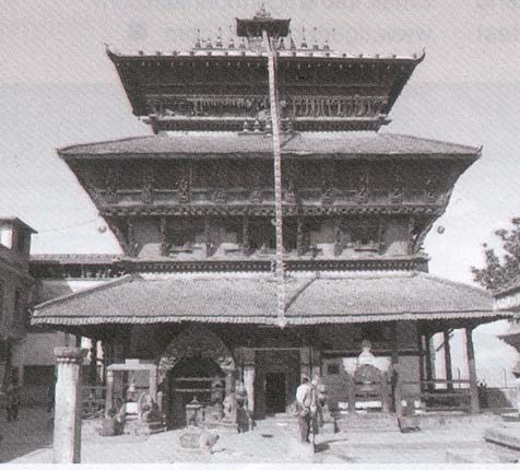

In ‘A Catalogue of Arms and Armour in the State Museum, Hyderabad, A.P., 1975’, I found the following text.
In the eastern parts of the Deccan, some new weapons seem to have been introduced to suit to the regional needs of the people. The ‘Kora’, which could produce deadly blows with its forward-curved and broad-tipped blade, appears, for the first time, in one of the sculptural panels carved in the second gate of the Mukhalintesvara temple at Mukhlingam, the capital seat of the Eastern Ganga monarchs.
The temple is datable to the second half of the eighth century A.D. It may, therefore, be presumed that ‘Kora’, the favourite weapon of the Gurkhas, had come in vogue by the middle of the eighth century A.D.
The age, of this sword type, will no doubt surprise many, like it did me, but also the place surprised me. Not north India and not Nepal, but Deccan.
The kora could have been used all over Indian in the early times, vanishing, and in the end only being used in north India and Nepal – but was it so, or did it travel north during war times, and ended up being adopted in the north but vanishing in Decca?

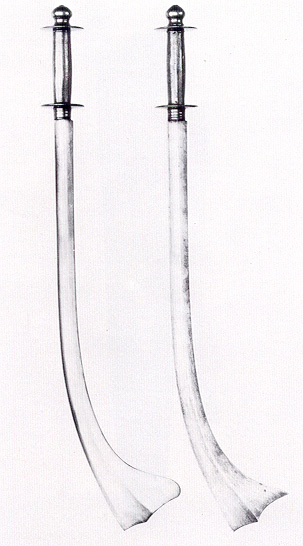

Hi Jim, from your mail it is clear, that you have put a lot of time into your answer – thank you.
In Hindu Arms and Ritual, page 252, Robert Elgood writes: “Kora, Nepalese, Bengali and Orissan sword, the blade broadening and curving slightly as it gets further from the hilt. The form is early though most examples date from the eighteenth or nineteenth centuries. Nigam states that it appears in a sculptured panel in the Mukhalingesvara Temple, Mukhalingam, capital of the Eastern Ganga dynasty, second half of the eighth century. Seven examples are in the Royal Danish Kunstkammer inventory of 1674 where they are described as East Indian Sabres. Another in Copenhagen has an Indian hilt and a Danish blade bearing the mark of Christian V.
The kora is generally described by modern writers as Nepalese but appears to be particularly associated with Bengal. A kora in the Kandy Museum, Sri Lanka, is said to be the weapon of the last executioner”.
I have checked the information about the Royal Danish Kunstkammer, and in the book Ethnographic Objects in The Royal Danish Kunstkammer 1650-1800, Copenhagen 1980, it says that in year 1674 they had seven and in year 1689 they had eight ‘Ostindische krumsabler’. The text is on page 107 and two of the koras are shown on page 108. King Christian V (1646-1699). I don’t know if the one with the kings mark has a Danish blade or not, as the book only mentions the items in the collection, the mark could also have been made after the kora arrived in Copenhagen. There is however a chance that the Danes made trade blades, as they had a small trade colony, Tranquebar, on the southeast coast of India.
I have mailed the Danish National Museum to ask if the blade with Christian V’s mark really is Danish made, and to which degree the Danes made trade blades for India – I hope I get an answer.
Quoting Robert I left something out, maybe I should not have, as he writes ‘See Bughalee’. It is also in the glossary, and says, ‘Bughalee. Term used by Fanny Parks in the nineteenth century as synonymous with a korah (kora). See Parkes II, p. 143. Then something about the koras in Denmark, and he ends. The weapon appears to be particularly associated with Bengal’.

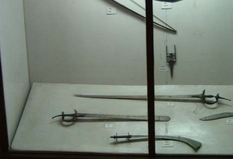

Jim, In the Nepali national museam , there are kora of the style we are most familar with, dating to the mid. 16th century. The oldest belonging to Draya Shah the founder of the Gorkha kingdom in around 1560.
I will dig out a photo. {not a brilliant one unfortuanatly.}

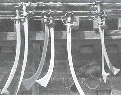

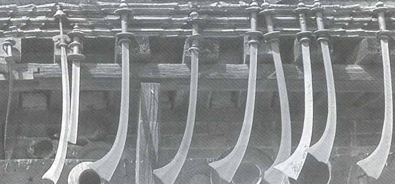

So, in Nepal we are back around 1560, with a kora style we are familiar with, I wonder how much further back it can be traced in the Himalayas. I may be difficult, as there were not many travellers in these parts at the times, besides caravans during a few summer months, when the passes were passable.
I must admit, the more I look at the picture posted by BI in post #2, it looks as if it could be a very early type of a kora, straighter than we know them, but then again, that is the way I think the sword must have started – but that is pure guessing on my side.
Earlier I thought that the kora could have been used in Deccan and maybe in Bengal, but now it seems as if it was a common weapon. Only in many books it is not even mentioned, which could mean, that it went out of use, the tulwar and the shamshir types taking over. Meaning the blades of most of the koras were made into tulwar and shamshir blades, as steel was expensive and had to be reused, old blades as well as when the blade tradition changed.
It is funny to think that for a long period of time, the Afghans ruled in Bengal, but the kora cant have appealed to them, or one would have seen it used in Afghanistan.
The only picture I have shows only two of the eight koras. Notice the different tips.

Heres the photo I mentioned, sorry its a poor one, it was the first display case ,I came across & I could see more aluring ones ahead.
Meant to go back to this one but got sidetracked.
Weapons of Draya Shah c.1560.
Spiral
photo. copywrite, Spiral JRS 2005.
may only be used with acknowledgment.

I couldnt find any descrepancies in likley dates on the kukri designs for at leat the last 200 years. The ones older than that did appear to be generaly design predecesors in a manner that seemed logical {although obviously that is not proof of anything!} & therfore I fully see your point.
Many of the tribes groups in Nepal {including the Chetri warrior class, the Brahmins & of course the Newari} are of heavy Indian as well as Mongolian linage.
According to the museam curators, ex Gurkha historians{ educated men of very senior rank.} etc.}, arms dealers,collectors & even ill educated villagers we spoke to the kora was the main battle weapon of the fighting man in Nepal until superseded by firearms. {Although the higher caste warriers & officers would often use tulwar or Khandra.}
The piles of kora in the museams & sitting rusting away in the villages shacks & old military stores is mind boggoling, & seems to confirm that military use was there primary use although in the last century they as you say are just used at Dashien .{we saw hundreds of them, 90% rusted beyond belief.{So sad when on a few you spot the occasional old gold & silver inlayed ornate carving.{& yes I know the differance between brass & gold. }}
Fighting kora in Nepal come in all shapes & sizes, blades from 16 in. to 3ft bieng common. 2ft to 30 in, are certanly the commonest though.
Some exceptional museam pieces are nearer 4ft.
Heres a photo of Bag Bharirav temple in Kirtipur that was eventualy sacked by the Gurkhas in 1769 with many of the weapons siezed from the Kathmando defenders.{the Gorkhas had already siezed Kathamando proper by that time.}nailed around the sides at a hieght of probably around 40 ft.
The 90lb or so of ears & noses that they cut of the still living defenders are no longer visible though! {They spared the nose cutting of any man who could play the flute.}
The best of the weapons were of course siezed & as is the way in Nepal locked away until one of the the Palace armourys was opened, & the weapons are now displayed in the National museam.
A Fascinating thread this one! Although I find the Mentioning of the various countrys rather inprescise when one considers how the tribes & peoples of Nepal, India, Tibet & Bhutan have moved from one country to another & interbreed both in times of war & peace {not to mention the slavery trade that was legal in Nepal until around 1930} & that parts of India were once Nepal & the Nepalis invaded Tibet at least 3 times, & that the vallys of Nepal have been a genetic melting pot for many generations. {I guess refugees frow war & religious persecution have always ran to the hills!{if one can call the himalayas hills!}
I wonder if further study of Indian & Nepali temples & art work could provide us more history of the kora particularily the earlier examples.

Hi Spiral,
Nice kora display you show.
I just had a mail from the curator of the Ethnological Department at the National Museum in Copenhagen, answering my earlier mail to the museum.
‘The museum had seven kora’s at the inventory in1674 and eight at the inventory in 1689. At present the museum has two kora’s, as one was given to the crown prince in 1845, two has been identified as being in private collections, and three has vanished into thin air so to say – many years ago.
Besides the kora’s, the museum has two khanda’s which entered the Kunstkammer in 1739, and one of these is mounted with a Danish blade, marked with the mark of king Christian V – why this is so is unknown’.
I was advised to contact the Armoury Museum in Copenhagen about the trade blades, which I will do.

Thankyou Jens!
I wish I had actualy managed to pick up some good Koras for myself In Nepal, as well as Kukris. Maybe if there is a next time?
I would be interested to hear what your military museam say about the trade blades.

Originally Posted by spiral
... Heres a photo of Bag Bharirav temple in Kirtipur that was eventualy sacked by the Gurkhas in 1769 with many of the weapons siezed from the Kathmando defenders.{the Gorkhas had already siezed Kathamando proper by that time.}nailed around the sides at a hieght of probably around 40 ft.
Spiral:
Have the weapons shown in the picture of the temple been exposed to the elements in the manner shown since 1769? If so, they are remarkably well preserved for such treatment.
