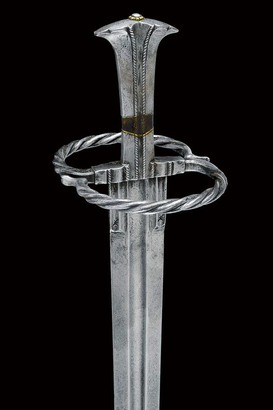

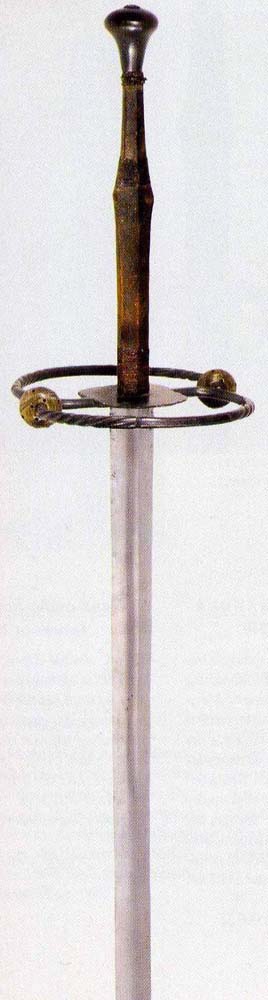

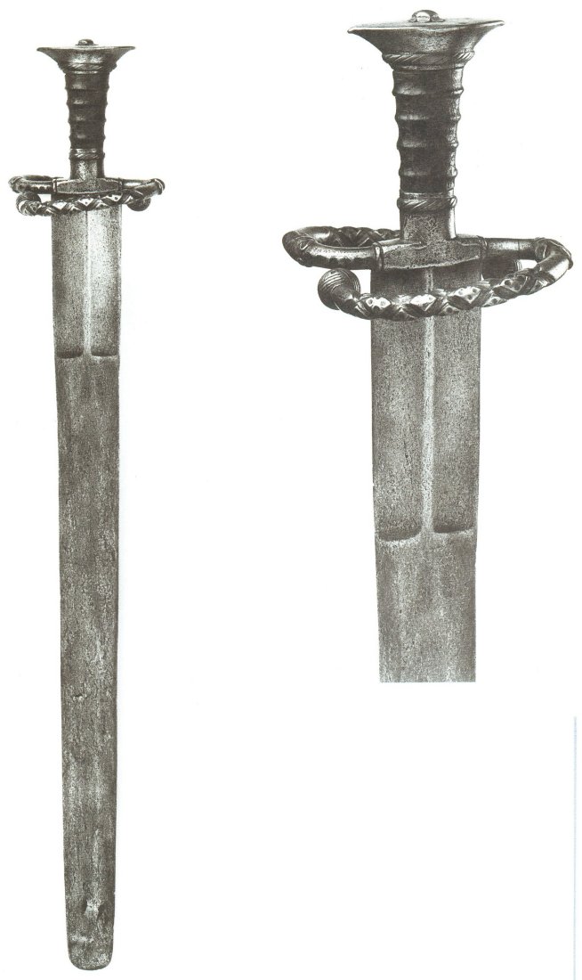

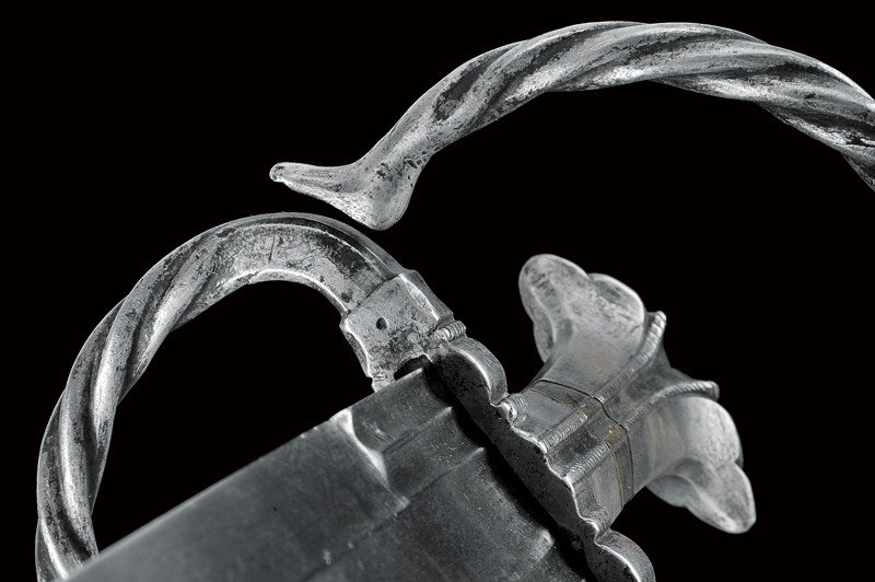

Another Katzbalger copy, 19th c., in North Italian early-16th c. style.
It is in the Tojhusmuseet Copenhagen, and an almost identical item is in a German private collection which has been published in a monography.
m
Old 3rd May 2012, 07:15 AM   #92
cornelistromp
cornelistromp's Avatar
Join Date: Mar 2009
Posts: 1,071
from the sale; the Karsten Klingbeil collection.
attributed to the 19thC.
Old 3rd May 2012, 07:35 AM   #93
cornelistromp
Join Date: Mar 2009
Posts: 1,071
to make life easy, a probably 19th century katzbalger sold as a 16th century one by Sothebys. and a probably 16th century katzbalger sold as 19th century by Czerny (black background).

Actually, this one was found to be absolutely original by my friend. He had known it for more than twenty years when it was in a North German collection, still heavily patinated but not for sale, not even for 20,000 Deutschmark.
20 years later, he recognized it at once at Czerny's though it got cleaned meanwhile, and he got it extremely cheap because nobody would believe!

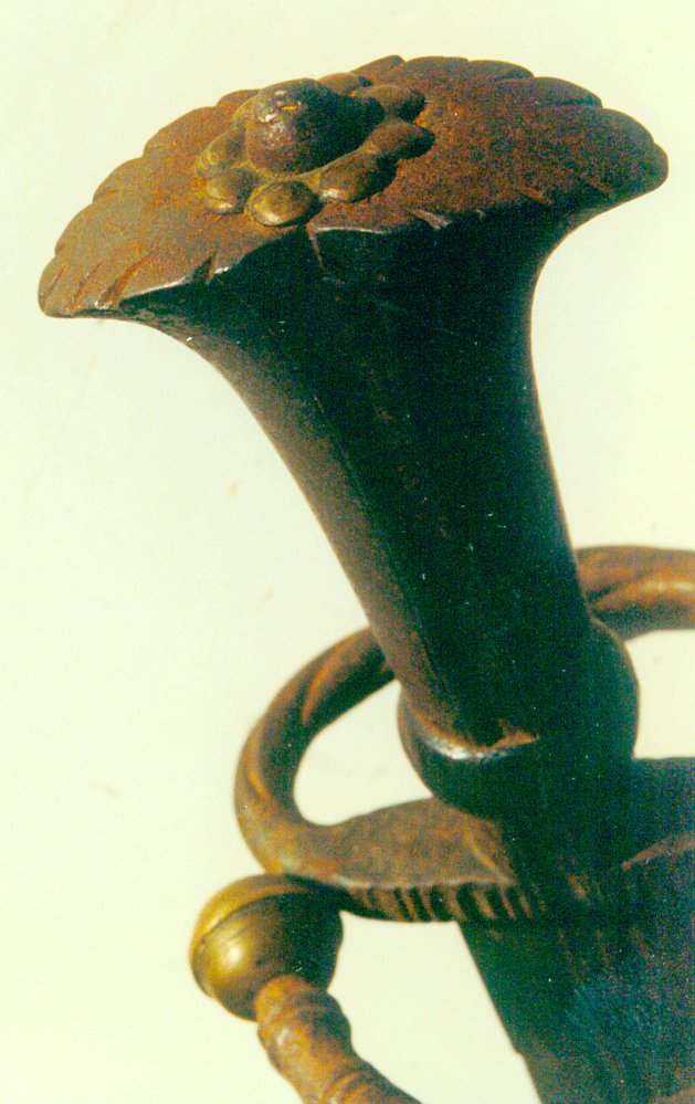

The sword in post #20 is indeed a replica, in my opinion.

Quite right, Dmitry,
I would say the blade with its way too many nicks looks 'overaged', apart from the fact that the sectioning of the blade (lenticular cross section) is not corrrect and the overall length is too short.

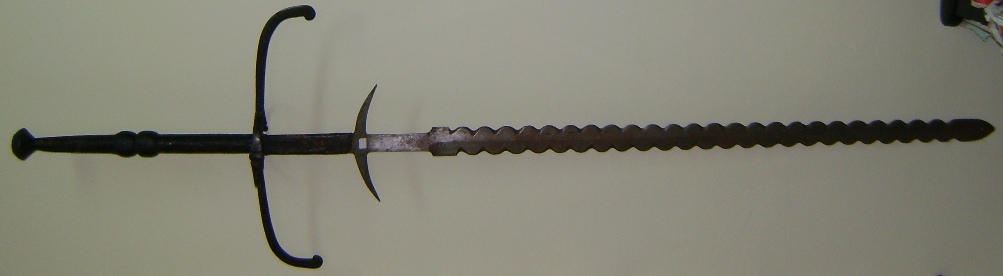

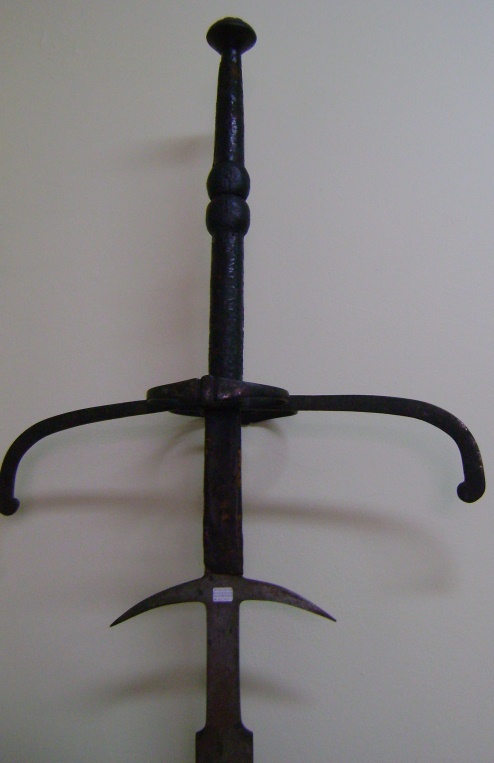

Old 17th June 2012, 02:53 PM   #104

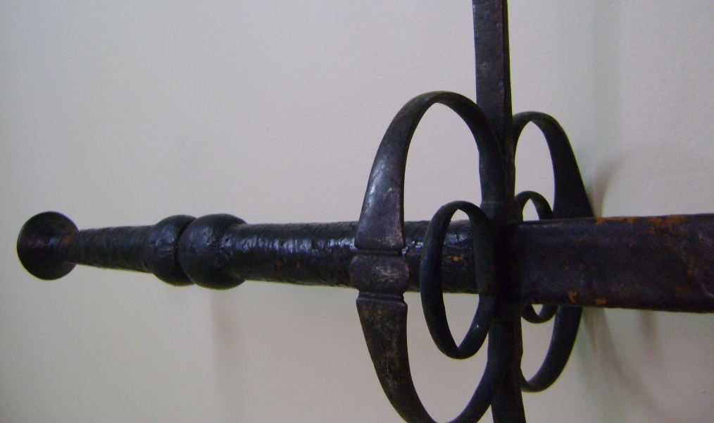

Default Back to two handers
How about this one?
About 2 meters length.
Dated circa 1590; German origin.
Transitional ?

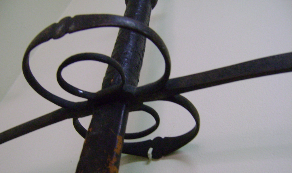

... (lousy) pictures allowed by owner.
Old 17th June 2012, 06:54 PM   #105
Matchlock
Matchlock's Avatar
Join Date: Sep 2008
Posts: 4,310
Hi 'Nando,
Generally this looks fine to me although the form of the quillons seems somewhat unusual.
Michl
The crescents on the blade don't look to inspiring either. The dozens of nicks on the blade were supposed to make it look like a battle weapon, I guess.

Exactly, Dmitry,
And to 'prove' the 'great age' of the piece!

Originally Posted by fernando
How about this one?
Transitional ?
@Fernando beautiful sword, thanks.
there is a possibility that the pas d'ane/donkey hoof is removed, in it's working life?, see pictures of the 2-handed swords for an almost identical sword, image the sword in the bottom center.
@Michael, the quillon form is quite rare but not so unusual, see swords form Landeszeughaus graz for example.
best,

Matchlock
Matchlock's Avatar
Join Date: Sep 2008
Posts: 4,310
Originally Posted by cornelistromp

Old 20th June 2012, 03:26 PM   #112
... there is a possibility that the pas d'ane/donkey hoof is removed, in it's working life?, see pictures of the 2-handed swords for an almost identical sword, image the sword in the bottom center. ...
Very good and attentive comparison, Jasper.
I will remember checking for any pas d'ane vestigial signs when i revisit the place where it is exposed.

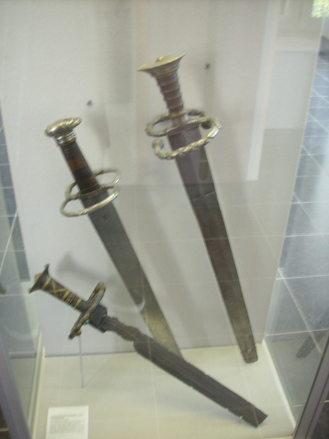

Old 21st June 2012, 02:48 PM   #116
Matchlock
Matchlock's Avatar
Join Date: Sep 2008
Posts: 4,310

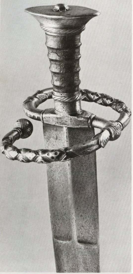

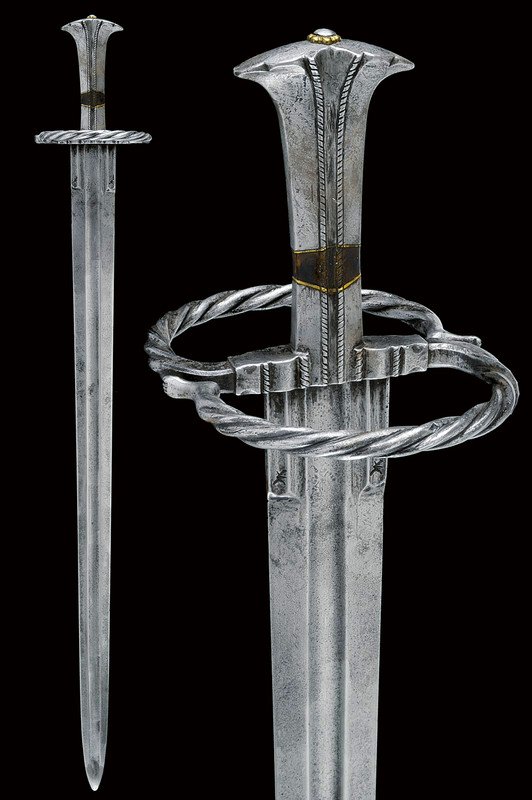

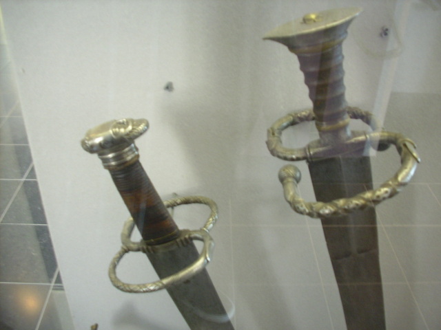

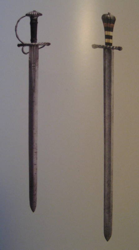

Hi Jasper,

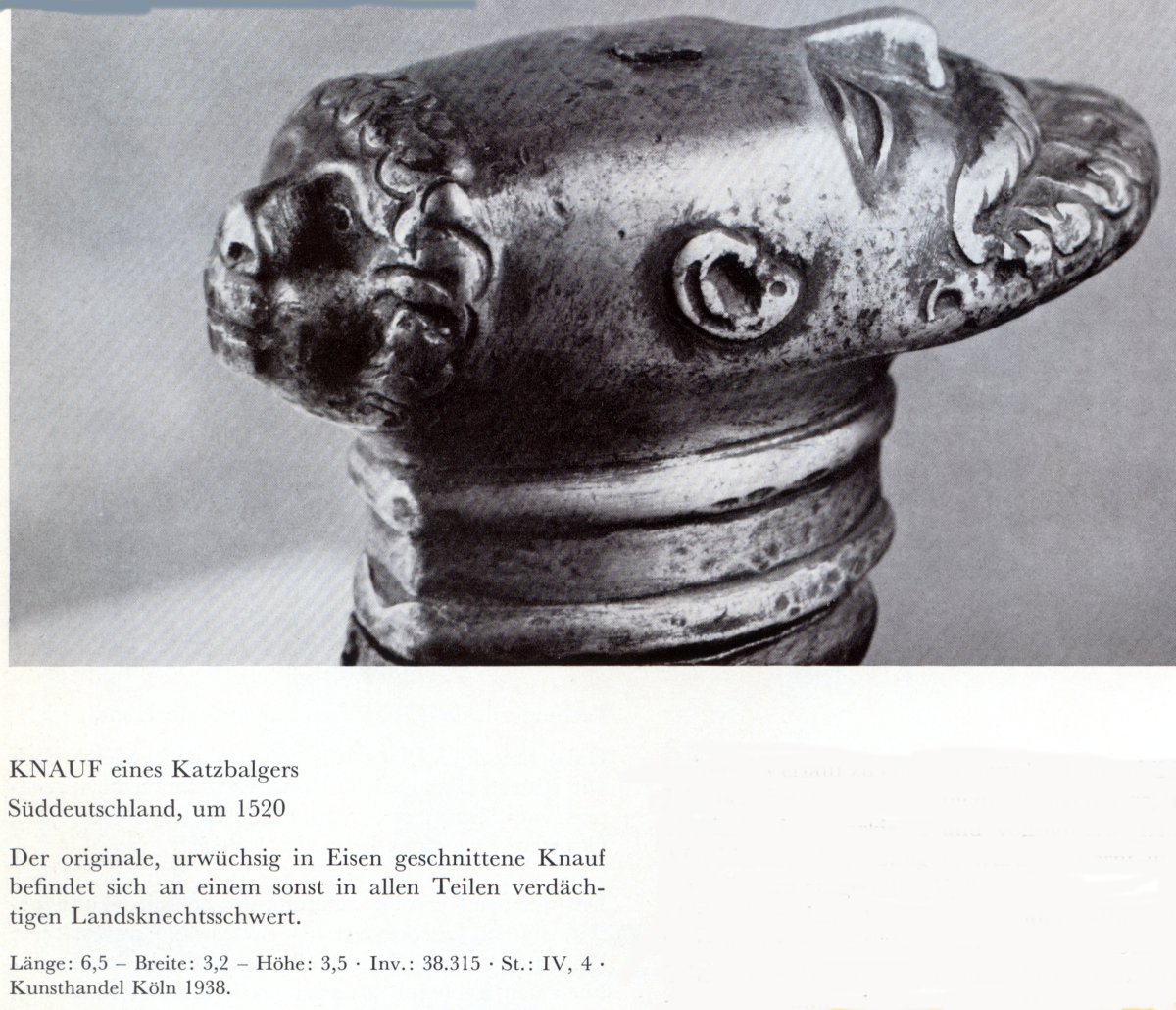

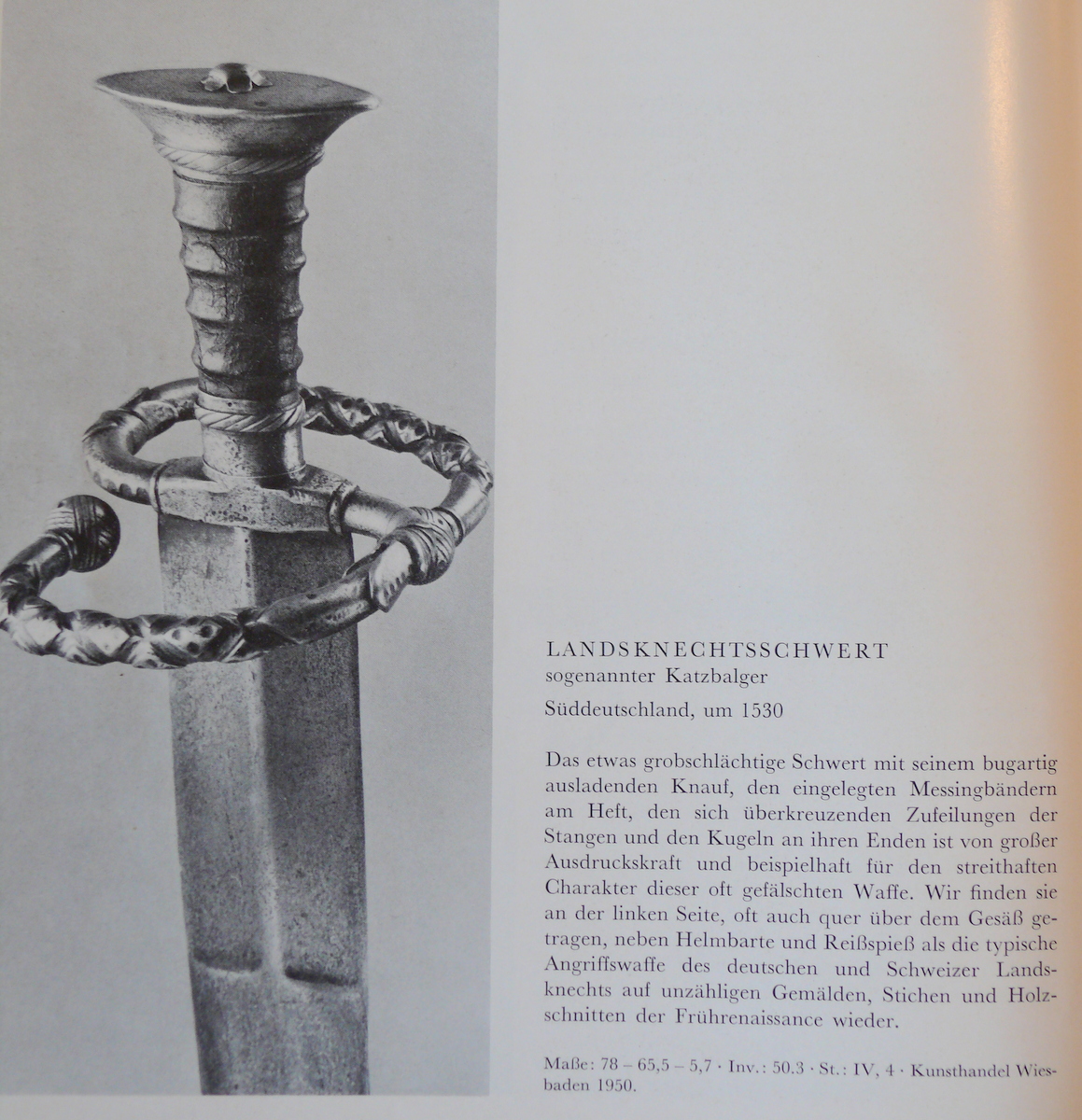

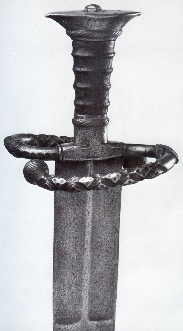

I am sorry to say that since at least 1968, the weaponry community has agreed that both these Solingen 'Katzbalgers' are composite pieces.
The first, with a hilt of characterisic form, is clearly the better or the two and the blade, typically staged and fullered (one of the main criteria I pointed out) may have been shortened (overall length only 78 cm); the 1968 catalog by Dr. Heinz R. Uhlemann points out that this type of sword is commonly forged (top three attachments).
The second is commonly agreed to be a crude 19th/20th c. fake, way too short, but reusing an authentic and finely caved pommel of ca. 1520 in the shape of a bearded Landsknecht's head. Only the measurements of the pommel are given, the remainder is neglected.
I realize your command of German is good, so the translation of the description by Uhlemann is for the rest of the community:
'The original, archetypically iron-carved pommel is part of a Landsknecht sword which is suspicious in all its remaining parts.'
(Kostbare Blankwaffen aus dem Deutschen Klingenmuseum Solingen, 1968, p. 46.)

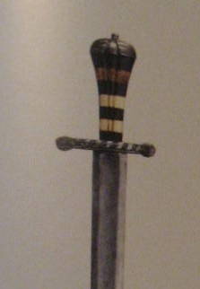

Old 21st June 2012, 04:05 PM   #117
cornelistromp
Join Date: Mar 2009
Posts: 1,071
Hi Michael,
yes I am familiar with this literature, the only DKM forgeries now with 100% certainty to be allotted,in this case to the workshop of Anton Konrad, are a dresden reiter degen and a medieval ceremonial sword.
The Katzbalger with the beautiful chiseled pommel is defined by Uhlemann as suspicious, but here the status left with the last publication before his retirement.
Both of them I've seen and both I find convincing enough, with the science of 1968 more atypical weapons were classified as fakes.
or you may have more recent results of research which I am not aware of?
I have no further written information about the other katzbalger, do you have something available? (from the weaponry community?)
kind regards,
Old 21st June 2012, 04:14 PM   #118
Matchlock
Matchlock's Avatar
Join Date: Sep 2008
Posts: 4,310
Hi Jasper,
There seem to be diverting criteria of what to define as characteristic and original; this not a problem at all, just normal among experts and it makes discussions all the more worth while. Otherwise weaponry would come to standstill.
No, to my knowledge no other publiations have been dedicated to the Solingen Katzbalgers since the 1980's, the time when Haedecke was in charge.
m
Old 21st June 2012, 06:15 PM   #119
cornelistromp
Join Date: Mar 2009
Posts: 1,071
hi Michael,
the first Katzbalger is dated by Uhlemann 1530 in kosbare blankwaffen (1968), in 1991, this same katzbalger is dated by Haedeke around 1550 in "Fuhrer durch die Sammlungen DKM" ". there is no mentioning whatsoever in either publication of any composite piece or shortened blade.
furthermore the length of 78cm is very acceptable for a Katzbalger,fe compare JP Puype, Arms and Armour of knights and Landknechts, katzbalger no 39 and no 40, resp. 82 cm and 80cm.
