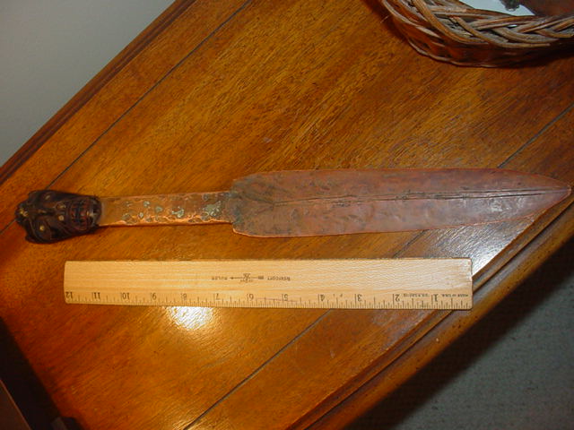

Hello, great site! I recently picked this copper dagger up and was told by the seller that it was American Westcoast Tlinget copper dagger. One of my friends indicated they thought it was more likely an African dagger. It measures approx. 16" long and has a wooden carved figure with tack nails through the nose which fastens to the copper handle. Also has mother of pearl inlay eyes. Hope the photos come up. Would really appreciate any info. Thanks!

Welcome to the EEWRS Forum. This one does not strike me as being especially African, so a Tlingit origin appears possible. I have little experience with North American pieces so I'll leave further comments to those who do.

The seller's right: it's definitely in the style of Northwest Coast Indians, and they did indeed make copper daggers.
Now, for the nasty question: is it a "genuine Indian Dagger?"
Dunno.
Here is a pdf containing images of "genuine" PNW metal daggers, and this one doesn't look the same, either in styling, blade shape, or patina on the blade. If yours is genuine, it's missing a good chunk of its handle.
Trouble is, it could have been made relatively recently by a Tlingit artist, which would, indeed, make it a genuine Native American copper dagger, although not an antique. If you're asking about whether it was made in the 19th Century or before, my guess is not, but I could be wrong.
It could also have been made by a white artist imitating the distinctive PNW style. Without further provenance information, it's quite hard to tell.

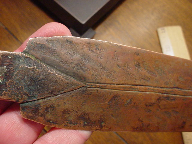

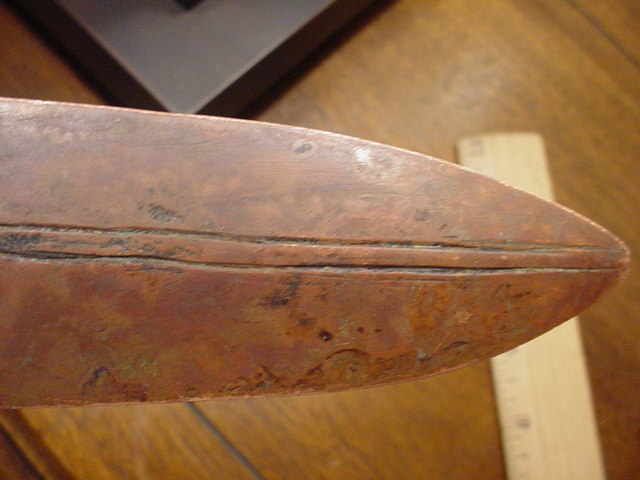

I do hope it's the genuine article. The lack of a patina is bothering me, and it makes me wonder if some "genius" (read this sarcastically) decided to clean the blade with acid. Either that or it's fairly new.
In either case, I hope you have good luck getting the provenance documents. In this case, I would suggest some skepticism with this piece and the documentation that comes with it. If it really is 150 years old, that age doesn't particularly show. This could be a result of good storage (if so, where's the grip?) or someone's overly thorough cleaning (perhaps the handle and blade got wet, rotted and corroded, and were cleaned off). Or it's a more recent piece and someone is lying about its history. More detective work is needed.

Fascinating knife. I, also, wonder about the age of this thing. There appears to be some oxidation present, particularly in recesses on the blade. If truly as old as the seller claimed, this must have been cleaned.
I understand Native American artifacts, particularly weapons, often command staggering prices. If you got a really good deal, it might just be too good to be true.

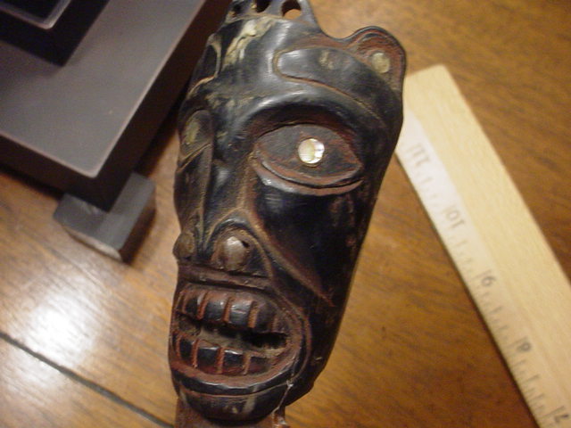

Thanks again fearn. I am a collector of Native American weapons and you are right there are some clever folks out there trying to make a quick buck selling reproduction pieces. I have made my share of mistakes, and hopefully I did not make one on this piece but it is possible. I would say you are right it has been cleaned in my opinion. If you look at the copper handle on the back side of the wood figure it appears to have not been cleaned and does appear to have the patina that would indicate an older piece.
The reason I mentioned the Tlinget laddle is the seller indicated that the laddle and a fancy Tlinget neck piece also came from the same individual who had the dagger. Not sure if that is any indication of authenticity or not. Anyway I will check out the provenance tomorrow.
What is your take on the carved headpiece at the end of the handle?

To be honest, that mask bugs me. It's the one part that looks old, although as Andrew mentioned, there's a bit of corrosion in the blade itself.
The thing that's bugging me is that the web pictures of genuine knives tend to show the faces in profile to the blade--in other words, they're spun 90 degrees from the mask here. I seem to recall the same feature in the weapons in the old ethnographies.
Since the PNW people had a strong tradition of mask making, I've been playing with the idea that the handle may have been an independent mask (basically a piece of costumery on clothing) with a button-like loop in the back. The "mini-mask"--which may be 150 years old, from the darkness of the wood--was then secured to a blade that's much younger. If so, there may never have been an entire handle. This is wild speculation, of course, but it does get at the central oddities of this knife: young-looking blade and old-looking pommel, attached at an odd angle.
Neat knife, and neat puzzle. I'll be interested to find out the rest of the story.

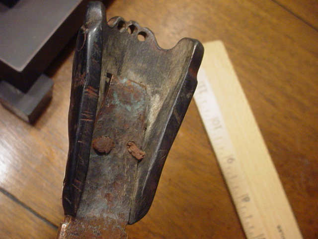

The pommel of your dagger appears to be "in the style" of NWC art. It is
possible that it is native manufactured but by an unskilled artisan. The
construction (how the pommel is fixed to the blade) is also atypical.

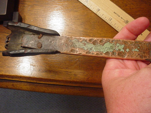

Actually, the museum people have another point we've been ignoring: how is that pommel fastened? It looks like it was nailed (or riveted) through the nostrils to two holes drilled in the blade? And the rivets are iron? (and rusty?)
Looking at the blade, the top was pretty clearly shaped for the pommel: there's a shelf where the blade was narrowed to accomodate the "mask."
Whatever the "rivets" are, the blade behind the pommel seems to show more of a patina than the rest of the blade. My new question is, can we believe that we're looking at 150 years of patina there?
Personally, I don't think so. I'm getting pretty skeptical about the purported age of this piece.

Well, you are comparing the patina on two different metals. Copper tends to stabilize more quickly than iron. The copper behind the pommel would not have been subject to as much contact as the handle and blade, so wouldn't the patina there naturally become deeper? The handle and blade were probably regularly cleaned and worn with use, even, preventing the building up of a patina at all until the item went from working tool to historical artifact. There are also a few explanations for the presence of such "new-looking" rust on the rivets, such as again the fact that rust might have been kept off while it was in actual use, then took hold after it was collected put in a drawer somewhere (they might even be replacements for old ones that rusted away).
I'm just saying that we shouldn't reach any firm conclusions based on the rust on the rivets and differences in the copper patina.
Somthing Jose wrote a while back surprised me and I meant to comment on it. Mother-of-pearl was not available in the Pacific NW until the turn of the century? I would have thought that bits of mussel shells would have been a staple embellishment for a long time, and even abolone is found along the California coast somewhere (good trade item, there). Shell decoration was pretty common among other No. Am. tribes, I believe even pre-Columbian. An intriguing anthropological quirk.

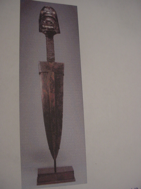

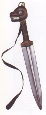

Hello Everyone! I have been surfing the web and found this Northwest Coast dagger that sold in one of Sotheby's auctions in May of 2000. Please excuse the bad photo. As you can see on this particual dagger the mask is not presented in profile as someone earlier had mentioned but is shown in full view - same as my dagger. This particular dagger meaured 21 1/2" and is decribed as follows: Northwest Coast dagger, probably Tlingit, that is 21 1/2 inches high, and has a finely carve horn veneer handle in the form of a "voracious sea creature. with thick lips, jagged teeth, flaring nostrils and hollowed eye frames with classic ovoid eye rims, holding a shaman figure in its caping mouth. This one is a ceremonial dagger. I would assume mine is ceremonial also?
tomahawk
tomahawk is offline   Reply With Quote
Old 1st September 2005, 05:31 PM   #27
Posts: 6,000
You can see the simple but exquisite aesthticism of these magical pieces. Tim

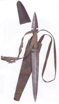

It would not surprise me if it were ceremonial in nature, if for no other reason than a little mask on the handle wouldn't be very practical (or long-lasting) on a working knife.
If I am not mistaken, the Tlingit use specific iconography in their mask and totem carving to represent particular spirits. One would expect that these mini-masks conform to this, so I wonder which spirit is depicted in yours and the one from Sotheby's? Each spirit watches over a different aspect of life (or death), and the identities of these particular ones might give some insight as to the ceremonial function of the knives.
Old 1st September 2005, 09:46 PM   #29
Posts: 6,000

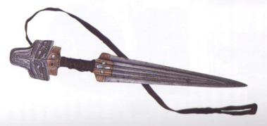

Here is another picture which according to the source has a mythical bear looking to the side. The rather bright file marks on tomahawks knife are not what you would want to see I have to add. Tim
