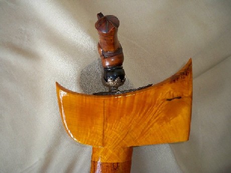

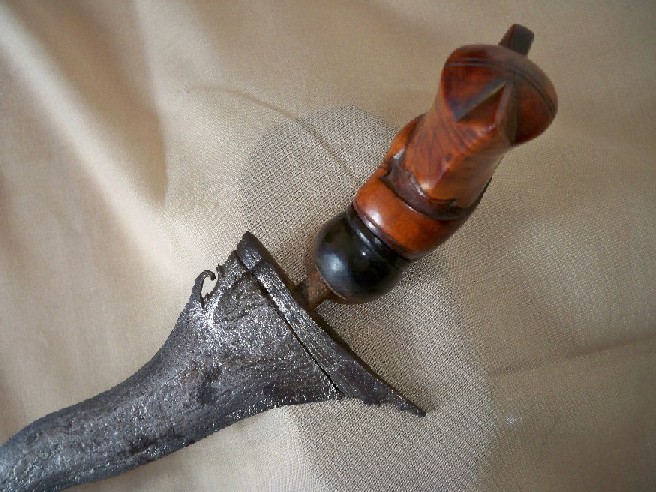

I had the good fortune of acquiring this from a fellow forumite some months ago.
Upon inspection it has an interesting composite hulu jawa demam of really old kemuning, somewhat upright, with a buah pinang from dark coloured buffalo horn.

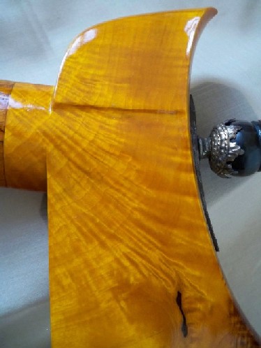

It was then entrusted to a craftsman from Terengganu who selected a piece of kemuning with flashing grains and some sena wood for the batang. I asked him to attempt a broad, Bugis style sarung, maybe not quite sarung penghulu but close enough.
I was fortunate enough to find a smallish pendokok to fit the hulu. In doing so, I noted that the size of the puting is somewhat larger than the diameter of regular Peninsula/Pattani blades.
Am quite happy with the completed work and really enjoyed the whole project.

Let us enjoy your completed restoration works as well. Pictures please.

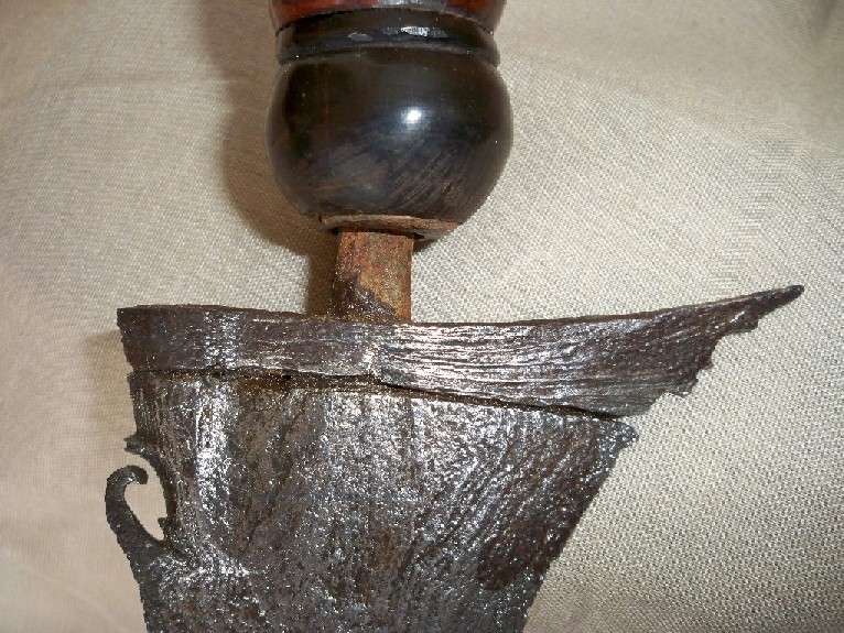

Default Closer look
Buah pinang

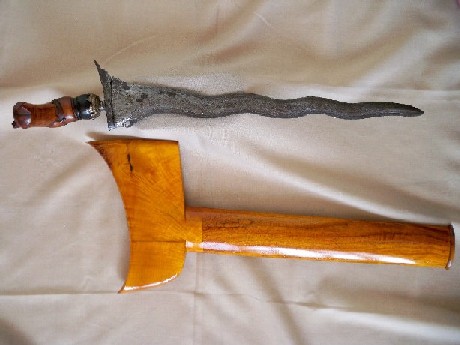

Default Keris views
Restored

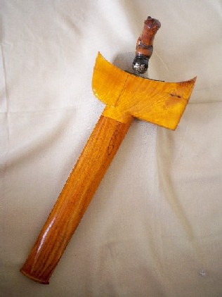

Default Keris views
Closer view of the whole keris

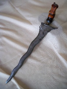

Default Keris views
Keris and blade

Congratulations, nicely done! Maybe think about to clean the blade a little bit more, I still see some corrosion.

Thanks Detlef,
Will get round to the cleaning this one, though I must confess I've also neglected some others in the keris cupboard that's due for some cleaning

Thanks for showing. Personally, I feel that the sheath vs the hilt and hilt ring is not proportionate. As for the blade, it would be better to adopt a more 'peninsular malay' look, rather then the 'steely look' at present.. but then again, it's a matter of personal preference. Congrats..
