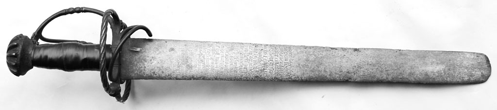

I attach images of a group of those North German two-hand swords acquired as 'Vortragschwerter' (processional swords) by the town council of Emden in ca. 1615 (!), and still preserved in the Emden Amory; one of them (see close-up) is comparable to the one in discussion.
The lower three photos taken by me in the Emden reserve collection in 1992 show a similar North German type, early 17th c., the grip missing, the ricasso with comparable engraved line decoration.

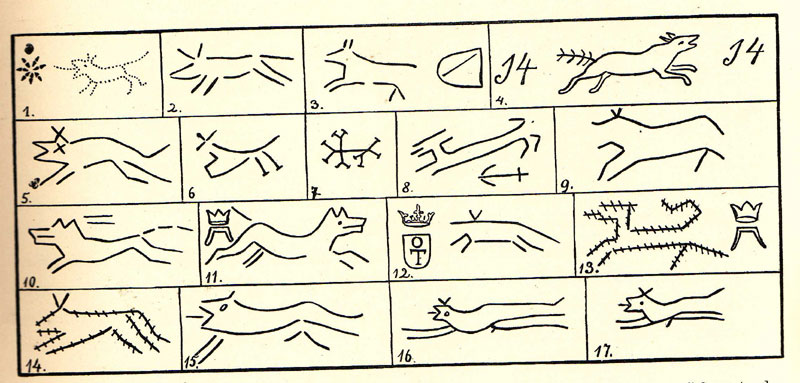

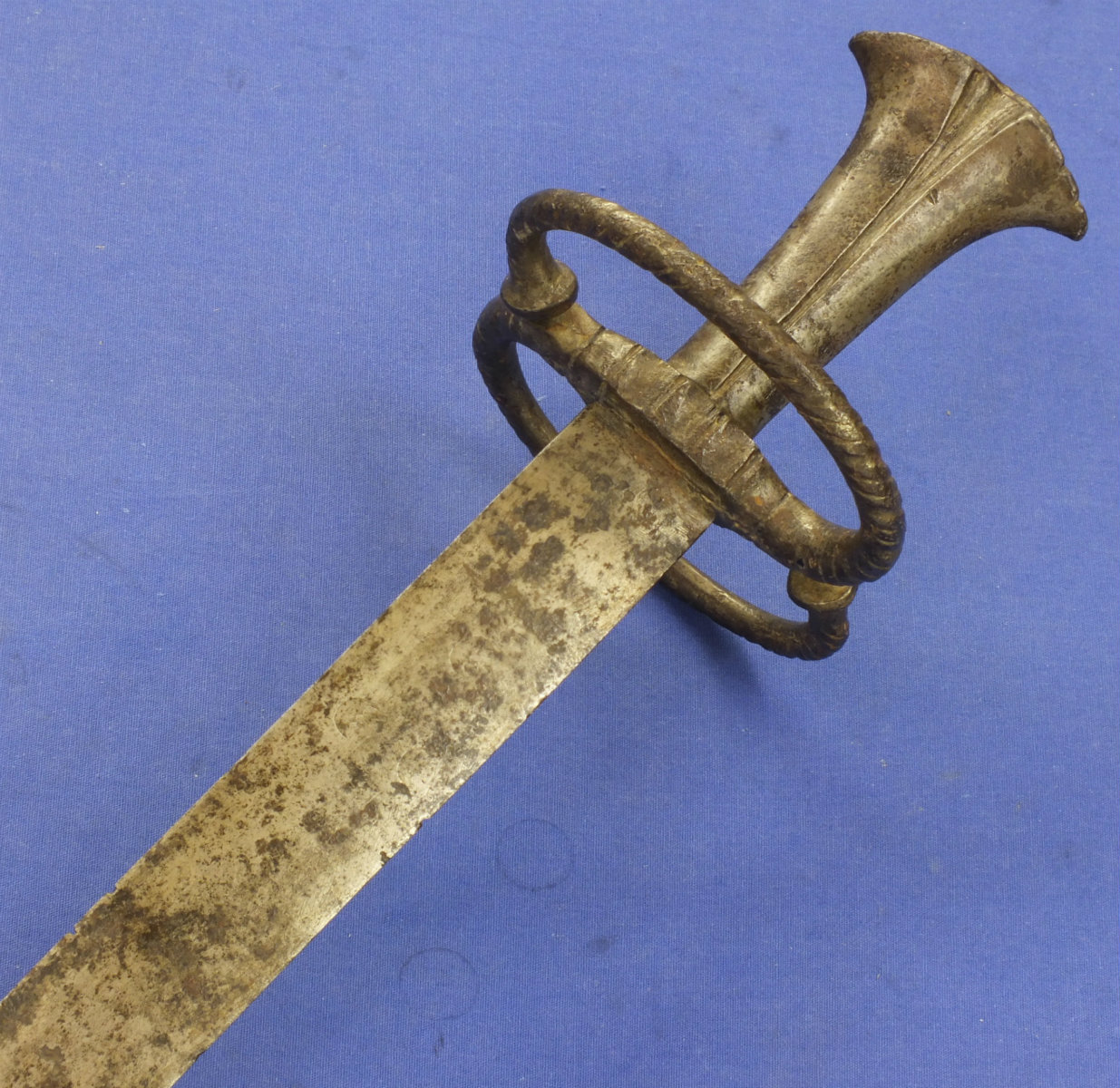

This 'Katzbalger' blade was shortened from a Tuareg sword (kaskara) and bears the characteristic crescent marks which were struck into the cold iron, in contrary to Northern European blades where the makers marks were always deeply stuck into the red-hot iron. The so-called 'wolf' and 'orb and cross' are just primitively and crudely scratched instead of cut with an engraver's gouge - nothing else! All original orb and cross marks are inlaid with yellow metal (line tausia).
In short, I am sorry to state that this is one of the most brutal forgeries I have ever seen ... my word on it! Return it as soon as possible.
Please study my thread on Katzbalgers and show me just one genuine sample with
- this kind of marks
- this kind of blade without the ricasso flutings!
Sorry but best,
Sorry but best,
I know nothing about genuine katzbalgers but I'm pretty sure that blade isn't from a Tuareg takouba or a Sudanese kaskara. The half moon stamps used are quite different on Saharan weapons (outline only, not stamping the entire shape like this, and are found in pairs, not the triple arrangement seen here. The profile of the blade also wouldn't fit for a kaskara or takouba. The scratched wolf and cross and orb are similar to some native African imitation marks however.
I don't have the expertise to judge the sword and obviously would bow to superior knowledge, but just wanted to say that the blade and the half moons do not correspond to any kaskara or takouba I've ever run across.
