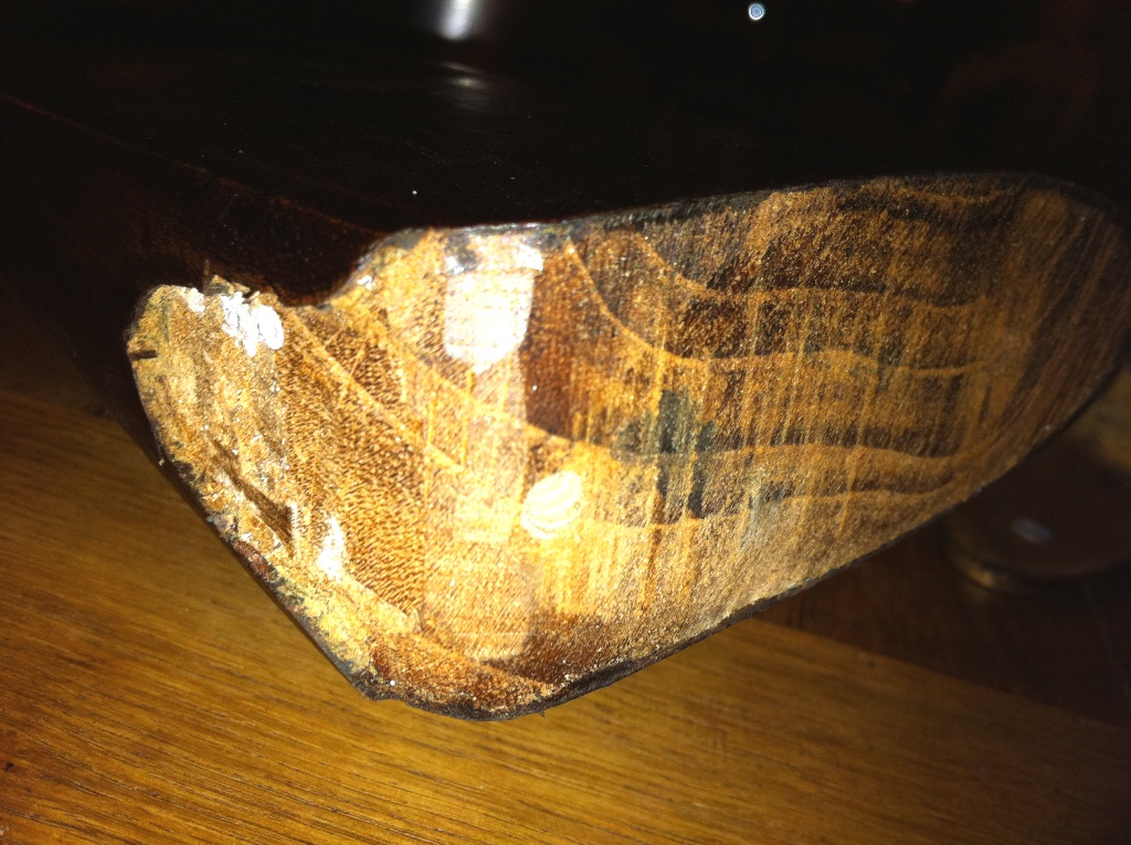

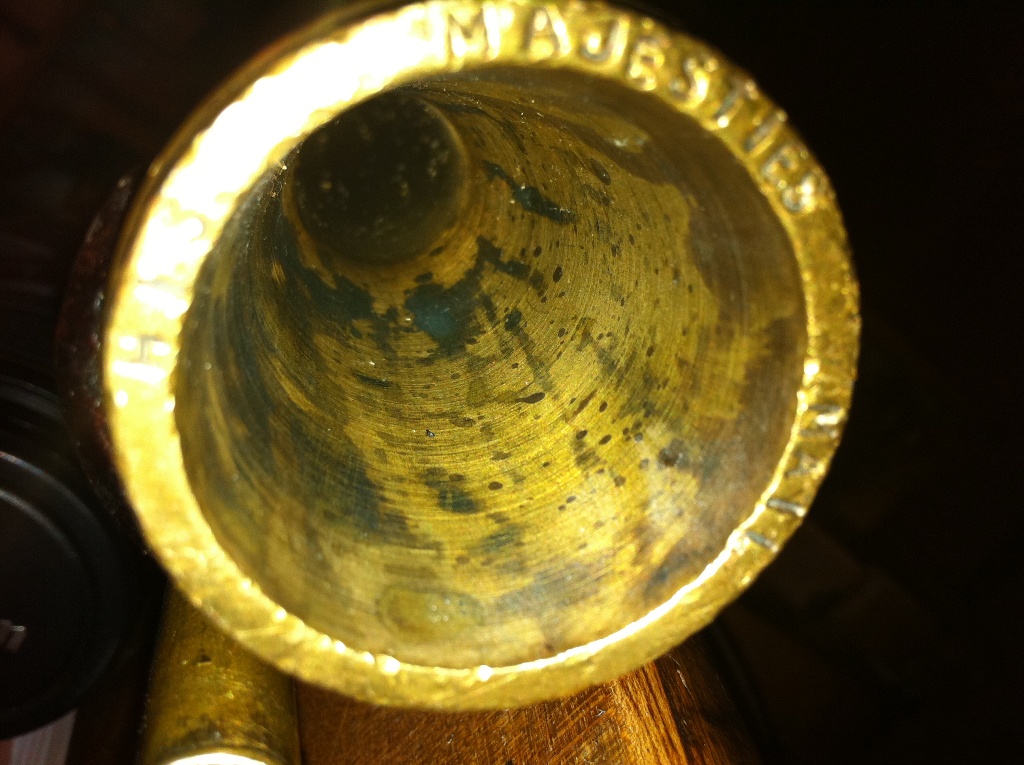

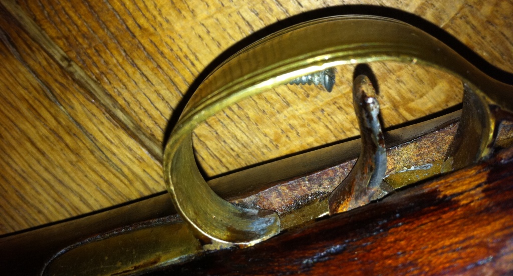

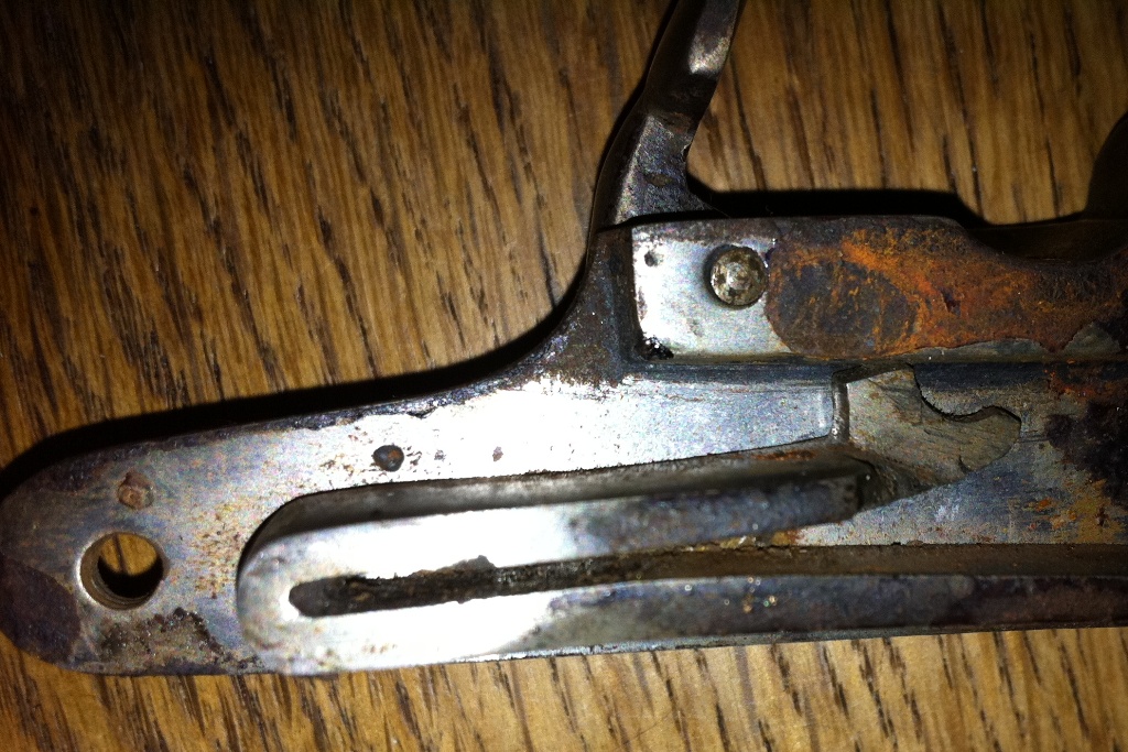

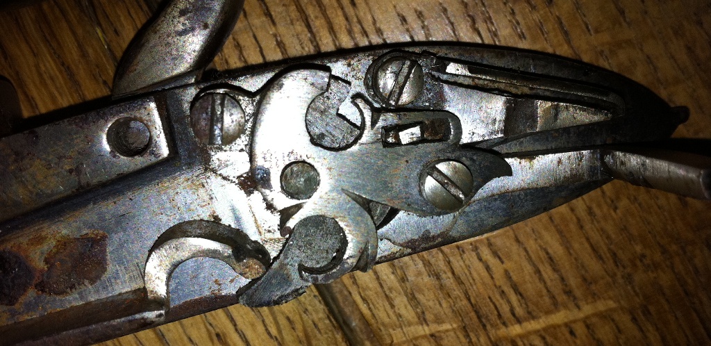

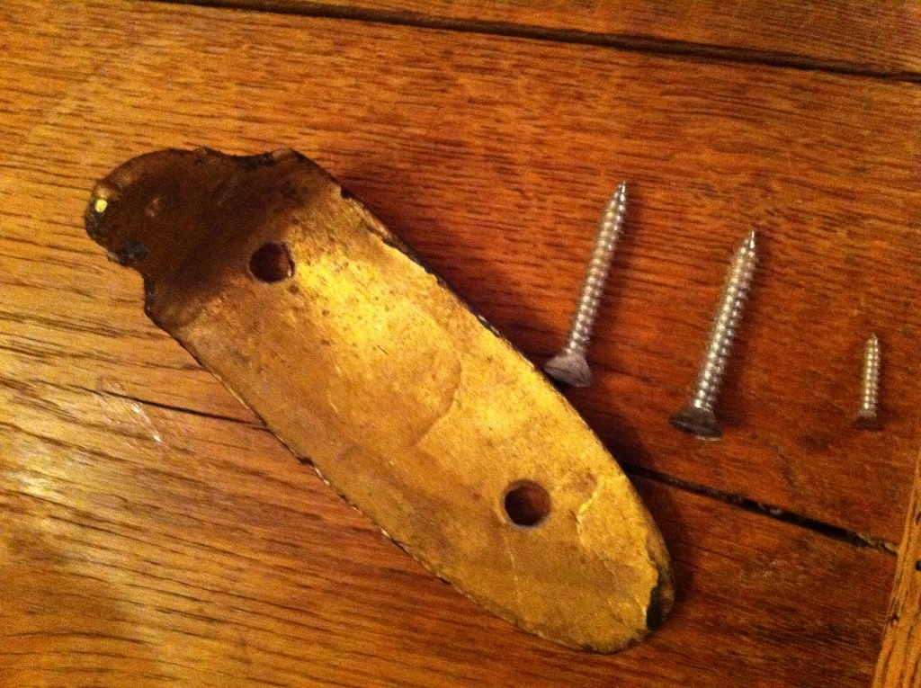

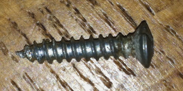

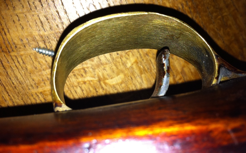

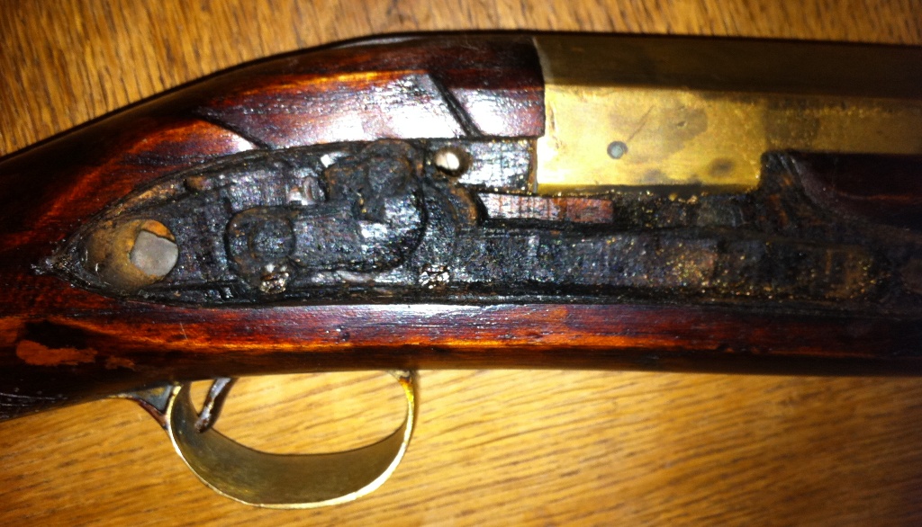

Default This blunderbuss was a fake !
You was right and as usually Fernando your felling was good .
After had removed some screw now I have many evidences to confirm yours opinion that it was a XXI th Century production and you could see it with those photos .( sorry for quality but enough to see)
This afternoon I will send back to this auction company who had sold me as "royal mail Blunderbuss from the 19 th century from the city of York"
AGAIN THANK YOU !
CERJAK

Posts: 10,851
Cerjak, I would like to thank you very much for your gentlemanly reception of the unfortunately very accurate assessment of this gun, which has has proven to be a modern commercial product. I am glad to hear that the auction company has taken a noble stance on accepting return, however I hope they will look further into providing more accurate descriptions in their offerings.
I also thank you for sharing detailed photos of the elements of this gun, which gives us all a very good lesson on the spurious items out there and what to look for. This item has also led to a fascinating discussion, as well as a great spin off on the very important topic of the use of serifs on stamped fonts, beautifully handled by Chris and Spiral.
Gentleman, an extremely impressive turn out on this, thank you all so much. I know Ive certainly learned a lot on these fascinating blunderbuss guns!
