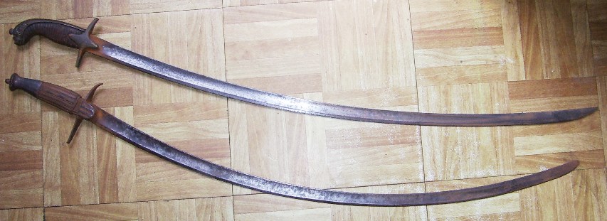

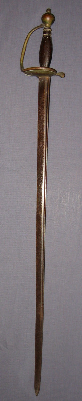

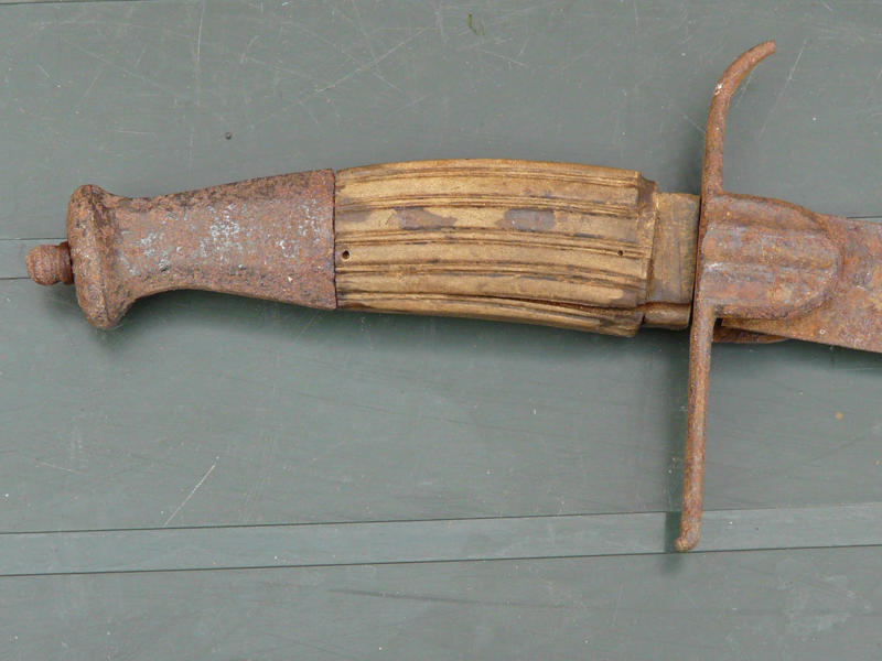

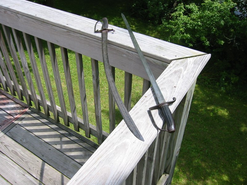

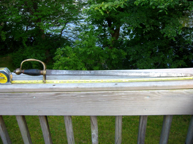

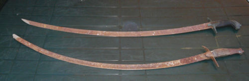

Does anyone recognise these 2 regulation (?) Sabres.
No dimensions as yet (swords not yet received) but several pictures to get the ball rolling. Condition is poor and the knucklebow from the lion headed pommel sword is missing. Not certain whether the other should have one or not.
I'm hoping that I can at least improve the condition of these 'old warriors'.
All comments, advice and information gratefully received thank you
Kind Regards David
Old 2nd August 2011, 04:28 AM   #2
Posts: 10,741
Hi David,
I'm about as rusty on recalling ID on regulation pattern military sabres as these swords themselves but off the cuff and without hitting the books (too tired for another excavation in the bookmobile) I would say the top one with fluted ivory appears to be American officers. The pommel resembles earlier French officers swords also, along with the fluted langet. Looks early 19th, for U.S.......Federal period.
The second example seems Continental European officers, probably latter 18th c. into early 19th, the langet seems Prussian or Austrian. Admittedly just guesses, but think the time frames.

Hi Jim ,
thank you ...I had seen French swords with a very similar pommel (on the fluted handled sabre) but they were shorter ....US could be a good call. Hopefully they will arrive soon and I'll be able to improve the description ... I suppose I should be a little more patient ...a few pictures isn't really much to go on All the best
Kind Regards David

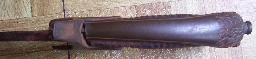

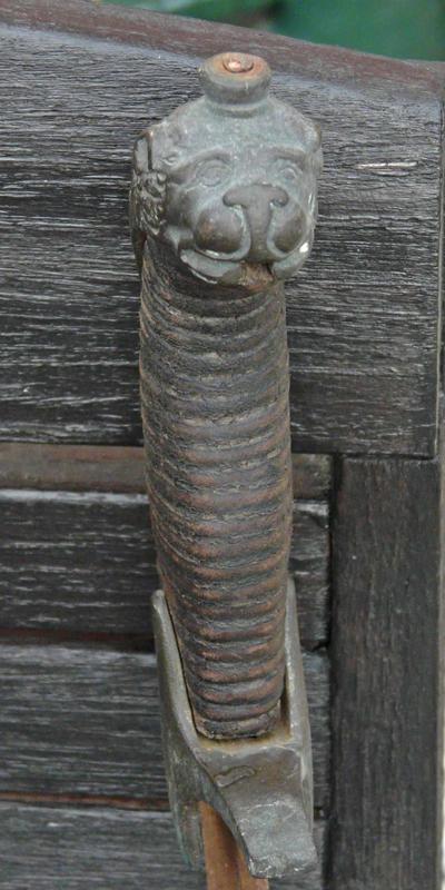

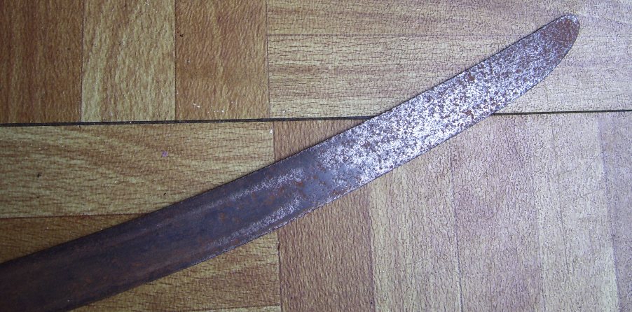

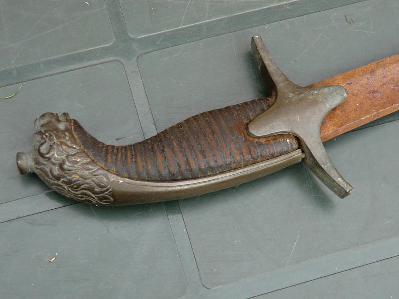

Swords have arrived....and have just had a quick basic clean....

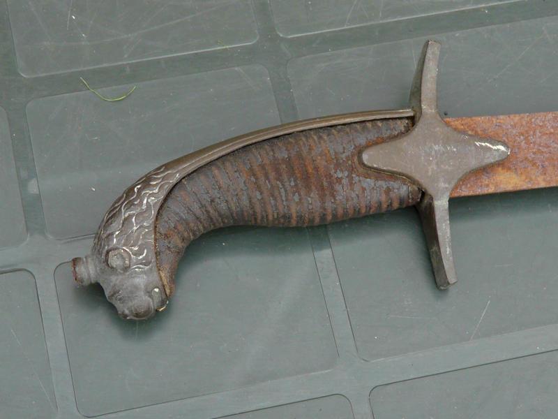

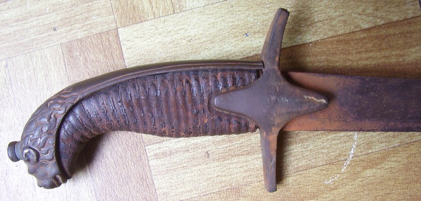

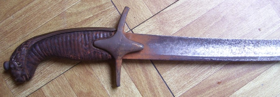

Lion head pommel Sabre has a broad single fuller which finishes approx 6 1/2" from the point. The blade has a sharpened false edge and the spine has distal taper and the edge is still quite sharp. Handle leather over wood...no signs of there ever being any wire wrap. The ends of the remaining guard look to be 'snapped' off ...rather than cut
Blade length 83cms/32.5 "
Blade width at forte 28mm / 1 1/8"
Spine at forte 8mm/ 5/16"
Any ideas Gentlemen ??
Kind Regards David
Old 4th August 2011, 06:44 PM   #6
katana
katana's Avatar
Location: Kent
Posts: 2,658

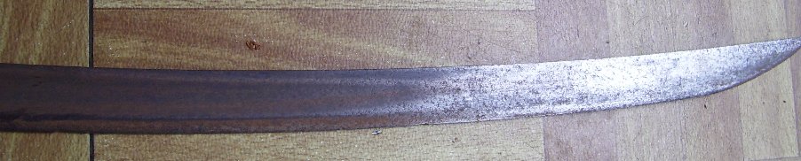

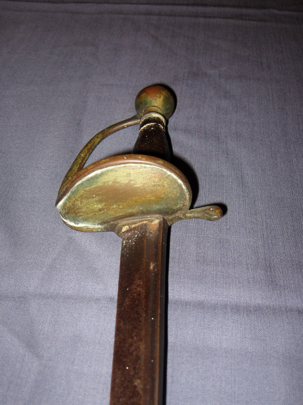

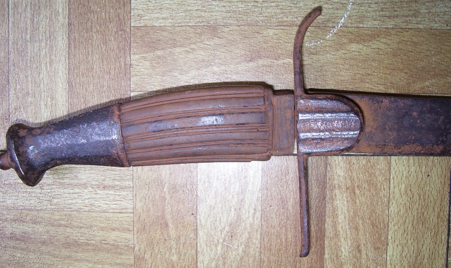

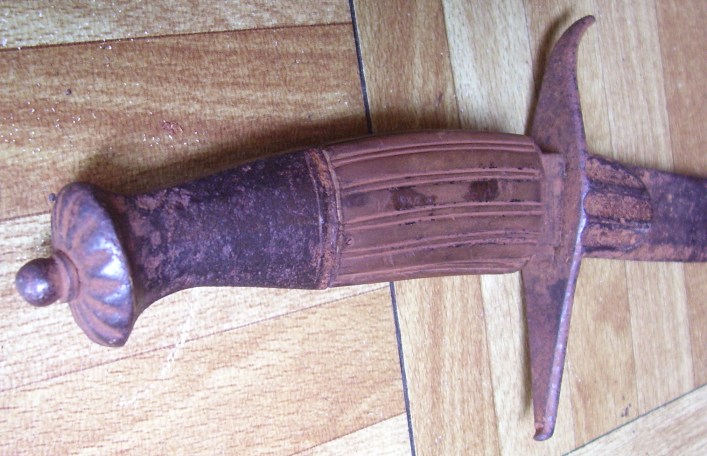

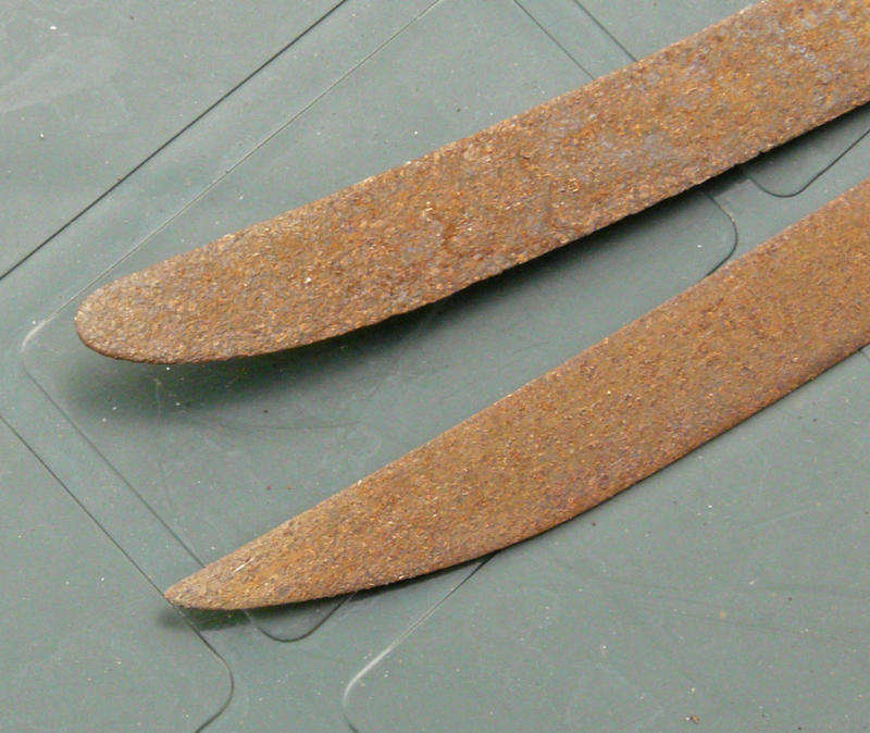

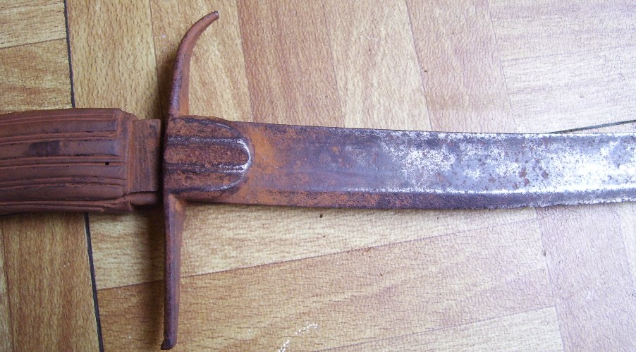

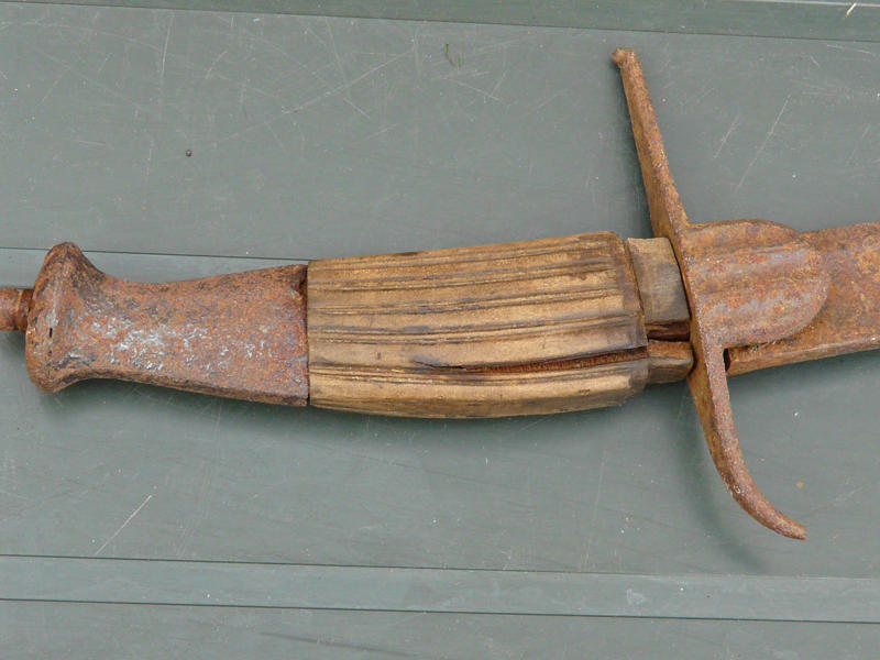

Fluted handle sword ....broad single fuller terminating approx 5" before the point, sharpened false edge, sharp edge and spine has distal taper. Handle material is 'organic' , no 'burnt hair' smell from 'hot pin test' ...so not certain what it is ...seems quite hard though (either through age or the material itself)
Blade length following curve 81cms/ 32"
Blade width at forte 28mm / 1 1/16"
Spine max thickness 5mm / 1/5"
Kind Regards David

Oh, i like the one with the organic material handle and the rather curved blade
Old 5th August 2011, 01:19 PM   #8
katana
katana's Avatar
Location: Kent
Posts: 2,658
Hi 'Nando ,
I do too....although the handle may have been fitted upside down....it handles OK as it is...but looks slightly odd but does follow the line of the pommel section.....the handle has a lenghways split in it and I believe was removed (without removing pommel nut) and refixed the wrong way round. As there is no movement I'm assuming someone has used aradite to stick it to the tang.
The sword is light and fast. Once identified ...I'll make a decision as to whether I repair/restore it.
Kind Regards David

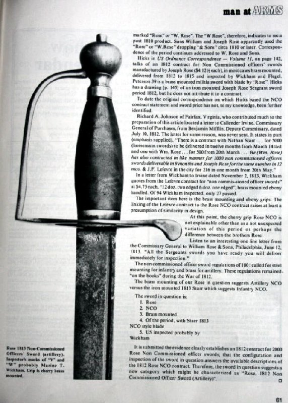

David, these are both enticing sabers, and well worthy of being stabilized with conservative restoration (I always hate overcleaning....an old salt like me relates to patination)
I've been plowing through stuff here in the bookmobile but at the same time getting ready for another departure northward. In Wagner ("Cut and Thrust Weapons" Prague, 1967) I did find, as suspected, an Austrian parallel to the lionhead. On page 434, plate 64, this same basic style is seen on the sabre of a senior noncommissioned officer in the 'Prima Plana' infantry with the years 1776-1777.
In the case of the sabre illustrated in Wagner however, the hilt is in brass and has a knucklegard, and the quillon extends straight out (as on French military sabres). The ecusson/langet on the crossguard is this same rounded diamond shape, and is profiled.
While it is not a perfect match, it is the same lionhead form with capstan on pommel, the same langet form and similar grip type. This of course suggests the Continental provenance of the sabre and that your sabre is 'of the type' and probably produced in period or subsequently within reasonable time, but for other issue.
Is there evidence that a knuckleguard was present, as should be on these type hilts? The quillon is curiously pointed downward with no terminal, is it broken off? The metal is dull gray, can you tell what material?
As for the other sabre, still no match, but as previously noted, these type pommels are known to have been on French sabres which usually carried neoclassic themes in motif. The United States typically followed French fashions in military uniform and weaponry post-Revolutionary War but in larger degree at the opening of the 19th century (Federal Period).
In this sabre the pommel is of similar form to the officers swords later in the century, and the fluted grips also. French sword grips often had vertical fluting but ebony was much more common. The interesting vertically sectioned langet seems to suggest U.S. as well as the notably parabolically curved blade. These strong curves were much favored on some of the earlier U.S. sabres, particularly those made by the Virginia Manufactory. Many of these early sabres were incredibly long with dramatic curve, and most were shortened down by Confederate officers during the 'War Between the States' (Civil War) as I was told vehemently to call it when I lived in Nashville!
There is nothing comparable in "The American Sword" (H.L.Peterson) but I just noticed Fernando's astute comment....the material in the grip does indeed appear 'organic' and when cleaned...ebony? If so, this is French I would think.

The "lion headed" is certainly missing its knucklebow ....the end of which would have 'terminated' in the lion's mouth. The opposite quillion is indeed broken and appears to be slightly bent forward ...how or why I don't know ...but am certain it was originally straight. The remaining 'crossguard', pommel and backstrap are heavily oxidised brass. So it certainly fits your description of the Austrian Infantry Sabre
As to the other sword.....further examination confirms a very hard, dry, close grained wood with some age (under magnification it almost looks 'petrified' ...and I don't mean 'fearful' ) This sword also is missing the finial from the upper most quillion and the knucklebow ...which would have terminated in a hole at the 'base' of the pommel . Remaining 'crossguard' is steel and would assume that the knucklebow and finial would have been the same.
These 2 swords came from the same source ....and its very strange that both have almost the identical damage/lost parts. Whether, it was a previous owners whim to do this ( ) or was legitimate modification or damage I have no idea. The patina/oxidation on the fractured ends of the brass 'crossguard' is very old ....so the loss of the knucklebow/finial was some time ago....perhaps genuine 'battle damage'
The seller bought these from an antique dealer some 60 years ago.....they were 'paired' together when originally bought by the antique dealer....so they have been 'brothers' for some time. It would be extremely exciting to find out that these both may be 'bring backs" from the Napoleonic wars....Austerlitz..Waterloo ...and all that .......imagination and hope, the bane of being a collector

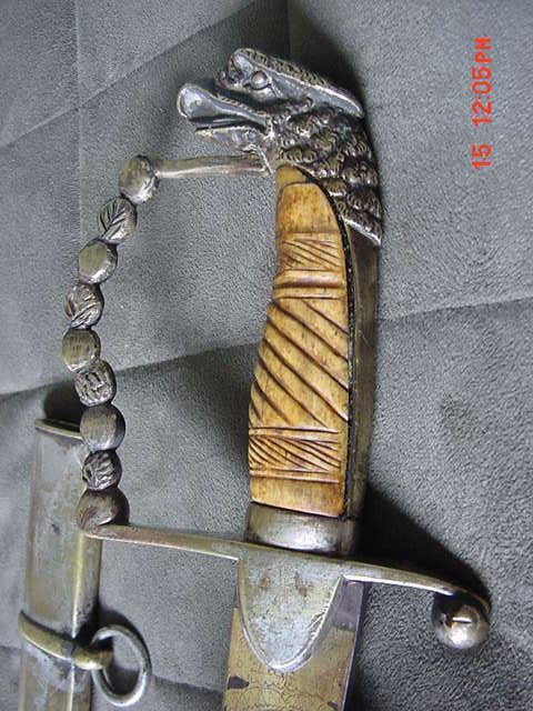

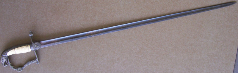

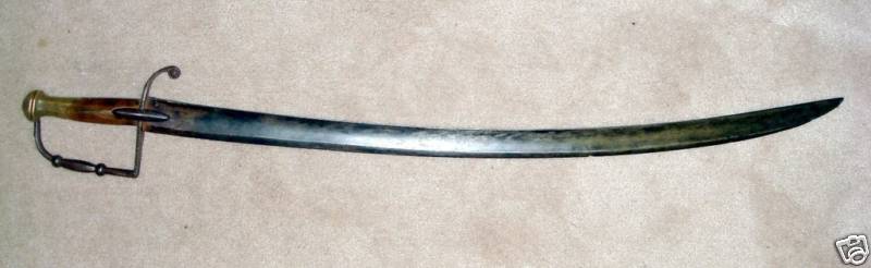

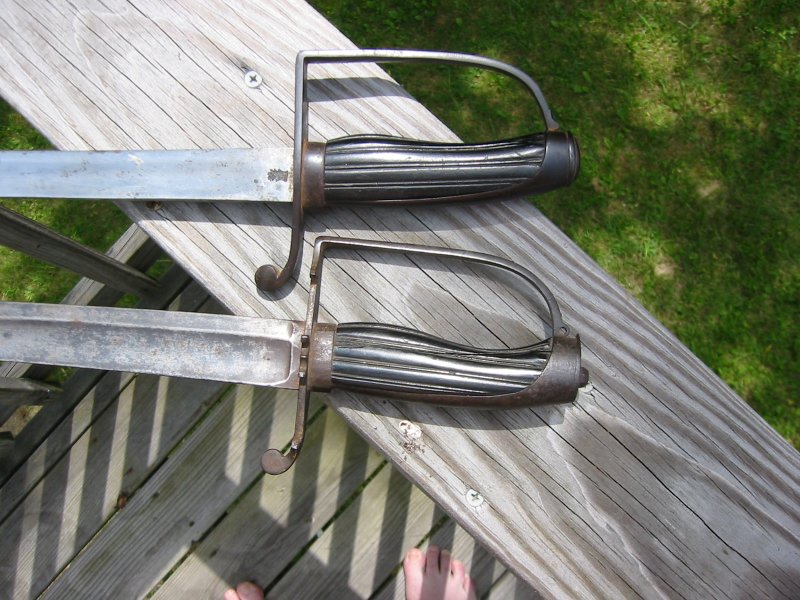

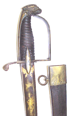

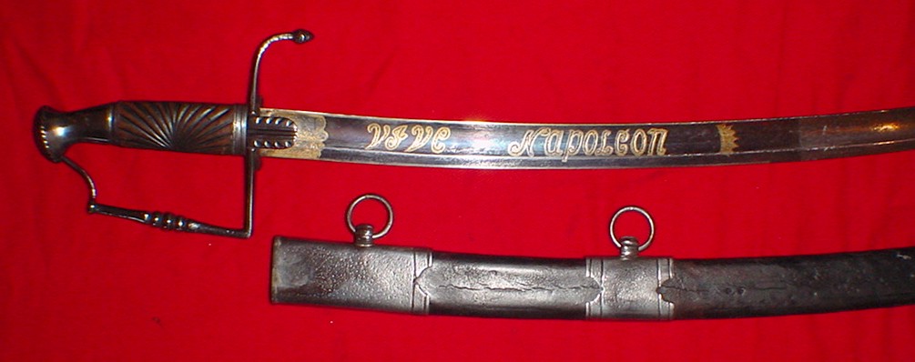

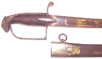

Here is a picture provided by a very helpful formite on SFI. It is described as a light cavalry sword....likely, mine is the Infantry Officer's variant. The blade inscibed "Vive Napoleon" .....long live Napoleon ...so obviously French. The hilt not a perfect match, but, too close to ignore. It has also been suggested that the more parabolic curved blade (marmaluke style blade) on my example, is quite rare.
It seems that the evidence is starting to strongly suggest French and, possibly, of the Napoleonic era. I have read that the stirrup hilts were prone to battle damage and in the case of the Cavalry, damage from the rider falling from his horse (with sword in hand).
Kind Regards David
Old 9th August 2011, 01:35 AM   #17
Posts: 10,741
This is excellent David, and thank you for posting this beautiful saber which truly does offer compelling evidence to Napoleonic French for your saber.

I looked to H.L.Peterson's "The American Sword" and found interesting notes concerning swords of the U.S. Marines, who of course still use the Mameluke sabre adopted from thier exposure to these during wars with the 'Barbary Pirates' in 1801-1805. These same type ivory hilted sabres were adopted by the French and British after thier campaigns in Egypt.
Interestingly, Peterson (#142, p.165) notes one of the early swords used by the Marines from 1804-1818. While most Marine swords seem to have followed artillery officers swords of the time, this interesting sabre (which apparantly belonged to Francis Wharton, the commandant) .."illustrates a type of French sword which was quite popular among American officers of the period".
On p.192 (Peterson, op.cit. #159) the eaglehead sword presented to to Lt. Presley O'Bannon of the Marines for his valor at the action at Derna in 1805 has the distinct knucklegard feature of the drop down semi arc seen on the Napoleonic sabre posted here. This sabre was Baltimore made and reflects again the French influence on American swords.

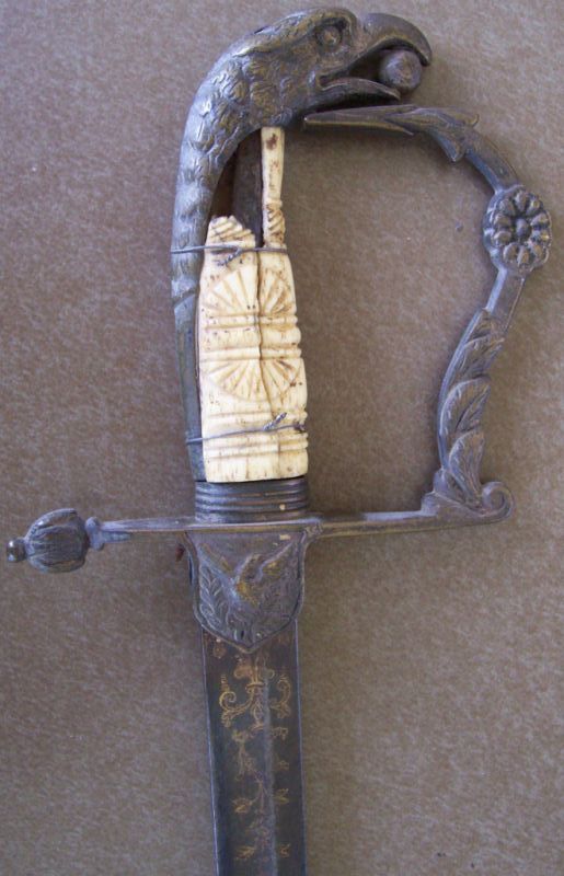

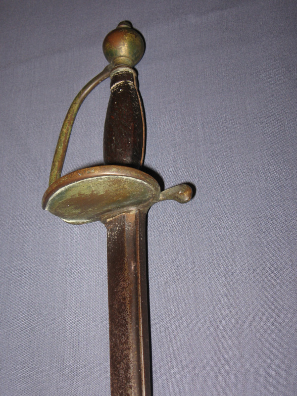

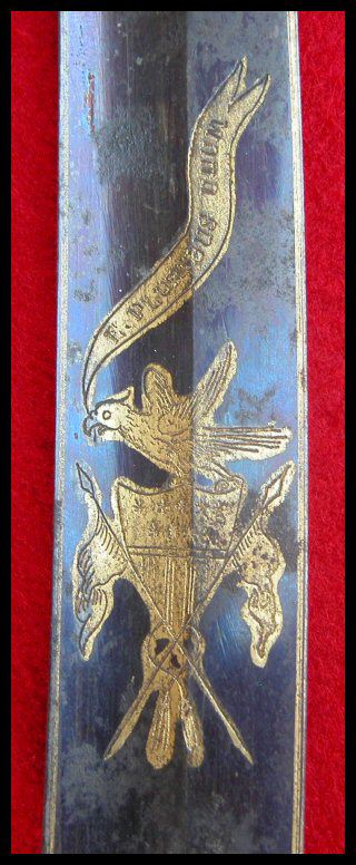

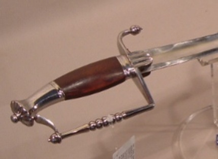

Some odds and ends to toss on the ashes. Here is a French form around a lot of the 18th century (pre revolution), along with another pair with mixed feelings Quite British that pair but the spadroon blade looks almost Prussian.
Anyway, I see the major influences of domination in sword manufacture for the U.S late in the game when looking at the French styled sword in this thread. That some were individual pieces were adopted is recognized as well as some presentation swords but if we look at the demand and supply, the French goods and influence of the American federal period is lacking. Even beyond that, consider the boat shell hilt of the U.S. infantry officer sword of the 1830s not having a roman helmet but a variety of large eggs instead. All the roman helmeted swords post dating the federal period are a given and I agree that by that time, French stylings are dominating but not so during the Napoleonic/Federal period.

#98 second sentence "Many are known, because of their histories, to have been used in this country" Not quantified further, group b had 30% fewer cavities than group a You'll like the one attached below.
#93 Again a quantitative and subjective relationship in influence. Much more so when in the 1840s and beyond, Horstmann and others flood the market with Solingen made long neck French style eagles (note the dateline again). Of many hundreds of eagles shown in the elder Mowbray's bible and in the Medicus collection indexing, the French made eagles genuinely pale not just in production numbers but also lacking the diversity of the swarm of English made eagles. Again, look to early influences and desire, the eagles main eyrie (sp) of eggs was English, balls or not.
#63 Jim, it is easy to cherry pick such a statement by Peterson and disregard the rest of that chapter. Forty years after that book was published it again becomes a quantitative falsehood. Did many favor French eagles? I don't see it from the numbers end.

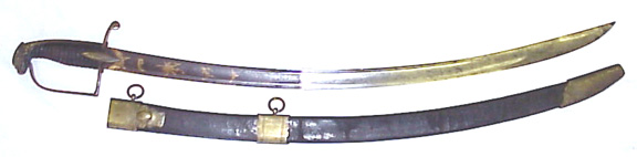

There are certainly a good many other swords that could be mentioned in several books, for instance the Lattimer collection and other examples from Peterson that are French but it doesn't carry the weight of conviction to me (nor does the elder Mowbray's eagle pommel book) They are all a starting point for me rather than books of absolutes.
You'll like this one from S&K
Oh, yes, while you have #93 in mind, note that he misidentifies #91 as wholly American made, while returning in Mowbray's 1990s eagles as now known to have been from Thurkle
Cheers
GC

Glen, I can only offer my compliments, you really know your stuff, and it is truly a pleasure to discuss these issues with you.As I mentioned, a true learning experience, and reminding me that despite so many years studying these things, I know I remain much more student than any kind of 'expert'
Actually as I mentioned, my familiarity with most of these references are from decades ago in my 'collecting' days. In looking back at some of the cites I used, I must concede that I am quite guilty of some cherry picking as you have astutely noted, but such was more inadvertant as I was trying to minimize some of the text for volume. The reference to 'histories' did not seem relevant, but as you point out perhaps in retrospect was. My selective choice of references was from quite a few hours of revisiting the few books I have with me. Ironically, although I have the revised Peterson from 1965, I acquired it only a few years later. These books; Neumann, Blair and later Robson (1975) I have had all these years are are still my treasures, and it is great to revisit them (glad I brought them!). As you note there have been considerable revisions and newly presented material in these past decades, so it is good to have that made known here.
Also, I neglected to thank you for sharing the article in Man at Arms on Rose!
I have subscribed to Man at Arms since the first issue in 1979, but all of these are with most of the rest of my books in deep storage for years.
Interesting note on the sabers identified as American made, but now known to be by Thurkle. This seems inevitable with all the cross traffic in trade and as I had noted, many swords came in from Germany and were mounted in America, so provenance may easily have dictated American made, as many German blades were veiled by thier furbishing in America. The interpolation of products is evident by German blades with the 'Warranted' term seen on British swords; Germany was also producing blades for France in given periods.
Actually I was not even aware that the French made eaglehead hilts, and though I knew Andrew Mowbray, I regret I never had his book on these swords, a monumental oversight on my part. He was a great scholar and very giving individual who inspired me a great deal, so even more regretted realizing this.
I am extremely grateful to have this discussion with you on this aspect on the influences in early American swords, and the considerable and important key points you have provided showing much better perspective on these than I previously had. While I think we have pretty well covered much of the detail here, it seems we both remain in degree apart in our views on the French influences, though I admit I lean more toward many of your points.
I would very much enjoy continuing this on a separate thread, but think we should return to the original sword identification featured in this thread.
David, thank you so much for your courtesy and patience in this digression.
Glen, I very much thank you again for your courtesy and outstanding detail in presenting some extremely important history and material in better understanding of these military swords. I know personally I have learned from your most admirable knowledge, and look forward to continued discussions on this and any topics you are in.
All very best regards,

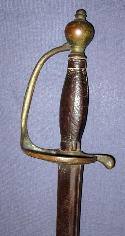

Kind Regards David

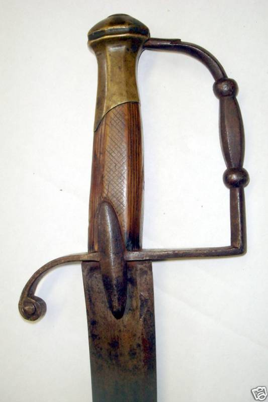

Hi Jim and Glen,
interesting discourse ...I have learnt some lessons thank you.
The picture I thought was a light cavalry sword is in fact an Infantry Officers sword....the blade also shows similarity to my own.

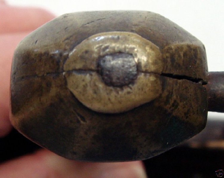

I assume that the finial on the pommel is a tang nut...can anyone confirm this for me, thank you
Kind Regards David

Hi David,
The finial/knob/capstan routine is most often not a nut. We see these on a great many types of swords. However, one reason they were used in cutlery is to add a little relief of other parts. Attached is a prime example why there is a peen block added to a lot of assemblies. Some of them a bit over the edgewith the extreme nature of such a simple fixture.
Cheers
GC

Hi Glen,
thanks for the reply ...here is a better picture of the pommel. To me it looks like a nut but the tang could have been peened over the finial (after passing through it) and due to the fact they are both steel could, with the effect of age/rust etc become almost invisible ?
Another picture provided by Marc on SFI ....unfortunately no details other than the sword was sold via "Le Hussard"
Best Regards David

Trying to find the significance of the 5 balled knuckleguard .....I found on Wiki ( ) that this design feature ...." popularity lasted from 1790 to until about 1820 when it was no longer produced " If true it helps date this sword.
I also read that this ball feature is more common on Infantry swords.........stylised musket balls ??
Kind Regards David
Kind Regards David
http://www.vikingsword.com/vb/showthread.php?t=10330
I prefer beaded as a terminology and more apt for a lot of hilts. It might make more sense to continue that old thread than add it to this one but here are some more cause to pause. They are not just found on infantry swords but the spadroons probably most recognized. Artillery, naval examples as well. I have pretty much summed up my thoughts there but would point out that Wiki articles are really no more than a start and much more information can be found in dealer listings as well as books.
Musket balls you say A hilt that has just two and one with more of the stylings. The other French sabre I posted is also beaded, imo.
Someone that could produce the first use of the term five ball might warrant a
meritorious certificate of rightness
Cheers
GC

Thanks Glen,
my knowledge in these types of sword is, shall we say, limited I suppose musket/cannon ball symbolism is possibly unlikely ..but possible....I cannot find any reference to a definitive explaination for the 'beaded' design ....or why there tend to be 5 (3 & 7 much less so, but interestingly all 'odd' numbers, whether or not that is significant ... I do not know )
Kind Regards David

How odd ?8^)~ There are just two in the one I posted above.

My main area of collecting is ethnographic ....where decorative elements are often symbolic or talismatic. These decorative features often aid dating, origins etc and subtle differences can equate to a difference of many years or origins a thousand mile apart.
The hilt with the 'disc' shaped sections of the knucklebow and the other with the elongated 'bead' with a ball at either end, which you mentioned are not even subtly different to the usual 5 'balled' or 'beaded' decoration that I am refering to.....so agreed 'odd'.
My question was about the decorative (or symbolic) grouped 'beaded' design, usually 5 in a row .....either with beads of equal size or those which graduate in size ie smaller at the ends, increasing in size to the middle. This design seems to have travelled to a number of countries....some of which were enemies. To my mind this suggests some symbolic, talismatic or religious meaning.
Kind Regards David
Old 15th August 2011, 07:40 PM   #30
katana
katana's Avatar
Location: Kent
Posts: 2,658
Continuing the possibillity of a religious meaning to the 5 beaded design....
The basic 'unit' of the Rosary is 5 .....simplistic ...but beads and 5
I am sure there are many possible interpretations , assuming there is one at all. If originally symbolic perhaps the meaning later 'forgotten' and later designs 'just based' on the earlier one
