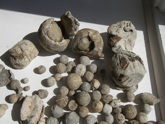

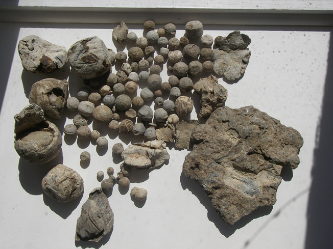

Danish metal detectors enthusiast have over the last year found more than 700 lead shot in the fields surrounding the castle. Estimated that approx 95% stems from these two sieges. Together with the lead shots have some cast iron balls and some stone balls been found.
Very interesting is the lead shots for small caliber cannons, with iron or stone core. With a cal. of 45-47mm.
Hagebøsse/Hagenbusse shot in cal. from 10/11mm and up to 20/21mm.
Some very small lead balls with a diameter from 6,3-9mm confuses me? could it be from some form of canister or grapeshot??
Some of the shots still retain that little tap from when they where cast.
Shown on attached images is only a small portion of the over 700 shots found so far. Many of the shots is only fragments or deformed on impact. Most of them is believed to have been shot from the castle at the besiegers. When i get a chance to examine the rest in the near future, i might post a update if something interesting is found.

Interesting question on the tiny lead balls. Wasn't that period a bit too early for the use of canister or grapeshot ?
... Why not "shoulder arm" (haquebut or handgonne) ammunition ?

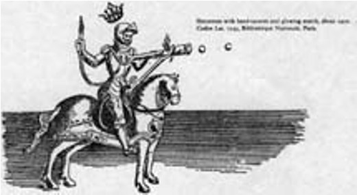

On the other hand, there is an early codex (14th century?) in the Paris National Library, with a drawing showing a mounted man (Eques sclopitaris)firing two projectiles in a simultaneous manner, from his handgun (sclopitus or scopitus). Somewhere in this forum there is a thread where this situation is quoted (Michl-Matchlock either the author or involved in it), with a picture most probably larger and better than this one shown here:

The very small leadshot from the castle findings (6mm) is just an enigma to me, thats why i thought of maybe a kartesche?? hope someone here can shed light on it.

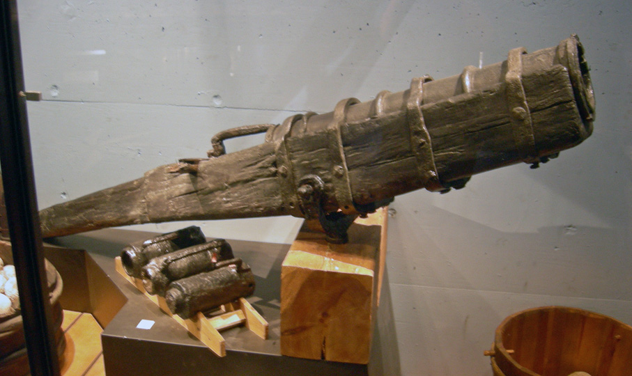

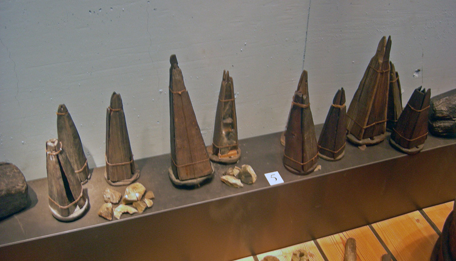

Here is a pic of some of the canisters from the shipwreck outside of Riddarholmen. Taken at the Medieval Museum in Stockholm.
kisak is offline   Reply With Quote
Old 1st May 2011, 03:05 PM   #9
Fascinating !
Thanks for the accurate pictures, Kisak
So they were conical ?
The ammunition looks like stone fragments ?!
How did these devices keep their direction?

They were indeed conical, and filled with sharp shards of flint. According to the museum description the idea was for the wooden canister to remain in one piece during the flight, and then shatter as it hit, sending the stone shards flying all over the place. I would guess that accuracy and effective range were both quite poor.

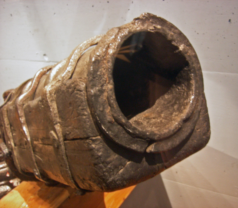

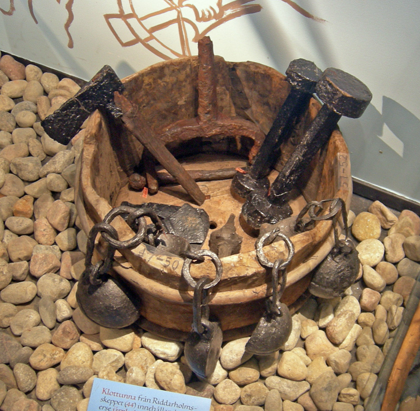

The pictures here show one of the cannons from the wreck. They also had another similar cannon on display from the same wreck, with the same stock, breech-loading, and rack of spare chambers as this one, but with a smaller calibre. The fourth picture shows some chain and bar shot, also from the same wreck.

Personally I tend to believe that the smallest lead balls actually were used as shot, firing a number of them at once in order to increase the effect. On the other hand, small caliber arquebuses (handguns) of ca. 9-11 mm were quite commonly in use in the 15h and early 16th centuries. Haquebuts (hagebosse) normally had calibers ranging from ca. 20-30 mm. All the bigger caliber balls should be assigned to lighter pieces of cannon.

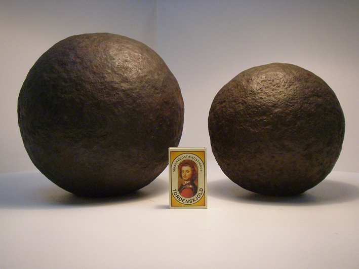

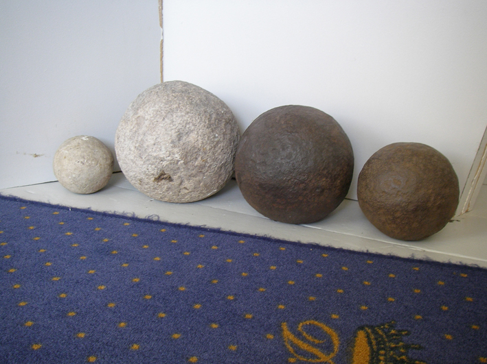

Unfortunately i haven't had time yet to go and examine the rest of the found lead-balls, but these approx. 700 lead-shot is found this last year(2010) Last month another 60 was found. Apart from lead-balls, hundreds if not over a thousand other findings has turned up. Medieval coins, bronze seal (signet) and all kind of every day life objects. Surprisingly no crossbow bolt-heads has been found so far.
Some years ago, i found on the castle grounds some forgotten cannonballs, that amazingly enough have been lying arounds in the vegetation's since 1535. 2 large cast iron cannons balls and 2 stone balls. The largest of the stones and the largest of the iron-balls both are Kartove kloder/Karthunen with a diameter from 20- 25cm and the iron one weigh around 36kg
Its known from historical sources that the besiegers i 1535 had brought 10 kartover/karthunen with them from Copenhagen to blast the castle with.
And they did for several months. Near 2000 german landsknecth and an army of citizen and peasantry under the comand of Graf Johan von Hoya besieged it and tried to take with storm several times, all in vain. The castle was impregnable.

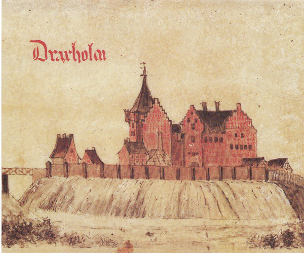

Attached is a mid 17th.c illustration of the castle and some photos of the cannonballs.

Ohe forgot to attach the image of the Castle.
