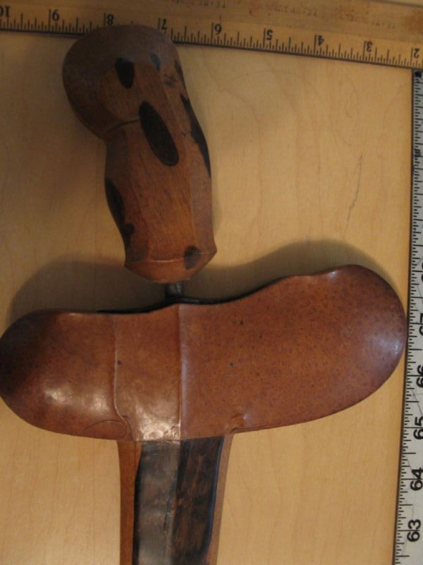

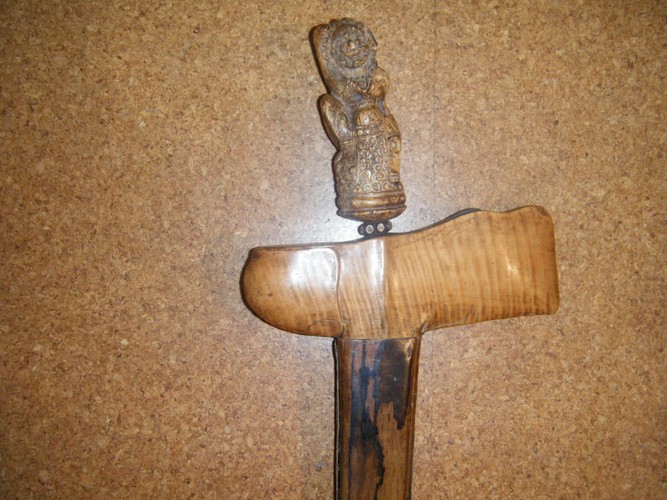

just bought this fine old Bali keris. Only the the wewer is missing. Scarce dapur with original Bali stain. And I like the wrongko from gembal jati (I think that it is this wood). What do you think, keep the hilt or change it to a figural hilt? In the moment I am incline to keep it with this hilt.

Marcokeris
Marcokeris's Avatar
Location: Italy
Posts: 928
IMO the hilt is OK
Nice keris
Old 13th April 2011, 10:07 PM   #3
asomotif
asomotif's Avatar
Join Date: Nov 2006
Posts: 2,238
Hi Detlef,
Nice keris.
I would keep the hilt. Looks like a good original combi to me.
Check the peksi , maybe the hilt should fit even lower and a uwer is not missing at all.
A lot of old Bali Keris are without uwer.
Other option is to sent it to the Netherlands
Willem

Hello Detlef, it's nice keris !
The Pelet of hilt isn't match with the warangka, you probably need other hilt to this

hmmm....if this hilt isn't a "match" for this sarong i don't know how you would go about finding one that matched better... I think this hilt looks fine. Have you removed it yet. It is possible that there might just be something up top of the hole that prevents the hilt from coming down more. If not it's easy enough to bore the hole a little deeper for a better fit. As for a uwer, a nice one is easily obtainable. Some very ornate hilts sometimes do not seem to need them. IMO this ensemble would look better with one. I am not convinced that all the Bali keris that we find without uwers were always that way. I think sometimes they may have been sold off along the way (if precious metals and jeweled) or damaged and not replaced. Certainly we see more elaborate hilts where a uwer would just be too much, but with a standard everyday dress like this it seems more appropriate.
Also IMO, the practice of collectors to so freely trade up for need hilts and other parts is a strange one to me. Unless something is damaged or out of place it is my general tendency to preserve the ensembles as they are. After all the keris comes to us with a certain amount of history and this hilt is part of that history.

Thank you all for comment! Like I write before I am incline to keep the hilt. A nice uwer I still have, this don't will be a problem. I don't have the keris in my hands until now, I will post some pictures when I have received it. David, I am also not a friend to change a hilt when I see that this one was long together with a keris but many times you can't be sure about this. BTW I think that it was and still is a well-established practice to change hilts by a keris.
Willem, when I am bored with this keris I will send it to you!

Posts: 7,258
As has already been agreed, this is a good keris.
I feel that the burl atasan that is currently a part of the wrongko may not be the original mate to the gandar, but a replacement of the original. From the photo I am not able to say if this is a recent replacement or not, nor can I say whether or not it is teak burl ( jati gembol). It is burl,certainly, but jati gembol? I don't know.
As Hartadi has commented, this burl atasan does strike a discordant note. I have had a great many Balinese keris pass through my hands, and I have seen many more, but I have not ever seen a combination of woods that fight against each other, as these two do. To my mind this combination of materials is out of character with Balinese aesthetics. The atasan would work well with a pendok, but not with the current bare gandar. My feeling is that the original atasan had been damaged and a person with little understanding of Balinese aesthetics used the best piece of wood he could obtain to replace it --- make no mistake:- the burl atasan is a fine piece of wood, its just that it is out of place.
Add in the pelet handle and I cannot visualise this keris as an item of dress, its appearance is too unsettling.
Comments have been made regarding the gems and gold that could be found in Balinese uwer.
When a Balinese decorates anything at all, including keris, the dominant principle is to obtain a stunning final appearance. To obtain this appearance they used ( and use) any materials at all, with very little regard for the value of the materials. Where gems were included in keris dress, they were included for reasons other than their appearance, for instance, diamonds were a protective device against poison.
I have seen and handled royal keris handles that combined diamonds, good quality rubies, and glass. Mostly the gems found in Balinese keris dress are not worth much.
The only Balinese keris I have seen and handled that have gold incorporated into their dress are two royal keris that were at one time in the possession of the Raja of Badung.
Of the hundreds of Balinese uwer that I have seen, the only two gold uwer were on these keris. I have a bottle full of old Balinese uwer, and not one of these is gold, or silver, and most are set with pastes rather than natural stones. Because of this, I doubt that the keris which were in European public collections during WWII were stripped of anything. I would be inclined to accept that a Balinese keris that came into a European collection pre-WWII and that is now without a uwer, was very probably without that uwer at the time it was collected.

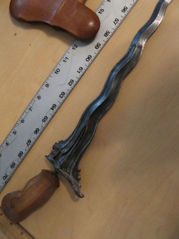

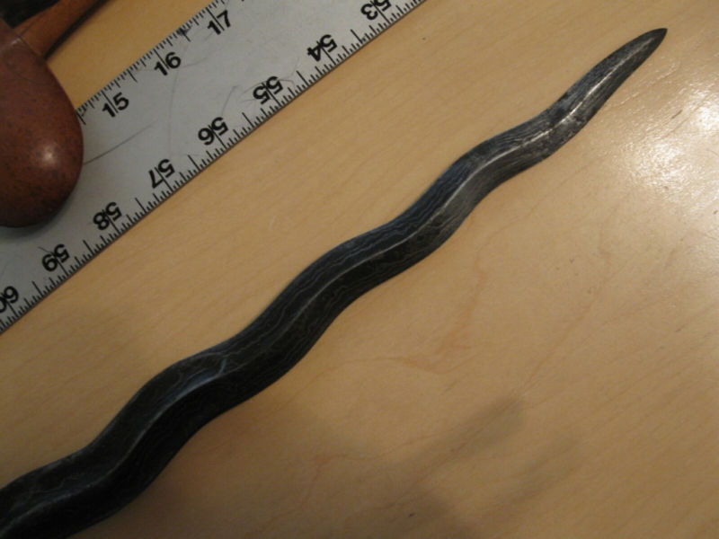

Here a other Bali keris from my collection also with a ganja wilut where the atasan and gandar worked from different wood.

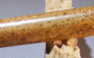

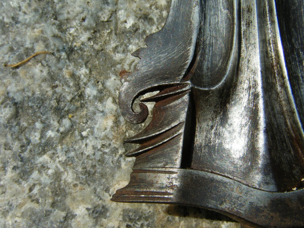

Yesterday I received the keris and I think that I have to agree with Alan that the complete keris isn't a very old one but in all parts very good worked.
i have asked the seller about the history of this keris and he told me that he get this keris with some other items from a man who has been a surveyor in Indonesia and the Philippines before the second world war.

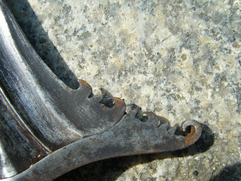

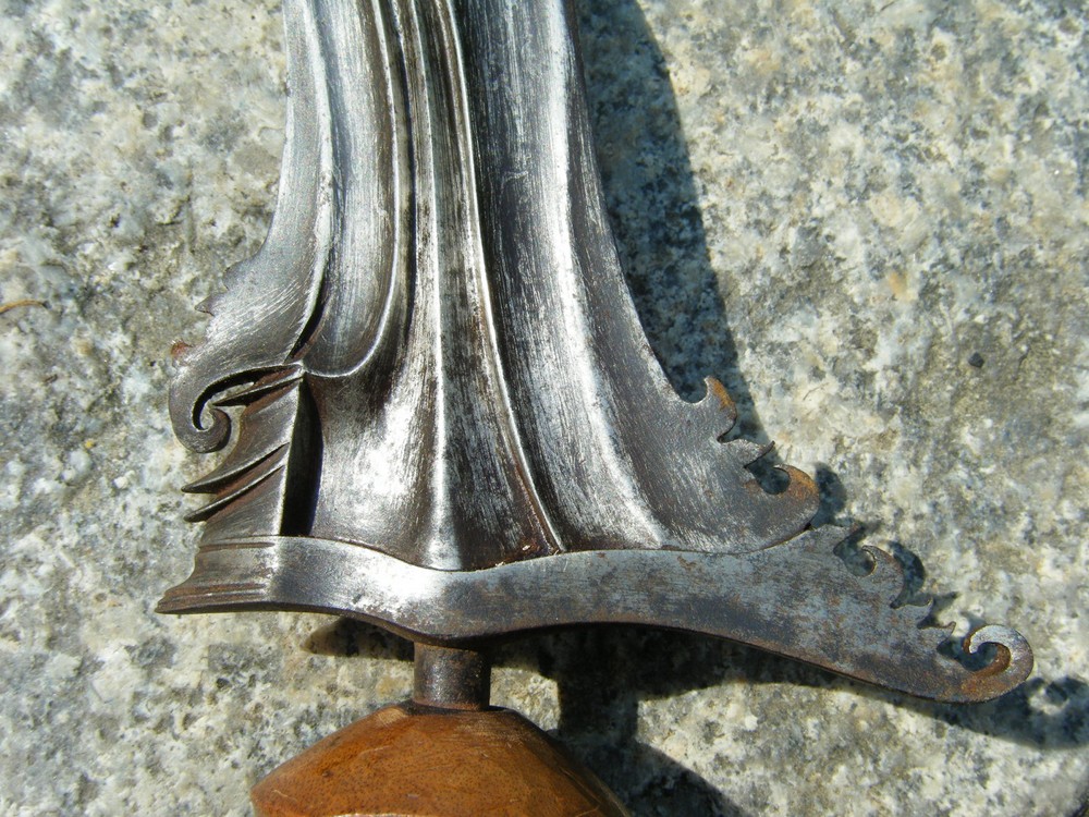

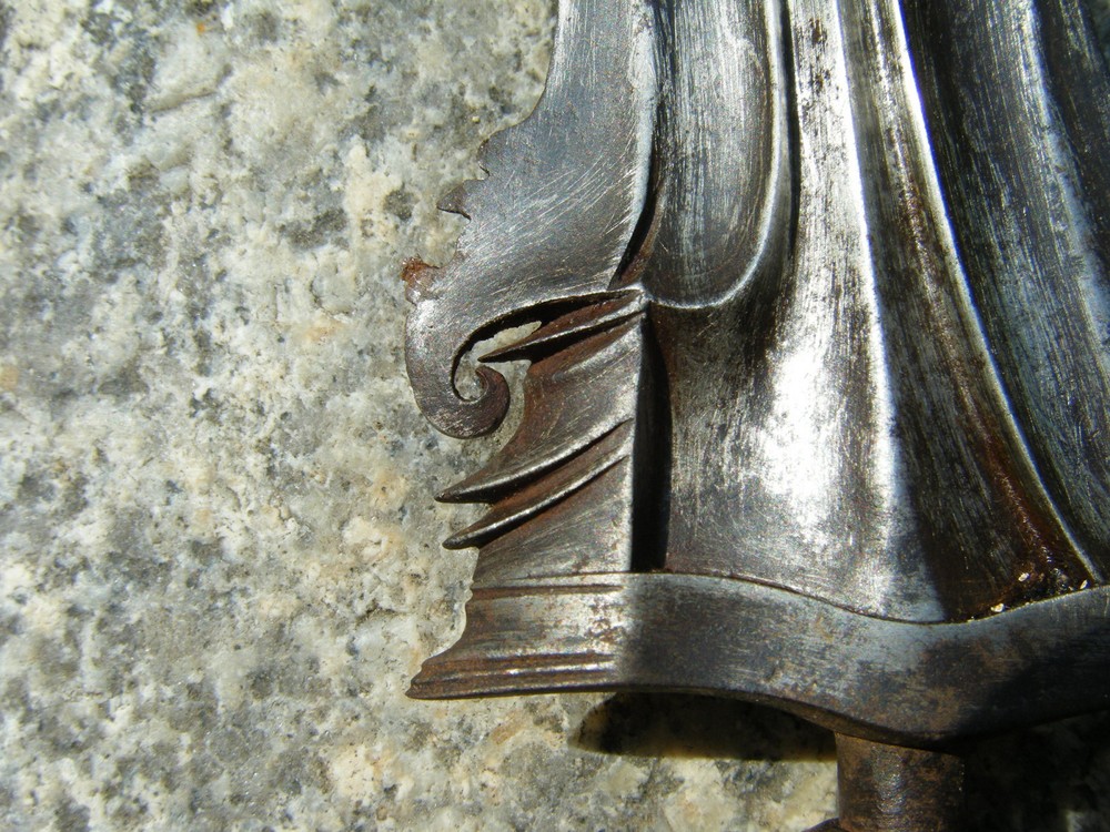

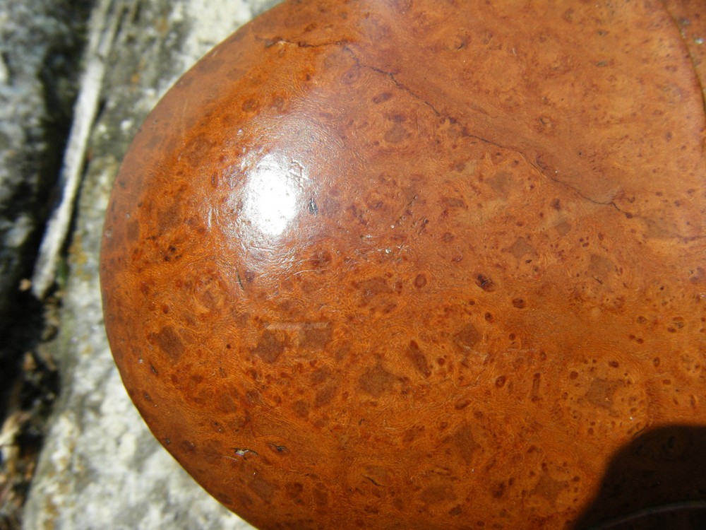

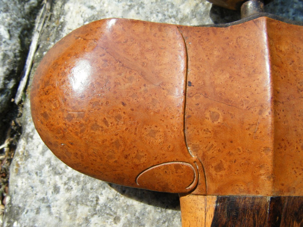

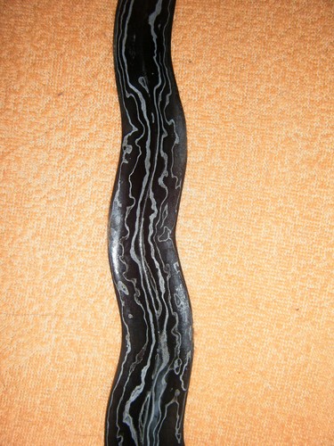

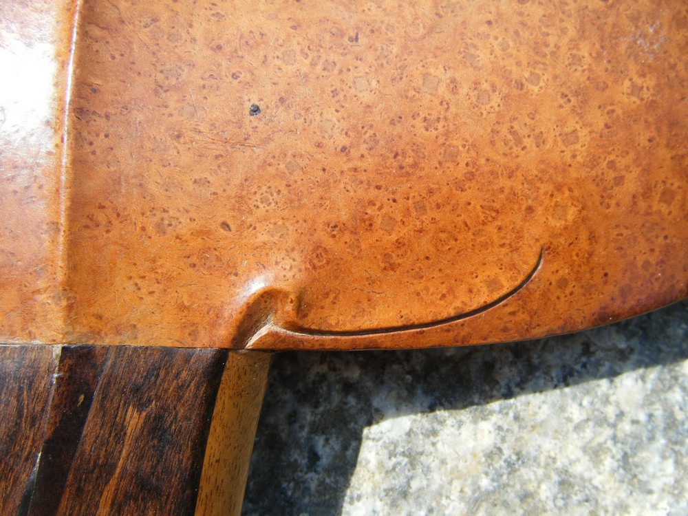

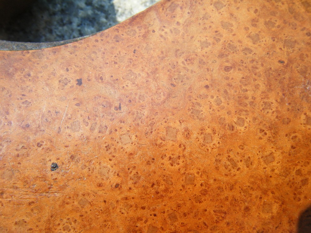

I have taken some close ups from the atasan as well from the blade. Someone has a hunch which wood is used for the atasan?

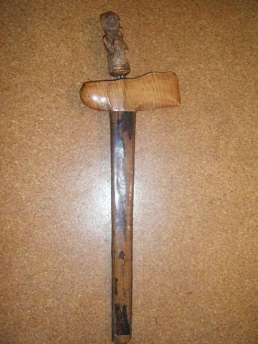

I found this picture by internet search so I think that I have been correct which my first guess that the used wood is gembal jati (teak burl). What do you think?

Detlef, as I wrote in my earlier post, I cannot be certain from a photo as to whether this wood is burl teak or not.
It is a burl, but I know of a number of burls that have very similar appearance.
It looks like burl teak (jati gembol) but close physical examination would be necessary to be sure, a picture is just not good enough for certainty.
A. G. Maisey is online now   Reply With Quote
Hello Alan,

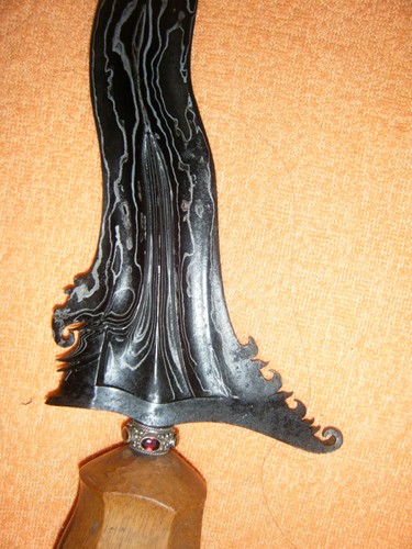

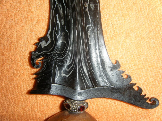

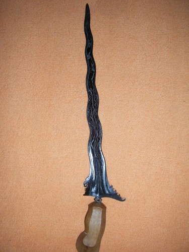

The blade has get a new stain and I want to share the result with you.
I have given the blade a new good recent uwer from silver to complete the dress.

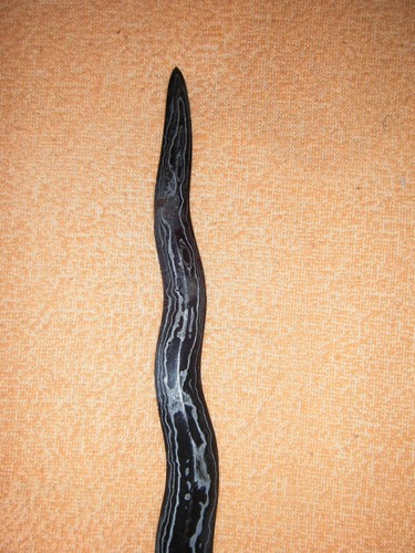

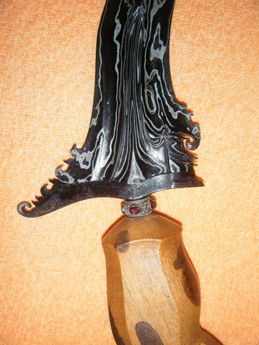

Here the pictures.
Old 17th July 2011, 02:38 AM   #28
Posts: 7,303
Nice to see this blade come alive again...
Old 17th July 2011, 03:35 AM   #29
Posts: 7,421
Love the new staining!
Old 17th July 2011, 10:02 AM   #30
David and Jose,
thank you. I am glad that the pamor come out nice like this and it is not from great interest for me how old this blade since it is a very nice one.
