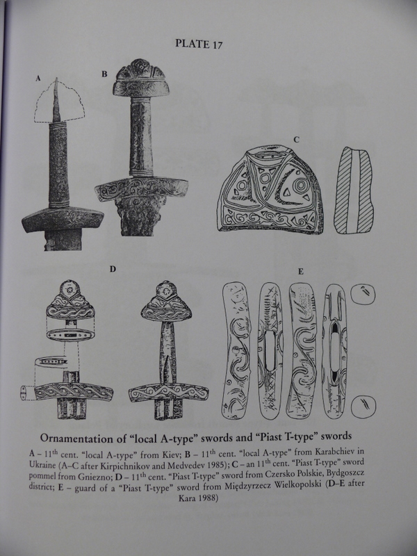

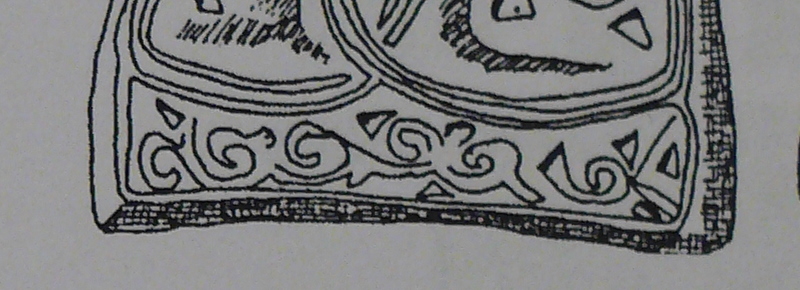

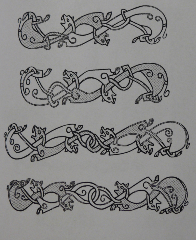

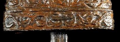

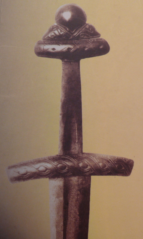

pommel:I found the same decoration/pattern published by Lech marek.

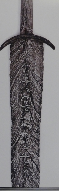

an 11thc piast T-type sword pommel. see picture Blade:the blade pattern i thought i saw before was on a sword auctioned by Bonhams 29 april 2010 however it is a kind of... different.see picture cross:the decoration/pattern on the guard must be something like the sword hilt from Busdorf Germany. see pic. best, Last edited by cornelistromp; 2nd February 2011 at 07:25 AM. |

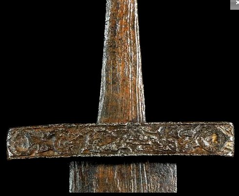

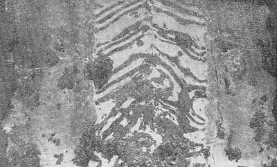

Yes, the Viking age artisans did decorate their equipment with tendrils and beasts, however on iron hilts (I think we can conclude the hilt is iron from the photo) decoration of this style was done via inlay, not carving. So we don’t even have to get into how the carving might be off, it shouldn’t be there to begin with, I can’t recall a single example from the era.
![]() Unfortunately, referencing another unprovenanced auction sword does not bolster the authenticity of the one in question, though these two are similar enough to make each other look bad. It does not look like the usual chevron pattern created in the Viking period, and it looks a lot like modern attempts to replicate the technique, with what appears to be the chevrons pointing in opposite directions on either side of the blade (indicating much more simple construction than most old blades) …and I’ve never seen an authentic blade with the chevron angle so stretched out. Attached is a photo of a more ‘normal’ chevron angle. ![]() The Bonham sword is even more nonsensical; for fundamental, functional reasons swords were made with the coarse, patterned material in the middle & had edges of very clean metal, going all the way back to Celtic times. And Leutlrit did not make his swords from pattern-welded material, so tis odd that they would reference his swords in the lot description. ![]() |

![]() Quote:

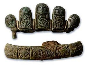

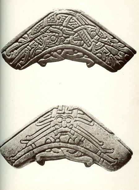

that you have never seen it means nothing, Unless you have seen them all! (famous Oakeshott quote) ![]() (it does not mean in any case that it has never existed on Viking swordblades.) re: Quote:
This elaborate Viking sword hilt was found on the Isle of Man by two gentlemen with a metal detector. Here's how 24-Hour Museum describes the pommel (top part): Rather like a set of knuckles, the pommel (the top part of the sword) design is divided into 5 parts, or lobes, each with intricately carved designs. In between the lobes are sets of finely twisted silver wires – a technique seen a few times on artefacts from the Isle. kind regards, Last edited by cornelistromp; 2nd February 2011 at 05:12 PM. |
