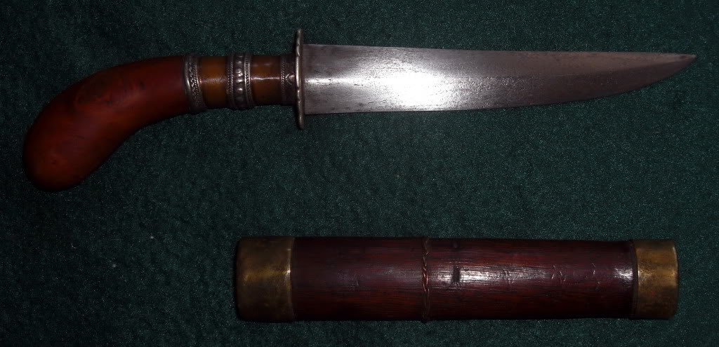

Hi Guys,
Another of my impromptu acquisitions, I believe it is a filipino dagger, or Puņal. Quite dainty, in fact wifey loves it. Any extra info on its origins? Seems like a beautiful cousin to the larger, brutish spanish albacetes.

Hello Celtan,
nice and older one since the handle is elongated (this is what I have learned at this place). The real name is gunong. Try to etch the blade, it has maybe a nice lamination.
Here you can see many more of this nice daggers: http://www.vikingsword.com/vb/showthread.php?t=5732

Sajen is right it is a gunong. Some say that slender handles like this indicate an older piece than that of the more "pistol" like hilts. I would say perhaps a little before 1900. Origin? Hard to place. Maybe Mindanao based on the okir, but this is a guess.

I like it. Definitely a laminated blade.
Here's one with a similarly shaped blade that has been etched.

Steve has a point - if you etch the blade the laminations will be more pronounced.
Like the laminations on this one Steve. Once again you are the king (or datu?) of the gunongs.

By ""etching", do you imply I should leave the blade dark, sans polishing back to bright..?

You can etch with diluted ferric chloride solution if you want but I would just leave it be. It looks nice just the way it is
