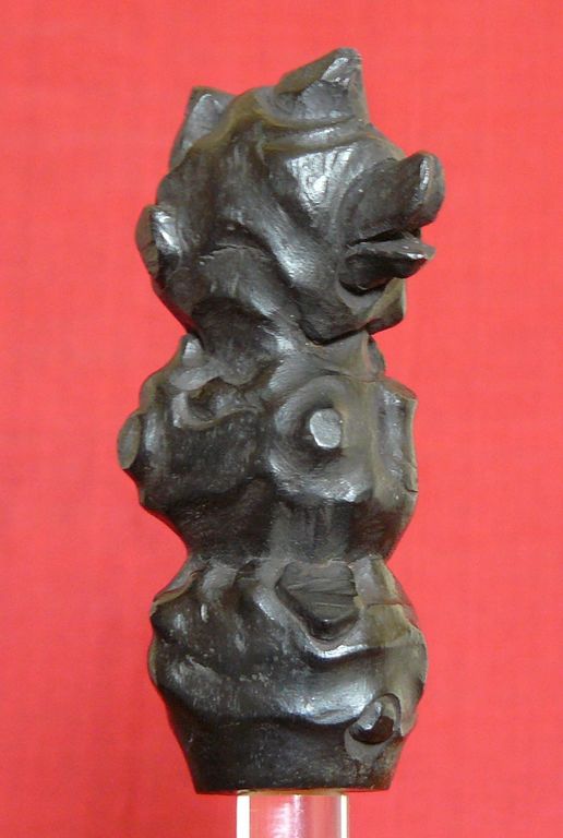

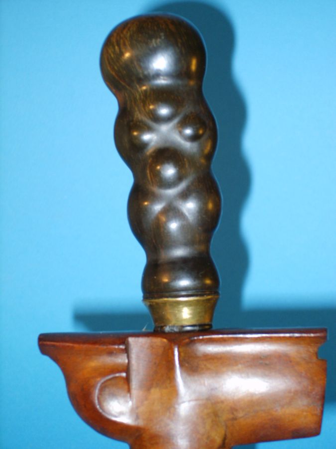

Hello Alan,
the red marked is what I understand before by the word gana. My understanding of a gana hilt is a natural grown piece wood (or other material, for example akar bahar) which use the natural knots without a lot of carving to show an anthropomorphic figure. And it is told in many books (of course without any proof) that handles like this have a function as jimat.

Thanks for your response Detlef.
Yes, I think that your idea of a "gana" hilt is about as most people who use the term understand it.
However, when was this term first used for these hilts?
The earliest use of the term "gana" that I can find is in Martin Kerner's keris grip book that was published in 1996. I cannot find the term used to refer to this type of hilt, prior to this. Because Martin was rather relaxed in his attitude towards providing references for his information, I have no alternative at the moment but to assume that this term is a product of Martin's inventive imagination. However, Martin also uses the term to refer to a hilt made of ceramic, and that can hardly be a naturally occurring form, so just exactly what did Martin have in mind as the attributes of this particular hilt form?
I am aware that the term is used by some people who contribute to discussion in this forum, but I do not know where else it appears in print.
Detlef, since you are aware of the presence of this terminology in many books, other than in Martin Kerner's keris grip book, could I trouble you to name those books, and the date of publication?
My present feeling is that we could well have another situation similar to the intensely interesting Durga terminology on our hands.
Alan,
first of all I have to note that David is correct by his assumption that I used the term "so called gana hilts" intentional. And that I write "in many books" have been a little bit hastily, sorry.
I think that you are most probable correct that Kerner used first time the term "gana hilt". So only other books apart from Kerner's publications ( 1. Keris-Griffe aus Museen und Privatsammlungen; 2000, 2. Keris-Griffe aus dem malayischen Archipel, Museum Rietberg Zürich, 1996) used the term gana hilt are 1. Kris Gli Invincibili from Vanna & Mario Ghiringhhelli, 1991 , 2. The Invicible Krises II, Vanna Ghiringhelli, 2007 and 3. Poignees de Kriss, Petit chefs-d' oeuvre d' Indonesie, Jean Greffioz, 2009. (So far I know)
So I think that it is most probable that this authors assumed the term from Kerner. Since Jean is also member of this forum he can maybe enlighten us if this is in case by his own publication.
So I am in analogy with your observation the the first use of the term "gana hilt" in print appears in Kerners books.
Maybe Pak Ganja like to jump in the discussion and can tell us if he have any presentiment of the term in use in old Java.
