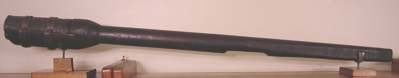

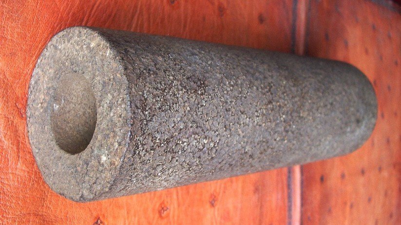

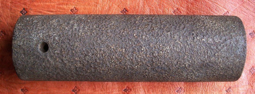

Hi, new guy here. I recently acquired this big guy, who weighs in at 9" long, about 2.75" wide, 31mm bore, and weighs 12 lb or so. I'm not sure of origins, but I think maybe Chinese as it came with a bunch of Chinese pole cannons.
Wherever it comes from, it looks close enough to a European handcannon that I'm considering furnishing it to suit. My problem is, I don't care for the tiller variety of furnishings that most of these early guns were originally equiped with, nor does my fireplace mantel (where this will reside) have the space for one. It probably sounds ridiculous when talking about historic weapons, but my aesthetics run more toward the appearances of the later rifle-style buttstocks. I'd ideally like something stout and short, with a blunderbuss-like aspect. So what I'm looking for (and hoping folks here have other examples of) are handcannons of the period that have shorter and more musket-like wood.
Here are a couple I've dug up:

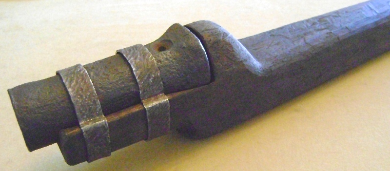

This one may be Chinese, and is probably much smaller (modern handgun size), but I like the appearance:

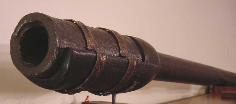

The stock on this wheellock grenade launcher is ideal, but obviously too modern - though I'm looking hard for a similar period example:

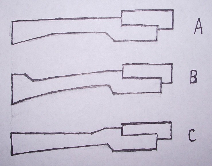

Some sketches of some possible directions I'd like to take the stock:
So...does anyone have any advice or opinions about what I should or should not do, or anything to add about the cannon itself? I want this to look good, but don't want to be so farby that my medieval weapon aficionado friends turn their faces away from me in shame.

I'm not an expert, but the one thing I've noticed about the examples is that the have a band in the middle of the barrel, to help hold it in the wooden stock. Since that band is missing in the specimen, you need to have another mechanism for holding the barrel to the stock.

My hope is to wrap the band around the barrel with a tab at the bottom to join the band ends together. The tab will insert into a slot in the stock, and a rod will run through the stock and tab to hold it all together. The effect should be a band secures the cannon without having to attach on the exterior of the stock. Again, like I presume of the "pistol" example.

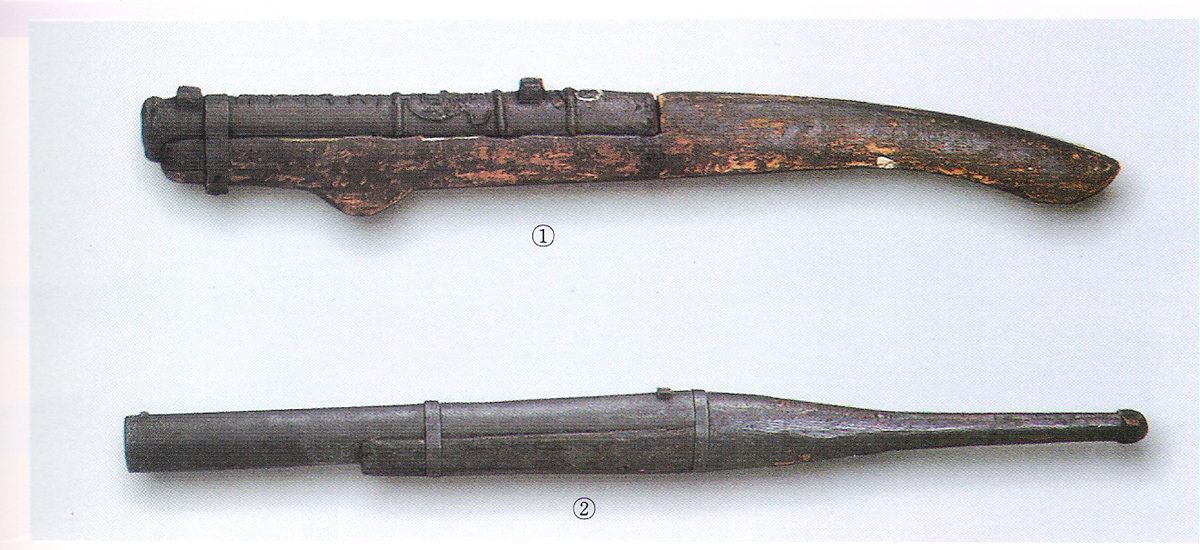

Here are a couple used in Korea in the late Joseon dynasty (the entire dynasty lasted from 1392-1910).

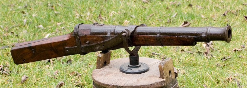

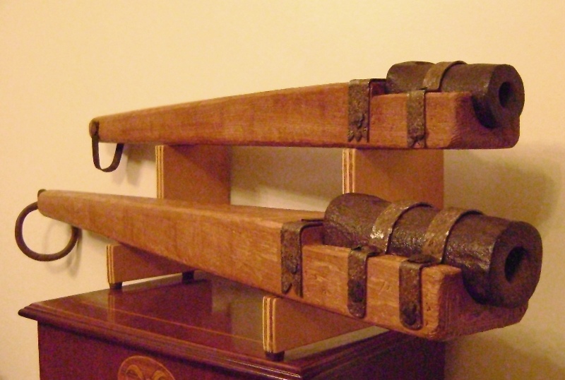

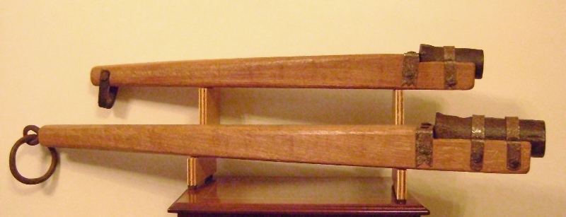

Meanwhile and concerning freestyle setups, here are some solutions i found for some of my early European barrels.

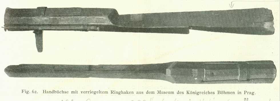

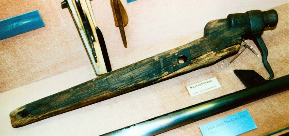

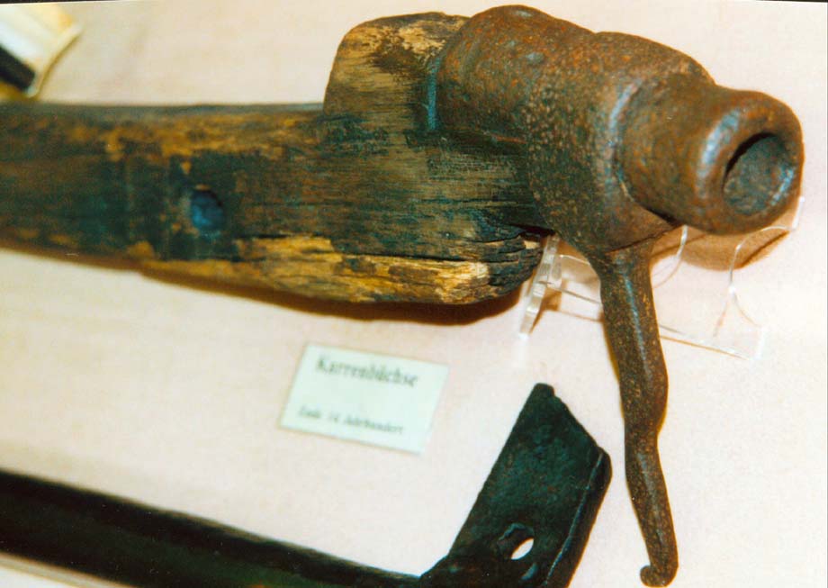

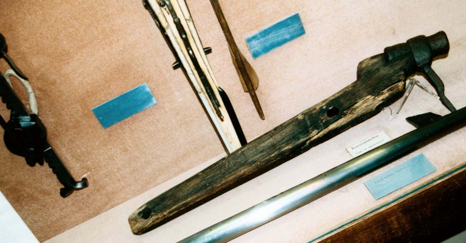

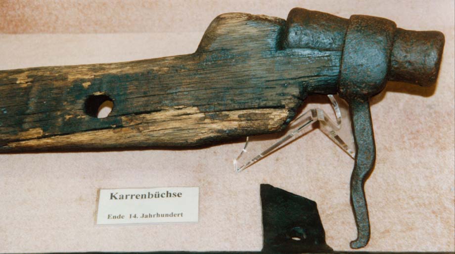

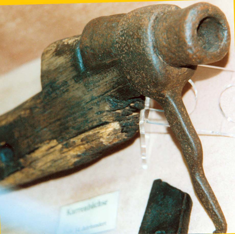

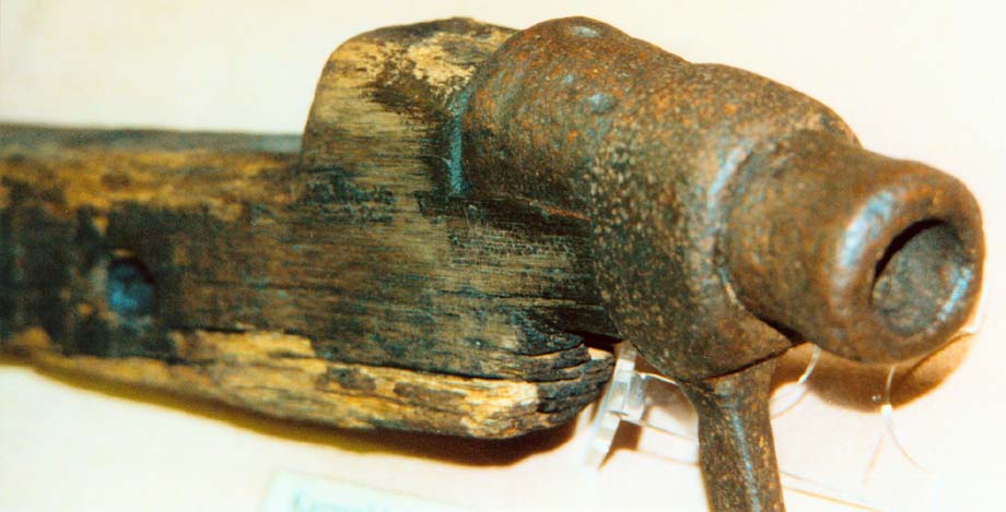

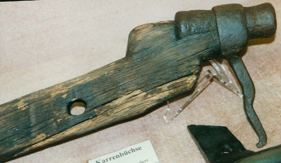

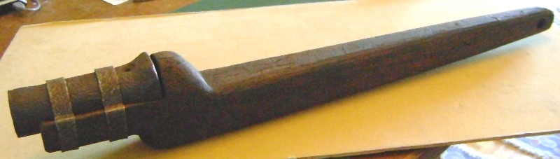

Here is the original, actually existing late 14th century example which your fine reconstruction work illustrated at the end of your latest post is obviously based on. The hook is a modernization of ca. 1430, the earliest date when hooks on guns turned up first as I stated on several earlier occasions. The hole drilled thru the stock was most probably for pivoting on some additional mount.
It is preserved in the Firearms Museum of Suhl, Thuringia, and measures about 65 cm overall. It was a find from the attic of a nearby Schloss!!!

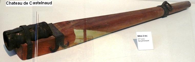

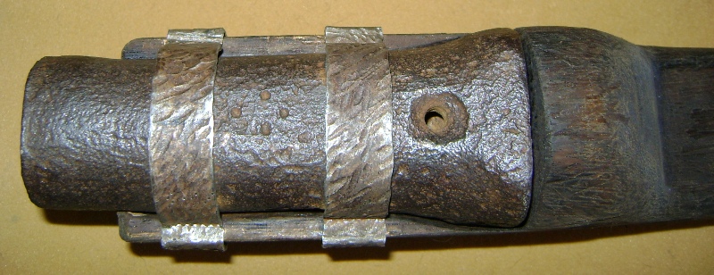

... And the second ones posted were inspired in a XV century Germanic "baton a feu" exhibited at the Chateau de Castelnaud.
Well, there it is! A pair of real Asian cannons, at last! The top one is especially curious, as it appears it was maybe wielded like a pistol-gripped shotgun!
