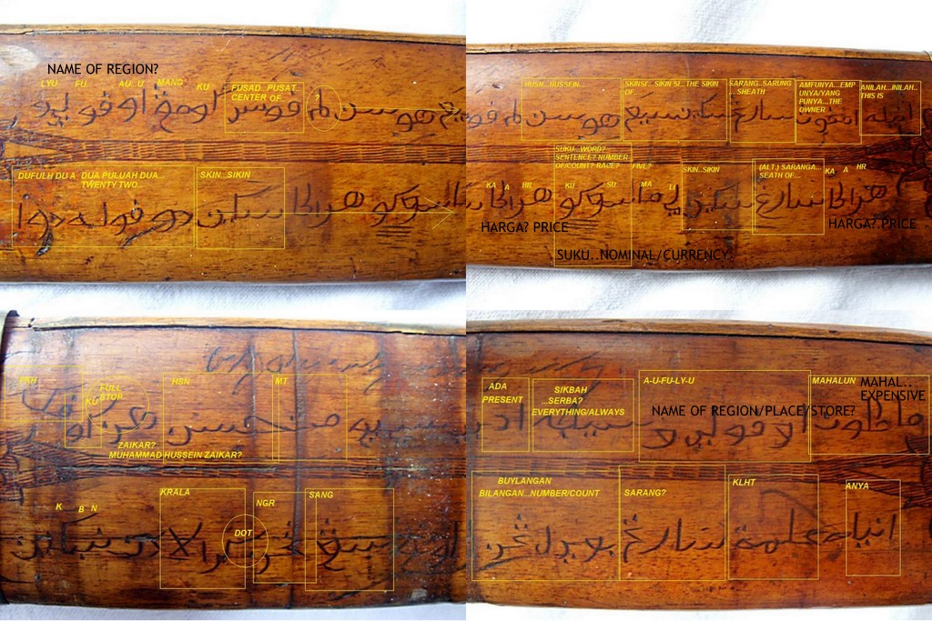

Anyone who would like to try helping me with a translation of a text, written on a sikin scabbard?
It is a long text, almost along the whole backside of the scabbard.
If anybody would be that kind and wants to give it a try, I could move the metal bands and post some close up images of the whole text...

Default Text close ups!
Here some close ups of the text!
Forgive me if the text is upside down.
If so we have 3 options:
Option 1:
Turn your computerscreen upside down and try to translate!
Option 2:
Stand on your head before the computerscreen and try to translate than
.......and if that don't work either, we still have option 3!
Option 3:
I will turn the images and post them the other way around...

This is the ultimate way to embaress myself trough contributing to translation of script and language I don't read/speak.
But I always facinated with translation so I give it a try, I just try to read the azimat using (my guide). I try to approach by Bahasa Indonesia instead of Bahasa Aceh (I don't speak Aceh). I believe you can't get a firm meaning without some help from Aceh speaker.
Totally amaturish translation (might be totally error) but it turns out like the script was written by the sheath maker/smith/seller with record of pricing, names, etc.
I hope somebody else able to contribute better translation. Please regard this as better than nothing .

Well, at first I really appreciate your try for translating this text. Don't feel embaressed, I was the one who posted it upside down.
It might be that "mohd", also member on this forum could help. He translated also the text on my ladieng recently.
Totally amaturish translation (might be totally error) but it turns out like the script was written by the sheath maker/smith/seller with record of pricing, names, etc..
I never heard of the written text of prices etc. on an antique scabbard, made for warfare..
That normally is the case with touristic pieces, where names of towns and dates are often mentioned on the blades or carved in the scabbards.
This scabbard certainly is no touristic piece....
If your translation is correct, than an "Azimat" is not the right word for this text.
Maurice

Hi Maurice, I just read your message and here I am! In fact I'm just wondering whether I'm of any help to you in translations
You did great Tunggul! In fact you'd done most of the bushwhacking which make things easier for me to look into the translation path of the text!
Originally Posted by Dom
.. anyway, after review,
the writing uses the Arabic alphabet,
but the language used is not the Arab ..
No and yes Dom! It's not really Arabic alphabet but it's what we called as Jawi Alphabet which is a customized version of Arabic alphabet. Certain Arabic alphabets which are considered as not user friendly to our Malay tongue are either customized or dropped! And yes, that's not an Arabic language! It's a Malay language.
.. I try to approach by Bahasa Indonesia instead of Bahasa Aceh (I don't speak Aceh). I believe you can't get a firm meaning without some help from Aceh speaker.
Totally amaturish translation (might be totally error) but it turns out like the script was written by the sheath maker/smith/seller with record of pricing, names, etc ..
I don't speak Aceh either. IMVHO the text is written in Malay language with some non Malay words (i.e. maybe Aceh words) in them.
And again you're correct Tunggul! The text is just telling about the owner of the scabbard, the pricing and the address of the scabbard maker .. or some sort like that
Transliteration:
Inilah ampunya sarung sikinsing Husin [rb] pos kumang aupu liau
Harga sarung sikin lima suku harga sikin dua puluh dua
Maklun aupu liau sikin ada besi yang mat husin hn kupk
inilah alamat sarung builangan utang sing ngar kuala kn nbkn
1st line tells that the owner (i.e. ampunya) of the scabbard is Husin (i.e. with some info about Husin which I couldn't understand)
2nd line tells that the price (i.e. harga) of the scabbard is 5 1/4 and the price of the sikin is 22
3rd line tells more about Husin and steel which I couldn't fully understand
4th line tells about address (i.e. alamat) of Kuala [something]
I/A: I'll analyze it further and I'll let you all know especially Maurice of any success in getting the full text to be translated into English
Hope this helps a little
mohd

Hi mohd,
Thanks for replying.
It seems that Tunggulametung was on the right way than!
Strange, cause I wonder why they want that info on a scabbard?
I was thinking of some phrase of the koran, or some spell to prevent the carrier from behing hurt in wartime...
Seems it to be an address with price of scabbard etc.....
Anyway, Tunggulametung, great work.
Now two of you guys are backing eachother up on this, I fully trust your translation!
There is also something written in other "western" script, but I can't make anything of it.
I have to look soon with a magnifier, maybe I can decipher the letters.
Again, thank you both for your effords.
And if you find out more, please let me know! It would be great to have the whole translation.
