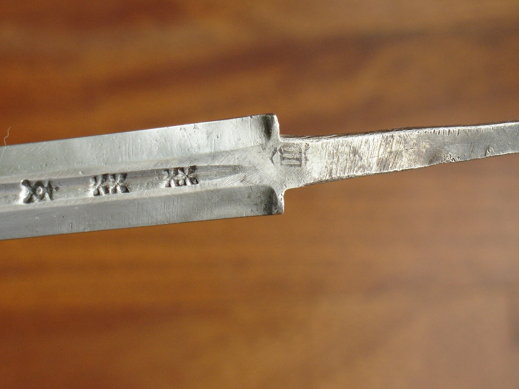

Just a couple of questions... is the end of the tang threaded, or is my eyes playing tricks on me again? Also, is a mark what I see at the beginning of the tang? Could it be possible to have a close-up?

Do we discern some letters, among the other symbols on the blade, as being some initials for IN TOLEDO ?
Isn't the maker mark (?) on the tang a bit too close from the blade base?

Yes, the end of the tang is threaded and what appears at the beginning of the tang is a mark (see first pic).
On the blade appear a few letters and what appear decorative carvings.
The letters seem to be : E N T O L on one side and N X T O L on the other.
Another older sword of mine (see second pic) has a similar inscription : N T O L
GIO is offline   Reply With Quote

My concerns are the rather heavily embellished 'x's ; that the fuller runs to the root of the blade; the typical Toledo type makers cartouche, often with a T is absent in the blade root area and most apparant, the unusually crisp 'anchor' is within the fuller rather than at its terminus.
Also, I have never seen one of these tangs threaded.
But, as Marc has well noted, thats what keeps things interesting, and it would seem that as this type of blade was heavily exported specifically for hilting locally produced or refurbishing damaged rapiers in Spain's colonies.

Looking at the up-close photo, I will stand myself corrected. This was no sand paper. It was a belt-grinder and sand-paper.
There are two options here for me.
1. The threaded tang indicates that this blade was mated to a pommel that was not original to it. In other words, this blade was recently taken off a composite sword. The blade decorations may have been refreshed and re-cut. We see that in the antique firearms market.
2. The other explanation for a threaded tang is that the blade is 19th century, from an old style officer's sword-rapier, like an Austrian infantry sword, or a British household cavalry dress sword, both from the first quarter of the 1800s. Blades of this style were in vogue with the upper echelons of the officer class for a short time, and were produced to imitate the earlier styles.
