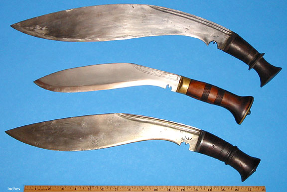

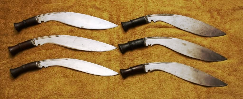

Gav
Prior to 1900 most battle kukris had the long leaf design blade to my knowlege this other style of kukri appeared after 1900. Here is a group of long leaves for comparison. I also included a pic of some long leaves that were in my collection some years back but since have foolishly sold them.
