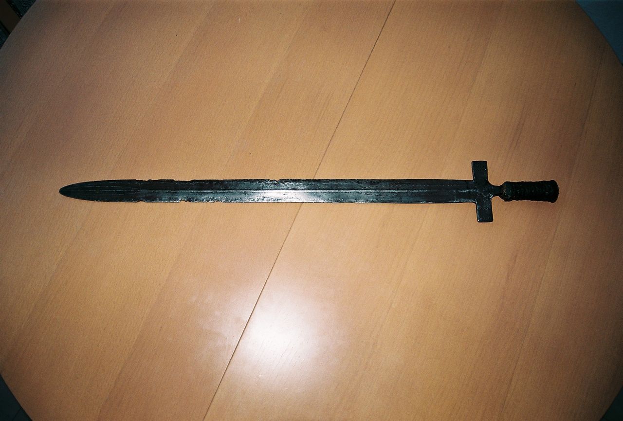

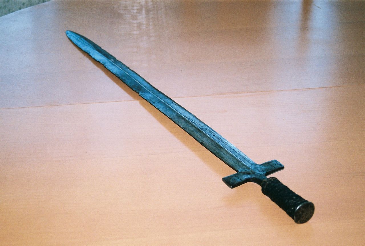

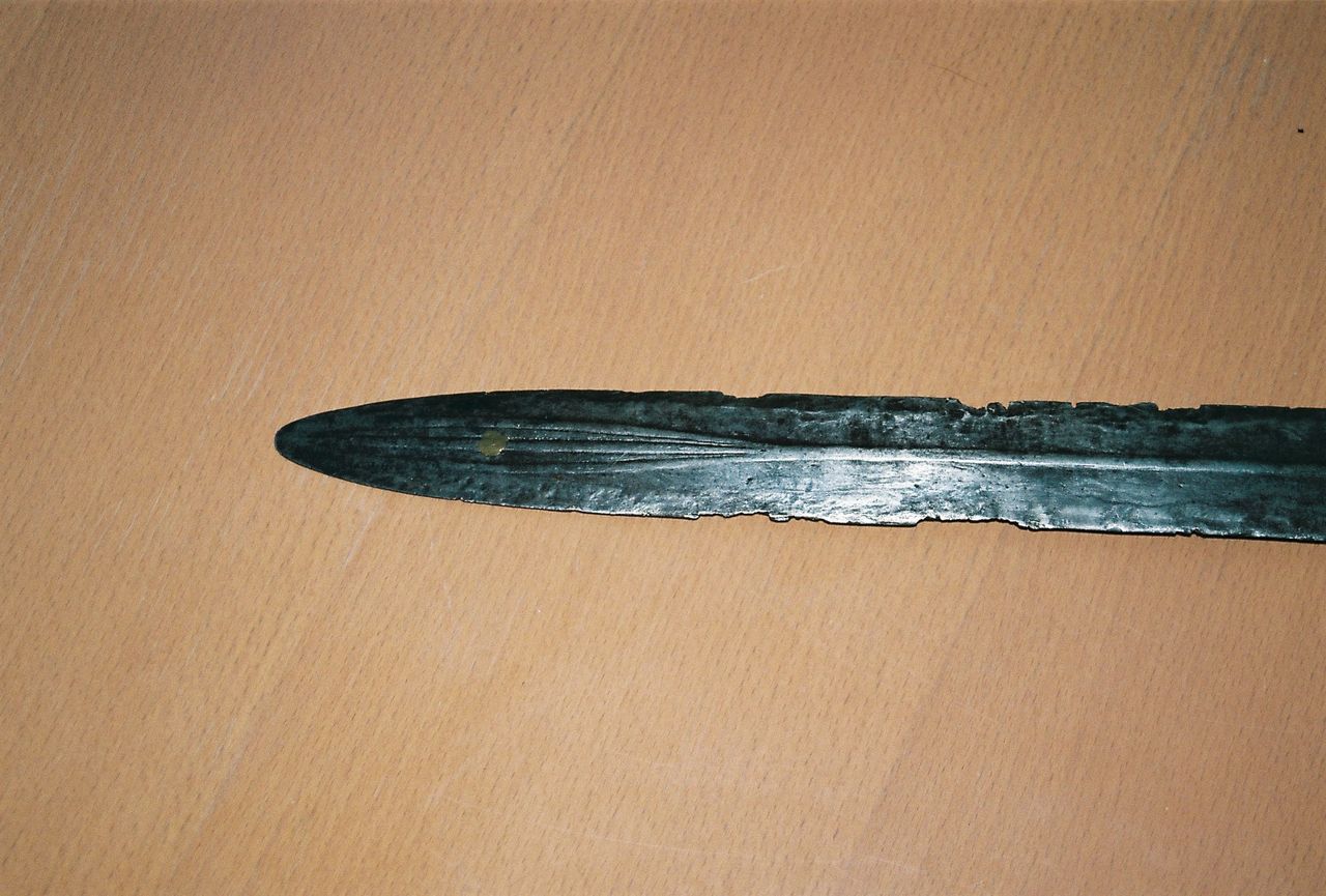

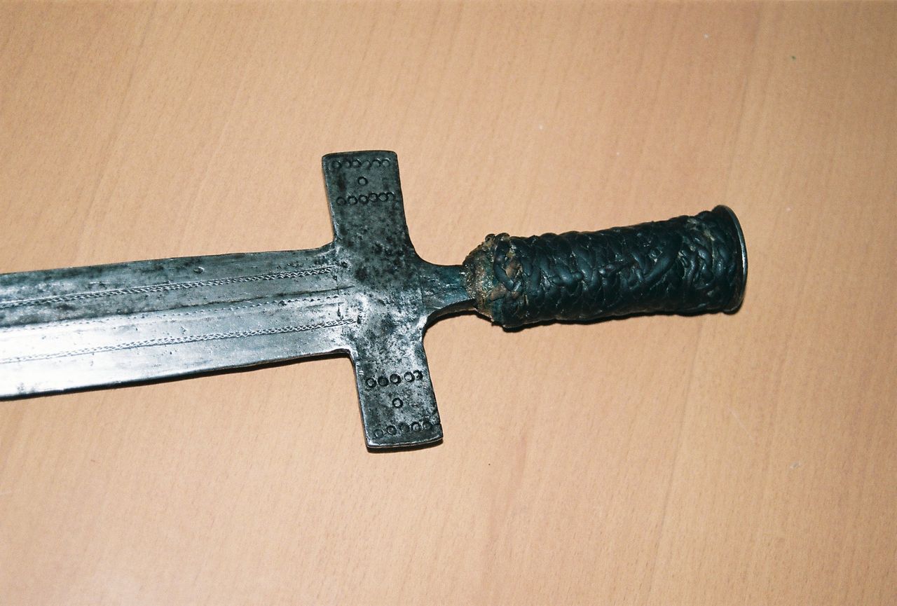

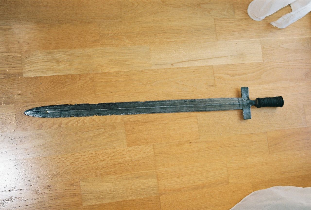

The sword was bought in antique shop in Prague, I think it is comming from Sahara or Sahel (??)
There is copper dot at the top of the blade /going through the blade/.
Martin

Sort of like a kaskara, sort of like a takouba. I've never seen one with an integrally welded cross-guard, though.

I think Takouba with free style hilt.

Hi Martin,
First of all how do you find such things in Prague? :P The only stuff I ever see is beat up military sabres and fake katanas...
This sword I think is not from the Saharan regions. The decorative patterns and geometric shapes remind me very much of Poto or other Congolese area workmanship.
I would agree that the influences of the takouba form are fairly obvious but my best guess would be that this piece from the Congo or perhaps Cameroon?

Thank you all. Because of the style of the hilt (leather strips) and dots on the crossguard I would also say it is comming from the arid region south of the Sahara (maybe north Cameroon, Chad). I think they did not use such leather strips for handes too much in equatorial regions. But the blade is really strange, and made of strange steel (it is not possible to polish it - it stays always grey or slightly dark, there are visible signs of folding)

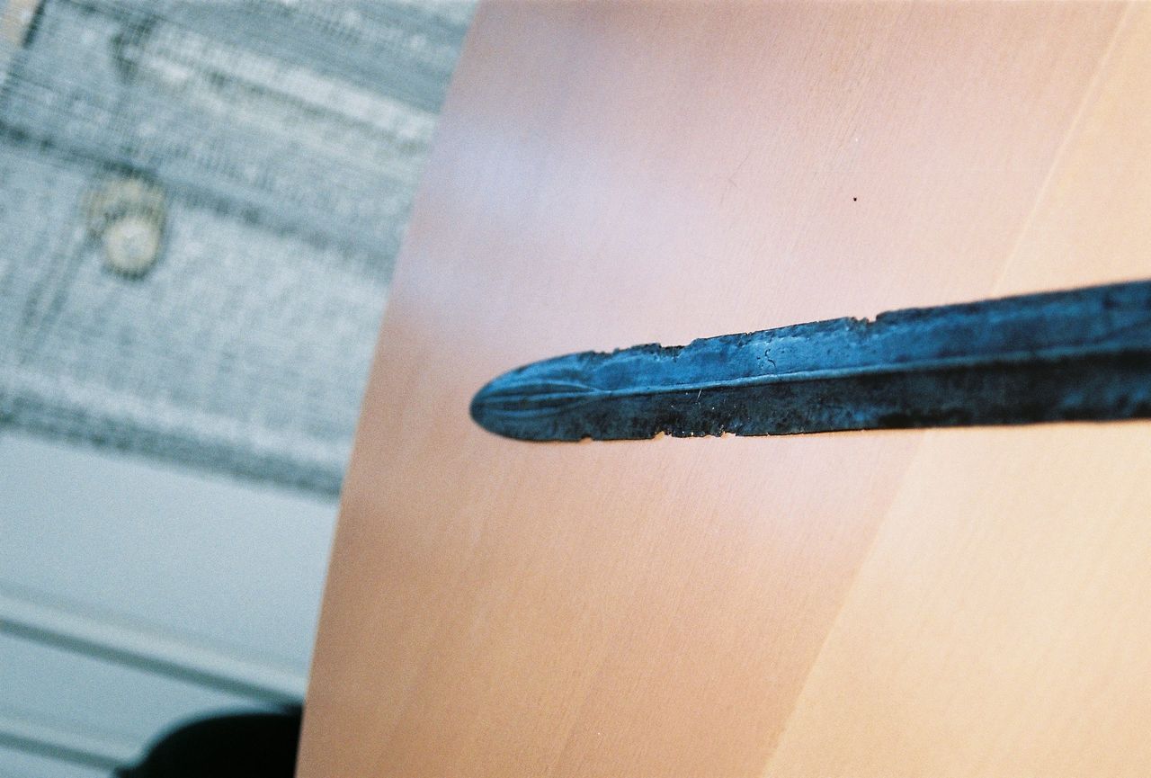

Peculiar blade tip construction ... and with that brass dot .

At first sight, what is most compelling visually is the distinct takouba like guard, but most puzzling, the fact that it is integrally forged. The mention of the dull gray characteristic of the steel I am wondering if that would be due to high zinc content?
I agree with the observations by ISPN and Martin, this sword has many features associated with tribal weapons from Zaire, and the elliptical features incorporated with the central raised rib in the blade resemble elements that appear in Ngombe weapons from Zaire (Beaute Fatale, p.77). The linear rocker style work that profiles the blade, resembles blade decoration features from Cameroon, as does the wrapped leatherwork, althought obviously the typical arched pommel is not present.
As often the case, a pastiche of influences from these regions in what may have been a court type weapon, probably from Zaire, and likely of latter 19th century. It would not be unreasonable to consider that the takouba was seen in certain degree in Zaire in the 19th century and later, and local artisans would have been influenced by the crossguard feature.
The interesting copper or gold metal filled dot situated in the symbolic ellipse near the blade point seems to perhaps derive from a gold or yellow copper nail hammered into higher quality Yemeni swords from ancient times. As with many, if not most African weapon forms, there is often deep traditional symbolism brought into them. The Arab influences that came into these areas along with the advent of Islam certainly accounts for many of these features, and it would be interesting to learn about this one, which I believe was mentioned in al-Kindi.

Actually, I personally do not think this is a takouba, although it does have 'one' takouba like feature....an elongated rectangular crossguard, which does not suggest this is a takouba variant. It does suggest influence, which is one of the most fascinating, though sometimes almost maddening, features in many African weapons. While we often try to categorize these weapons into distinct typology or regional attrubution, it is of course speculation unless having well documented provenance.
While takoubas and kaskaras were in effect 'cousins' as far as being broadswords, as I have often noted, I think they are quite different in most cases....the takouba blades are typically lighter with rounded tip...the kaskara heavier with more of a spear point. I do not believe the takouba developed from the kaskara, nor vice versa, however, they do share common 'influences' that become noticeable in certain instances and examples.
The blade on this sword is produced entirely different from those of the takouba and kaskara, and the raised geometric designs at forte and blade tip are not seen on any takouba or kaskara blades I have ever seen. The integrally forged interpretation of a takouba like crossguard is different, and something I have not seen on takoubas personally. The flat disc pommel and wrapped leather grip does resemble work I have seen on some Mahdist period kaskaras..but then this type wrapping is known in Cameroon, and probably Chad as well.
Here I would emphasize trade routes that traversed these regions across the Sahara from times immemorial, and were well established and travelled.To imagine that weapons that travelled along these routes did not influence individuals including artisans in these areas is hardly thinkable. It is known that along with migratory or nomadic movements of tribes, those who were craftsmen and blacksmiths moved as well. The hybridization of weapons and all manner of culture were of course products of these influences.
The gold metal inlay which seems strategically placed within the also strategically raised geometric ellipse, seems to represent some type of symbolism or auspicious meaning. Since it is a singular spot placed in a key location, we can probably reason that it is more likely that than some randomly placed motif. What was meant in mentioning the Yemeni practice was simply a comparitive note, and use of such inlays are known in other cases of course......since there was profound Islamic presence throughout these regions, naturally it seemed feasible that this tradition or symbolism might be transcribed to a blade, even in Zaire.

Like Jim, I also do not believe this is of form of a Takouba. The central rib and general blade profile is totally different. The cross guard does give it a Takouba-esque look , but, as noted its welded 'attachment' is again not normal for a Takouba, nor is it leather covered....judging by the decoration extending from the blade to the guard it never was, or meant to be. The brass rivet/inlay perhaps, was enough to 'sanitise' / nullify the believed bad effects of the iron.The hilt seems more usual for the Congo and surrounding areas.
The decoration seems similar to a number of blades seen from Mandara. An area of intense mining, smelting and 'smithing'. References suggest this area attracted 'smiths' from a number of tribes and it makes sense that an 'intermingling' of styles of weapons would have developed as a result. Techniques may also have been shared creating a 'melting pot' of ideas ...... improved metallurgy and the skills of the workers.
Martin, I think you got yourself a very interesting sword, it seems extremely well made .....the blade especially, congrats

Regarding the inlaid copper or brass plug, I have discovered an interesting reference in which Dr. Lloyd Cabot Briggs discusses this phenomenon in his work on Tuareg swords and daggers (p.80). Referring to a takouba with intermediate (south or central) attribution, and with a blade that he notes could be European, he states , "...this blade has been pierced about 3/16 of an inch above its rounded point and the resulting hole is filled by a copper plug 3/16" in average diameter on the obverse and 1/4" on the reverse".
He claims another example has a similar hole, unfilled, and that he has no idea what the pierced mutilations might be for.
The point is of course, that the practice did exist in Saharan regions in at least some degree. The fact that the instances here relate to Tuareg swords, and they of course only nominally accepted Islamic Faith, does suggest non Arabic source was possible for the copper insert....unless one considers the profound presence of Islamic Faith throughout all of these regions, which influenced Tuaregs as well as many other tribal entities who were more devout followers within these Sultanates.
