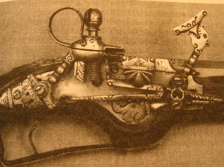

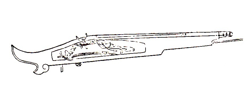

I found this on another site with the caption:
A flint-style lighting mechanism, most likely a wheelock, as depicted in a Ming firearms manual published in 1638.
Wheelocks were used by the later Qing Dynasty military as well

Thanks for initiating an interesting thread. To respond to your questions and comments:
1. First off, the so-called "Japanese style" matchlock is of Indo-Portuguese origin. Japan and Korea were the last areas to receive this technology, which was a fusion of Germanic/Lusitanian/Indian elements developed at the turn of the 16th cent. An example of one of these Goanese muskets, perhaps the only published example known, is in Holger Schuckelt, DIE TUERCKISCHE CAMMER (Dresden, Sandstein 2009), cat. 60, p 79. The matchlocks of SE Asia are of Indo-Portuguese type along with many from China.
2. The woodcut illus. of the gun in your post above dates from the Ming Dynasty. Flint ignition systems were known in China (as they were in Japan) but never supplanted the matchlock in either country. There are a handful of Japanese examples, and their mechanicals are derived from Dutch-style snaphaunces. This Chinese example is interesting -- Portuguese ancestry here. The cock is powered by a mainspring outside the lockplate pushing up on the cock's tail, which is identical to the way a Hispano/Portuguese "patilha" lock (the familiar miquelet) operates. The shape of the lockplate, the angle of the cock, and the crescentic terminus of the cock jaw screw are similar to that on the Portuguese "pescoco de cavalo" (horse neck) lock, an early flint mechanism in which the mainspring has been moved inside the lockplate. The horse neck lock, which is now rare, originated in the latter 16th cent. See Rainer Daehnhardt, ESPINGARDA FEITICEIRA: A INTRODUCAO DA ARMA DE FOGO PELOS PORTUGUESES NO EXTREMO-ORIENTE (Lisboa: Texto Editora, 1994), p 100.
Also, note the shape of the stock of the gun in the picture. It is a short-butt, cheek-fired design, classic Indo-Portuguese shape. The guns made in the Malay archipelago down to the end of the 19th cent. have butts of identical shape.
3. Wheel locks were known in China, courtesy Jesuit missionaries at the court in Beijing, by the 18th cent. In the cabinet d'armes of the Qianlong emperor (r 1736-95) are several wheellock sporting guns, all of Chinese make and design, right down to the locks themselves.
4. When the Koreans (and later the Qing forces during the Kangxi reign) fought the Russians in the Primorye region, the Cossacks and other forces opposing them had guns using a type of flintlock common in Scandinavia at the time. It had an external mainspring but was stylistically distinct (and appeared to be of less substantial construction) than the Portuguese and Spanish models. The buttstocks of these guns are long, for resting against the shoulder when aiming.
This is a brief coverage of the points raised in the above posts, my apologies if I've overlooked anything. Please pose any questions and comments and I'll do my best to address them.

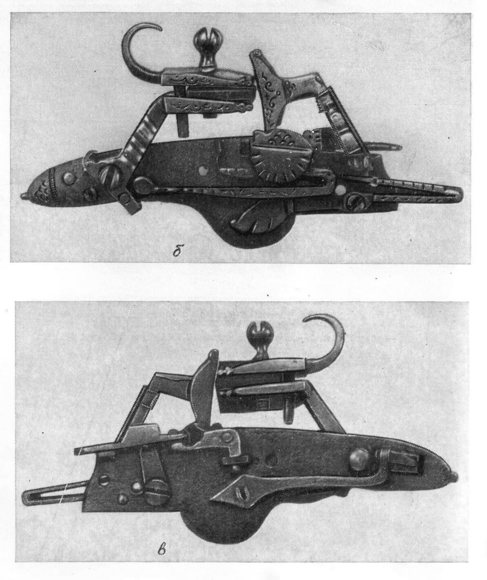

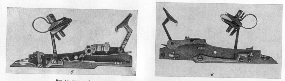

Here are some promised illustrations of the Russian style lock.

Thank you, Dmitry, for posting these pics, especially those showing detached locks, exterior and interior views. Mechanically, these are among the earliest manifestations of flint-and-steel mechanisms on guns that are known, and it is believed that they first appeared in Scandinavia in the mid-16th cent. Blackmore (p. 28, cat. no. 134) discusses what is perhaps one of the oldest dated examples, now in Stockholm's Royal Armory and thought to be one of several guns with Nuremberg barrel marks, converted to this early flint mechanism by Swedish technicians at Arboga in 1556. This style of lock quickly spread throughout the Baltic area and not long after to Russia where they were well-known by the beginning of the 17th cent.
Strictly speaking, these locks and the examples in your pics are not true flintlocks, for reasons discussed previously. They are SNAPHAUNCES, the distinction being in the separation of the steel (which is struck by the flint) and the priming-pan cover into separate units. A true flintlock has, besides an internal mainspring and sear system, a COMBINED steel and pan-cover (the unit looks like a letter L).
Be that as it may, the examples shown here, like their Scanian counterparts, have a primitive character to them which is not only charming but speaks to their antiquity. The pan-covers are opened manually, like those on matchlocks, before firing. Some of the covers slide, others pivot like those on matchlocks. Note how the first example shown in your post has a lockplate which bulges out on the bottom. This is a hold-over from the style of lockplate on the earlier wheel-lock, it is a vestigial stylistic element which is functionally irrelevant on a snaphaunce because no wheel is necessary!
Snaphaunces were made also in Holland, Italy, and later Morocco but these are more advanced since the mechanism is provided with a push-rod and bell-crank linkage between the tumbler and pan-cover so that the cover AUTOMATICALLY opens when the gun fires. (See Blackmore, appendix, pp 112-13 for operational diagrams).
The primitive flint mecanisms had a long life in the Baltic regions and Russia as well. They remained in use in rural parts of Sweden, Finland, and Norway until the beginning of the 19th cent., and I recall reading a memoir by a Western traveler seeing them for sale in a market in western Siberia ca. 1900.

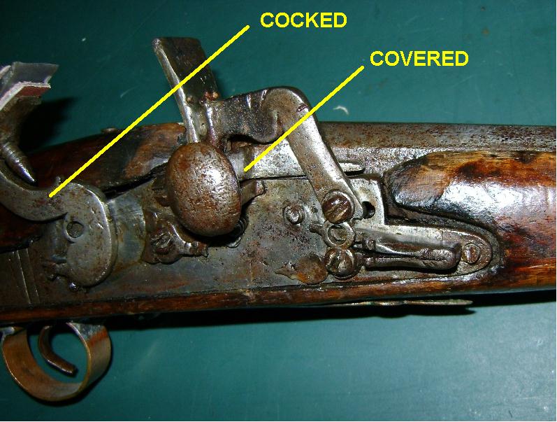

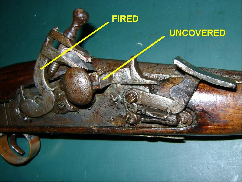

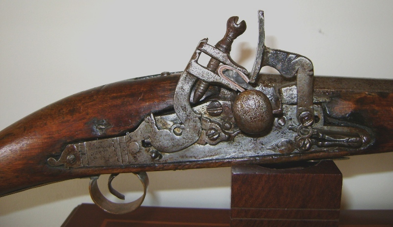

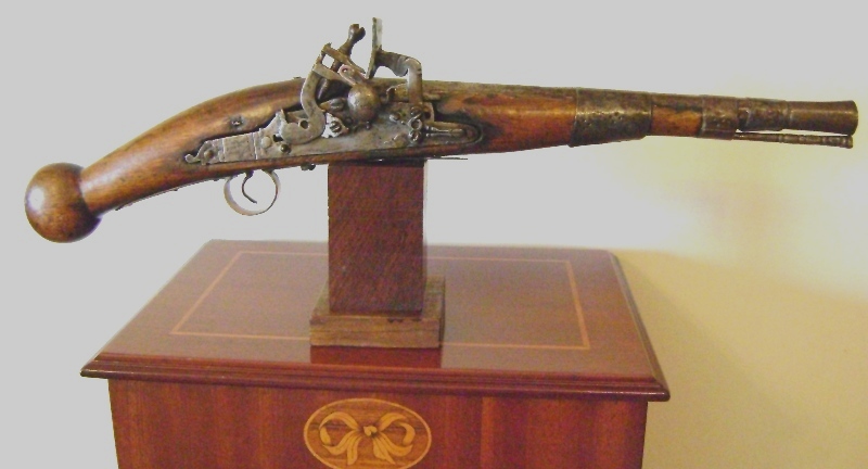

If i may hijack the thread, bluelake, attached is one rustic example of the Snaphaunce version quoted by Philip, in that the pan cover opens while you fire the gun.
I beleive this is a Moroccan specimen, possibly from the 19th century, although i ignore where the gunsmith inspired his imagination to make such a bizarre butt stock, resembling somehow those from early weel lock pistols.

To answer your question (or attempt to do so), yes I do believe that the type of snaphaunces in Dmitry's photos are very likely the sort of thing the Korean troops were exposed to in their encounters with the Russians in the early 17th cent. I'm just hoping that you'll uncover in a S. Korean archive an old military text or manual that has a woodblock illustration of the Korean version of one of these, just as we have similar documentation of Chinese copies of Portuguese proto-flintlocks.
Fernando:
Moroccan pistols are not very common. Yours is quite interesting because of its ball butt. ON the one hand, you could say it is an extreme anachronism if you associate the ball with the familiar north European wheellock pistols with the same feature. The connection is possible, after all the snaphaunce lock was introduced to the Maghrib by the Dutch during an era in which such wheellocks were still in use in places. (note also that there is still a resemblance of certain styles of Moroccan musket buttstocks to those on some types of Dutch and English matchlock guns). On the other hand, you could place the origin of your Moroccan ball butt a bit closer in space and time -- I'm thinking of the Catalan-style pistols, made in Ripoll from the 17th cent. until ca. 1800.
I checked my copy of Geo. C. Stone's GLOSSARY...ARMS AND ARMOR, fig. 649/4 is a crudely-repaired Spanish pistol (with a patilha lock) from Morocco, and 649/1 is the only example in the book with a snaphaunce lock like yours, although the butt is mushroom-shaped and not a full ball. The other two examples are local copies of Ottoman flintlock holster pistols which are themselves knockoffs (of generally inferior quality) of late 17th cent. Dutch and German originals. Indeed, Stone notes (p 503) "In Morocco and North Africa most of the pistols were European or like the Turkish, except for the decoration."
The fact that your lock has a manually-opened pan cover is very rustic indeed, the gunsmith probably lacked the skills to make the automatic-opening mechanism that is usually found on Moroccan locks. This adds to its ethnographic interest, suggesting that it came from a remote source indeed, to embody a shape of stock that had fallen out of disuse so long before in Europe.

Oh no, Philip, i guess i didn't put it right .
The mechanism in my example works precisely as you mention; the pan cover is engaged with the action and opens by itself (automatically), when the gun is fired.
Thanks a lot for the Ripoll suggestion on the ball butt; quite suitable indeed .
