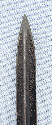

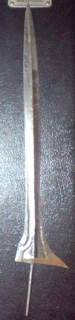

A long time ago, I started to forge a kris. I made several error in my forging and ended with a very small blade. To avoid wasting all my efforts, I decided to transform this heat welded blade in a kris patrem. Alan had told us : most of the work in kris forging, in not the forging but chiseling and filing. How right is he. Forging was not more than 5 to 10 % in time.
Once the blade completed (with errors !) I treated it not with acid, but with sulfur and salt and here is the result. I had to make the the necessary sarong and hulu adapted to its size. The total kris is only 23 cm long and the blade 14cm. This is also a lot of filing !
The mendak is the smallest I had in my reserves and I doubt I could find anything smaller even in Jogjakarta.
To work on such a small kris, does not make the work easy. Everything is so small that I have temporarily renounced to the small sculptures decorating the handle.
One thing is certain: my respect for the work of Alan and Lemythesmith has been multiplied by a factor.

Not bad Michel, not bad at all. The first keris that I made was made before I ever took instruction from Pak Parman, and its not as good as yours.
The sulphur and salt will not stain a blade, it will only reveal topographic variation in the material. There is a non-arsenic etch that will give a blade some colour, which is sulphur and rice water. I used this a few times more than 50 years ago, but never on a new blade, only on old ones, and it worked more or less OK. I mixed the stuff to a paste and applied it to the blade, then wrapped the blade in plastic sandwich wrap. It took about a week to work.
Something that collectors of both keris and conventional knives do not appreciate or understand is that the work involved in making a good quality small blade is at least as great, possibly greater, than the work involved in making a good quality normal sized blade, and the skill level required is definitely greater. Very good quality small keris blades are frequently more expensive than very good quality normal size blades, and certainly much more scarce, but try selling them on a western market.

Hi Michel, well done! A nice job-I like the "topographical" effect on the blade, nice shape too. I'm nearly done with another patrem which I've opted for a gongo iras brojol. If you let me know the diameter the mendak needs to be I have made a die for patrem mendak so I can stamp them from one piece-could send you one roughed out in copper if you wish, makes life a wee bit easier The patra carvings are not easy to get looking right-my new patrem has a horn Solo hilt and that was a swine to carve, and to get symetrical(ish)

Hi Michel,
nice small keris you have there. as you mention before, the harder part of keris making is making the detail(recikan) of the keris it self. In making the greneng we often use a very small saw similar to a saw we use on playwood. it is a very time concuming in making the greneng couse the sawing it self need high concentration and skill...
the other harder part is making the sogokan. what did you use for making the sogokan? a small grinder is an option, but it very risky . we some time use a special steel chisel for the sogokan and pijitan work.
About the mendak, we still can find a very small mendak which fit for a patrem here in Jakarta. Not always available but we still can find it.
I recon your keris handle is a little bit larger for the keris. but the warangka is a very nice job...Love your warangka...very nive job, congratulation on your patrem. Let us know if you dicide to make another keris.

Yes, sulfur and salt do not stain properly a blade, the mixture prepared as you explained, using only sulfur and rice water, seems to eat away the weaker metal in my case the iron. the nickel resisting better appears in surface and gives these topographical irregularities. I think the salt is only accelerating the process (it took 24 hours only). I have not utilized rice water, only plain water, and am just wondering why rice water. Nik Rashidin Nick Hussein, who gave me the recipe, told me "rice water" also. I think there is a chemist in the forum, may be he could explain.
I have utilized the recipe on an old blade which was in my eyes completely pamorless with a decent result. I do not know how Henk (of the forum) saw that that blade was with pamor and encourage me to stain it.

Thank you for your comments. To answer your questions : my ricikan were all done with files, as the greneng. I do not use a small grinder . As you say: it is too risky. A mistake is so easily done and often cannot be corrected.
You are right, my handle is a bit too big for the size of the keris. And it is the second one. My initial one was even larger and I had to redo it homothetically smaller. I think that my reference, also a patrem, has also a too large handle.

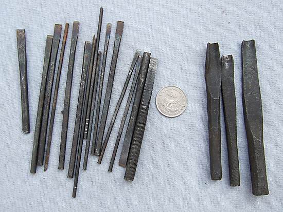

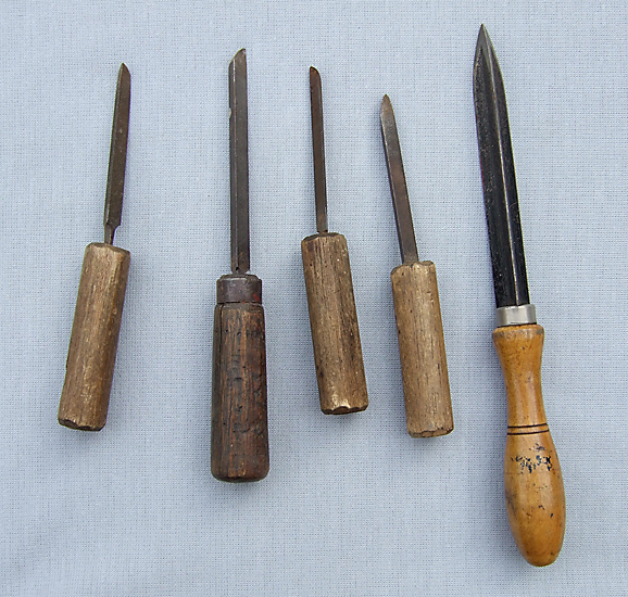

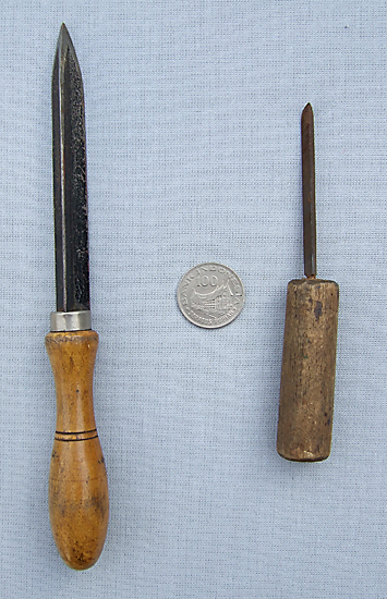

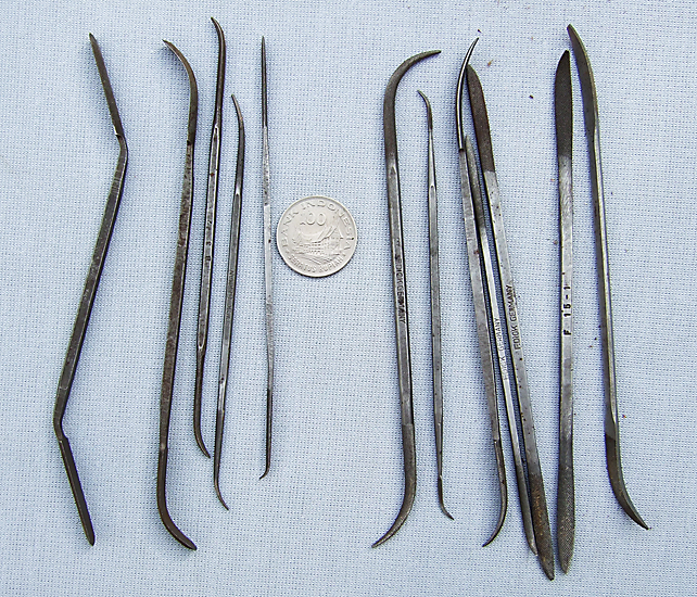

Ferry, you most definitely do not need a grinder of any type.
You can rough out with a hacksaw and a big file, and then you can cut the contours with a scraper (skrap). To do the rough contour work a big scraper that is use by motor mechanics that you can buy from a hardware shop is OK, but for the detail work you must make your own scrapers by grinding a radius onto the end of a small three sided file. You then sharpen this on a whetstone.
The cold chisels you need you do not buy from a shop, you need to make these. Old round files are the best material. You forge the point and then re-heat treat.
You need a lot of scrapers and cold chisels, because they get blunt pretty quick, and the more you have, the less you need to interrupt your work to sharpen them.
The cold chisel you use to cut the outline of the sogokan need only be between 3 and 5 mili across the cutting edge.
The grinders used by current top makers are die grinders, as well as the usual flex shafts, dremels and angle grinders, but even with a die grinder you cannot get the correct contour for a sogokan. If you are highly skilled you can get it close, but you still need to do the final shaping and finishing by hand.
Hi Alan,
Thanks Alot for your advices. I found it very very difficult on shaping the greneng. We use a small jeweller saw here. and always manage to break the saw. I'll try using hack saw and small round files on the greneng.
I'll take some pictures on the keris we're working and some measures of the keris. Thank you for every advices.

A piercing saw (small jewellers saw) is too difficult to control to cut the greneng. The biggest difficulty with the greneng is making sure the shape is exactly the same on both sides of the gonjo. With a file you can cut as near as you can the same, then just deepen the more shallow side a little to make it the same as the other one. You cannot do this with a piercing saw. You do not use a hacksaw to cut the greneng, you draw your shape with a scriber---draw it less than the size you want it to finish--- then you cut it from start to finish with jewellers files.There will be a rough edge on the outside of the cut when you finish, you must be very careful not to alter the shape of the greneng when you smooth away this roughness. You can polish the inside of the cuts with wet and dry paper wrapped around a sate stick. The main thing is to work very carefully and think before you cut---make sure you have a very clear picture in your mind of what you want to produce. This is the hardest thing in the whole process:- getting the clear mental picture of the form that will carry the feeling you are trying to generate.

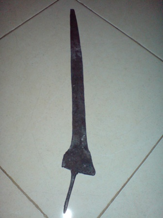

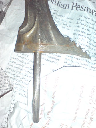

This keris is the first project which start to take its shape.
the picture took this morning ( 05.40am jakarta time) .
the greneng work done using small jewellers saw, done by a very skilled man for sure. when I find the fact using small jewellers saw is too diffficult to do, I start looking for another method for the greneng work. I really greatfull for Alan's suggestion. I'll try it on my next keris project. I'm still looking a suitable dhapur and ricikan style for this "saton" . A straight keris it gonna be , for a beginner like my self tilam upih would be great. I'm planning to make a PBX style...thick blade, odo-odo, etc.
Just cant wait till next week to start.

Hi Alan,
the angel your talking about, the condong leleh.
I have a feeling that my saton has too much angel. this is a kelengan keris.
tilam sari would be great. thanks
FERRYLAKI

Old 10th April 2008, 07:10 AM   #55
Posts: 7,255
Yep, condong lelehnya too bent forward, like a sick old man.
You can fix this when you set the blade angle---probably.
You just cut the angle at the blade base to give you the proper angle for the blade, but you will still need to go back to the fire to set the pesi right. Just make sure you don't deprive yourself of enough material to give it a good wadidang. Actually, this saton looks like its had a bit too much attention in the forge, that pesi does not look as if it is big enough to give a good solid pesi.At this point the pesi should be square and much oversize.But it doesn't matter all that much, you can always work to the pesi and make sure you don't lose anything.
The problem at the moment is I cant find any besalen to adjust the angel.
so the next project must be changed to this keris. This keris has already took its shape. Most of the shaping worked by my brother, and a grinder was involved. We're now trying not to use grinder no more. files and hecksaw is an option.
I'll post another pictures for further progress on this keris.
hope we can make a healthy shape for this one. this is a kelengan ( pamor less keris )
the gonjo may be too small ... but it already took shape.I cant go back with the gonjo, so its done. filing and sharpening would be our next time consuming job.

Ferry, this blade needs to be refined by using scrapers. There is no more work for a hacksaw here, and the rough shaping has already been done, so there is limited work for a file. What you need now is to use scrapers to do the kruwingan and refine all the contours.
There are plenty of smiths in and around Solo. Just take the forging back there and alter the angle.Make sure you have your blak with you.

Alan, can you discribe what a scraper looks like?
does sandpaper could become a scraper?
do you have a picture of scraper?
sorry for my lack of knowledge...
FERRYLAKI
Jakarta
ferrylaki is offline   Reply With Quote
Old 12th April 2008, 12:37 AM   #59

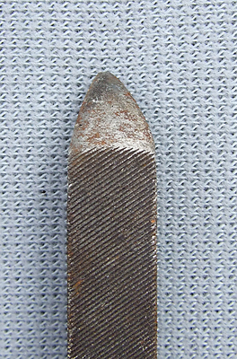

Posts: 7,255
Ferry, if you go into a hardware store, or motor mechanics supply store and ask for a "skrap", they will show you a scraper that mechanics use to fit engine bearings. This is the large, commercially produced scraper you can see in the photos. This is a useful size to work the length of the blade and to rough out the kruwingan.
The other smaller scrapers have been made from three corner files. You can buy second hand ones from the junk markets. You just use a grinder to grind a radius onto the end of the file, and then sharpen it on a whetstone.
The funny looking bent tools are riffle files. You need these for refining the various contours. These files here are Dick files from Germany, which probably cost a king's ransom these days---I haven't bought any for maybe 10 years or more and the last one I bought cost me more than $50. However, you can buy Chinese ones in Indonesia. They're not as good, they do not last as long, but they can do the job, and they are much, much cheaper.
The chisels and gouges are made from old files and other tools, and a few are made from 01 tool steel. You use these to begin the shape of a feature and to remove big quantities of metal. They are not used for fine work.
The other tools I have use to make keris, and that are not shown here are normal small jewellers files, a 6" file, and big heavy 15" file, a hacksaw, and a small hammer. The hacksaw and big file are only used in the initial shaping stage.
Using only these tools, this is what can be produced:-
http://kerisattosanaji.com/PBXIImaisey2.html
wow, so many tools...
I really should complete my tools.
people these days depend on a grinder and replace the old method of keris making.
I'll try to find those tools from now on.
thank you very much for these helpfull pictures Alan.
I really appreciate your kindness.
