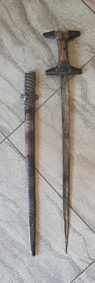

Hi All,
I know that it sounds like the beginning of a verse from Shirley Ellis' name game song but I was wondering how forum members would classify this knife. The hilt is clearly an s’boula/jiboula form but the blade and sheath are just as clearly shula. I’ll come right out with my opinion that it should be considered an s’boula/jiboula because the hilt was placed on the blade by a person of the s’boula/jiboula culture. But were the situation the other way around (shula hilt on an s’boula/jiboula blade), I’m not so sure I would want to call it a shula. What do you guys think?
Sincerely,
RobT

When it comes to ethnographic arms, we tend to classify swords and daggers by their hilt. For example, the same blade can be a takouba, a kaskara or even a firangi, depending on the hilt.
Based on this then, this would be a sboula.

Very nice and interesting dagger! For me it's just the name game. I wouldn't be surprised that "s'boula" and "shula" are only different spellings for curved dagger and the "classification" for two, for our view, different curved daggers, is a western collectors "classification.

Rob,
Coming back to your knife at the start of this thread, I think it might be an example from the area where the s'boula and shula coexist on Waelty's map. In other words, a local hybrid of the two. I think you could call it either a s'boula or a shula or a hybrid of the two, just as we see hybrids of Moroccan koummya/khanjar in the late 19th/20th C.
