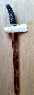

Hello
I would be grateful for your views on age and type of this keris please. Blade length is 44cm. The scabbard is described as ivory and wood. The hulu is silver. The keris is described as Balinese. The dhapur and etching is not typical for a Bali keris but there is a Balinese dhapur Marap that resembles this shape in lacking the elephant trunk and having a straight blade shape and similar fullers. The etching is also noteworthy but it may just be out of stain. Thank you in advance.

An interesting kris probably from Lombok, the hilt depicts a demon which may be Ravana. The blade would benefit from warangan treating indeed, the ivory warangka in kekandikan style is discolored on the back side because the maker used the outer surface of the tusk. I would estimate the age to first half of 20th century but the hilt is probably more recent.
PS: The top part of the warangka may be from bone (the pics are not clear).

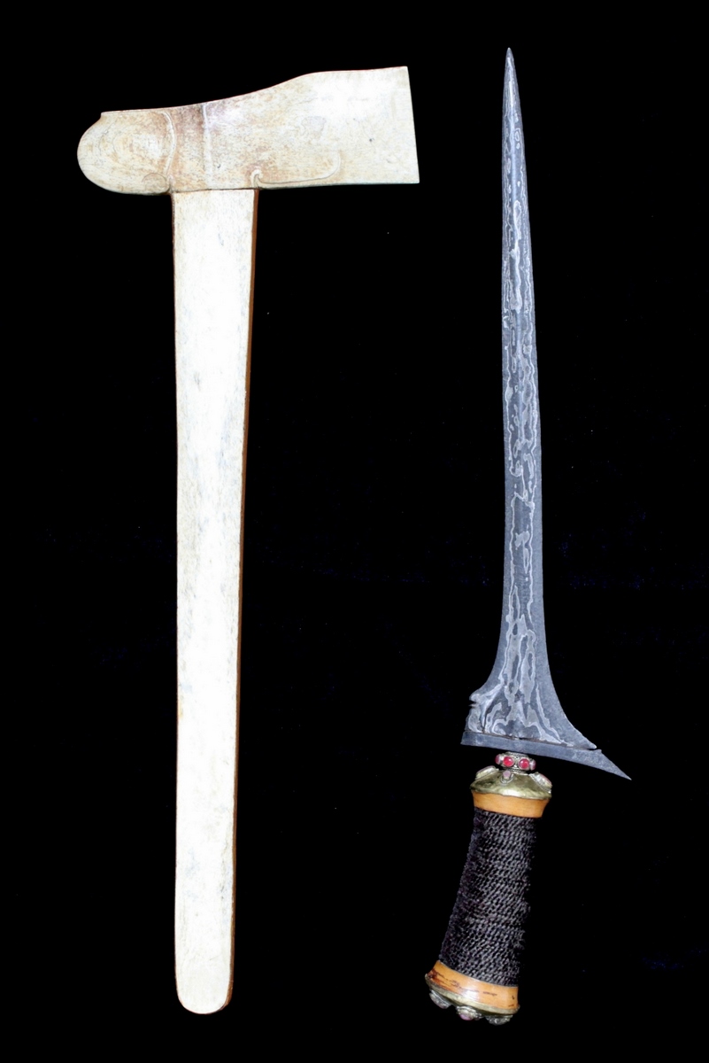

Thank you and yes, ivory materials is very possible but the small pits on the reverse side may indicate bone. By the way the hilt is placed in the reverse position.

Yes, an ivory atasan is much more prestigious and expensive than a bone one.
Bone would often decay quickly (more or less depending on the type of bone and the selected piece) so it generally looks older than an ivory one of the same age, except if the ivory piece has not been properly selected .
See specimens of an ivory atasan (left), and a whale bone one.

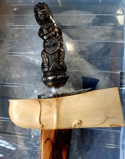

I have now received the keris and having checked it carefully I can confirm the Atasan is made of ivory and not bone. I am unsure if this necessitates any reappraisal of the age of the dress or not.
SidJ is offline   Reply With Quote
Old 31st May 2022, 05:26 PM   #17
Posts: 7,297
Personally i never thought it was bone, but i could not see any evidence of Elephant ivory (Schreger lines). Now that you have it in hand can you tell what type of ivory it might be? I'm not sure how much adjustment there would be to the age of the dress. It does seem newer than the blade and 20th century. Likely post-WWII, but it is still hard to tell from the seller's photos. The atasan does seem a little stiff in it's form which might point more to a later date than earlier. But these photos are all from odd angles. Maybe you could post some new images now that it is in your possession.

Hi David,
I can see Schreger lines and therefore conclude it is elephant ivory

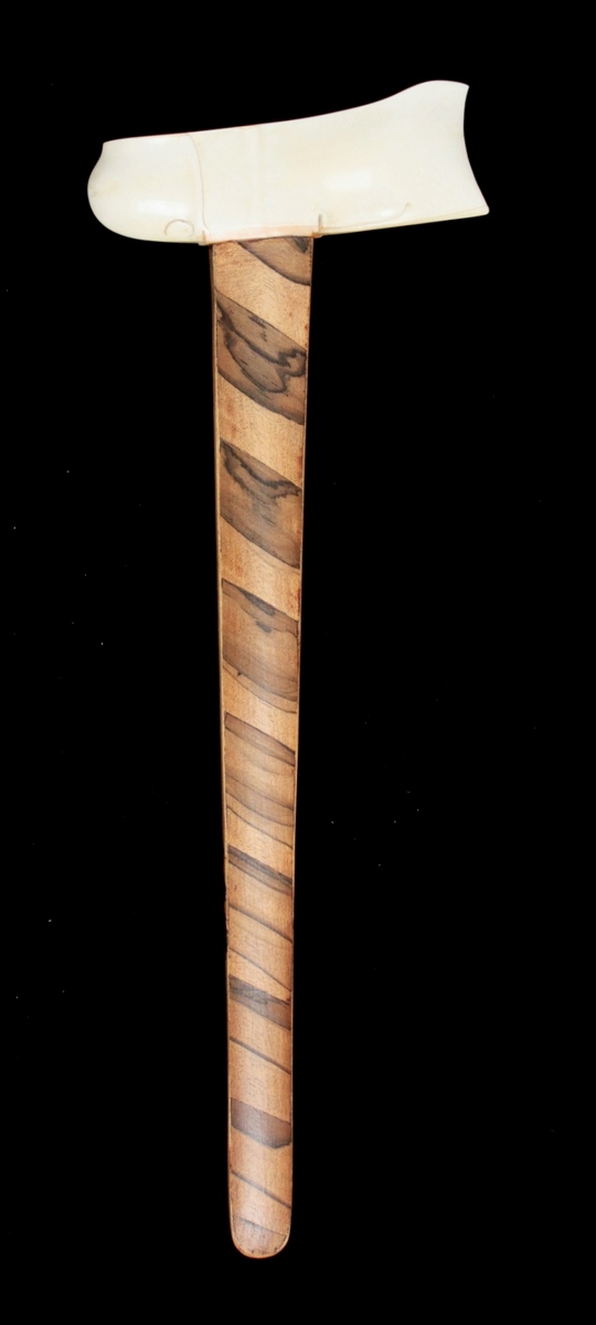

Old 31st May 2022, 05:55 PM   #20
SidJ
Join Date: Apr 2020
Posts: 244
pic
Hi David,
Thanks Sid. I saw these pics on the FB thread. I could see the Schreger lines there. Clearly elephant ivory. You might need a larger imager to convince the doubters here though.

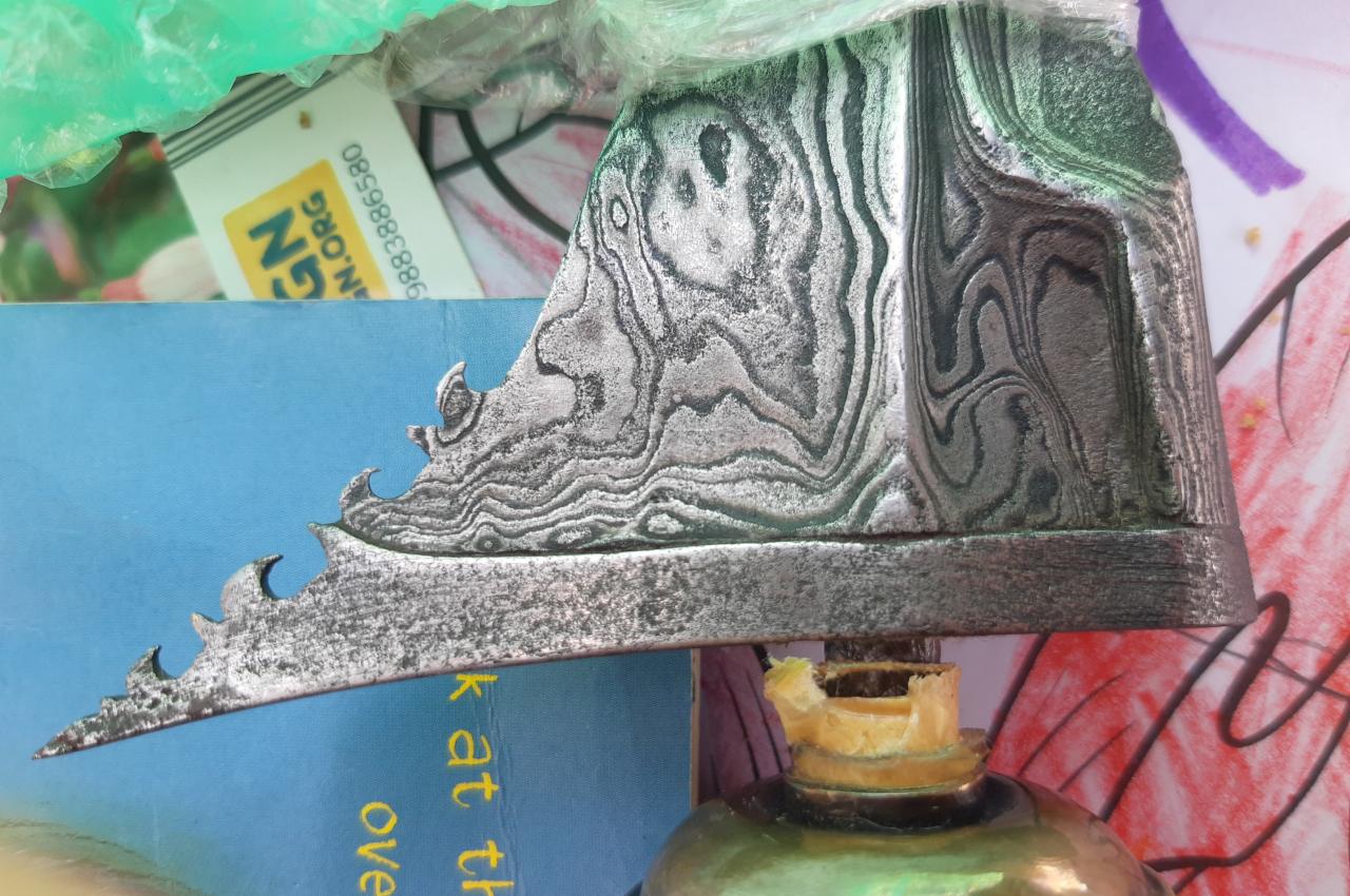

Interesting to see a Bali style Keris with defined Blumbangan but without Kruwingan and Tikel Alis. An unusually plain appearance.
SidJ, is there a possibiity to post a good picture of the base of blade with Gandhik on the left? Thank you very much!
And, is the blade alone indeed 44 cm long?

Gustav see pic
