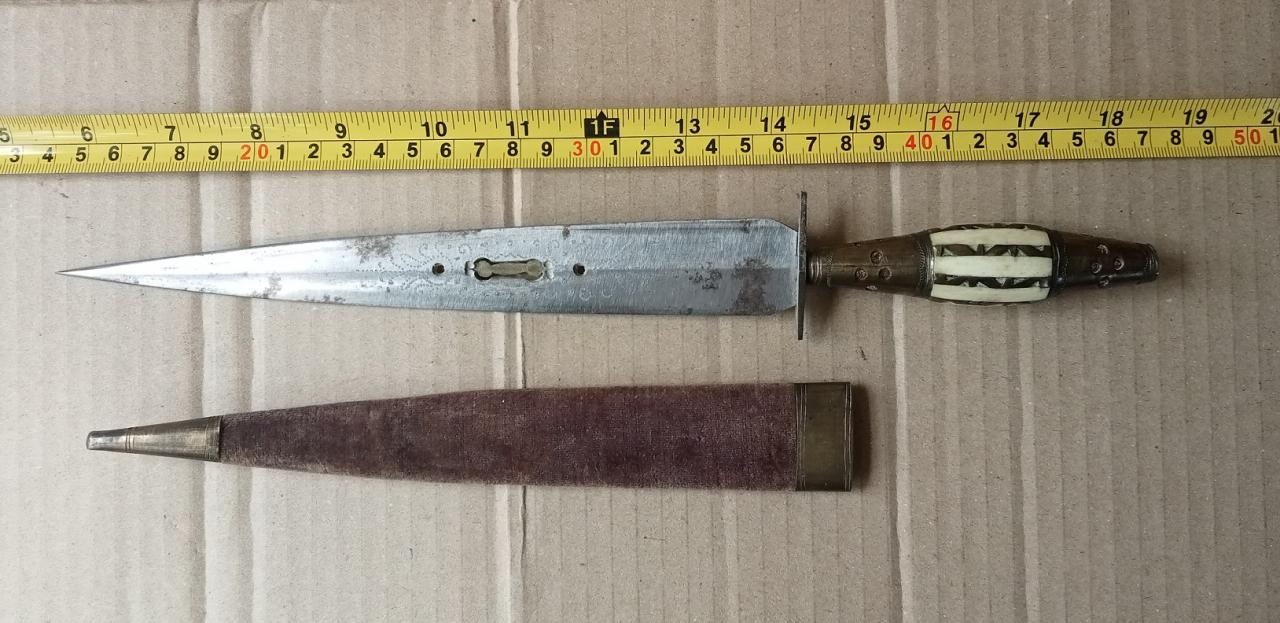

Another one that arrived at mine yesterday.....
