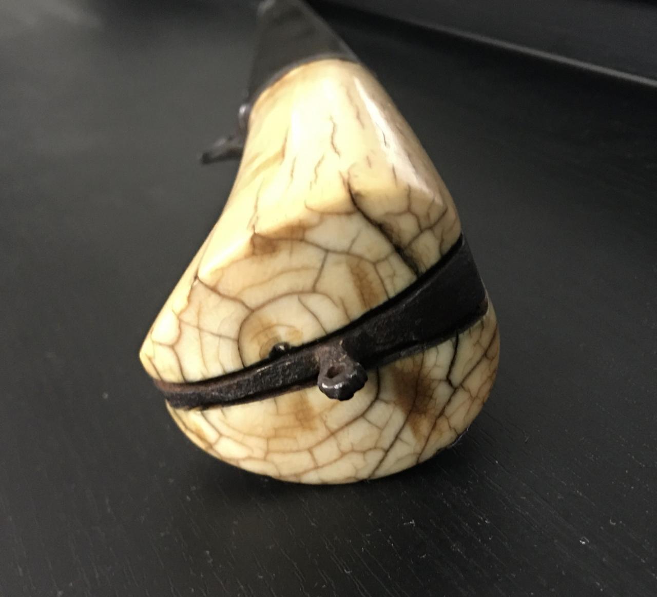

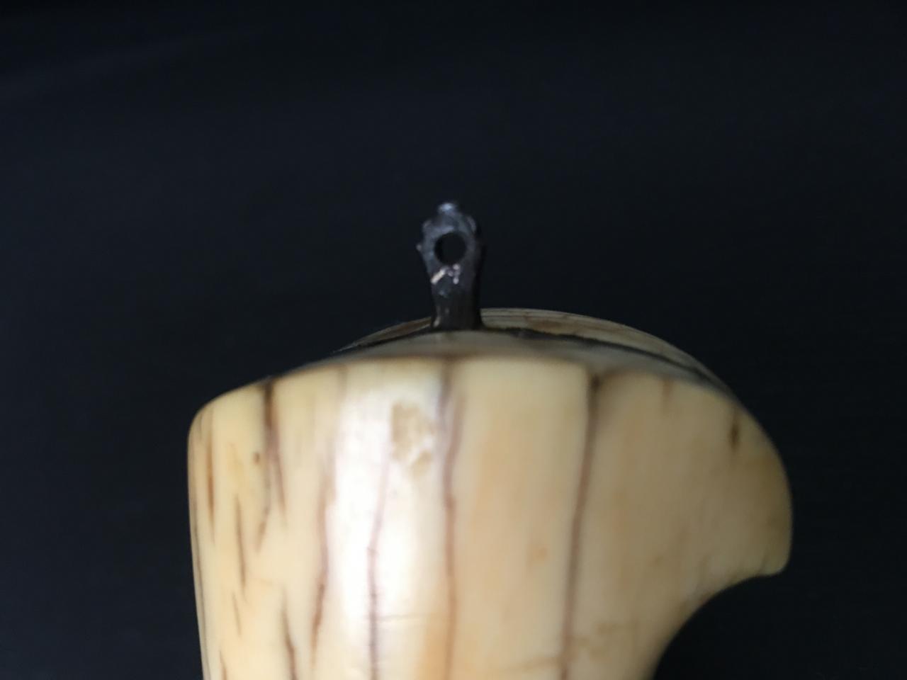

Regarding the use of coffee, it was a first for me and something that I learned about on this site. I believe coffee contains tannic acid. I used it because I was away camping when I collected the blade from a nearby auction house, so I had to improvise. I just filled my thermos with strong black coffee and submerged the blade for about 5-10 minutes, I was quite impressed by the results. I repeated the process in a deeper container when I got home. The Pesh Kabz is 16” overall, with an 11.5” blade.
Below are a couple of extra pics of the handle, showing a protrusion with an eye hole. Perhaps it originally had some kind or decorative tassel?
I shall try cleaning up the bolster toady and see what I have.
Thanks again Gents

Apologies for the blurry pics. I think my phones camera is on the way out!
