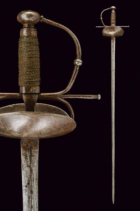

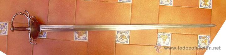

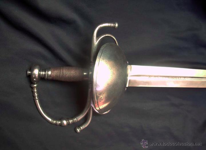

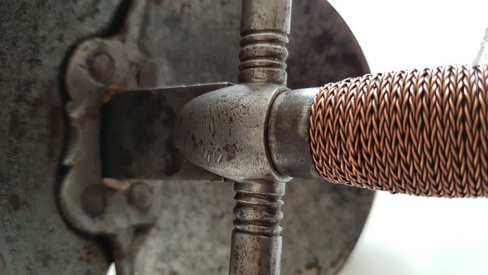

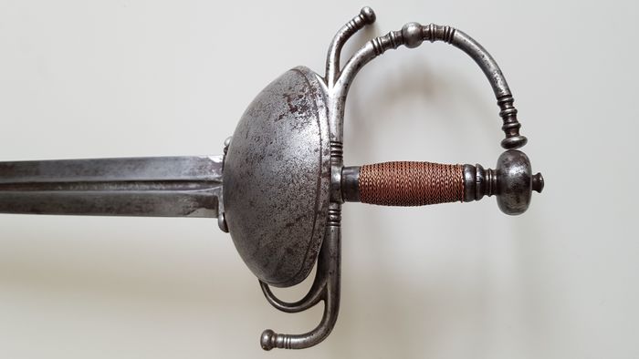

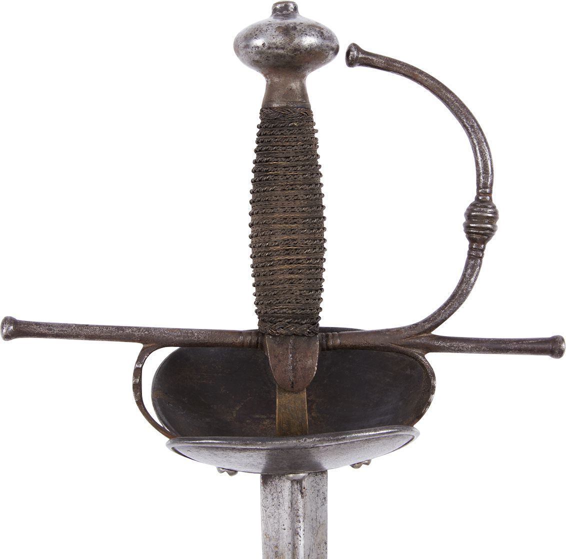

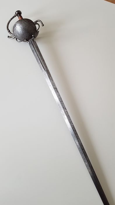

This is the sword, only one of the pictures has clear clues to think the sword is from a later period.

Other than the new-ish grip wrap, what is the giveaway here? Looks like a nice period sword to me.
Old 30th May 2021, 03:12 AM   #14
M ELEY
Location: NC, U.S.A.
Posts: 2,229
I concur with Dmitri. It looks of the period to me except for the wire wrap-

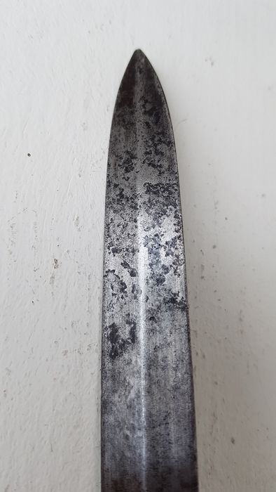

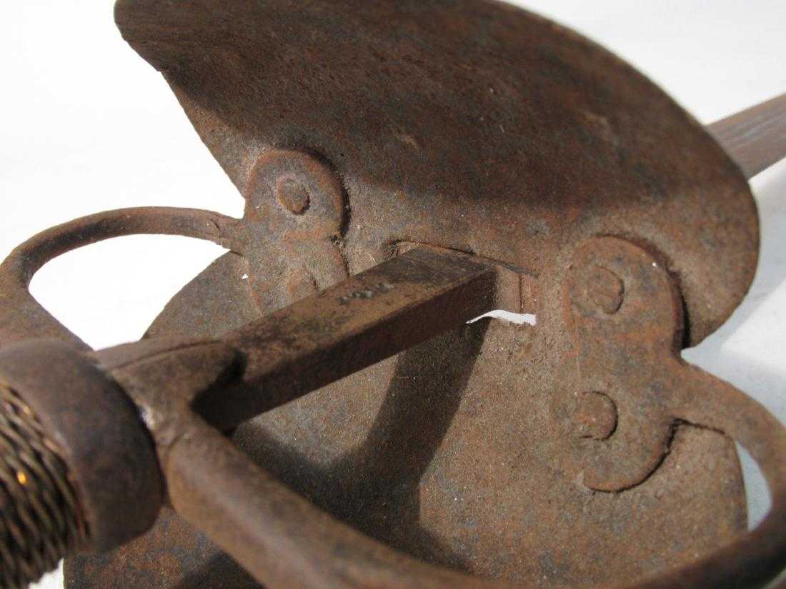

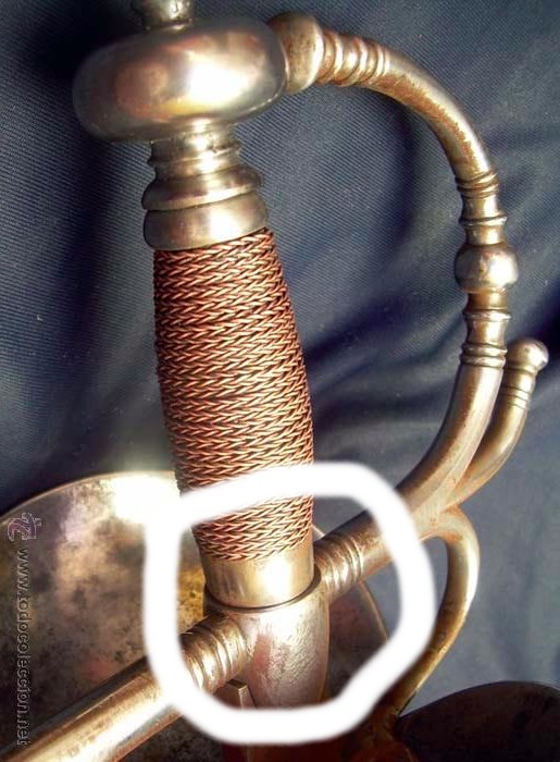

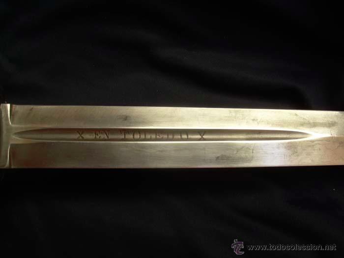

There are two problems here. The first one is that the cross is of the wrong shape and too perfectly executed. I have never seen a real XVIIIth century 1728 where the transition from the round quillion to the shields surrounding the cross are perfectly simetrical. Usually this is made by soldiering two shield-like pieces to the usual cross. Here, this has been made by adding the quillions to a slightly oval cylindrical piece. This can be seen at the 1910 catalog too.

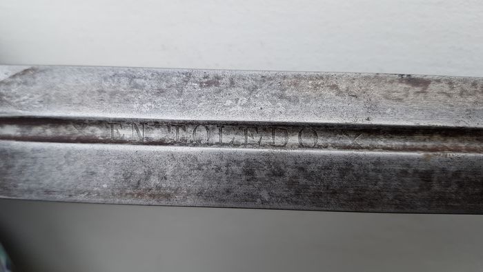

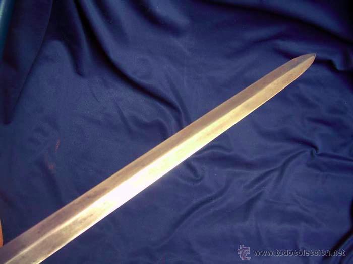

The second problem is the blade motto. The blade shape is typical from the period shortly before the refoundation of Toledo, 1740-1760, or rather earlier. If the motto would have been x EN SOLINGEN X or X KEISER X or X ENRIQUE COEL X. But that is a blade (and hilt) typical from a time when Toledo was functionally dead.
I believe the 1910 Fabrica de Toledo replica was made copying from a real sword, but this sword sported a Solingen blade, and they wrote instead X EN TOLEDO X.
The only X EN TOLEDO X large cavalry blades I could find were copies of the 1796 model made at the end of the XIXth century and this other next sword, sold some 6 years ago.
It is so much similar to the sword auctioned this week that it could be the same sword, just before being forcibly antiquated. Or it is a twin of the 1910 replica. I repeat, I have not seen that X EN TOLEDO X blade on a 1728 outside these two (one). I do not believe this has 270 years.
I believe the now defunct Madrid Army Museum had a number of the 1910 replicas used to dress mannequins with period uniforms, but as I do not live in Madrid I was a bit unaware of the danger of these replicas. Specially if antiquated.

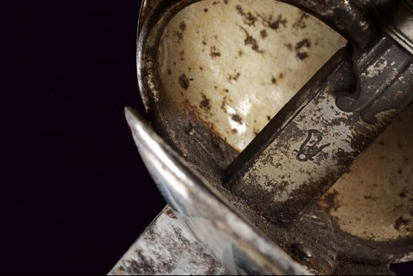

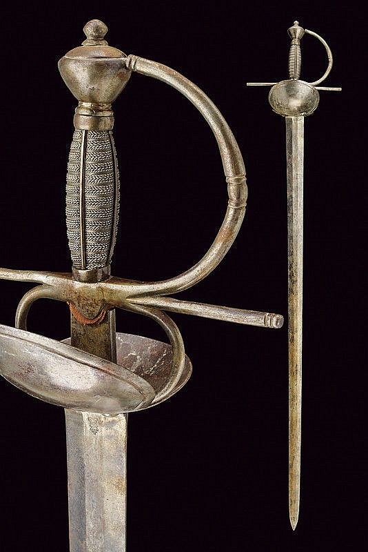

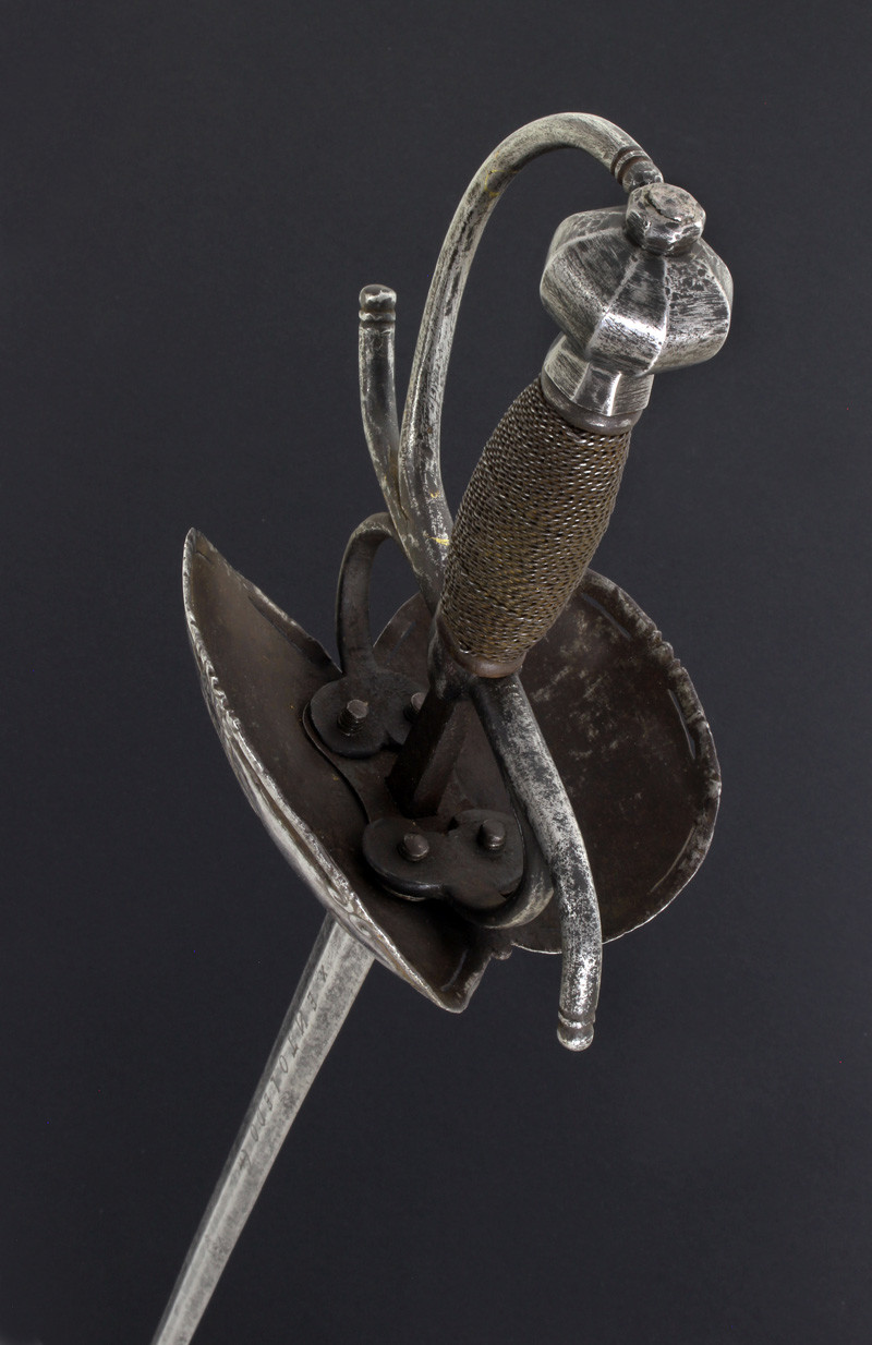

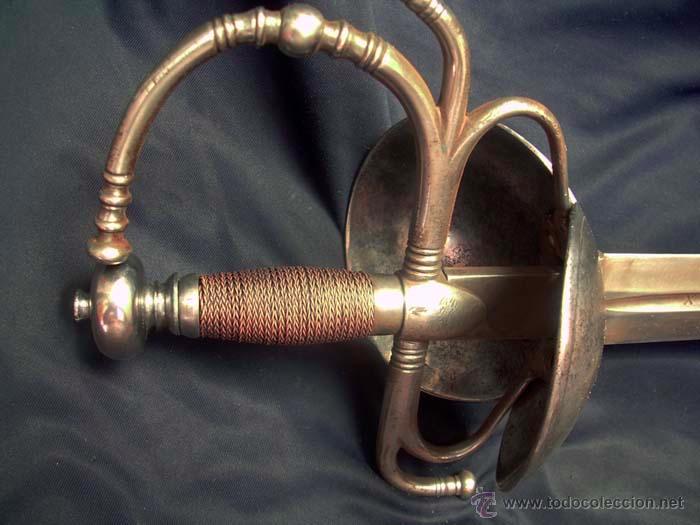

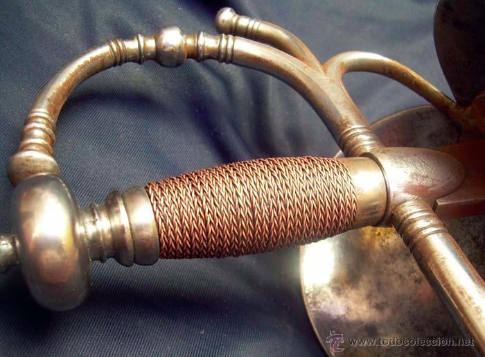

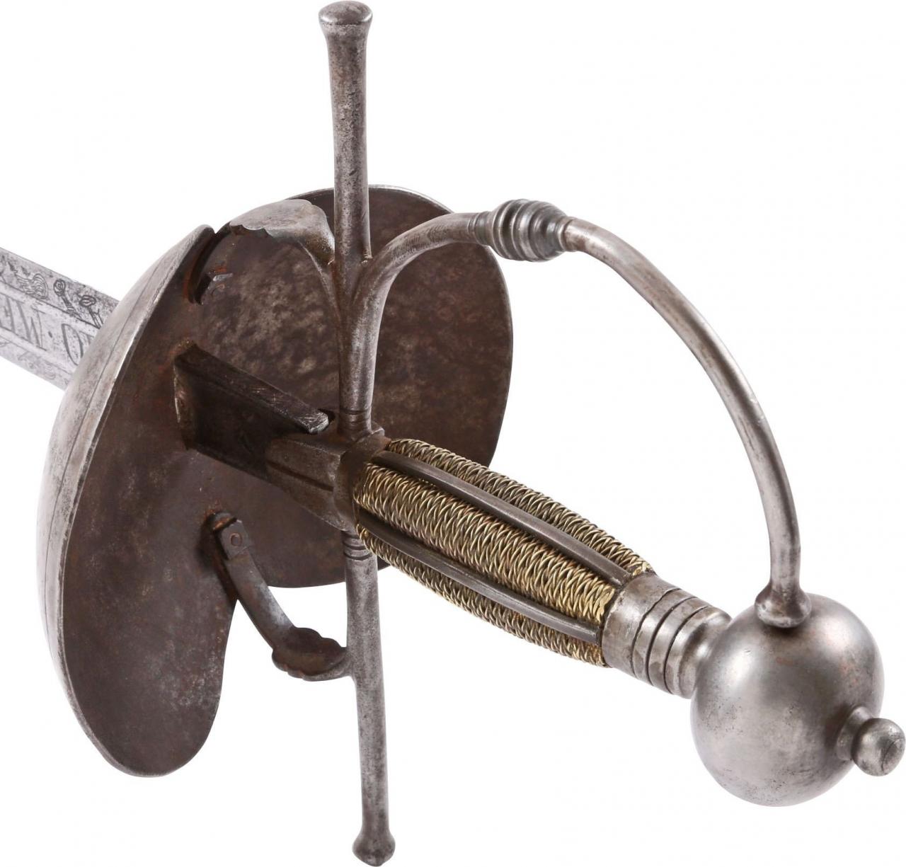

Just to show the point of shields at the cross.
Officers swords (and Guardias de Corps) have often a shield with a lyra like form. Troopers and some officers swords have just semicircles.

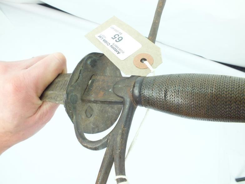

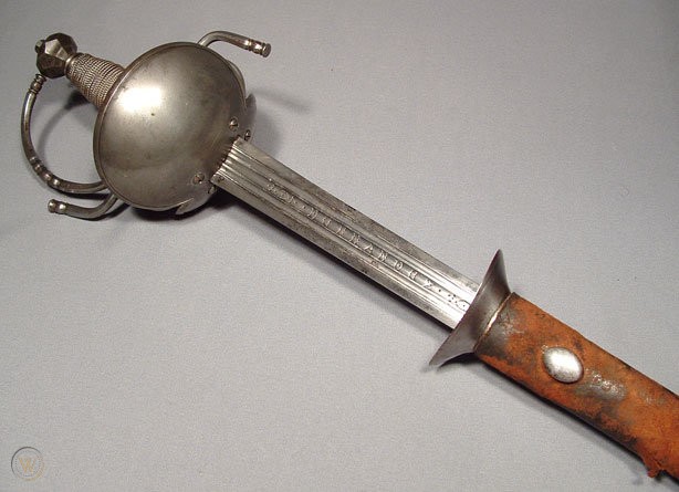

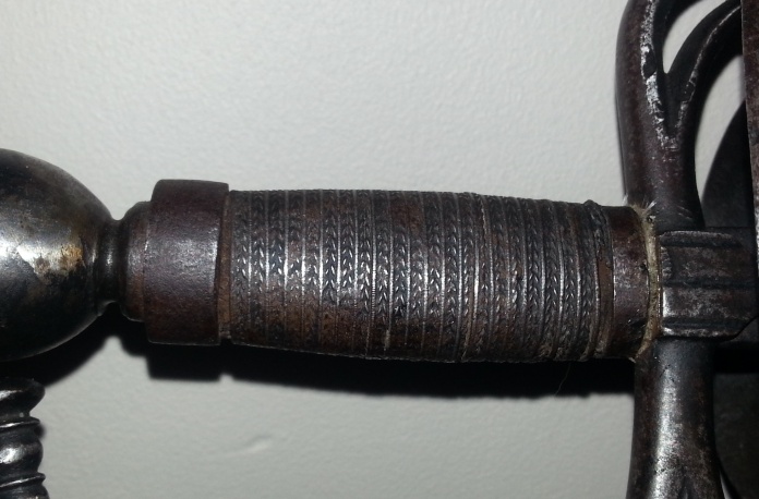

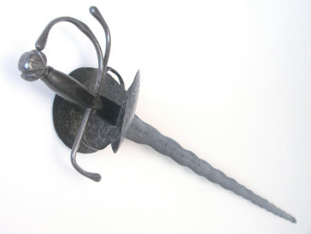

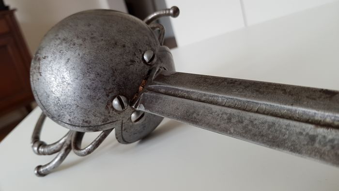

Some older 1728s.

I see what you are saying.

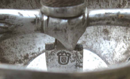

The junction/quillon block where the pas de ane and quillons emanate is too perfectly round in the area I circled. It was probably cast, while some of the other examples you posted were wrought.
If F.ca de Toledo did have this particular sword in their catalog, they must've made more than a few. Although, to be fair, the catalog sword isn't the same as the one you bought. The shell is more shallow on the catalog sword, the grip is different, the knuckle bow does not reach the pommel.
The second sword you posted, the unaged one, is the twin of the one you bought.

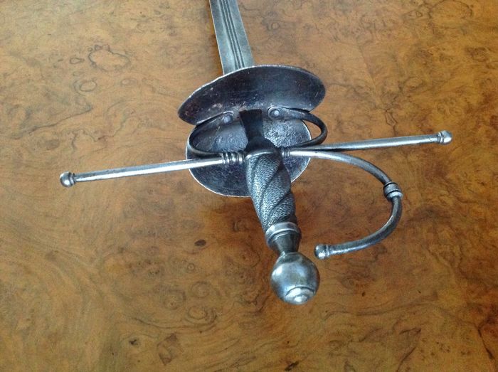

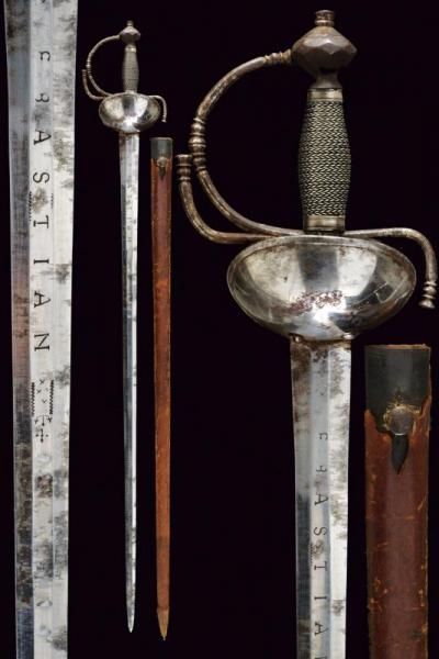

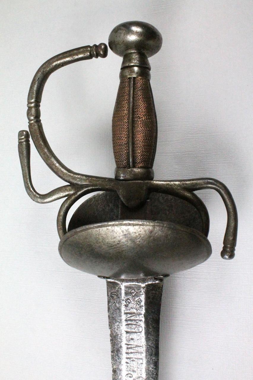

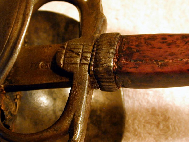

I just happened to stumble onto this thread just now, but I recognize the sword under discussion as I bid on it last year as well (I recognize the bright patches near the guard)! A good humility check to find out a year later that I was bidding on a reproduction!
I ended up buying this one instead (although not at that auction and from the looks of it after it had undergone a bit of cleaning, so I guess a reseller; pictures attached from the auction site as mine are all blurry due to bad camera).
Now all of a sudden, of course, I'm really hoping there's no 1910 Toledo reproduction with a silver wire grip and facetted pommel marked Sebastian Hernan[d]ez.
Although, either way, it handles like a dream.

Hello.
I do not think that is a repro but a very nice officer version. The octogonal pommel and the striated guardapolvo at the bottom of the cup are typical. You can find them as well in royal Guardia de Corps troopers.
Take the Sebastián Hernández inscription as apocriphal until you can compare with well known examples. Madrid royal armory ones for example, or the one that belonged to Alvaro DE Bazan in the naval museum.

Thanks, for your thoughts. }|:o) Indeed, I found some quite similar specimens online, like this one and this one. Otherwise I probably wouldn't have felt comfortable buying it! Still, it's good to hear that you agree.
And yes, I took the Hernan[d]ez name as more of a tribute or an attempt at marketing/boasting than it being an original blade by that maker (not in the least because the name is misspelled).

It is very nice you got it with a scabbard. the hilt and grip are probably from 1790s. The rings at the grip could be silver or silver plated. I think I recognize the mark at the ricasso as one from Solingen.
Yeah, definitely. The scabbard was a large part of why I jumped on it. It does seem to be missing the locket though (see attached image or this one). Perhaps I'll run into one of those at some point.
I'm not great at recognizing materials and I haven't done any acid tests but both the grip wire and the ferrules/spacers look like silver to me and they are not magnetic, so my guess would be solid rather than plated.
