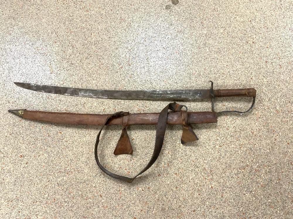

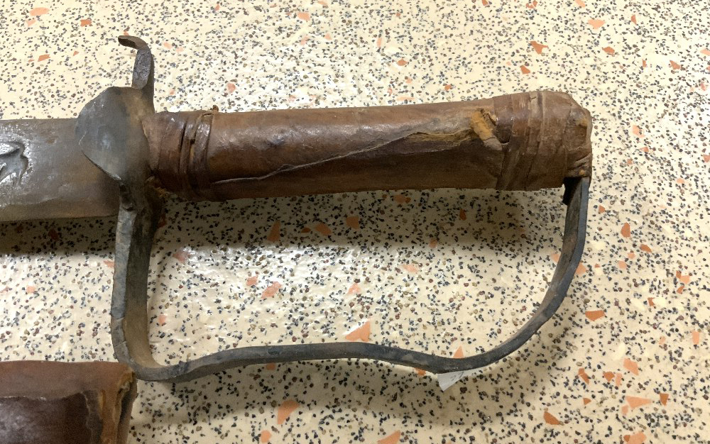

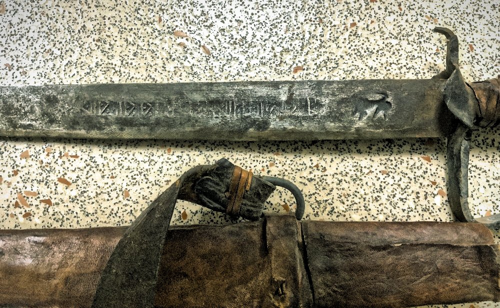

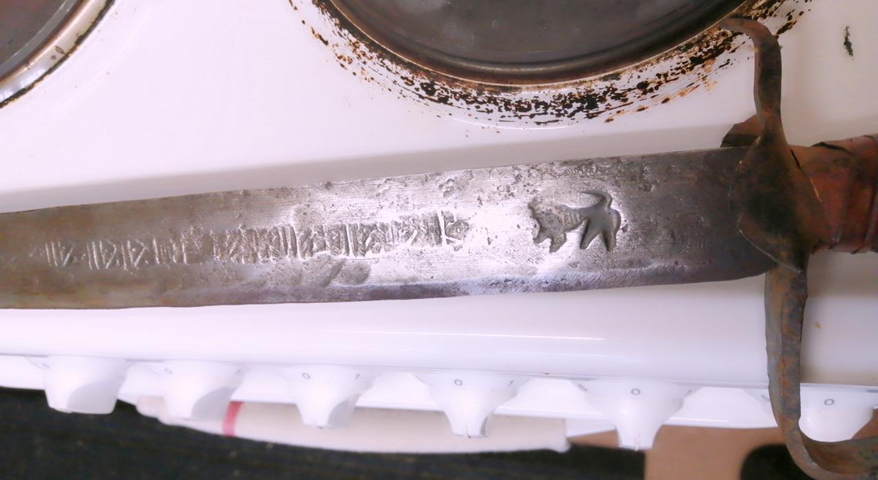

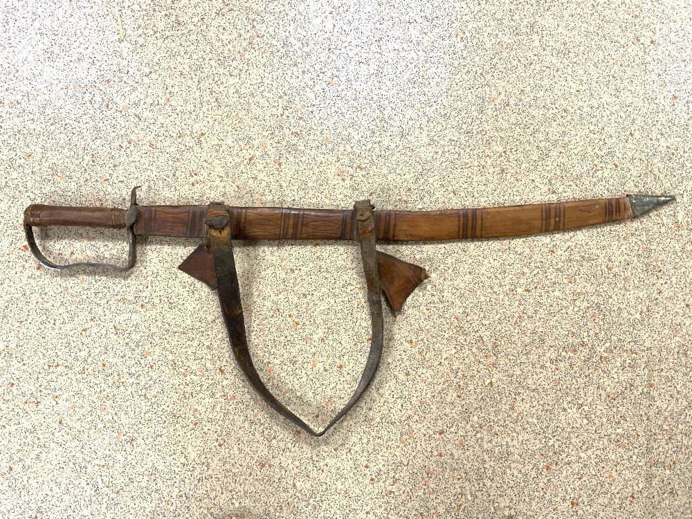

Just aquired this one. Described by auctioneer as an 19c Sudanese sabre.
The scabbard does look Sudanese, the sabre shows western influence, if not mfg.
Any comments, discussion would be appreciated, Thanks in advance.
No dimensions yet, should arrive next week. I'll update then.

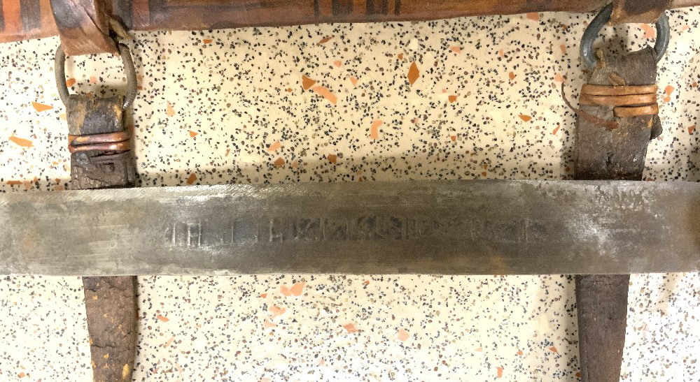

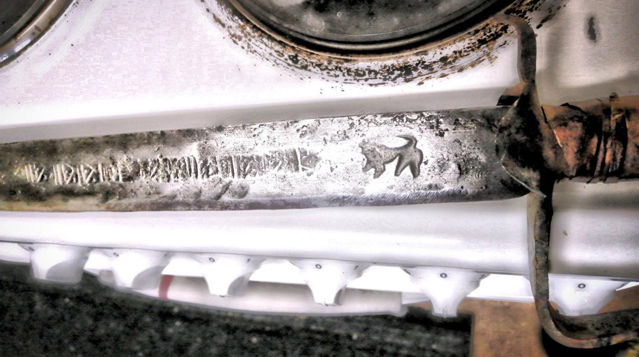

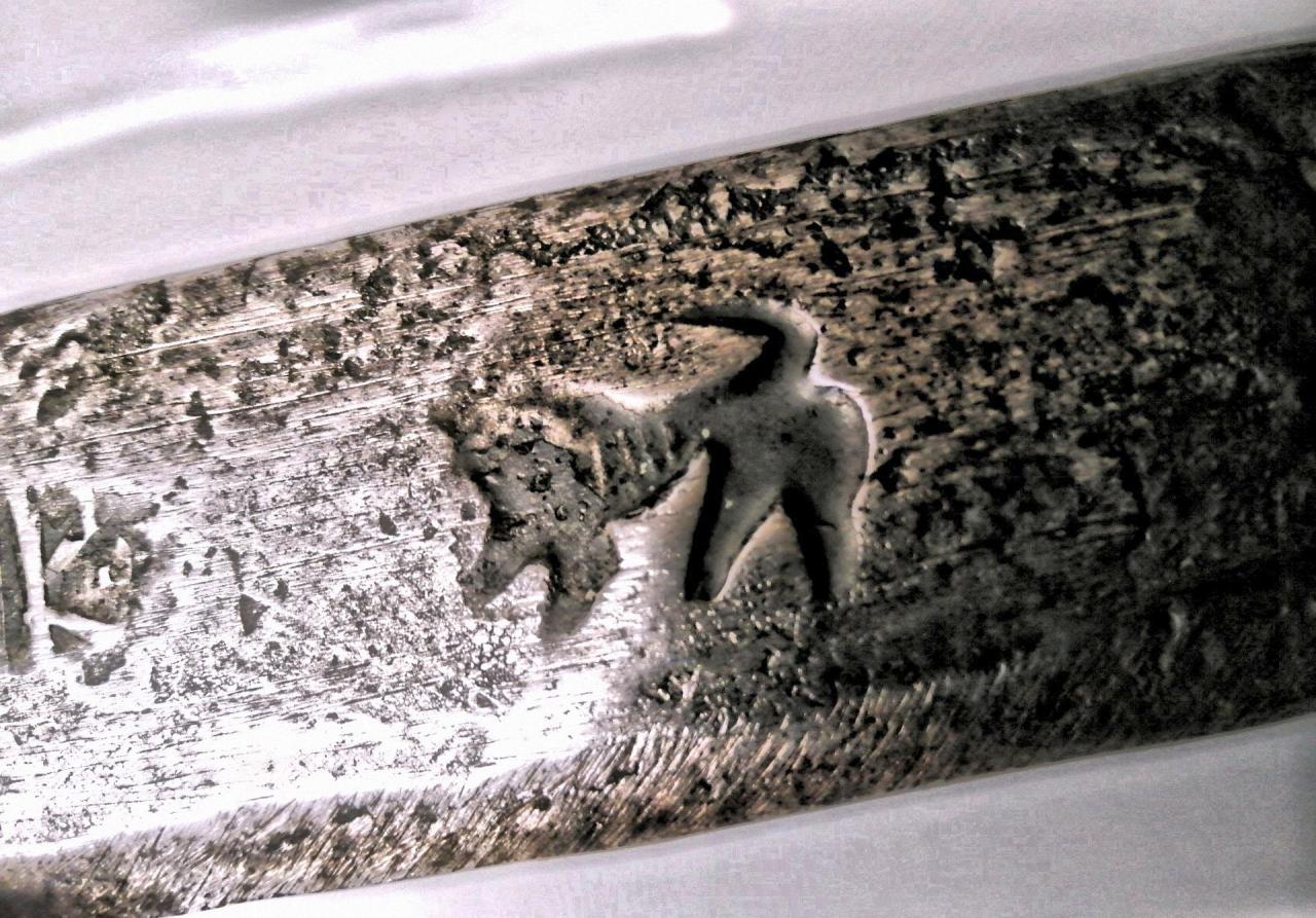

Old 5th March 2022, 01:28 PM   #3
Which one ?

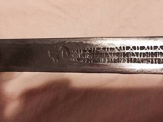

Was still tweaking/editing photos

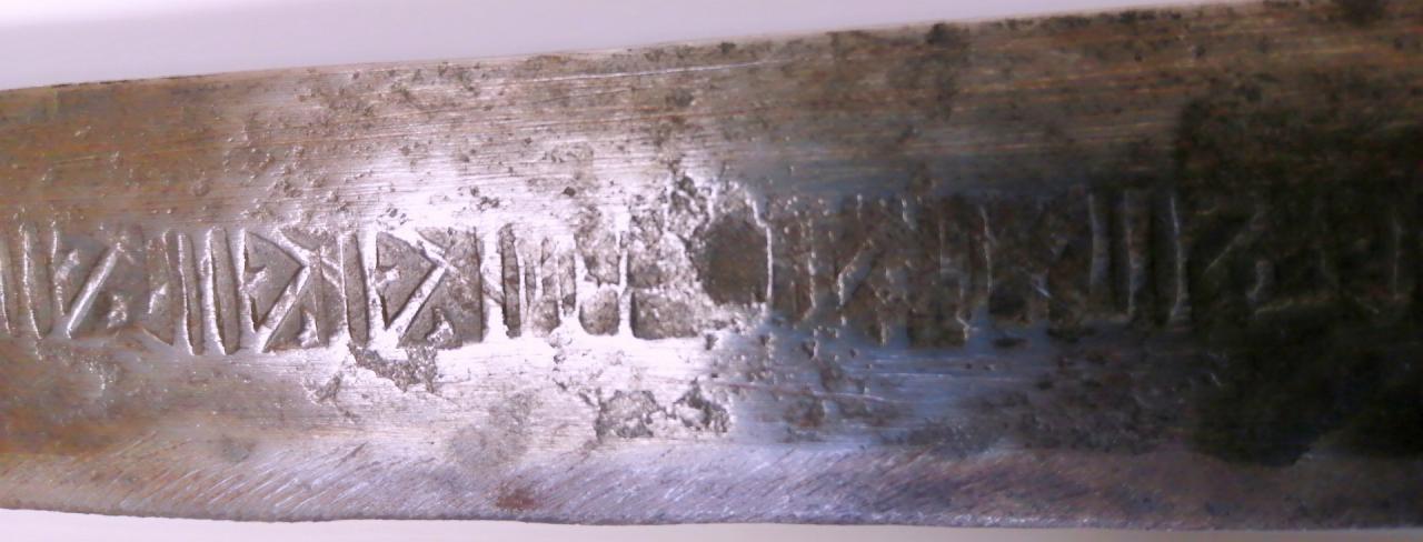

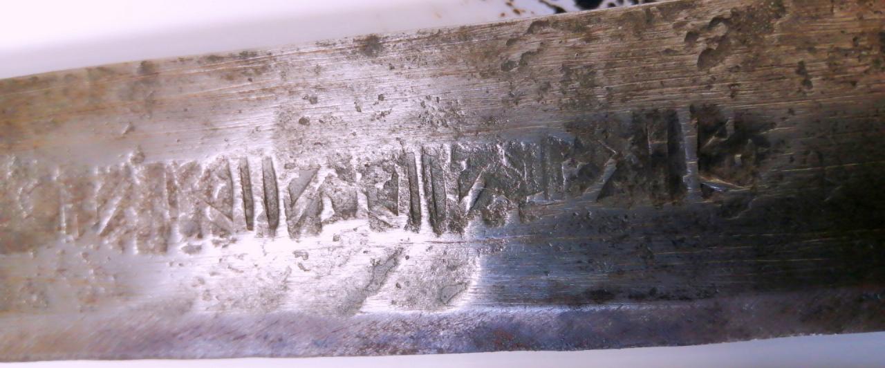

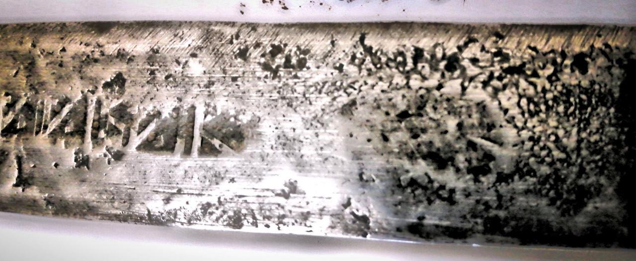

Tweaked the stampings ones, is that an ethiopean lion stamp, lettering looks like coptic rather than arabic.

Old 5th March 2022, 03:09 PM   #4

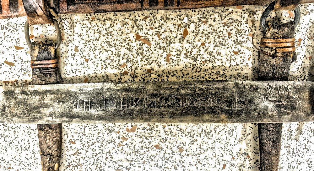

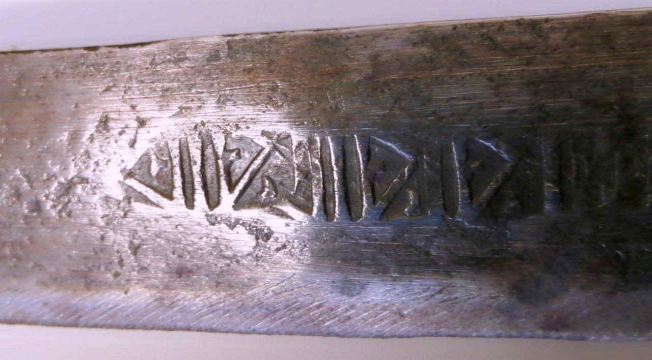

Waiting for better photos of the lettering in the blade, when it arrives
Old 5th March 2022, 03:53 PM   #5
Wilco.
Looks like it may need a bit of cleaning too. Will use my HDR camera & try for better side lighting to contrast the letters.
Old 5th March 2022, 08:32 PM   #6
Edster
Join Date: Oct 2010
Posts: 452
The last pic has a stamp that looks like an Ethiopian lion, and the lettering in the fuller looks like what has been IDed on other threads as Ethiopian. Could be an Eritrean/Beni Amer adapted Ethiopian military sword.
Ed
Old 5th March 2022, 09:12 PM   #7
Thanks Ed, that confirms my suspicions, and pins down the area better.

This is an improvised saber of a respectable age and unquestionably suited for a practical battle use.
When the blade is cleaned we shall be better informed about its origin. Even then we may not know whether it is , say, Ugandan. Somali, Ethiopian , Sudanese etc.
And this is my only hesitation about its value as a legitimate example of a certain tradition. Meanwile it is an unquestionably usable object coming somewhere from a multitude of potential village smithies all along Eastern Africa. It is a legitimate usable weapon, but its historical value is negligible. Currently it is a mix-and-match production the origin and the usage of which are unlikely be ever revealed. Charming, but not of a scientific value.
Old 7th March 2022, 06:47 AM   #9
Posts: 10,872
Really interesting Wayne!!

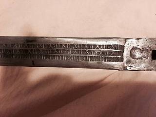

It is not unusual to see western influences in latter 19th c. African swords, and this looks like a village blacksmith rendition of a stirrup hilt.
The scabbard looks remarkably Sudanese (the shoulder strap etc.) but I totally agree with Ed, the stamped markings on the blade are seen on some apparent Ethiopian examples of kaskara, and as noted the kaskara was found in Eritrea as well.
I have seen kaskara with this kind of centrally placed linear script which appears to be Amharic, and the lion placed in that configuration similar to Ethiopian blades which also have a human head. These are thought to be perhaps commemorating the death of the Ethiopian Emperor Yohannes IV who was killed at Battle of Gallabat Mar. 9-10, 1889.
This was end of conflict between Mahdist forces and Ethiopian, with Yohannis killed and beheaded, thus the supposition of the head on the blade with this type script and the lion. (pic attached of Yohannis IV in 1884).
The blade is rough but of course recalls the shotel blades of the well known gurade sabers which of course, as with the hilt style,were of European style.
Most likely a saber of Ethiopian border regions of this latter 19th c. period, and with a great deal of historical possibility with these points considered regardless if this must remain speculative.
Ariel, I took the liberty of posting this kaskara you posted in Aug. 2015 which had similar motif, and was regarded as likely an Ethiopian straight blade possibly commemorating this battle.

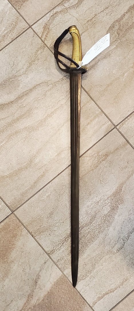

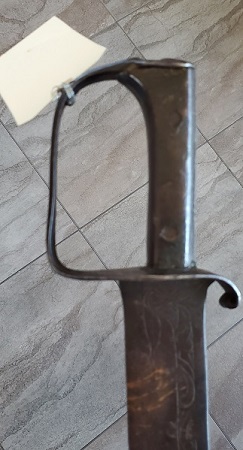

The ERSATZ denominator for edged weapons is actually often quite broad in remote and frontier regions, especially in colonial situations. In the tribal areas of Africa in many cases it was actually prevalent as natives used the blades brought in with trade more often than using those locally produced. Also many foreign weapons were constantly repurposed.
In colonial New Spain, the 'machete', commonly termed the espada ancha, was a locally made cutlass type hanger made in imitation of those typically seen in maritime use. While these were indeed 'ersatz' in a sense, in the early days they were often fashioned from cut down Spanish dragoon broadsword blades until local blacksmiths began making heavier blades.
The first picture is a traditional style espada ancha; next is an 'ersatz' version which uses a 'briquet' hilt, a three bar cavalry guard, and the Spanish dragoon broadsword blade which is cut down.
Examples of these kinds of weapons are a genre of collecting virtually of its own, and the examples are intriguing elements of history in many if not most cases.

Old 9th March 2022, 11:31 PM   #17
I think we have to distinguish between “attribution’ and “habitation”
The former indicates belonging to a certain ethnic military tradition, the latter to the place it was used.
We can see pulwars in Central Asian museums, British swords in Indian arsenals, Portugese, Spanish and French blades on Moroccan nimchas, one of the internet auctions recently sold a a classical Ottoman kilij with obviously latter engraved Sanskrit innscription on the blade. Egerton included Ottoman yataghan into the plate with Nepalese weapons ( likely, it might have been bought there).
How are we to attribute them? IMHO, we may desribe them as “ Moroccan nimcha with a repurposed French ( or other) blade’’, “ Ottoman kilij with ( later) usage in India “, etc.
It will be no different from “Afghani khyber made in India” or “South Indian sword with North Indian handle” etc.
Elgood taught us that a significant proportion of Indian swords were in fact repurposed and mixed creations of different parts and age The same likely appies to weapons from other parts of the world. Weapons traveled, had been repaired repeatedly, acquired new parts, all in different locations.
The only attributable part of Wayne’s sword is its Sudanese scabbard. The rest is a village blacksmith’s rendition of a “european” sword with uncertain atribution.
We can safely call it “ An impovised East African sword” ( simply because to its geographic proximity to Sudan) , but its accurate atribution is incredibly difficult and have a very high chance to be erroneous.
No critique or offence was intended, it was just an attempt to mark the boundaries of our ignorance. We see highly respectable and knowlegeable researchers and dealers dating their examples as “ 17-19th century” or “Likely Turkmeni- repaired Persian shamshir”. My minor quibbles are nothing in comparison.

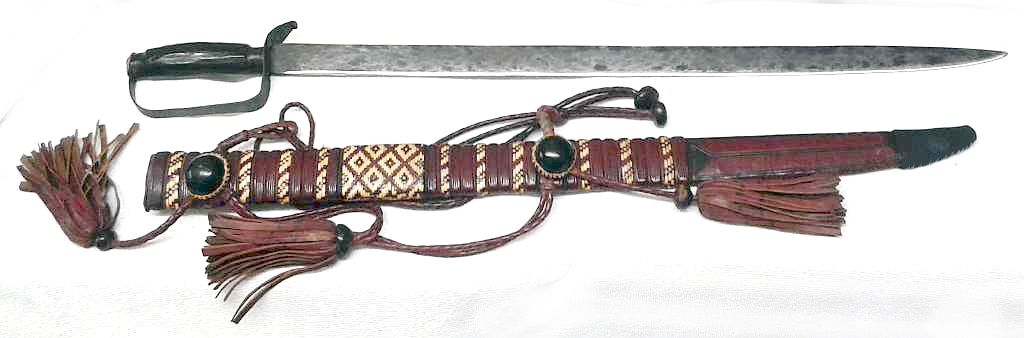

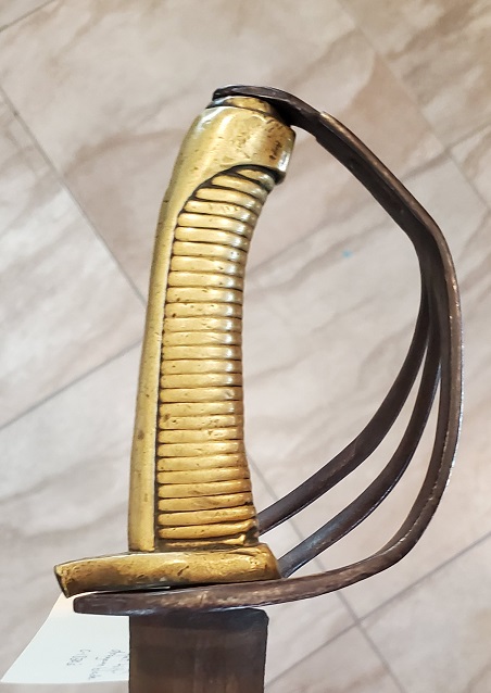

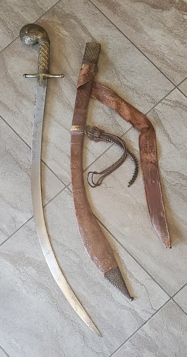

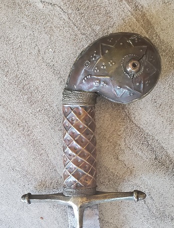

Heres another saber with likely Sudanese association, having notable Ottoman styled hilt of pistol grip form. The blade is of shamshir form and the scabbard has what appears to be the Sudanese flared point as typically seen on those of kaskaras. The strap is of the type used also on kaskara.
Old 10th March 2022, 05:58 AM   #19
Interesting. I'm not particularly fond of the oversized pommel disk thingy, which I assume was to help balance the blade closer to the guard. Is the grip all metal?
Old 10th March 2022, 09:38 AM   #20
Or is this a hollow pommel, only for decor; can we even see crack in it ? So not a balance solution, i am afraid .
Old 10th March 2022, 04:54 PM   #21
Posts: 10,872
It is of brass alloy and seems quite hollow, this is certainly not a fighting weapon but entirely a parade or ceremonial accoutrement. In Sudan there were often variations of kaskara, some with multiple discs relative to the familiar pommel disc, which were hollow, in these cases filled with seeds for rattling.
This does not rattle, but the cross hatch styling recalls the embossed silver hilts in Darfur post Mahdiyya.
As Fernando has observed, clearly the oversize pommel has nothing to do with balance, however the blade on this is quite viable, I think the term is Turkish beyez or to that effect but cant recall.
While this is obviously not a fighting weapon, my point in adding it was to illustrate the kinds of assembled, composite, or amalgamated examples which often occur in ethnographic contexts. In many cases, despite a degree of synthetically standardized 'forms' such as the tulwar, yataghan, kaskara, and the long string of weapon names, these do not follow pattern books and may be variant in the interpretations depending on maker, regional preference, period and many factors.
By synthetic, I mean that many of these descriptive terms have been created by arms writers and collectors to establish the necessary descriptive terms that are essential for classification and categorizing. In many, perhaps even most cases, these are 'collectors terms' which are completely unknown to the native people of the regions where these weapon forms are deemed indiginous. To illustrate one case in point, years ago I tried to discover the origin of the term 'kaskara' for the Sudanese broadsword, but completely to no avail.
In every attempt to discover this etymology it was futile, even 'authorities' in the British museums, arms writers, even an archaeologist and authority on Sudanese history had no idea on this.
Even speaking with Sudanese people I knew from different tribal backgrounds who recognized the sword referred to it simply as sa'if. One called it a 'cross'. None had ever heard the term 'kaskara'. It seems that Burton (1884) was the first person to use the term, but atypically offered no etymology or explanation. Until Iain Norman with his extensive Saharan tribal research found it was a term from Baghirmi, the word remained unidentified.
This phenomenon is much the same with so many ethnographic weapons it would be impossible to cover here. The point is that 'kaskara' simply has become a collective term for these broadswords from Sudan, and part of the vernacular of arms collectors and scholars. Much as with the transposing error of Egerton (1885) who accidentally used the term katar to describe the transverse grip 'jamadhar', and again, use of that term entered the vernacular of arms collectors and writers.
It has been proven time and again that it would be pure folly to correct these terms in the glossaries of collectors and scholars at this point in time as what is important is to have a well known term to ensure the proper semantics in discussion by using the commonly known term.
In this same manner, when an example being discussed is being described and exceeds a specific classification, it is important to qualify the elements being noted.
With the Indian tulwar, this form remained in use for centuries nearly rigid in its construction, with often only minor variations in elements such as pommel disc, langets, quillon terminals and of course decoration, in the classification systems focused on the hilts. Then enter the situation with the blades, which when various types were joined with the almost standard (Indo-Persian) hilt, entered an entire new spectrum of classifications based on the blade forms. The same was with the khanda/firangi situation.
So then factor in the phenomenon of components from other cultural spheres, joined with these native hilts. During the British Raj, there are many examples of Indian tulwars mounted with British blades. With the khanda, one of these with foreign blade becomes instantly a'firangi', but what of the tulwars...obviously they are not firangi as that term is used only in the Deccani dialects.
In the northern regions where the tulwar predominates, the term tulwar (obviously covering far more area geographically) is a collective term for 'sword' (much as sa'if is used in Arabic) but seems to apply mostly to the familiar Indo-Persian hilts. However, in Mughal parlance the term shamshir was also used in instances. There are shamshir form hilts on tulwars, yet they are deemed tulwars.
I think that common sense and context prevails in the accurate description of particular examples. Obviously we often cannot know for certain where an example comes from when there is no reliable provenance. However to use, often by analogy, the comparisons which suggest possible influences can offer constructive clues for consideration.
I think well considered observations using whatever elements of an example which are recognizable, despite that example being outside the parameters of a given classification is expected, and inherently should be recognized as speculative. Like any empirical research, this is a process which is ongoing, and more specific identification may eventually be accomplished as other comparable examples surface.
In the case of our subject sword (OP), my objective (post #9) was to show a kaskara ( from Aug. 2015) with a blade bearing remarkably similar central panel inscription (presumably Amharic, =Ethiopian) with a lion (also assoc. with Ethiopia) .....and comparable to the motif on the blade of subject sword posted.
Clearly the scabbard resembles Sudanese work, but this lacks the 'flared tip' typically on Sudanese scabbard. It would seem that the Sudanese would prefer a broadsword, but if this blade was from a repurposed shotel, and knowing that Ethiopians also favored European hilt gurade sabers perhaps that might account for the hilt. True, we will not likely know the village and country this unknown blacksmith was from, but the nature of the hilt, blade and scabbard give us points of consideration.
Sudan and Ethiopia share a border....the kaskara, a Sudanese weapon, was well known in Ethiopia as well as Eritrea further east. Ethiopians had exposure to the D guard hilt and used them. The Sudanese, barring any unknown anomalies did not, nor did the Eritreans.
It seems doubtful that a weapon, blacksmith made, would be produced further southward in either interior or coastal East African regions yet carry the scabbard character.
That is my take..........given briefly as always

I can see the crack now. I'll agree its grip is just decorative. A more functional & traditional Turkish kilij style hilt would look better to me, even in silver, but opinions of beauty are in the eye of the beholder. Somebody liked it...

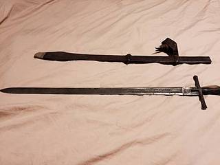

Sabre arrived this morning.
650 grams ex. scabbard.
26 in. blade, 5in. wood grip, peened tang. Was stuck in scabbard, had fun getting it out. Cleaned with a ss brush a bit. Definitely a lion one side, might be a rather worn head on the other, Amharic lettering. Service sharp too
Photos: Some HDR
Old 11th March 2022, 12:47 PM   #24
2 more
Old 12th March 2022, 04:20 PM   #25
Just had a thought, so I got out my Mandinka sword. It's almost the same length as the eritean/ethiopian sword, slightly lighter, straighter with a substantially thinner guard, an a bit more decorated.
Convergent evolution, or just copying the bellicose Europeans?
