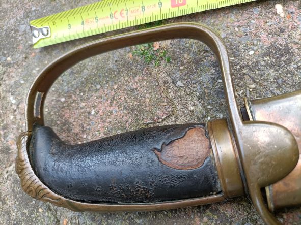

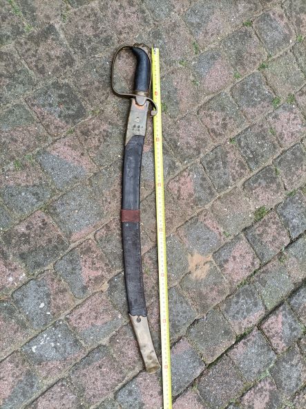

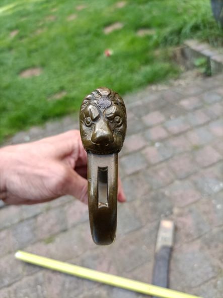

Hi, I have this little sabre what looks like a 1803 pattern infantry officer sword. Not sure what to think of it but maybe someone knows what it realy is?! The length of the blade is 55cm. Overall length without the scabbard is 66,5 cm. Despite the wear It is still razor sharp. Floral motives on the blade with some traces of guilding.

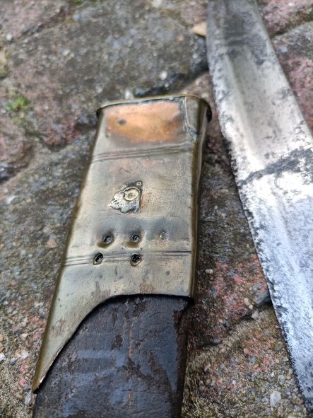

The handle is simply wrapped in black leather wich seems original to me. The scabbard has an old repair on the locket and a later repair where it probably broke in two. Overall, it has seen better days.

A flank sword with only 55 cms, cel7 ?
Must be something else ... i am afraid .

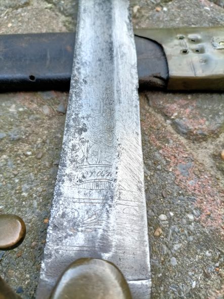

I think that the text says "warranted" That makes it plausible that it is British. But you are wright Fernando, probably no 1803 pattern sword.

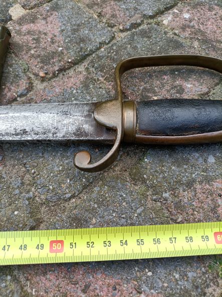

Some more pictures. If you look closely you can see that the fuller runs almost to the point. So perhaps the blade was shortened for some reason.

I doubt that actually. "warranted" means that the weapon is tested for strenght, hardness, flexibility etc. This was a guarantee that you bought a weapon that met the requirments needed on the battlefield. In other words, a more expensive weapon. Why would you do that if you knew that you probably never need to use it?!

37mm puts it in the range of normal sized swords. If it started out life this short I would have expected it to be a bit narrower than this. Doesn't tell us when the shortening was carried out though.

I note the original posted sword scabbard appears to have once had a stud like a scabbard for an infantry briquet/hanger frog rather than the two ring suspension for a sabre.
