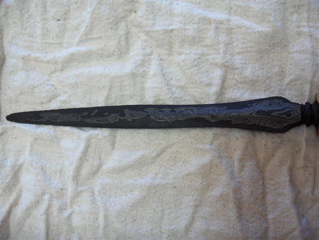

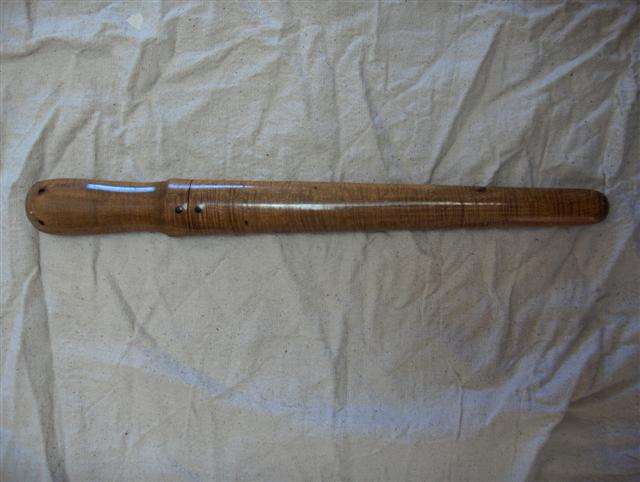

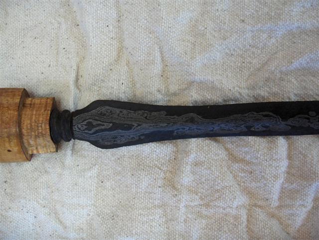

Here are some images of my new tombok. Would be interested in people's comments re age. The blade is in nice condition. The lustre in the wood is very good as well.
thanks
DrD

Hi DrDavid
The scabbard looks recent and I don't think the blade is more than 50yrs old.
Lew

Posts: 1,209
I agree with Lew. A rather recent tombak. Nevertheless a very fine example.

Hi Henk and Lew
I realise the dress is new but I am curious to know why you think it of recent origin. I suspect the photos may not do the piece justice.
DrD
Old 3rd April 2006, 09:16 PM   #6
Henk
Henk's Avatar
Posts: 1,209
DrD,
The surface of the blade and the edges are to smooth for an old tombak. Just like keris the blades of tombak where etched with lime juice and warangan. When you have an old tombakblade you would have noticed that the surface and the edges had the same corosionprocess as an old kerisblade because of the arsic.
