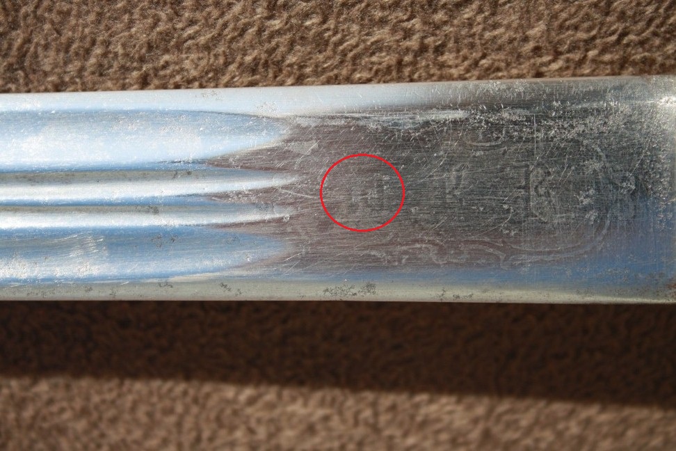

This one came to me a couple of days ago. Not a fancy one, but a good honest kindjal.
It has got some etchings on each side of the blade, or what remains of them.
Does anyone recognize these etchings ?
Thanks.
HB

Both photos are upside down, but on one I think I see the common ККВ inscription, which stands for Куба́нское каза́чье во́йско: The Cuban Cossack Troops. I am really not familiar with the history of this unit of the Imperial Russian Army, so I am not sure what the initials on the other side of the blade could mean. I just see a Cyrillic F, the rest is too faded away. Someone who knows more about ККВ may be able to decipher it for you.

Thanks Teodor i think you are right.
I have already got a classic KKV kindjal, there is one pic of it here: http://www.vikingsword.com/vb/showthread.php?t=14753
I think that what made me confused, is that on the new kindjal the writing is following the blade, but in the old one, it is written across the blade...

Oh, I see now. ЗОФ stands for Златоустовская Оружейная Фабрика: Zlatoust Weapons Factory.

I have second thoughts about the KKV etching on the last picture I know that it is turned upside down. I see ?KV.... could this be from some other cossack army than the Kuban ?

It is very worn-off, but I imagine I can see TKB, Terskoe Kazach'e Vojsko: Terek Cossack Troop.

Interresting !
I did a google search but could not find any TKV stamps
