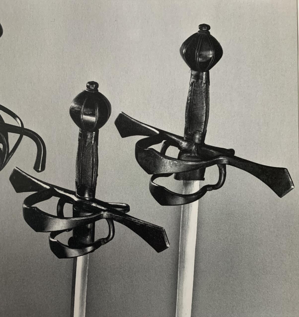

I think I found which reference you mean. I was going through Norman (1980) looking through the pommels chapter for anything described as Saxon, as well as indexes but found nothing with that specific designation.
I found the book "Die Schwerter und Schwertknaufe der Sammlung Carl van Schwerzbac-Bregenz" by Dr. R.Forrers, Leipzig, 1905.
E. Oakeshott "The Sword in the Age of Chivalry" (1964) is also mentioned in which the various types of sword pommels he lists in his alphabetically categorized typology of them is pretty thoroughly represented. I found no mention however of any specified as Saxon.
It seems I have seen the term Saxon used on occasion on examples in auctions etc. but cannot recall specifics. I have seen the term often used for military swords of the state of Saxony origins. Searching online mostly the term is used for numerous reproduction models from well known producers.

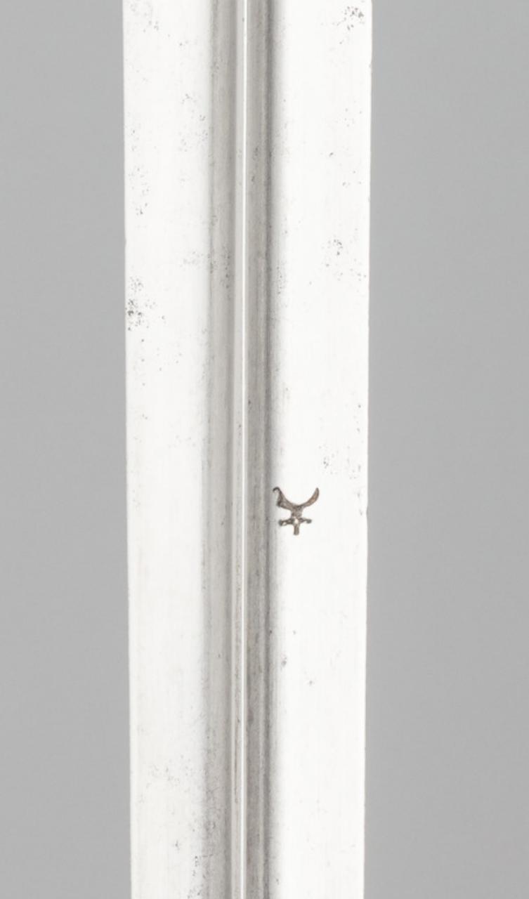

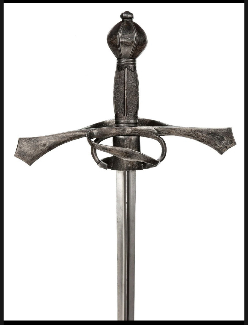

Again, this is most interesting, and while it seems over years on occasion I have seen swords identified as "Saxon' but simply regarded it as as a term of heightened specificity over the more general 'German' classification.
I have always recognized the axiom, 'weapon forms have no geographic boundaries' . Obviously certain forms had preferences in certain local regions and were preponderant in them, but was there some distinct characteristic that would signify a sword was specifically from the defined Saxon area?
Clearly there have been notable geopolitical changes in this state over many centuries, so that further begs the question, what defines a Saxon sword?
In the more recent centuries of course, military swords would have cyphers, inscriptions, coats of arms which specified Saxony, but with images of edged weapons without such identifying elements, what in the images in the OP signifies that these are 'Saxon'.
The serpent on the ricasso in the second image is of course associated with Milan and used by makers variously in that context.

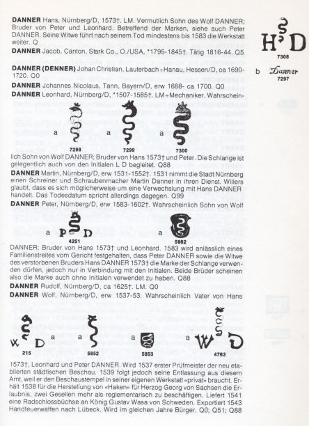

It is interesting to know that the nearly same snake-mark is the sign of the DANNER-family at Nürnberg
Good catch Udo!!!
What reference is this!? I must have it it surely leaves the standard compendiums in the dust.

Good catch Udo!!!
Eugen Heer, Der Neue Stoeckel, Schwäbisch Hall 1978, 3 volumes, 2280 pages, this opus is a MUST!!!

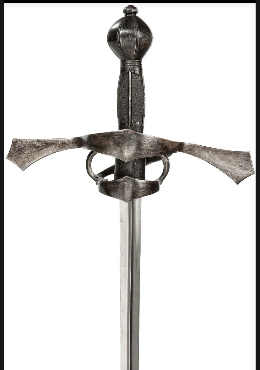

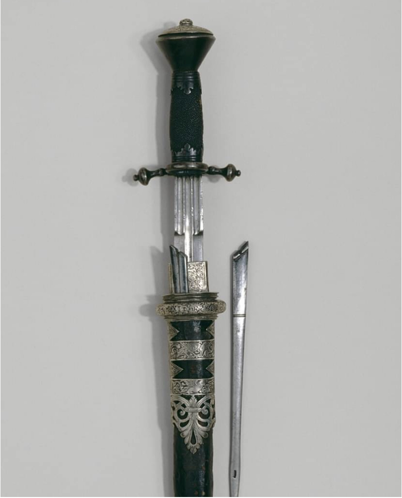

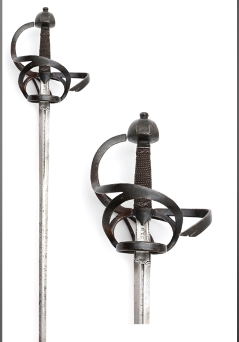

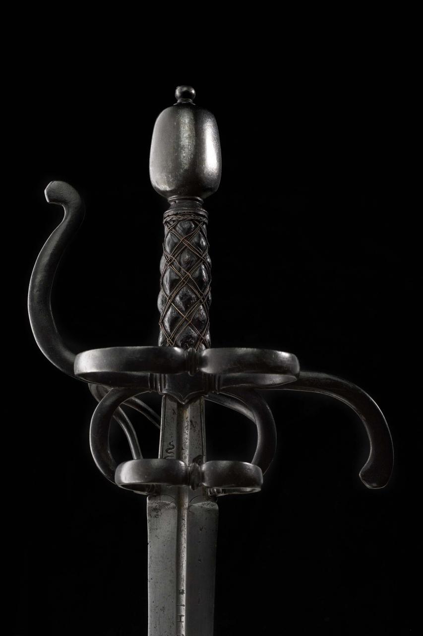

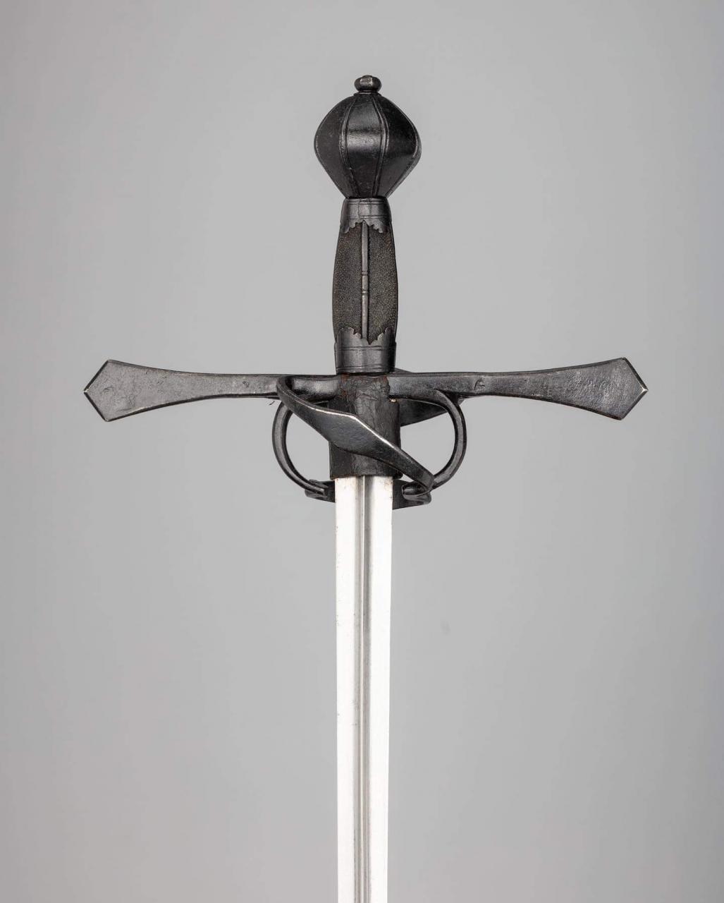

I try to give my opinion a little free rein here, I also listen to your opinions. I'm happy to accept additions and try to incorporate them. Of course, I will also name sources.
I would like to start with what I think is the simplest variant
The Saxon estoc with a simple eight-sided pommel and lines. Carried as a secondary weapon on horseback. In the version shown, probably for simple court servants on horseback.
The version with different blades (triangular and square) and usually provided with the Pi brand. There were leather sleeves and metal sleeves for the transition from scabbard to blade.
A chronological classification is difficult, but I assume 1590-1600.
Sidenotes:
1. The mounted contingent of the Saxon Trebanten guard was formed of a company of one hundred men on black horses.
2.Their uniform included a blackened comb morion (a type of open helmet used from the middle 16th to early 17th centuries) with etched and gilt ornament, black doublets and yellow hose and stockings, the colours being those of the Arms of the Electors of Saxony.
Source: Copyright © 2016 Peter Finer
Merenti is offline   Reply With Quote

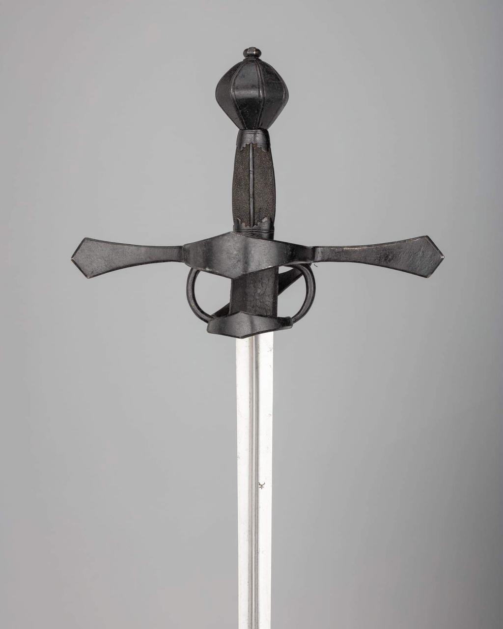

1.1

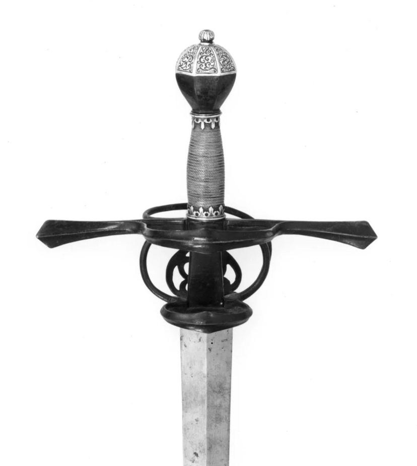

2 estocs with triangular blades and the same pommel. From the Rüstkammer collection in Dresden.
