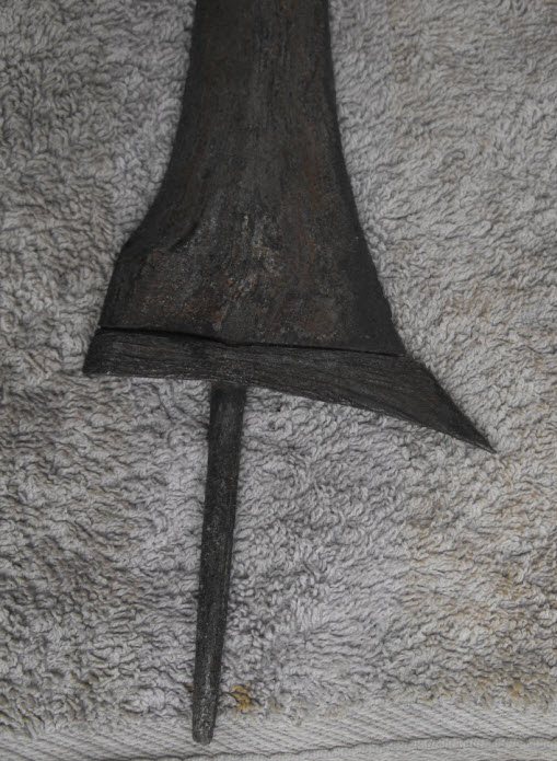

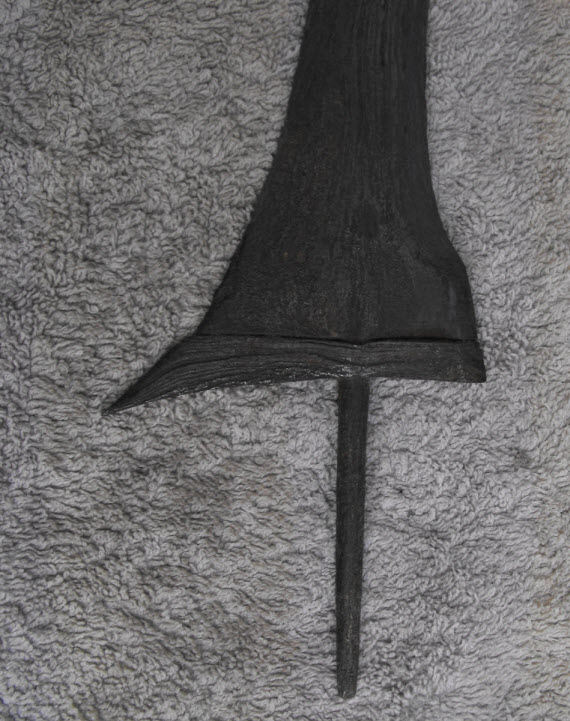

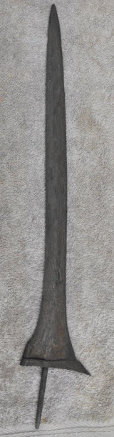

This one looks a kind different, there are more lines in the length of the blade, and is quit thick and heavy.
The length of the blade without the pesi is 36 cm.

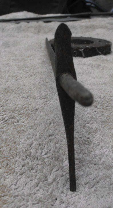

Is there a ridge down the centre of the blade, or is it more or less ovoid?

To my idea it's more ovoid, i had to look up what's the meaning of that word

Again, I cannot give a supportable opinion, its just your run of the mill average keris, but it does have north coast features and the gandhik seems to incline inwards at an angle approaching old Madura.I don't think I can go for Central Jawa, East Jawa. North Coast, maybe Madura.

I have seen a couple of blades that looks somehow like this one, with the (grains) in the length of the blade, and they were all stated as Madura.
